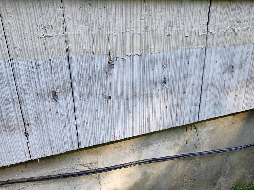

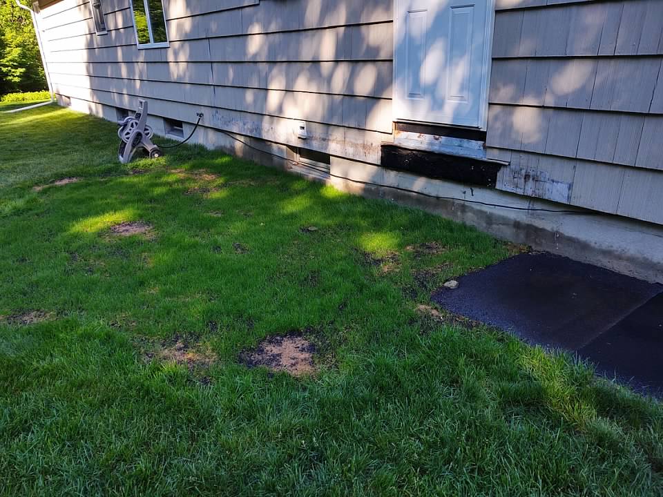

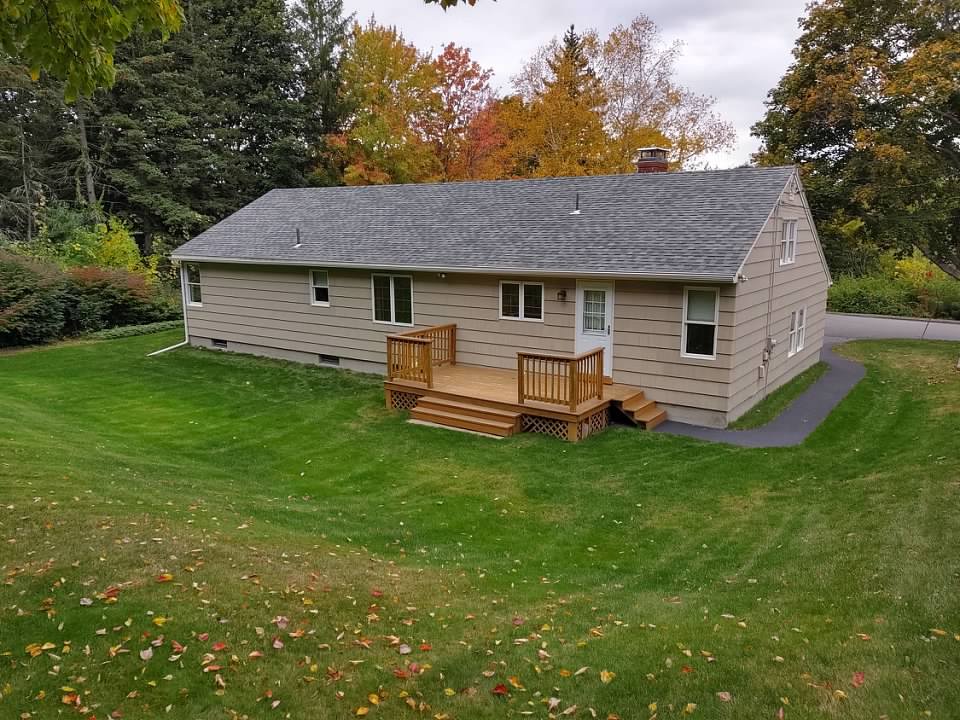

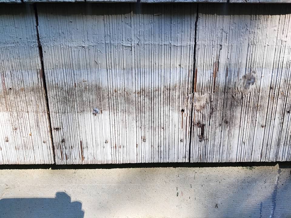

    Couple weeks back, I decided to remove the 8'x16' deck off the back of my house for multiple reasons. Primarily because it was attached to the house incorrectly 30 yrs ago. It was lagged/attached directly to the grooved western red cedar shakes. No ledger. No flashing. I also don't use the deck that much, I will be replacing this fall with a smaller 8x8 deck. I was fully expecting there to be major rot after 30 years. That black tarred board is from the original back porch. To my utter shock/disbelief/amazement there was ZERO rot. Other than the holes from some nails and the lag screws, the cedar shakes were all intact and dry. I'll replace a bunch with holes and some on the course above that had been nicked/damaged by shoveling in winter. Thankfully I have a partial box from replacing windows over the years. A few years back one box (25 sq ft) was $135. Now the same box is $325. :eek:
