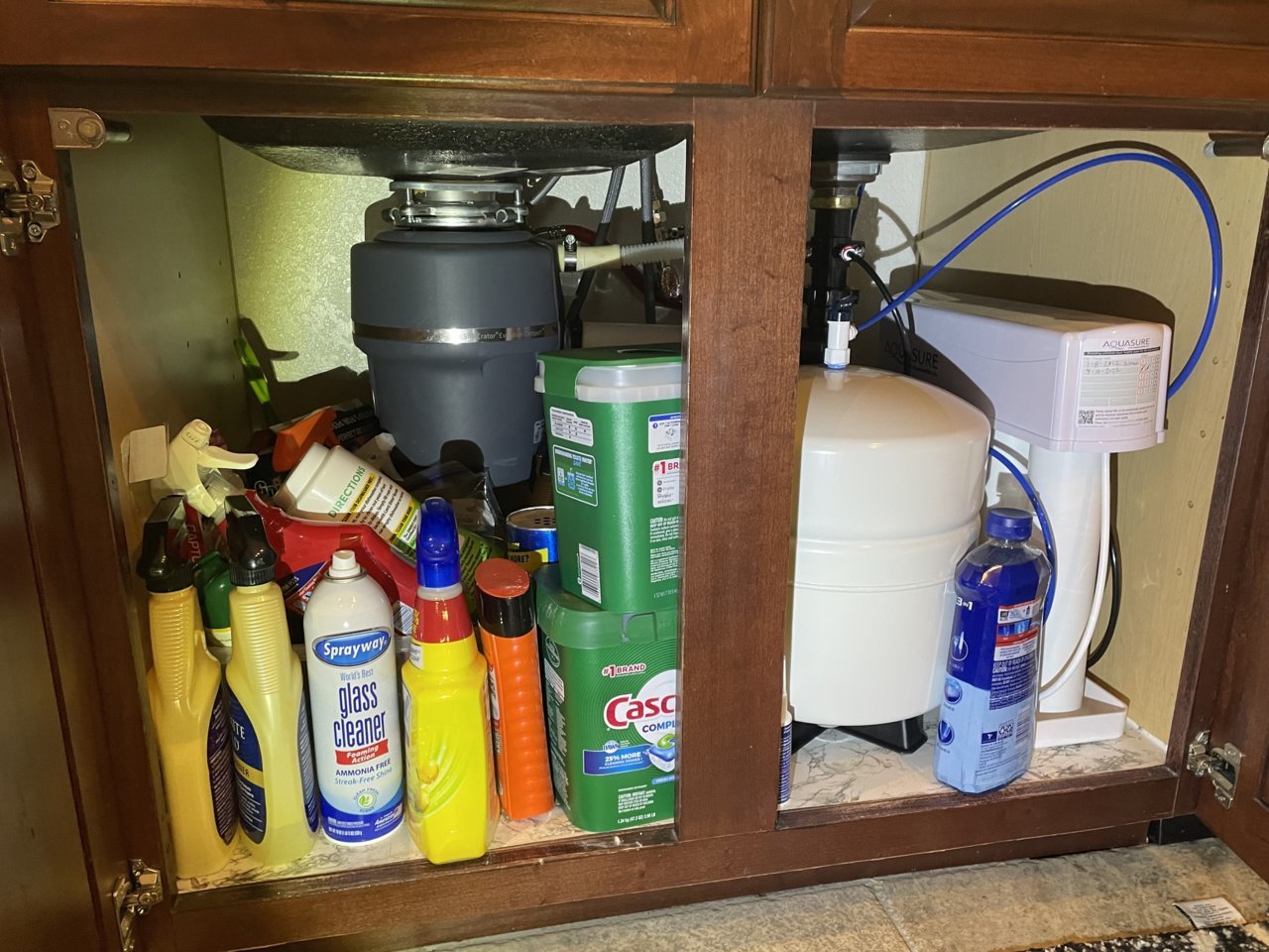

    I think all disposals are universal fit providing the height and width space is there. I got the 3/4 HP. There's not much room under the sink anymore with this disposal and the Aquasure R.O. system, but I'm happy with my choices. :D
    Edit: They don't usually come with a new power cord, so make sure to get one.

    Take cord off the old disposal:notsure:

    Plumbing lined up with no problem, but I had to cut a new drain from the disposal to the existing connection because the new unit is much larger and had a different connection.
    If I had been a bit smarter, I would have used the existing sink drain. I got the old one out and then took out the new one and realized they were identical. Dummy moment added 30 minutes to the project.
    This one is a 1HP 2-stage unit. They had info on a 1HP 3-stage but the shelf was empty where it would have been. And I did check the box and found out that it didn't come with a power cord, so I scored a new one without having to make a second trip.
    I'm pre-plumbed for a filtration system but I don't know anything about them. What can you tell me about yours?

    Dang, you could grind a whole Costco chicken in there! :D Texas has the same hard water problems as AZ.
    My water filtration consists of a Halo 5 whole house water conditioner, Aquasure Harmony 48k grain softener, inline sediment and carbon wall filters and the Aquasure R.O. system.
    I don't recommend the Halo 5 as it's way overpriced for what it does or claims to do. If I move I'll do the same setup but with the Aquasure Fortitude Pro whole house filter instead of the Halo 5.
    https://aquasureusa.com/collections...house-water-treatment-system-1-000-000-gallon
    https://aquasureusa.com/collections...sediment-gac-whole-house-filter-48-000-grains
    https://aquasureusa.com/collections...sis-drinking-water-system-100gpd-w-led-faucet
    I've also got a DI Rinse Pro 100 for spotless car washing. (absorbs 100 percent of calcium and magnesium)
    https://dirinse.com/product/d-i-rinse-pro-100-system/
    Basically, all you need a sediment filter, a large carbon filter and an R.O. system for cooking and drinking water. The R.O. system was added earlier this year and I didn't think we needed it, but wow is it nice.

    Thanks for going into detail about it. Your system looks very complex. How much time do you have to spend maintaining it? Or is it just add salt and change filters every now and then and it takes care of itself?

    Pretty much add salt and swap filters.
    The Halo 5 and Aquasure regenerate automatically about once a week. Inline wall mounted sediment and carbon filters are changed every 6 months, a bag of salt about once a month (it holds about 4 bags) R.O. filters stages 1 & 2 were replaced after 3 months, but we use a lot of water and the dog drinks R.O. water too. :rolleyes: :D I flush the tankless water heater with distilled vinegar about every 6-8 months.

    Was it hard lining up the disposal to the sink?
    My friend always have a hard time lining the disposal up. It's a losing battle.

    Question. Does the aquasure faucet fit in the little hole where a pull out spray nozel goes on a three hole faucet base setup?

    It should. I used an existing smaller hole that was for a soap dispenser.

    Nope, just heavy.
