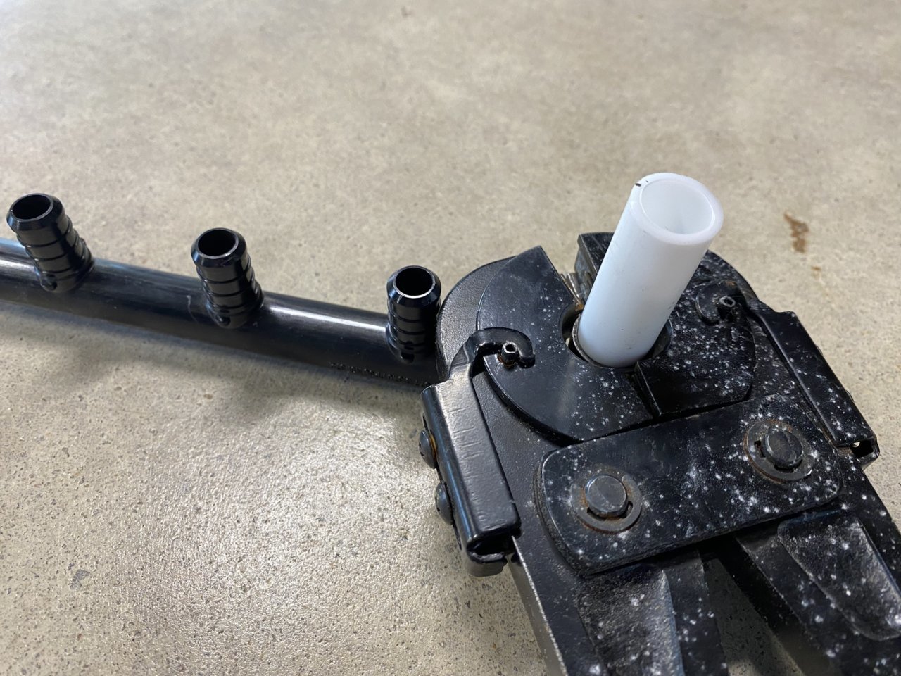

    The crimper?

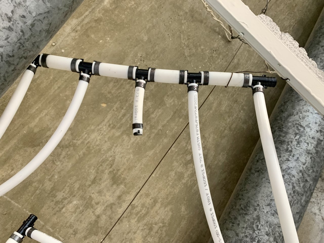

    Crimper works fine, the manifold spacing won’t work with it though. Not sure what tool they’re designed for. Thought I’d be fancy and use those and the nice copper stub outs. Both are in my return pile lol

    Sat my fat rear end in it.
    Maybe these?
    Disclaimer: I'm not a plumber, and have never used these. But I might be using them in a few weeks.
    https://www.homedepot.com/p/1-in-Stainless-Steel-PEX-Barb-Pinch-Clamp-10-Pack-PXPC110PK/301541072
    https://www.homedepot.com/p/Apollo-3-8-in-to-1-in-1-Hand-PEX-Pinch-Clamp-Tool-69PTBJ0010C/301921125

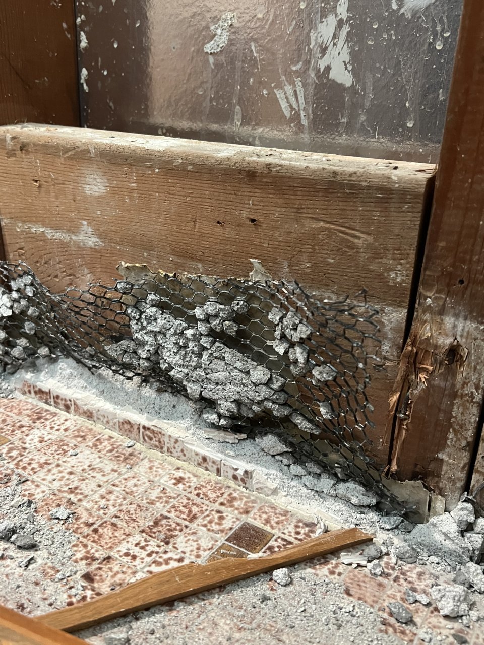

    Looking for any advice or professionals who have dealt with this shit before. Every single bathroom wall has this metal mesh backing behind the tiles and it’s damn hard to get pulled out. Any tips or tricks?

    I’m no pro but I’ve demo’d 2 bathrooms now with the same stuff. Definitely the old fashioned way of tile installation. If you can’t get behind it to smash it out, I’d say use a crowbar and small sledge and “chisel” it out. The metal mesh breaks pretty easy under some pointed force. I think pros always use hammer drills to tear it out.

    Yeah, it’s brute force, long crow bars, and leverage. That stuff SUCKS. Vice grips can sometimes get you enough hold to tear the smaller leftover chunks out, but it’s mostly swearing and banging.

    Thanks fellas. Figured that’s the way and I’ve been doing that mostly. Walls weren’t awful but the small edges at the bottom and the floors is brutal

    Brings back some nightmares. Ripped out three bathrooms in the last house with that stuff. It’s awful. Everyone pretty much covered what I was thinking. Good luck to you and i know your pain haha
    Almost forgot sledging the old cast iron tubs to be able to move them. That shit was heavy! I don’t miss plaster and lathe.
