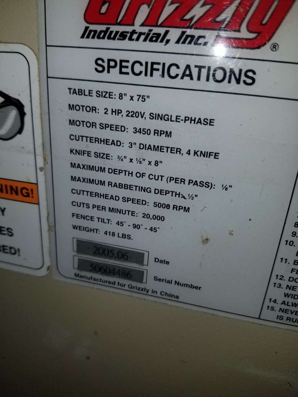

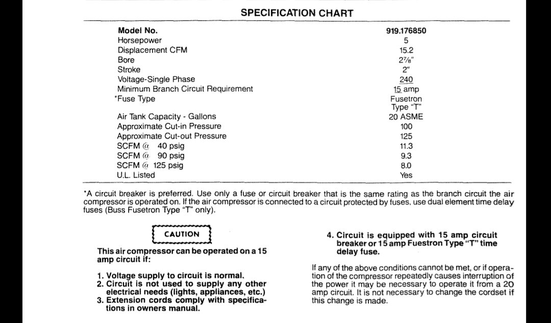

    Originally we were talking 120V no?
  4. Jun 29, 2022 at 7:28 PM
    My Name is Rahl
    Jul 5, 2018
    #258370
    22,105

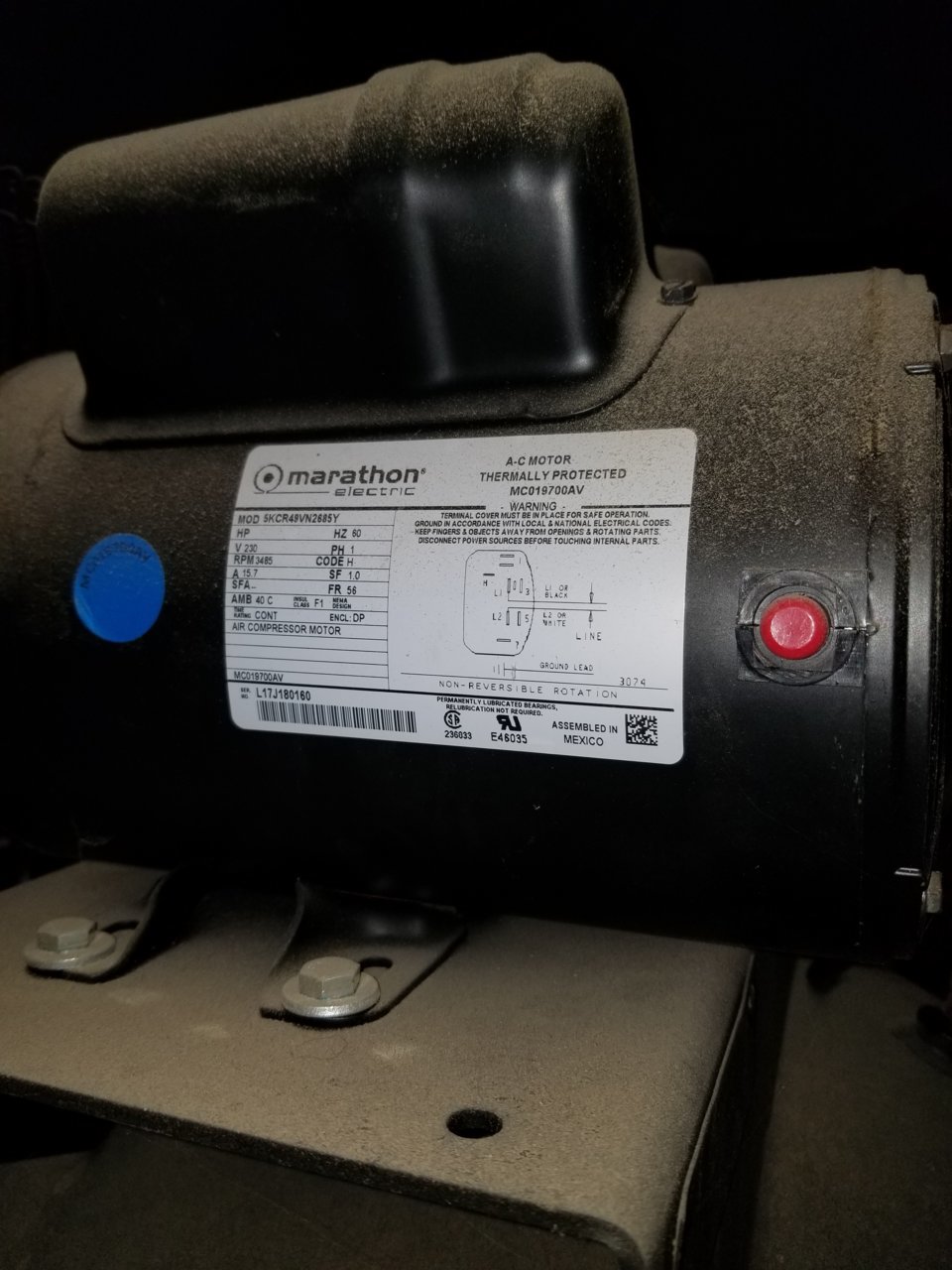

    No. The tag on the motor reads 13.1A, 230V.
    Toyko Joe and Pablo8[QUOTED] like this.

    Slightly different motor but specs are the similar.
    Pablo8 likes this.

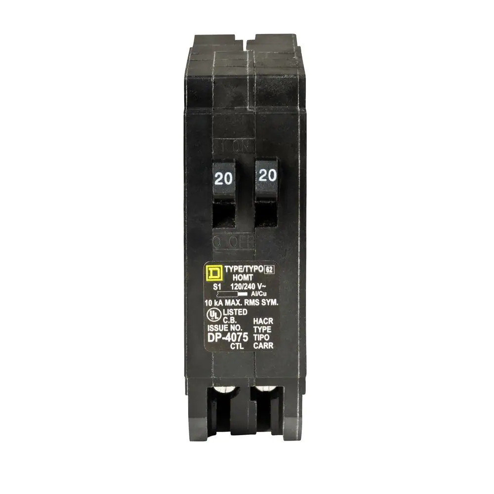

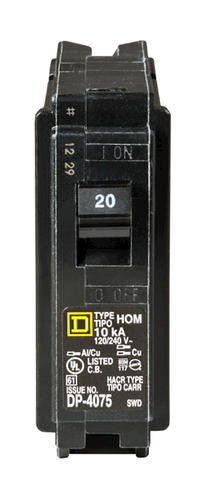

    For 230 volt motors you need a 2 pole breaker, it will take up 2 full adjacent positions in your panel board.
    A single pole breaker is only for 120 volts and takes one position.
    A breaker like this is called a tandem or cheater breaker, it lets you add another 120 volt circuit to a crowded panel board. Even though it has 2 handles it is not a 240 volt breaker. Use of these should be avoided if at all possible.

    Ok I am sticking with my original answer 12ga 20A

    Doing something (even without issue) and it being correct are two different things.
    Cutting tools start unloaded and are allowed to come up to speed before the load is applied.
    When most air compressors restart there is an immediate load placed on the motor and the cycling of the unit over a short period of time makes the service more demanding.

    One thing for sure, 10g and 30A breaker there would zero doubt. And I certainly would not go 15A slo-blo.

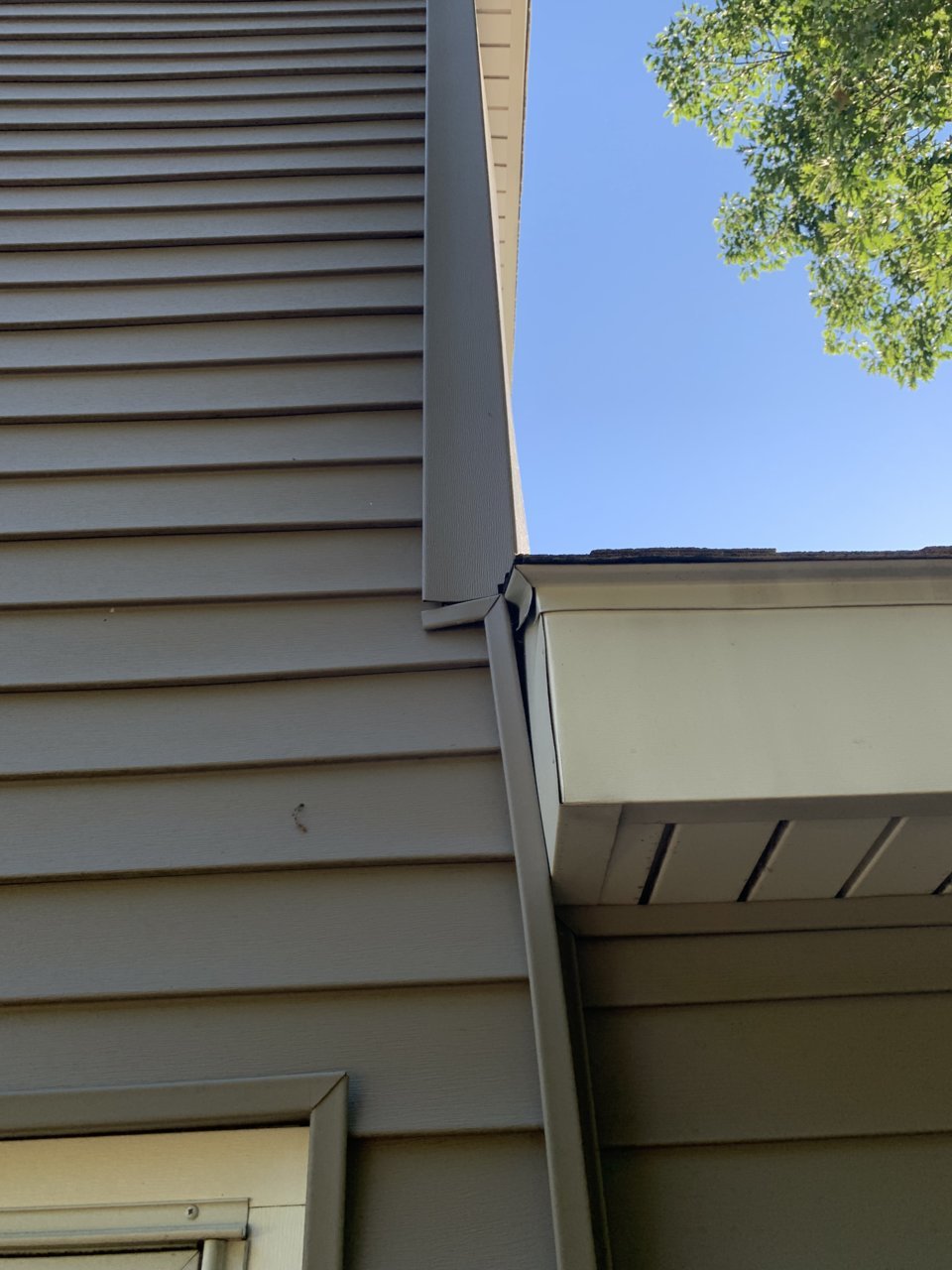

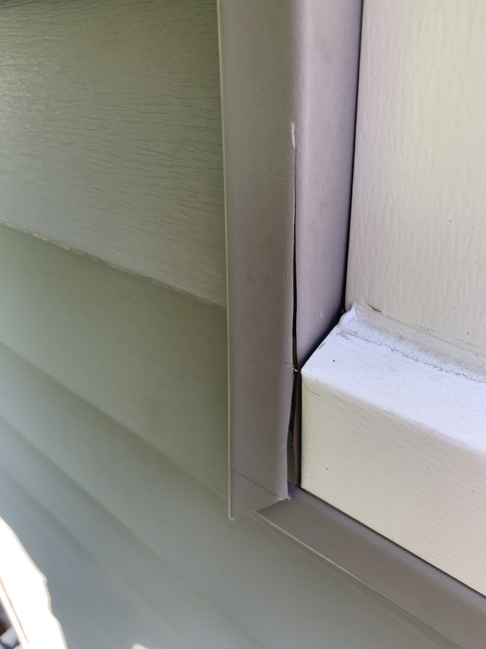

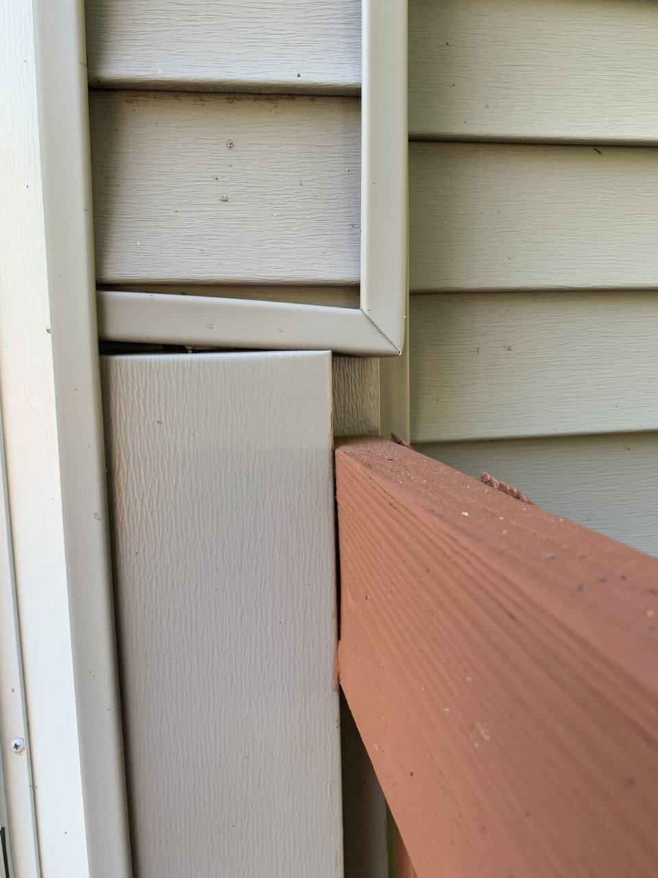

    Yeah it’s just J channel. Not a great job done on the siding but I didn’t want to be to picky. I did complain about a few things that they came back to fix but just did a hack job fixing. After a few times back fixing it and always looking like crap I gave up and said I will fix it myself. I’ve never done siding but I know I can do a better job then they did. I’ll post some pics in a little bit. Give you guys a good laugh to start your day.
  12. Jun 30, 2022 at 4:31 AM
    williams63
    williams63 Well-Known Member
    Feb 29, 2012
    #73898
    6,384
    chili
    nh
    2011 dblcb
    boss-c/o, boss rear leafs
    It’s the little things that bother me.

    The second pic is the air compressor motor.

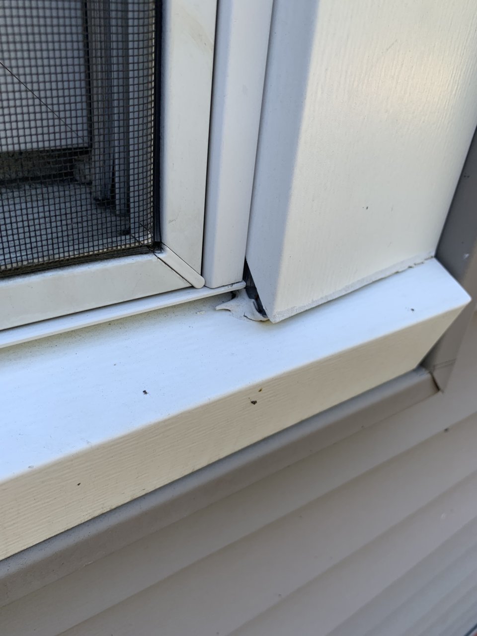

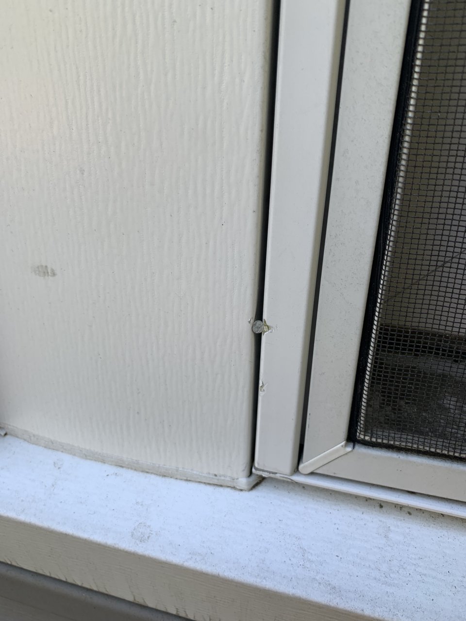

    Had the house sided a few years ago. Didn’t like a few things that they tried to fix a few times finally said leave it and I fixed them myself. I still need to do the windows. Windows on one side had casing and sills the other side didn’t. They talked me into adding the casing and sills to the windows that didn’t have it so they would match and the white trim would look better.
  20. Jun 30, 2022 at 6:05 AM
    williams63
    Feb 29, 2012
    #73898
    6,384
    chili
    nh
    2011 dblcb
    First picture is the casing they did I didn’t like that it kept popping out second picture is the fix they did.
