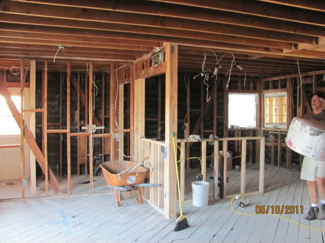

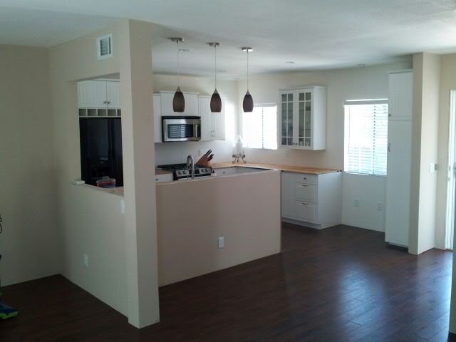

    Just noticed this thread. Lots of good ideas in here, wish I would've seen it sooner. Bought my first place in May (knowing it was a fixer) and have done a lot more than planned.
    On the inside took down all the plaster in the house and while it was studs decided to eliminate a few walls, make new hallway, move/close doors. Quite the learning experience to say the least. So far I've done it with the help of my family. Have only had to pay for drywall taping/texture along with and electrician since the house had 2 electrical panels.
    Still not close to finished but here's an idea of the progress so far

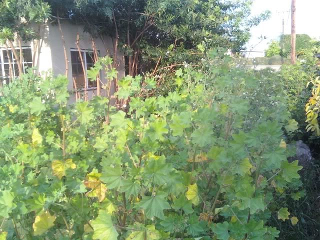

    Outside when I bought it

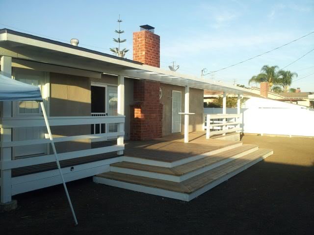

    And this is what the outside looks like now after having a bobcat tear up all the tree/shrubs and till the yard. Also took down the enclosed patio that was attached and started building a deck across the back of the house.

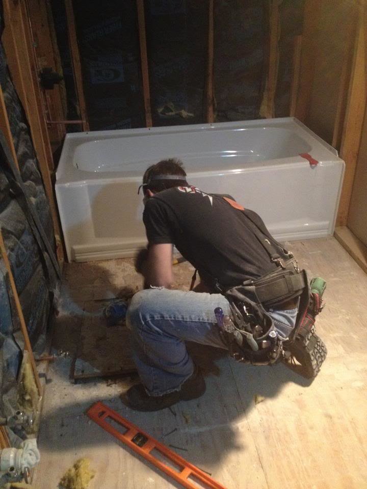

    Worked on the girlfriend's bathroom all weekend. I didn't get as far as I wanted but I still made decent progress. I was hoping to get all the drywall hung but that'll have to wait until after Christmas.

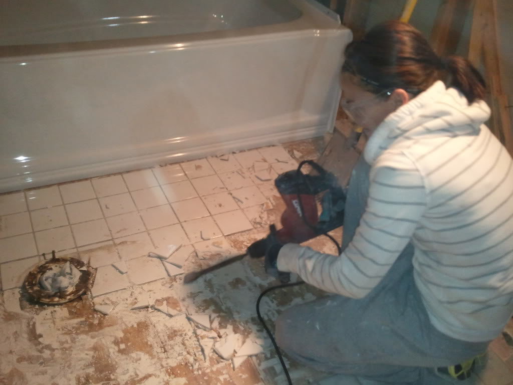

    Chiseled up the tile on the floor. Haha, my girlfriend fell in love with the Hilti rotary hammer. We found some water damage around the toilet so I had to cut up the subfloor and replace that section of subfloor.

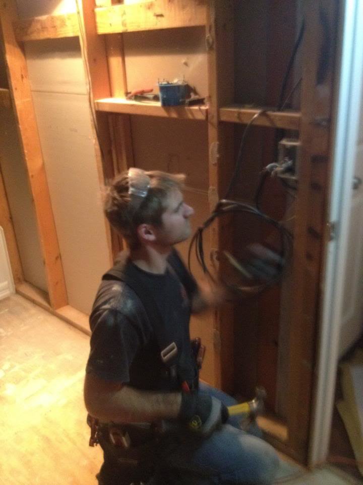

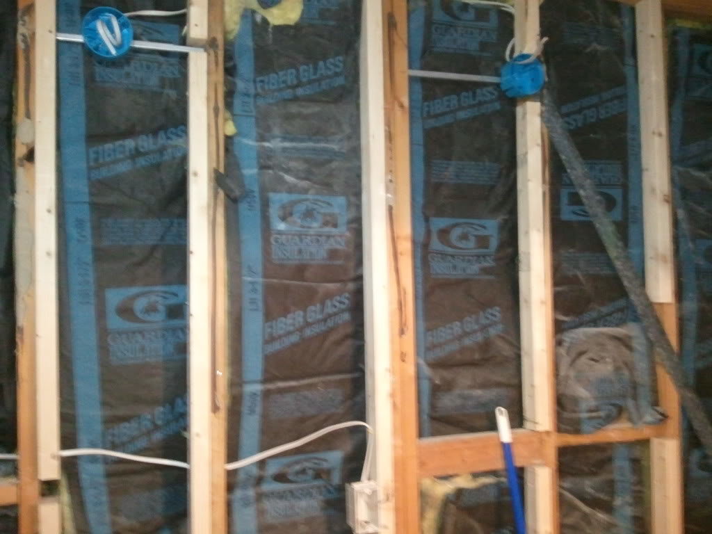

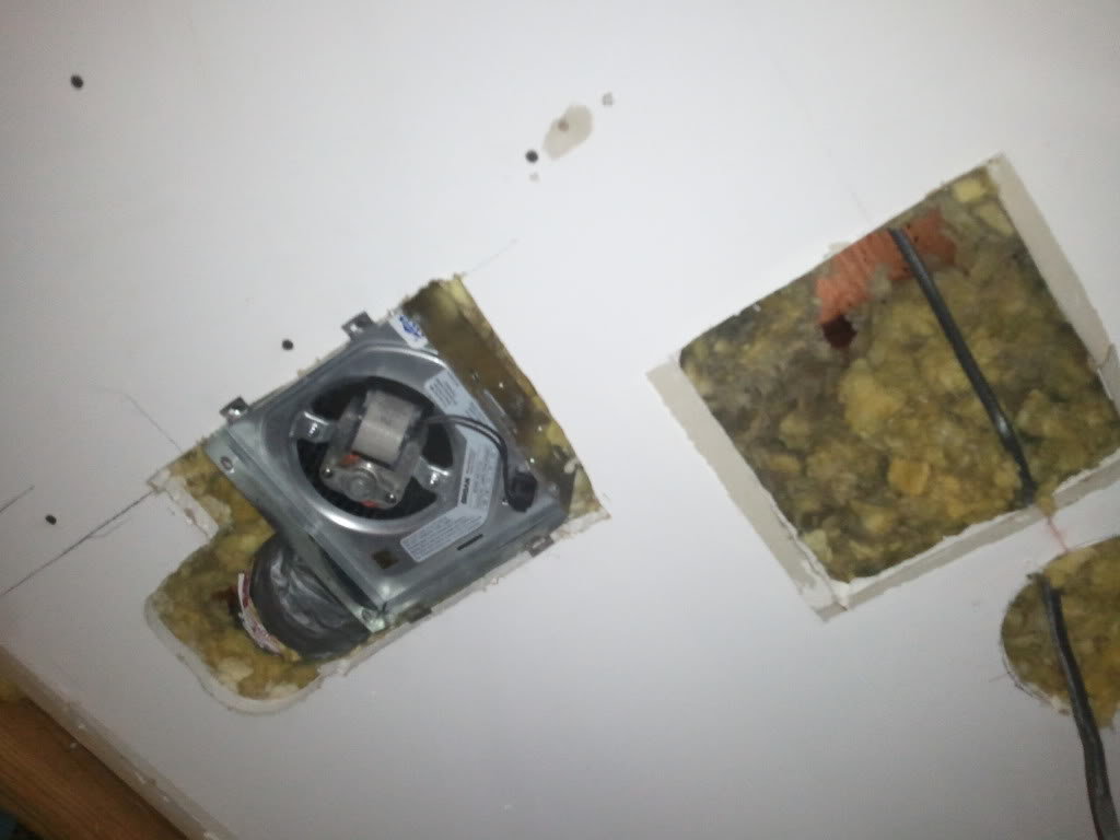

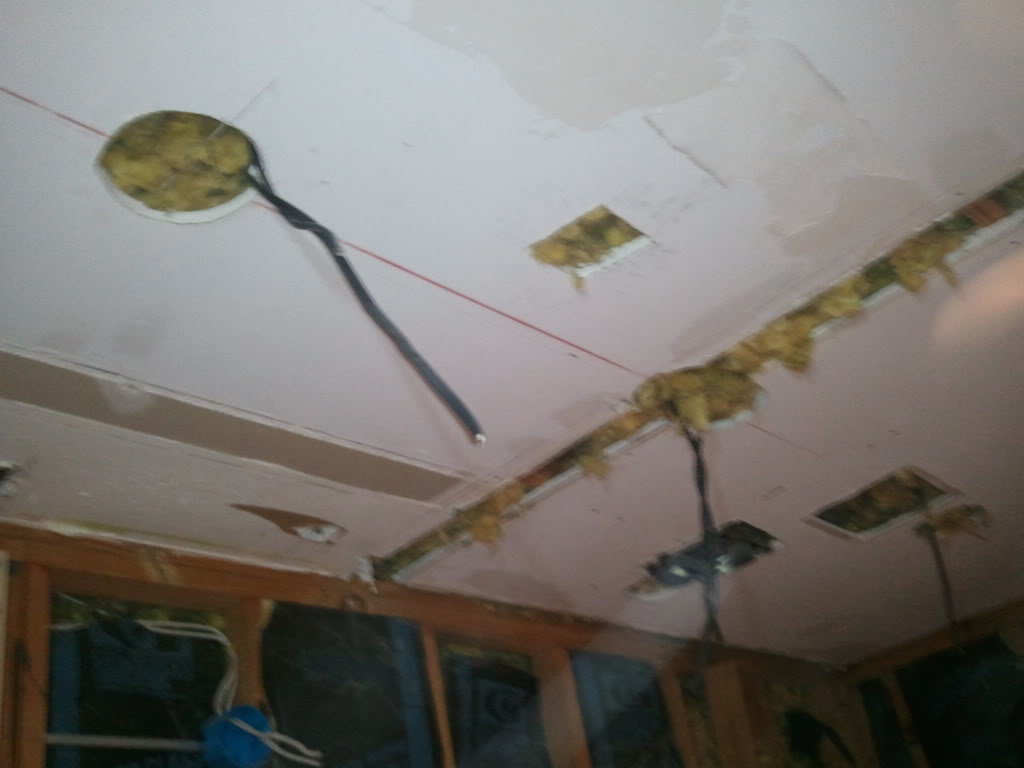

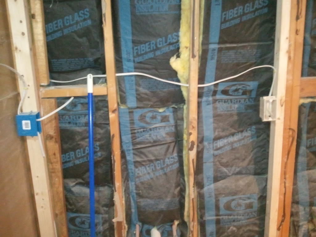

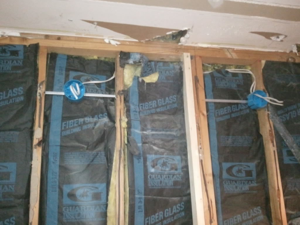

    I got all the rough electrical done. Wired in 2 receptacles, wired up 2 vanity lights, 3 recessed can lights, and a new fan.

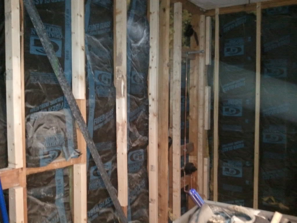

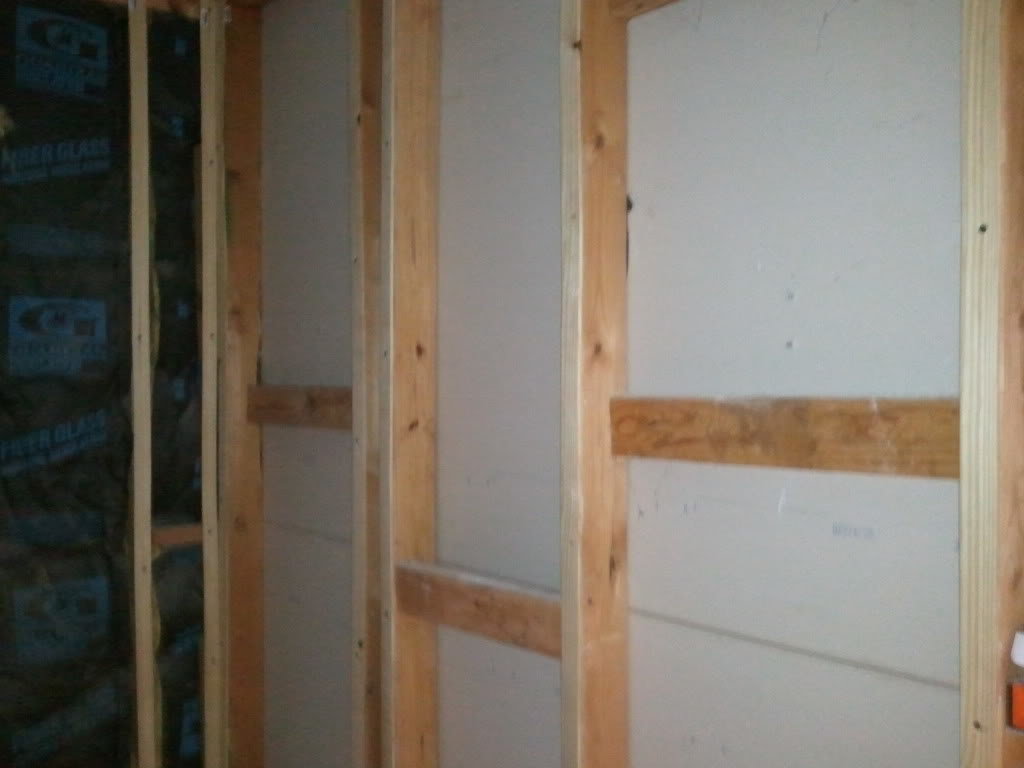

    I also got all the walls shimmed out to overlap the tub lip properly. The left side wall had to be shimmed out 1&1/4" so I sistered some 2x3's to the studs. The other walls just needed 1/4" to overlap the tub lip so I just used some lattice strips.
    Here's my girlfriend having fun with Sally (the rotary hammer)

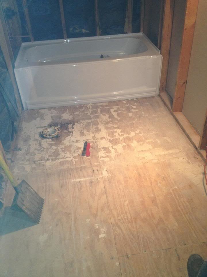

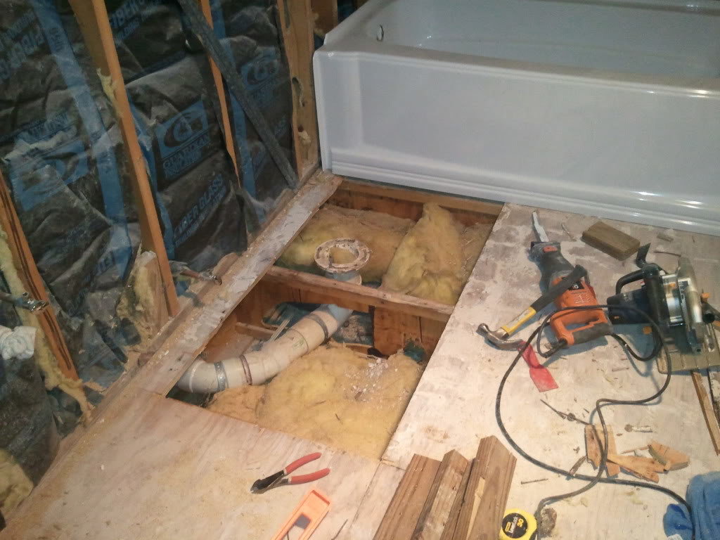

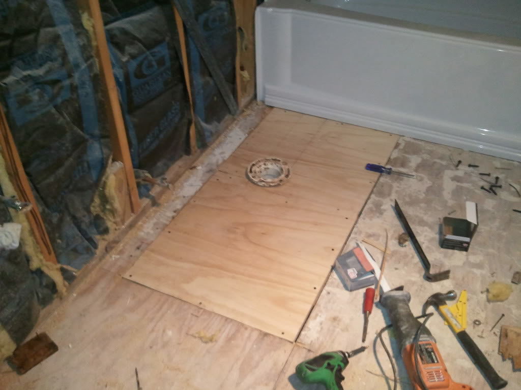

    Here you can see the slight water damage around the toilet flange. It wasn't really wet anymore and the plywood wasn't totally rotten through which leads me to believe it was either a really slow leak or it happened a while ago.
    Here's me pulling it up
    Here's the subfloor pulled up.

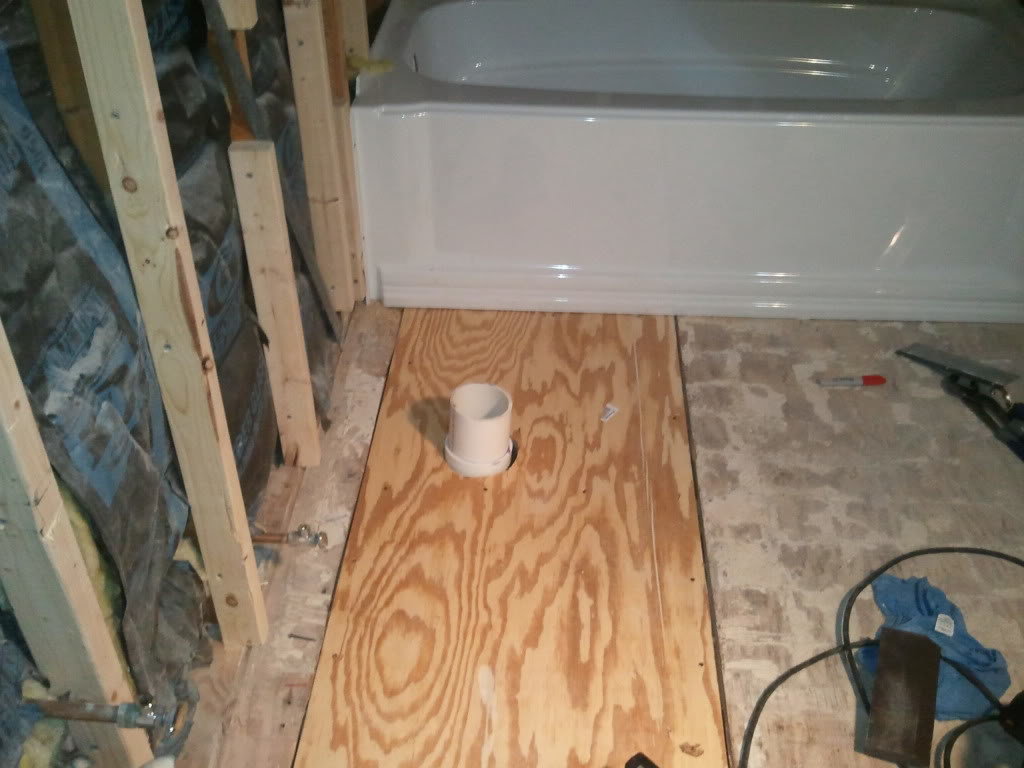

    All patched up with a fresh piece of ply. Fortunately I had a piece large enough leftover in my garage from another project.
    Here's me working on the electrical
    Recessed cans wired up.
    Moved the exhaust fan

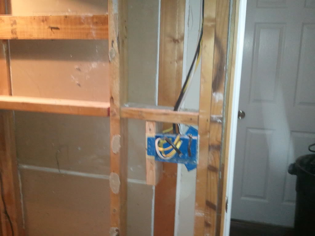

    Put in a triple gang box. separate switches for cans, vanity, and fan.
    Here's the wall shimmed out

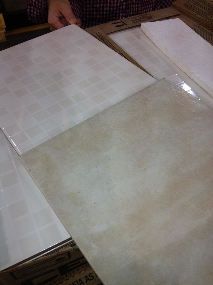

    Here's the comparison of the floor tile and the wall tile

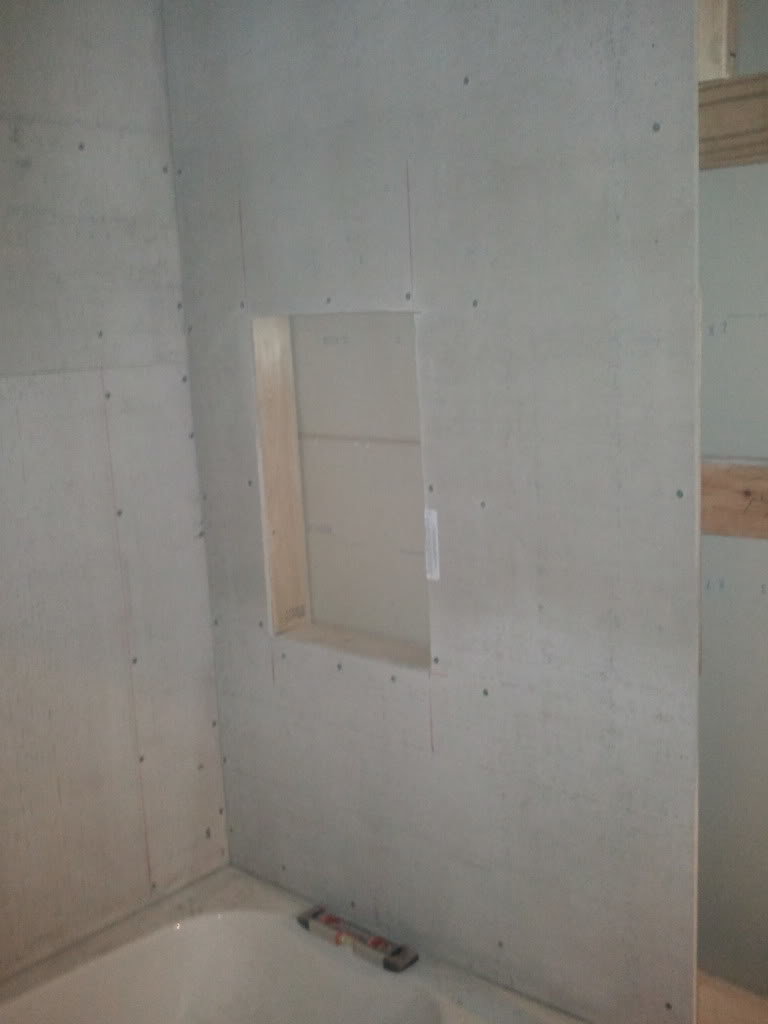

    Worked on the bathroom again yesterday for about 12 hours. I got a decent amount done.
    Since I was adding an additional layer of 1/2" subfloor per the recommendations from the guys over on the Johnbridge tile forums, I needed to re-do the toilet flange since it would sit too low. I cut off the 4" riser, added a coupler, and added a longer piece of 4" pipe so the toilet flange will sit higher. Once the finished floor is done, I will cut the riser flush with the floor and install the new closet flange directly on top of the finished tile floor. Once the new plumbing was done, I re-patched the subfloor piece with a new piece of 3/4 ply with the face grain properly oriented. Then I added the new 1/2" ply on top of that.
    My girlfriend's dad came over and helped me hang the hardibacker for the tub surround and helped me hang the drywall on the ceiling. I did all the walls by myself. I also planned out where the shampoo niche will sit so it falls within the field tiles properly.

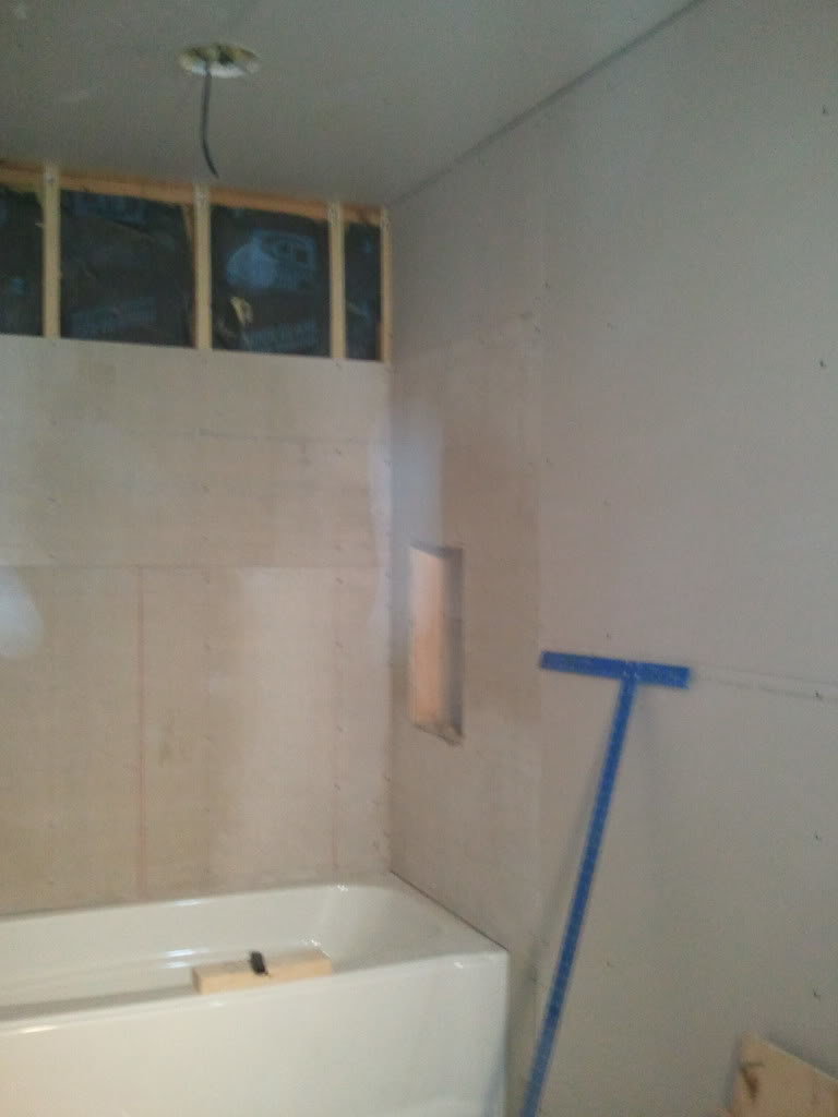

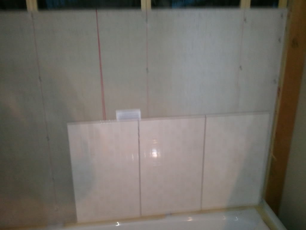

    The tub surround tiles will be in a vertical brick pattern. 5 of them fit perfectly across the back wall with no rip cuts needed.

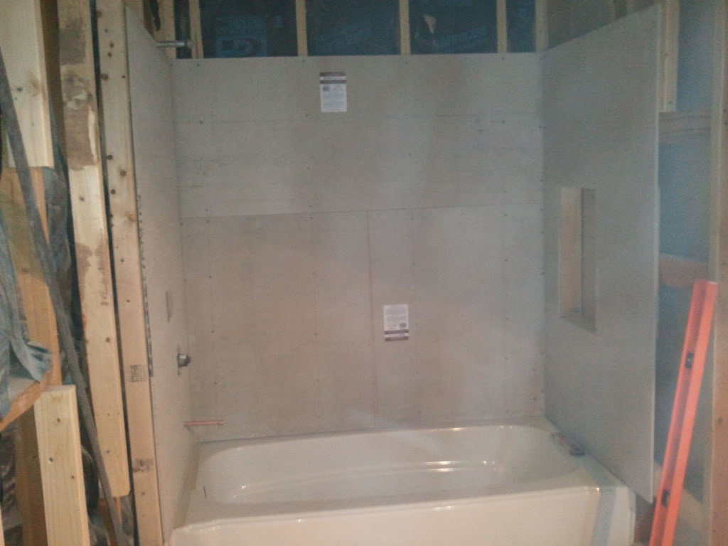

    Hardibacker going up, it will be waterproofed with redgard liquid applied membrane
    Shampoo niche, just need to add some hardi inside.

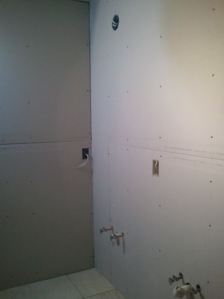

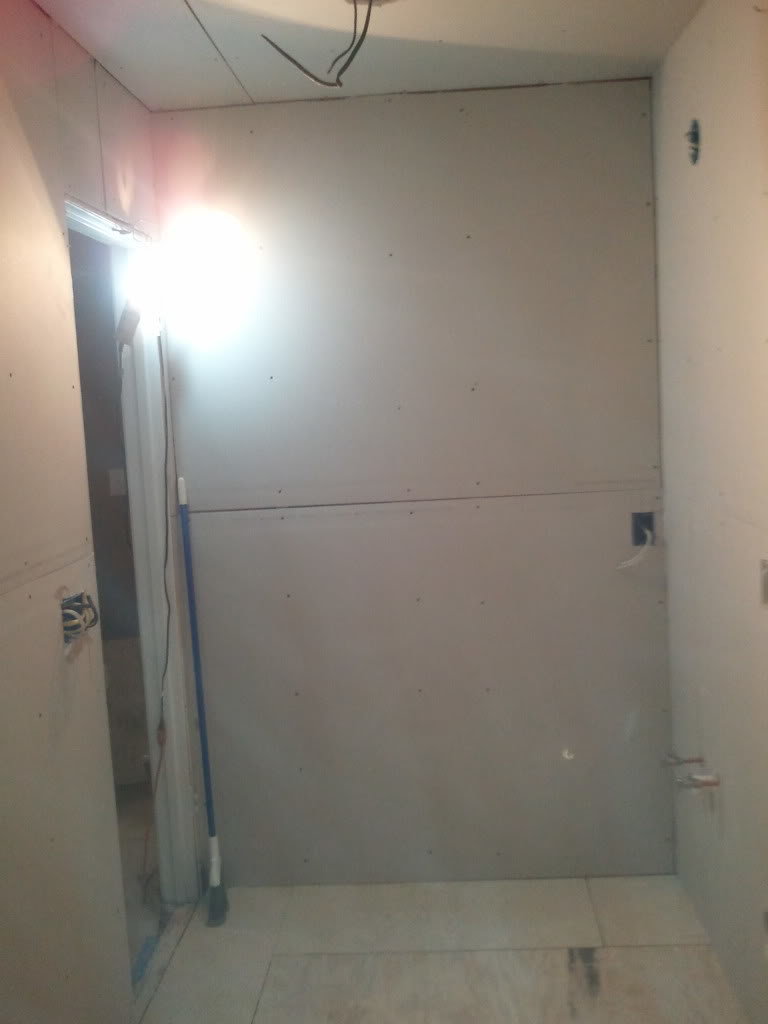

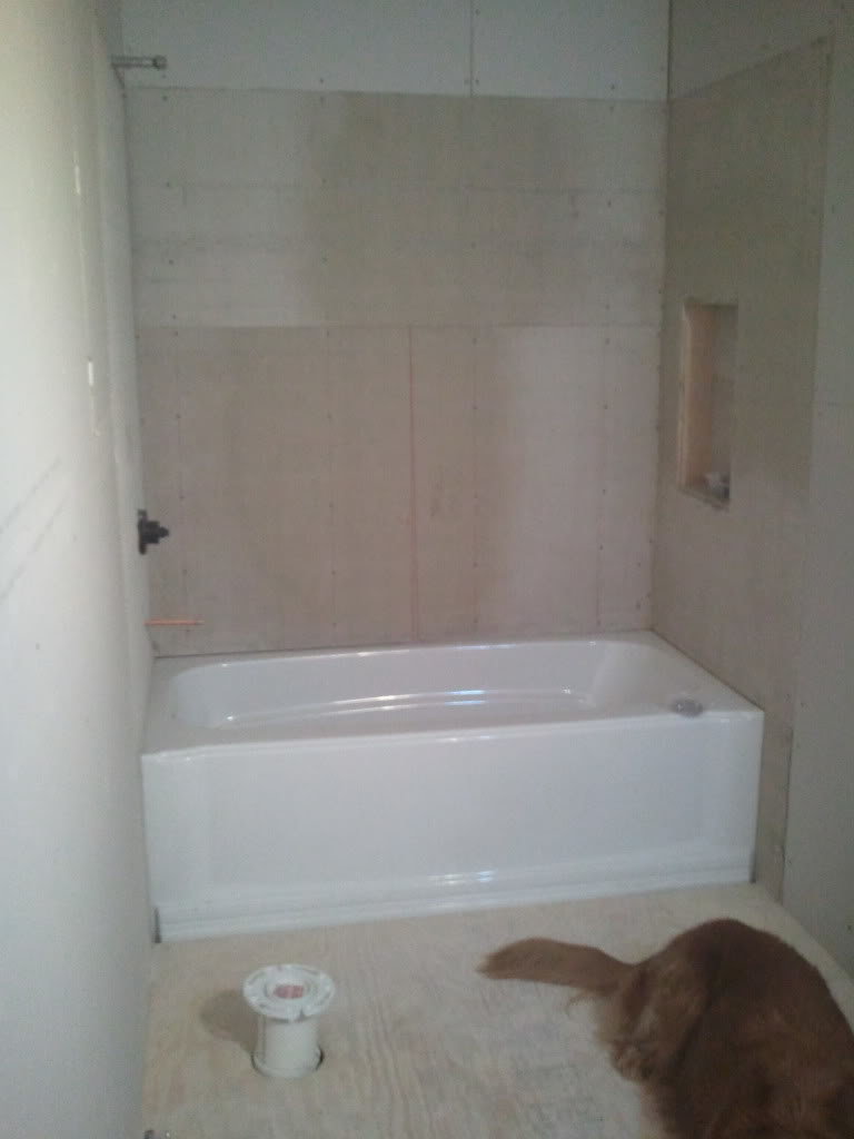

    Drywall done on the side wall

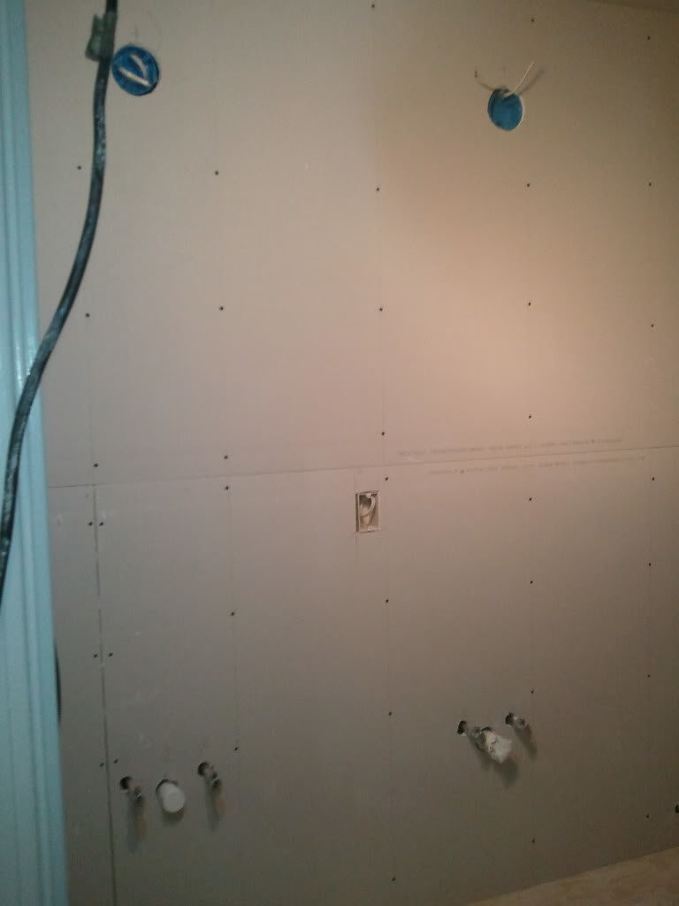

    Here's where the two 30" vanities will sit
    My helper
    The toilet flange isn't glued in yet so don't freak haha. Just put it there to plug the hole so it doesn't stink.

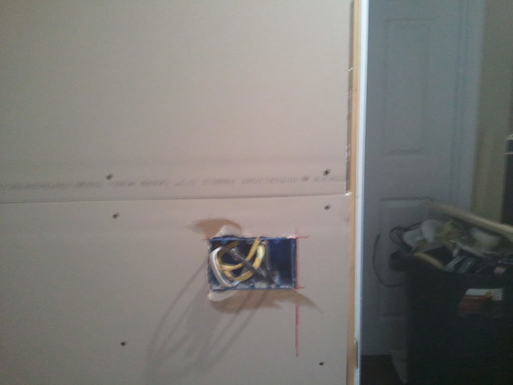

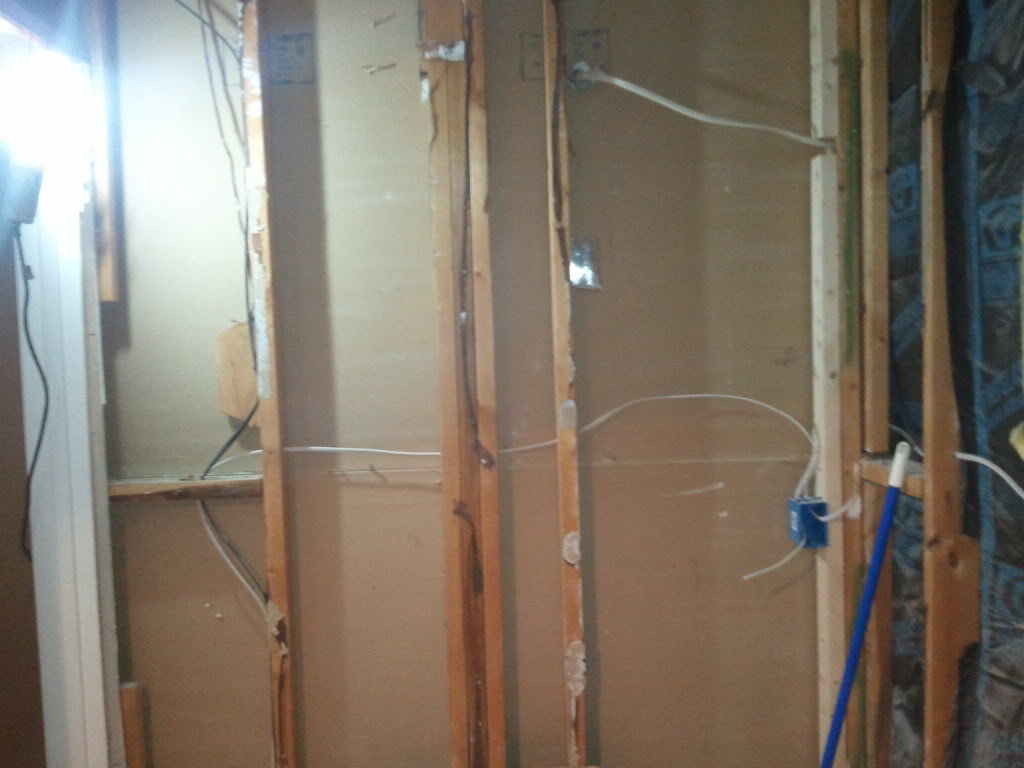

    Here's the triple switch box. Fortunately I was able to re-use some of the existing wiring hence why you see different colors
    There will be an additional receptacle (one for each vanity)

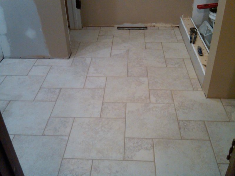

    Here is my tile i just finished.
    Next is the sink and then the shower.

    Nice
    We just did the same pinwheel pattern in slate at my job
