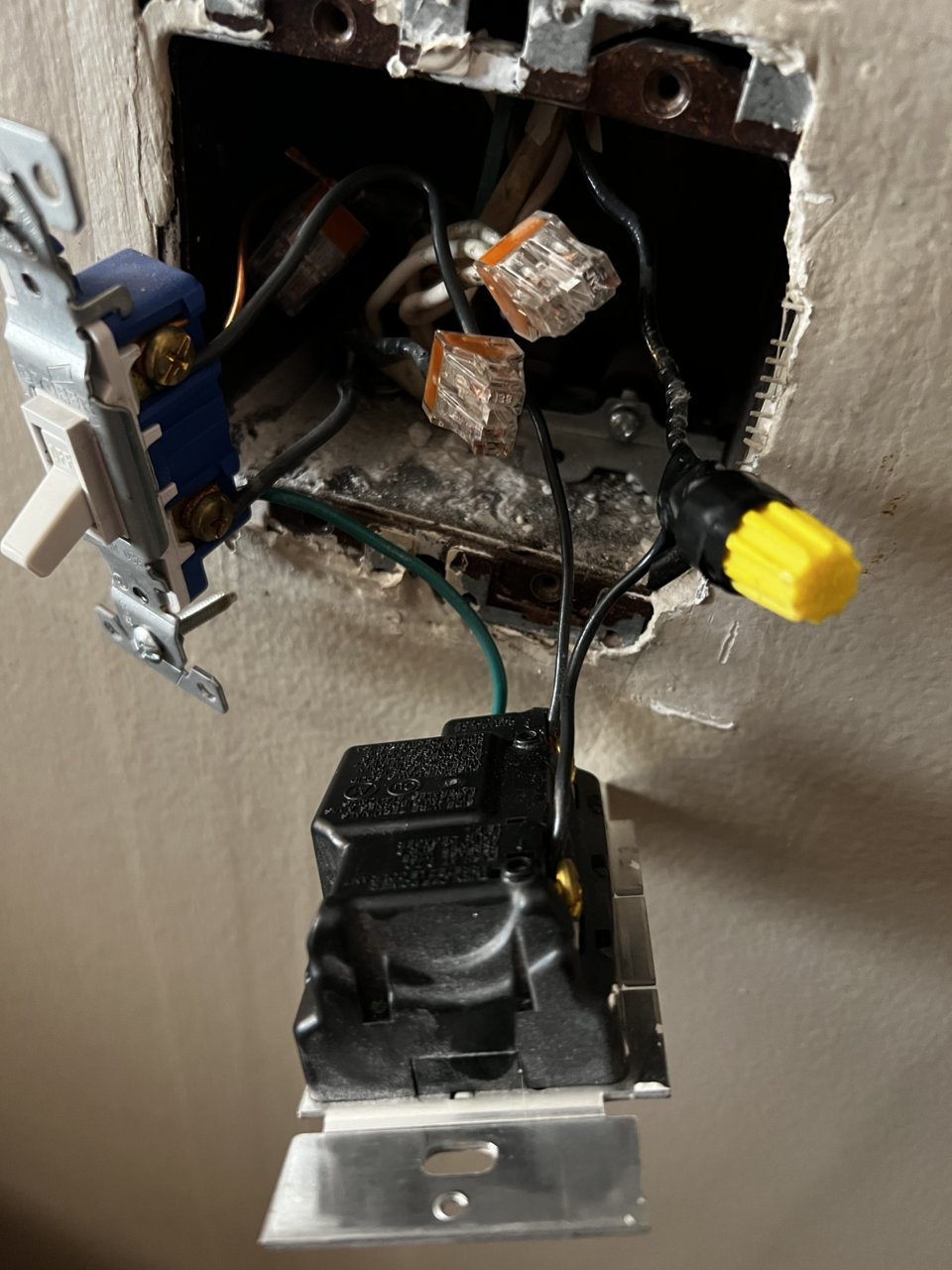

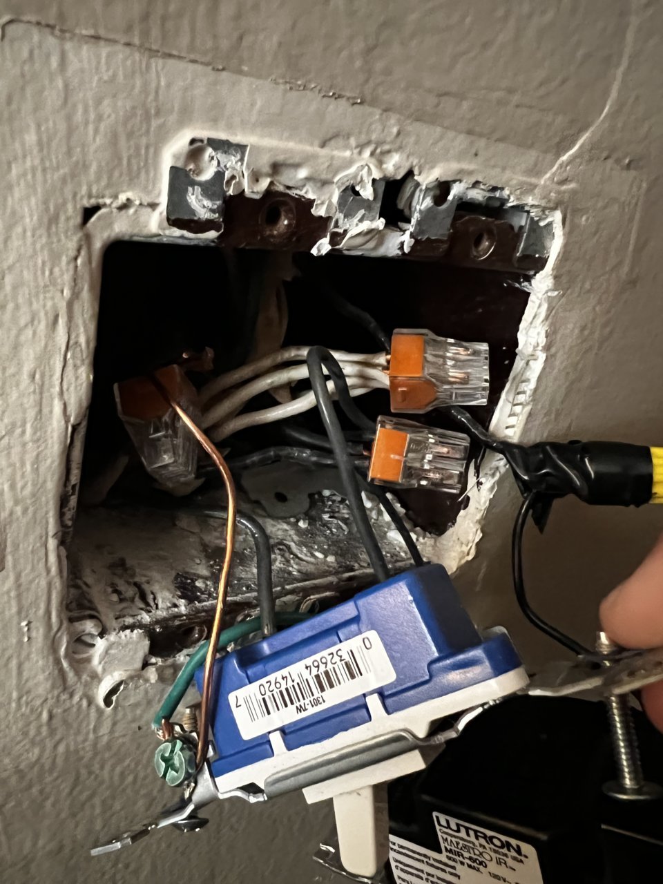

    Looks like a hot line coming into the orange wire nut, a hot line coming out and continuing on, hot line going to standard switch, hot line to dimmer switch. 4 neutrals tied together.

    That is what I kinda figured as well, I want to change it to 2 regular switches..any ideas?

    Remove this line from the wire nut and put a jumper in to go from wire nut to the new standard switch. Then connect the other black wire in yellow wire nut to other side of new switch.

    take the wires off of the dimmer and attach them to a regular switch

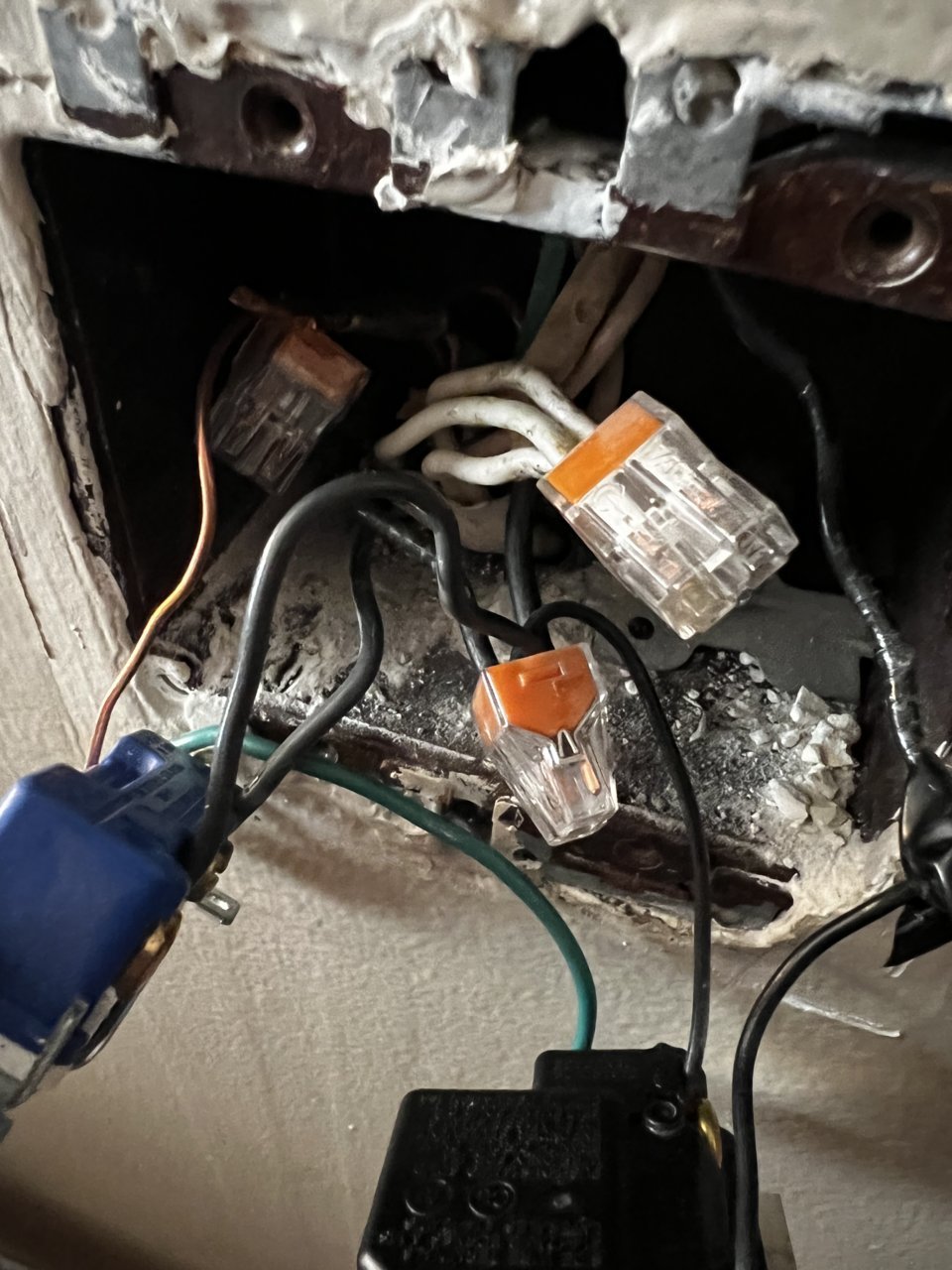

    Looks like the push connector for the ground doesn't have enough ports so they goobered in a ground by connecting the dimmer(black) ground to the switch(blue) ground.
    1. If it were my house I'd get some Wago 3 port connectors. Pull the goobered ground apart and run a separate ground line to each switch.
    2. Why is the electricians tape running up the wire from the yellow wire nut? Did they just get carried away or is it covering a damaged wire?
    3. If the wire is OK just remove the dimmer and yellow wire nut and swap in a regular switch.
