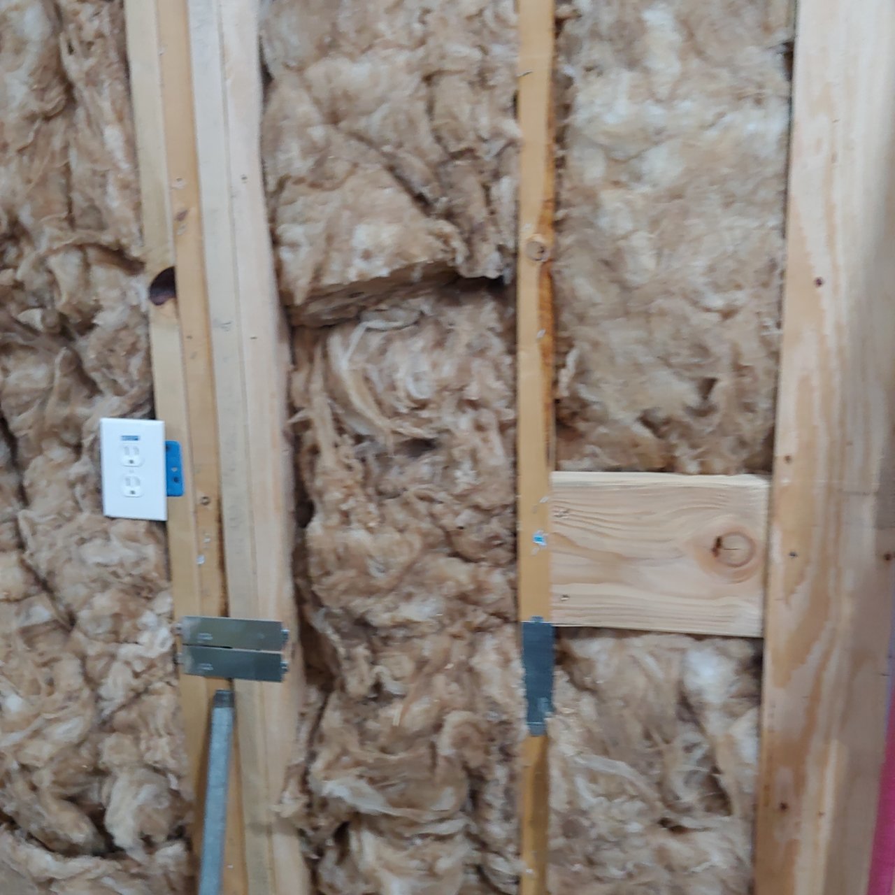

    Hanging plywood panels.
    Any tricky tips on lining up and cutting holes for outlet boxes?

    I assume the outlet boxes are pre hung? I measure from the closest board and pre drill a 1" hole. Then once its hung, flush trim bit on a router with a bottom bearing. It rides in the electrical box for a perfect fit. Just make sure you push the electrical wires deep into the boxes.

    New build? Basically like drywall guys, mark the location and use plunge bit to route the holes out

    I usually just try my best to triangulate where it's at. Measure from the floor up to the bottom of the box, from the previous piece of plywood over, from the ceiling down to the top of the box, etc.

    In this case, I'd pull the faceplate and outlet from the box, measure from the center of the box to the panel on the right. If your leaving a small gap between sheets, make sure you account for that. Also, pull a line straight down to the floor to give you that measurement. Mark your plywood at the same spot and drill your hole. Make sure you push those electrical cables deep into the electrical box. Set the depth on your router making sure that the bearing has clearance below the plywood. Hang the sheet and then route the hole. If you're mounting flush, then you'll want to swap out the bearing for one that's about 1/8-1/4" smaller than the diameter of the flush trim bit. I hope that makes sense.
