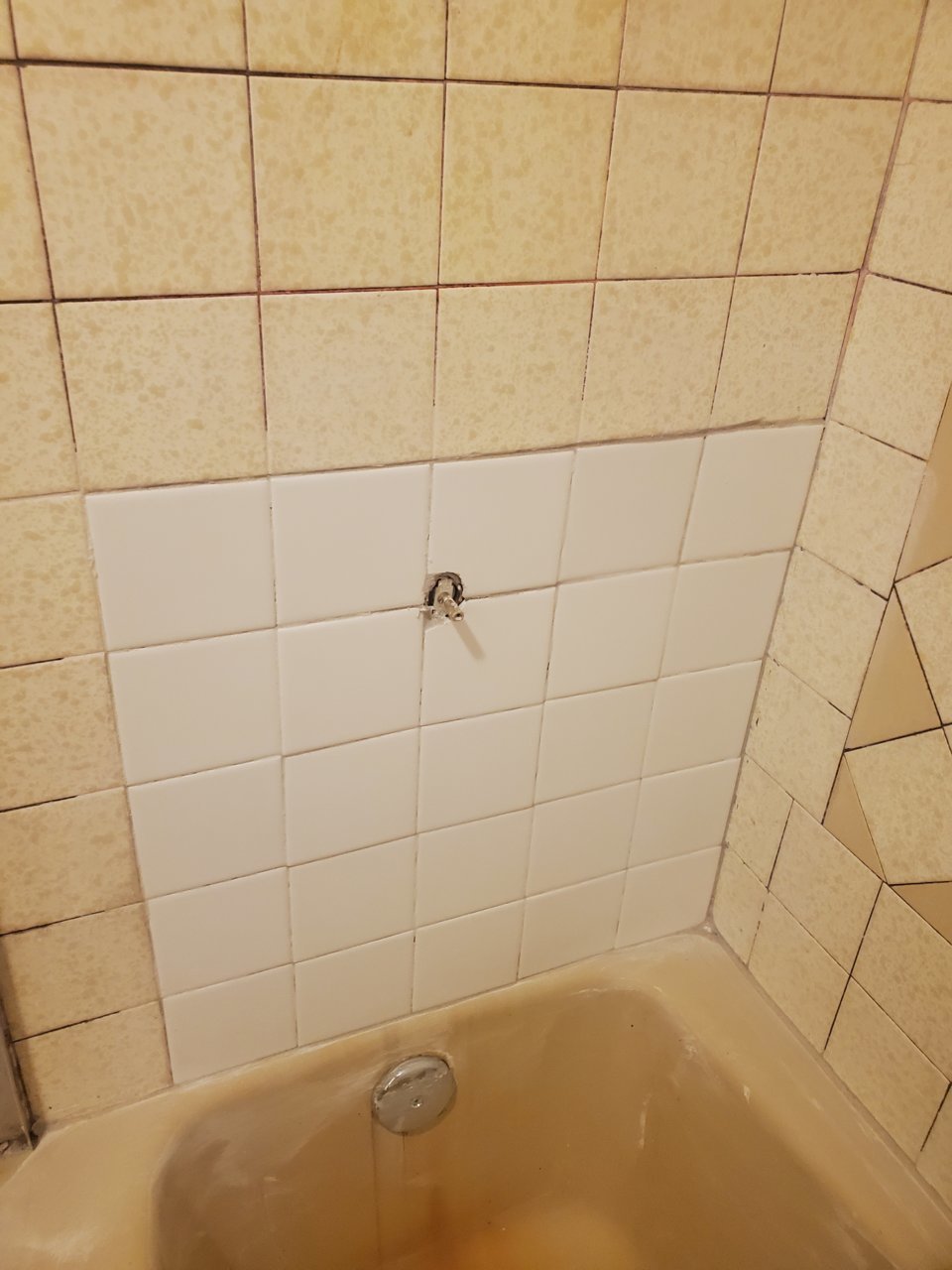

    CALLING ALL DIY PLUMBERS!
    I had some plumbing done, and unfortunately they had to break alot of tile due to the previous patch job being crap. Had to get a tile guy last minute, and this is what he did. Plumbers are supposed to be back to add Moen Trim pieces, but my wife can wait, and after watching youtube, it should be pretty simple. Only thing is, it seems that the tile guy didnt leave much room for installation? Im at work right now, but here is a photo. Any tips, or ideas. Its a simple Moen single handle replacement. Please excuse the horrendous tub/tile work. We are currently remodeling this old home little by little.

    Should be just the two screws for the backplate then the handle and screw

    Thats what i saw, but looking at this photo, i dont see where those screw holes are. Im thinking the tile guy didnt leave enough room? Or maybe i just saw so many videos with a lot more space that this and im comparing.

    You might not know if you have enough space or not until you can hold the escutcheon up to the piping and see for yourself. The wide variety of escutcheons and their mounting needs kind of doesn't let us give you any advice from our armchairs.
    Did the plumber use the correct mixing valves for your handle?

    This, id say its tight fit, screws would be on either side of handle. But there are tons different styles. Might be ok, you'll have to wait to get home.:fingerscrossed:

    Yea, contacted Tile guy, he said there should be enough room, but he will come later today just to make sure. Ill be home in about an hour and take a closer look. Ill update then. Thank you for all your input!

    Yup, tule guy going to come to open this up. No room for hardware. And need to clean up grout.

    You'll want a little extra room anyway in case you need to get back in there and replace the faucet cartridge. If you hold the face plate up you'll get an idea of how big you can go on the hole of course depending on how much space you need too.

    This is the access you need

    Yup! This is my first experience with plumbing, so I thought this tile guy knew what he was doing. They left s plastic cap on that has the same size hole you posted, not sure why he took it off and did this. He's coming in s bit to fix it. Thanks guys. Next time, I'll attempt to do myself. Atleast the tile work.
