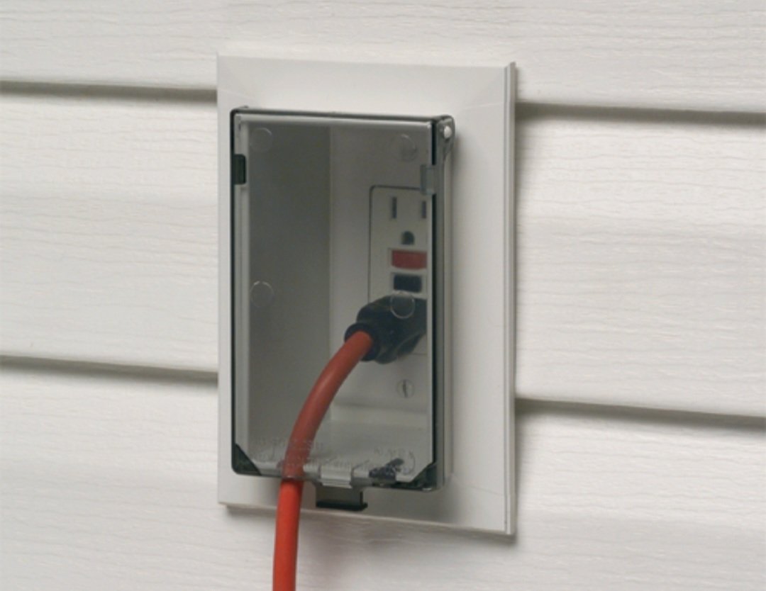

    Only the outlet upstream needs to be GFCI, as long as this one is wired on the "Load" side of the GFCI. GFCIs do not like weather. Always try to keep them inside.
    Even in my garage, I have to replace the GFCIs once in a while.

    Why not wire the GFCI upstream and put a regular outlet outside? :notsure:

    these are cleaner looking

    :thumbsup: That's the ones I linked above but for a flat surface as opposed to lap siding.
