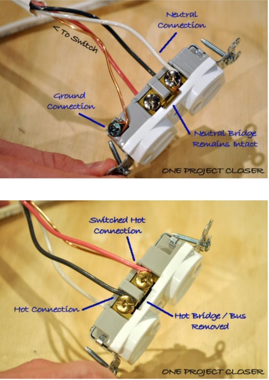

    My condo had the half hot half switched outlets in the living room & both bedrooms, no ceiling lights. It actually made it easier to install the recessed lights because I used the switched wire to control the new recessed lights. That switched wire was already run overhead so I just snipped it & ran it to the new ballast. The outlets got replaced anyway so both plugs were always hot.

    My living room is like that and I plan on taking the switch out of the equation and just wire nutting the wires all together for the plugs. Just haven't done it yet.

    Just replace the plugs? To make it half hot they just snipped the tab which opened the circuit. New plug wired in there will have both plugs hot. Then just cap the wire from the switch & leave it in the wall if you don't use it for something immediately.

    Maybe mine is different then? They are single outlets and either the top or bottom port is hot all the time and the other one is hot only when the switch is flipped.

    I'm pretty sure we're saying the same thing. To make the outlet switched they snip the bus bar, which disconnects the 2 plugs from each other to make them independent. Then they run an always hot line wire to 1 plug & a switched load wire from a wall switch to the other plug. If you replace the plug with a new one & leave that bus bar intact, then you just need to hook up the line wire to the new outlet & it'll power both plugs. The wire from the wall switch to the plug is no longer needed & can be capped. Or in my case used for overhead recessed lights controlled by that same wall switch.

    I think it pops breaker since its back feeding into the flipped switch
