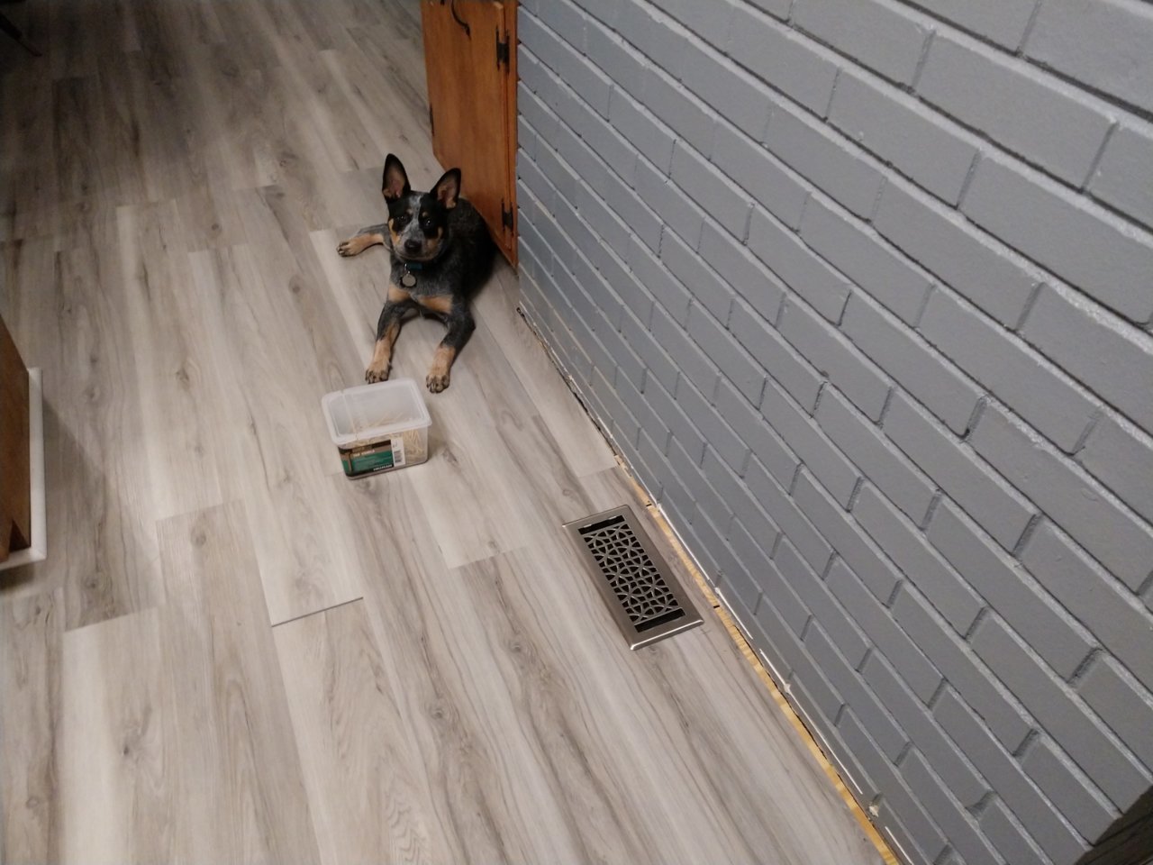

    Just got done. Far from perfect, but I made sure to plan the last piece (hardest) to go under where Im moving the fridge to. Glad I did, cause it looks like shit lol. But once the fridge is in, and I get a suction cup thing to close some gaps (gotta slide the entire row of planks in from the wall, as I gotta bit carried away with the hammer) it will look like nobody was ever there.
    Bucket of nails is covering a spot that needed a little glue. Stupid dog came by and scratched at the vinyl after I was done, ripped a little piece of the print off. :mad: Thankfully I caught it and was able to glue it back down.
    All this started cause I wanted to put that duct there. :rolleyes: Shouldve been an easy job.

    You'll find that Heeler puppies will chew or dig out anything that isn't nailed down. Indigo, our male, chewed a plastic car seat anchor cover when we had him in the back of the wife's Highlander without a crate. :rolleyes:

    Yeah shes a digger. Always finding random crap buried in the backyard.

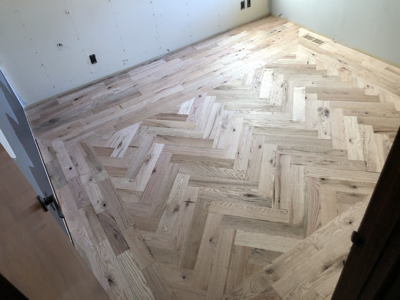

    Finally got around to finishing the floor. Things are moving at a snails pace now that I'm working on building my dream shop + my stair parts are taking up a bunch of room... so I guess the stairs are kind of taking priority.
    A couple of weeks ago the floor was flattened, trowel-filled, and then finish-sanded up to 120 grit.
    I decided to do a final 120 with my palm sander. Overall it gets a better finish than any of the big machines. Plus getting your face 3" from the floor helps you see if there's any other grit marks and whatnot. It came out really clean.
    Fast forward to last night. The floor kind of just sat for a couple of weeks while I waited for a pre-color stain to ship out. Remember the floor was made out of factory seconds. They were beat up and a they're a mix of red and white oak. To neutralize the reds in the red oak and kind of make the floor more uniform, I pre-treated with Rubio Monocoat Pre Color Easy Mint White. The green in the mint neutralizes the red because it's on the opposite side of the color spectrum. It's a water-based stain, so you have to work in small sections with tape, skip around your sections, wait for it to dry, tape off the dry sections, and then proceed to the sections you skipped. It helps prevent lapping since the stuff flashes really fast. You can get a feel for how we did it in a small 100 sq ft office:
    I'd say it made it more uniform. The look I'm going for is a very pasty almost ghost-white with cream grain.
    So I let all of that dry fully; overnight. Then this morning I got up and applied the top coat. For this I chose Rubio Monocoat Oil Plus 2c in Cotton White. The Cotton White is kind of cream colored, and I figured it would give me the look I'm going for without washing everything out to just look like a piece of paper. I couldn't really take pictures during the process because you hand-trowel this stuff on, buff by hand, and then wipe-off the holy hell out of it. So here's the finished product -- sorry for the awkward angle. My camera doesn't do it justice; it wants to darken everything or blow-out the details. Doesn't help that the room has 1 window and 1 tiny pod light. In person it's probably 2-3 times more white and has some depth to it.
    Here are some close-ups of the grain. I think this cerused effect is so cool for some reason. I think the close-ups give a better representation of the floor without blowing-out the photo lighting and detail:
    Not bad for $1/sq ft boards. I spent more on sand paper and finish than the boards. Labor hours... I don't even know. 50? 60? Finally get to move on to painting the ugly walls and installing my cabinets!

    i missed this one. Looks great

    That floor looks amazing!!
