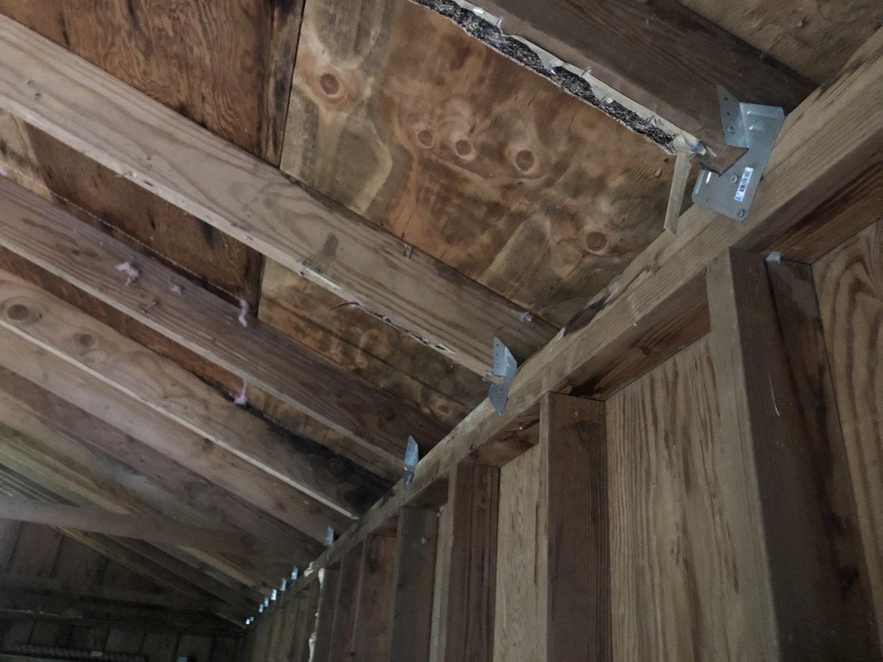

    Making head way on getting my footings poured. In the meantime, I’m starting to run some ideas by our engineer regarding ceiling joist and rafter tie design to take load off of the old barn wall we are removing. When the previous owners started on this outer wall, it looks like he inverted the second top plate in order to keep the roof pitch the same on both sides (building is on a slope).
    Here is how the original outer wall meets the rafters — pretty classic:

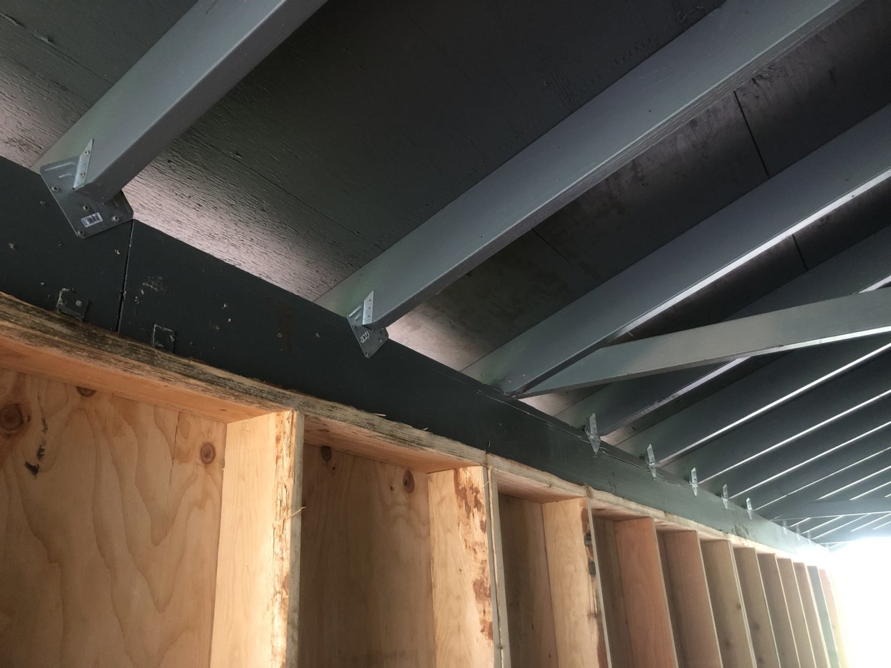

    Here is how his new wall meets the new rafters from the roof extension:

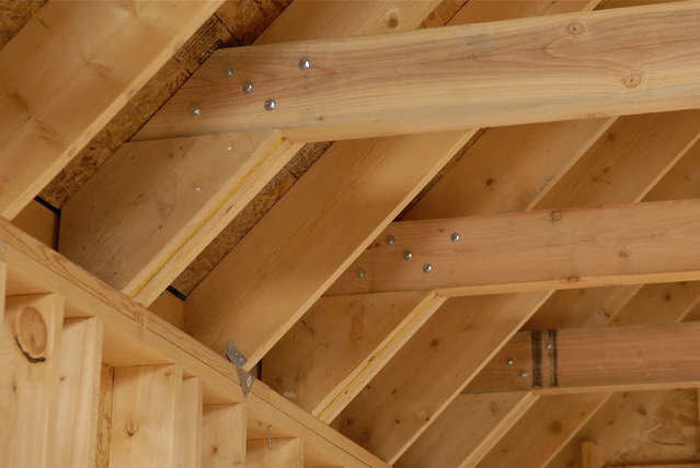

    I kind of like this design for adding structural ceiling joists — it puts the joists higher so I keep more head room:
    In order to do that, it looks like I’ll have to get rid of the hurricane ties to get those blocks nice and tight to the rafters. I’ve heard you can replace them with timber lok screws. Any idea how I’d fasten those screws to the inverted top plate (or whatever it’s called)?
    Another option is to be more precise with my ceiling joist cuts and do something like this — a retrofitted truss — but I think it might be too far up into the second third of the ceiling for my shallow roof pitch:

    in the second pic where previous framer stood top plate on edge , is there nothing outboard of that standing plate ? ie is the plate a 1 1/2" thick hinge the roof system is bearing on ? Or do you mean there is another set of rafters tied into that standing 2x6 on the other side of the wall ?

    Nothing on the other side — that’s the end of the wall. The board that’s on end is actually a 4x6. I’d be pretty sketched out if the whole thing was balancing on 1 1/2” of material :rofl:.

    your engineer will likely have a solution but you could run 3/8" GRK RSS screws through the lower plate into the 4x6 and then use Simpson A24 or similar on the sides of the rafters to connect them to the 4x6 and lose the hurricane anchors
