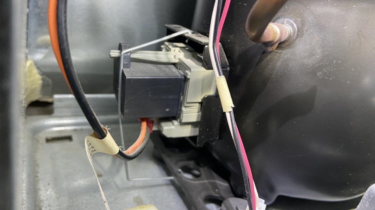

    Any appliance techs on here? have a ge cafe fridge that i hear click on and off in the back.
    Fridge is cooling but about 10-20 degrees off set point at times.
    Can this be the run capacitor?

    check fan for operation, make sure nothing is blocking the cross over from freezer. Usually quits cooling if its the start relay. How old is fridge?
    https://products.geappliances.com/appliance/gea-support-search-content?contentId=21185
    asuchemist[QUOTED] and Drainbung like this.

    Fridge is from 2016.
    its either this part
    WR07X10131 GE Overload or this part GE WR55X24064 KIT CAPACITOR 12 uF
    Man i wish I had a working multimeter.
    Thanks for response. I opened up the back and doesn’t look to difficult to pull the start relay out (i like plug and play).
    yup it was the start relay. my cousin spliced one in and it fired up. gonna put in a new part tomorrow once it comes in.
    Thanks.
