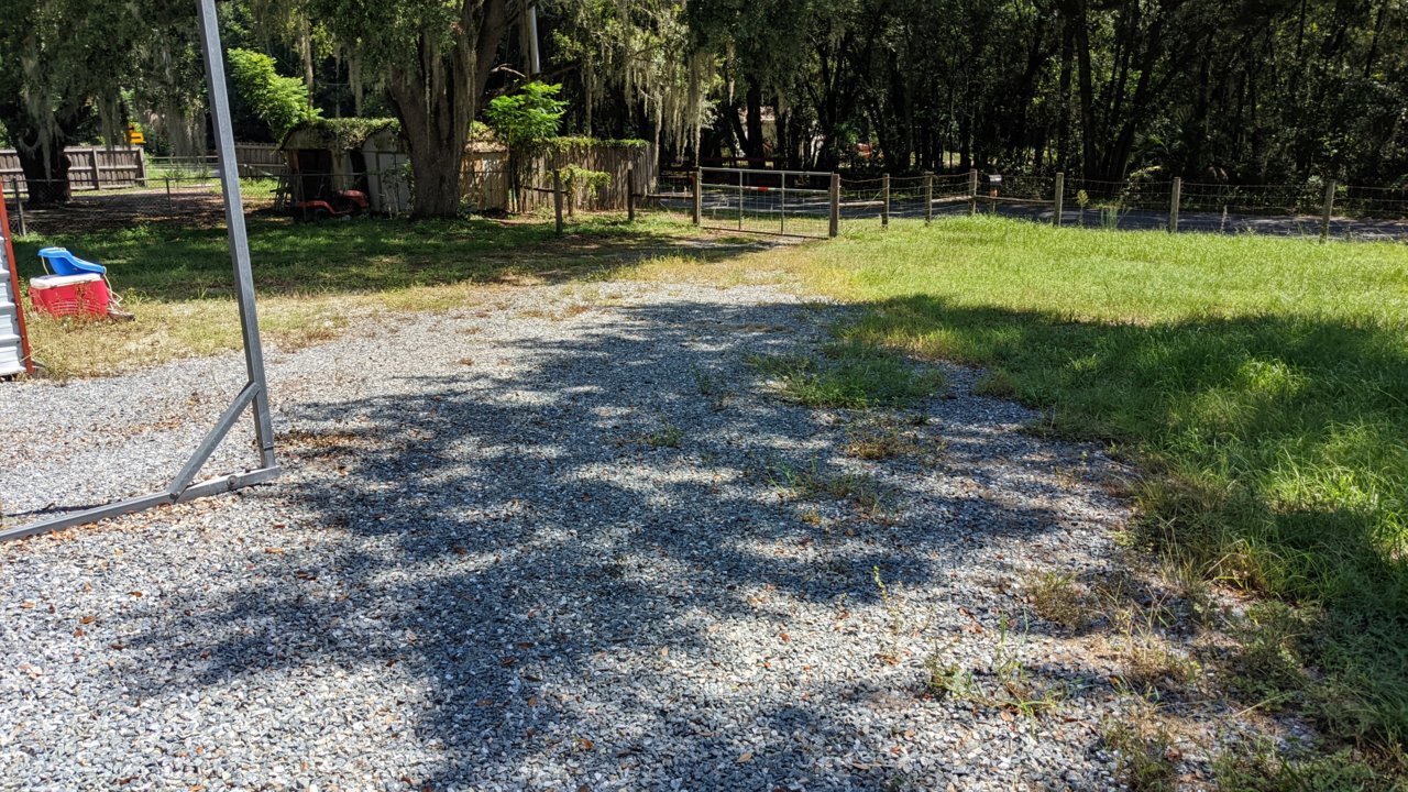

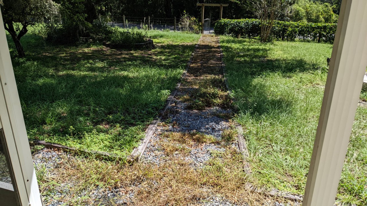

    So these were about the only pictures I could get, it's been storming off and on and dark and gloomy when it isn't coming down.
    I could see noticeable results on some stuff after just 24hrs, at 48hrs some things were already D E D dead, a couple plants are straggling, but ultimately I think I need to retreat with something a little less discriminatory.
    Roundup attacks the way weeds process their food but doesn't kill "grass" because grass processes food differently, apparently, however a lot of my weeds is grass and a lot of my grass is weeds.
    I just want what's in my gravel drive, my trash can path and the beds around my house to be plant free is all so I need a more general Herbacide.
    Luckily in my cleaning up and organizing around the house in the last few days I discovered the previous owner left me 3/4 a gallon of just such.
    You can see in the first picture the stuff to the right of the AC is dead, but to the left is unfazed.

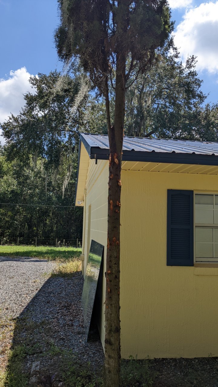

    I also trimmed up this pine tree that was rubbing the eaves with it's lower branches; chainsaw+6' A frame ladder is sketch.
    I've had someone tell me it's too close to the house and I should remove it, not sure I want to but I'm open to more experienced opinions.

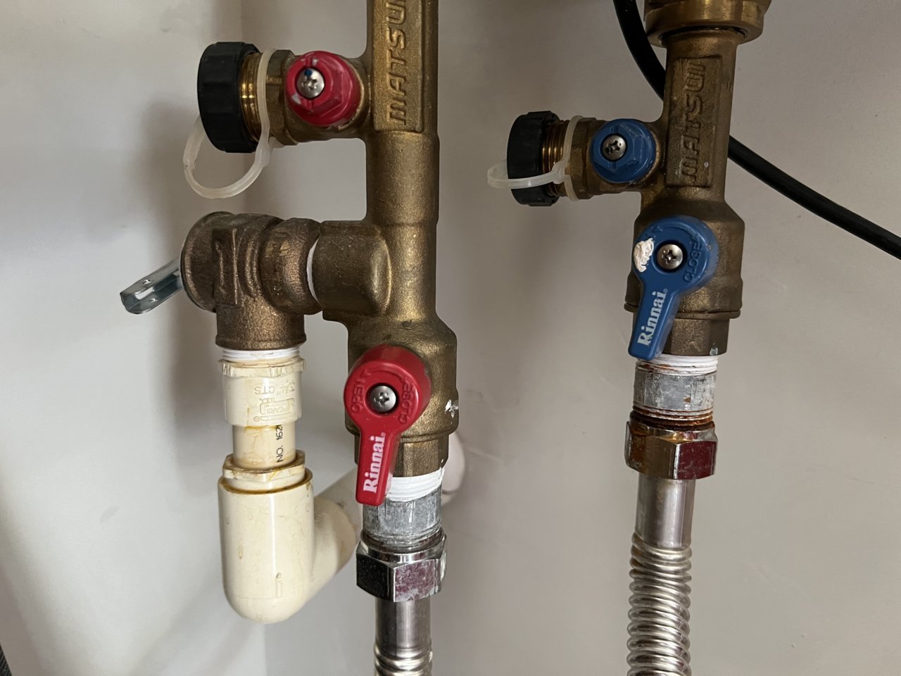

    I got brass nipples to replace the galvanized steel on there now. Is that the way to go?
    Tomorrow I'm going to shut off the water to the house and at LEAST replace the nipples. I also plan to remove the cold assembly and see if it's gummed up and needs to be replaced since it's relatively easy to do. I've got replacements on hand if it needs to go that way. If not, I'm going to apply some force to the valves with a wrench as stated in the instructions that came with the replacements.

    Brass is good. I like to keep a few of these Rinnai filter screens on hand as you're supposed to clean them after flushing, but I find them to be one and done with my hard city water.
    https://www.amazon.com/Water-Heater...ss+water+heater+filter+screen+,aps,124&sr=8-3
    Also, this flush kit and a few gallons of distilled vinegar is all you need. (What I use and Rinnai recommends distilled vinegar too.)
    https://www.amazon.com/Kelaro-Tankl...ush+,aps,129&sr=8-3-spons&smid=A2MBVPSPHH0UBM

    Brass works well, or black pipe. They do also sell threaded PVC nipples.

    Or chrome with the poly liner that usually come with a new tank WH

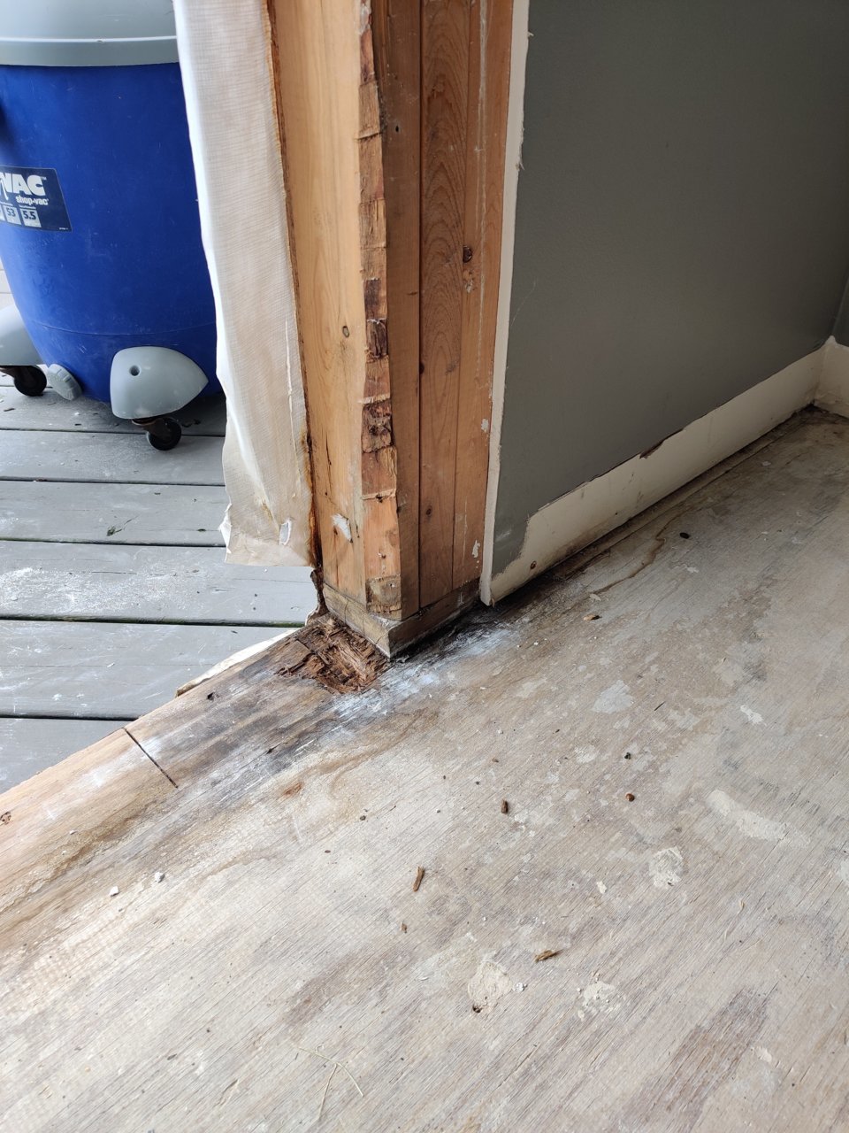

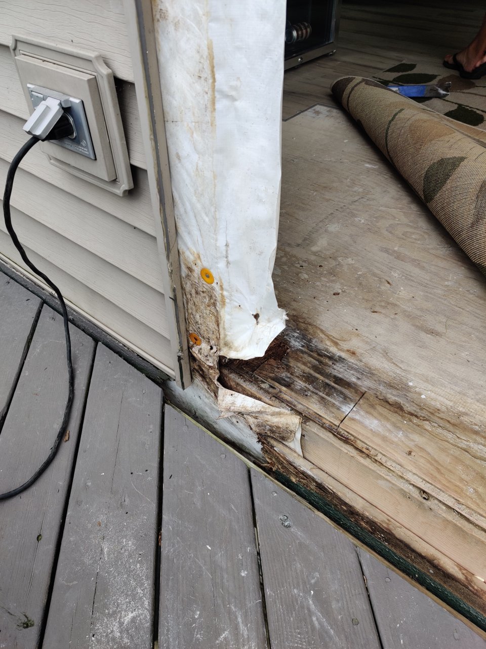

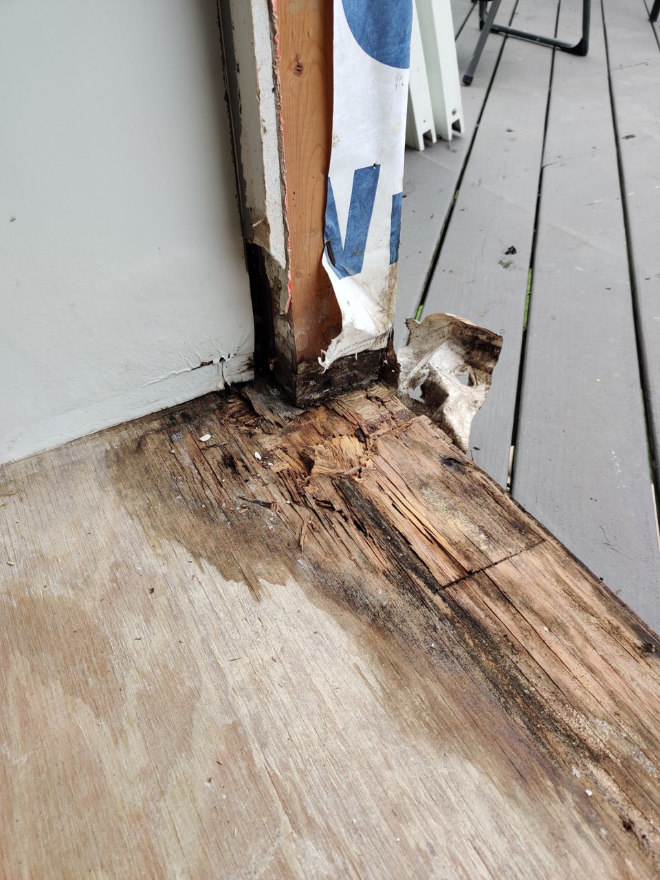

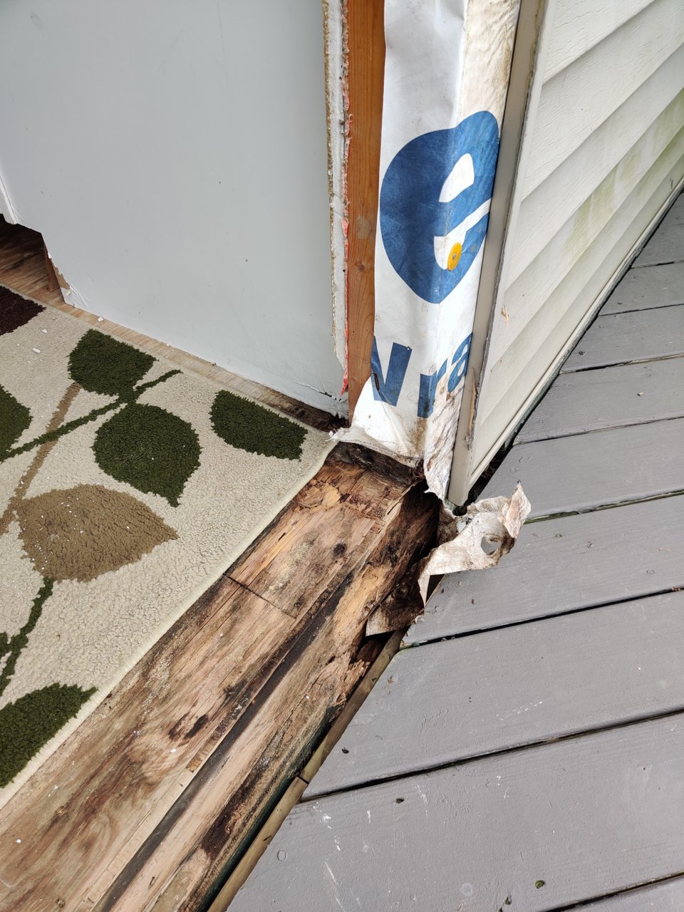

    Long story short, I was replacing our floor in the winter and found the subfloor to be rotted by our sliding glass door. So waiting until summer to take door out to inspect the severity.
    It's pretty bad. I already know that I need to take the deck down to replace boards.
    But my main question is how do I fix the subfloor underneath wall studs? Help me TW!

    I fear for your joists….any way you can get a look at them, especially the rim joist?
    You’re prolly not gonna like the fix :(
    How wide is the deck?

    Lots work but can be fixed

    If your referring to black iron pipe never use it in water systems. It corrodes at a faster rate then galvi. Brass, ABS and PVC are the correct ones to use. With brass being the best choice, IMO.

    Isnt black pipe just for natural gas/propane?
  18. Aug 20, 2022 at 12:45 PM
    theesotericone
    theesotericone Well-Known Member
    Jul 27, 2018
    #260800
    12,379
    Bishop CA
    Yep. It can't be used with potable water systems and galvi can't be used in gas supply systems.
    Black iron is not coated or treated. So it will rust very quickly in water. Since it's not coated there's nothing to interact with it in gas supply.
    Galvi is coated and will take much longer to rust. When used in gas supply that coating can flake off and clog the system.

    I think it’s for compressed gasses like you say propane/natural gas and compressed air.
    Copper, brass, stainless, pex, cpvc, hope, and galvanized are the ones for potable water, IIRC.

    Good excuse to buy some jacks :bananadead:
