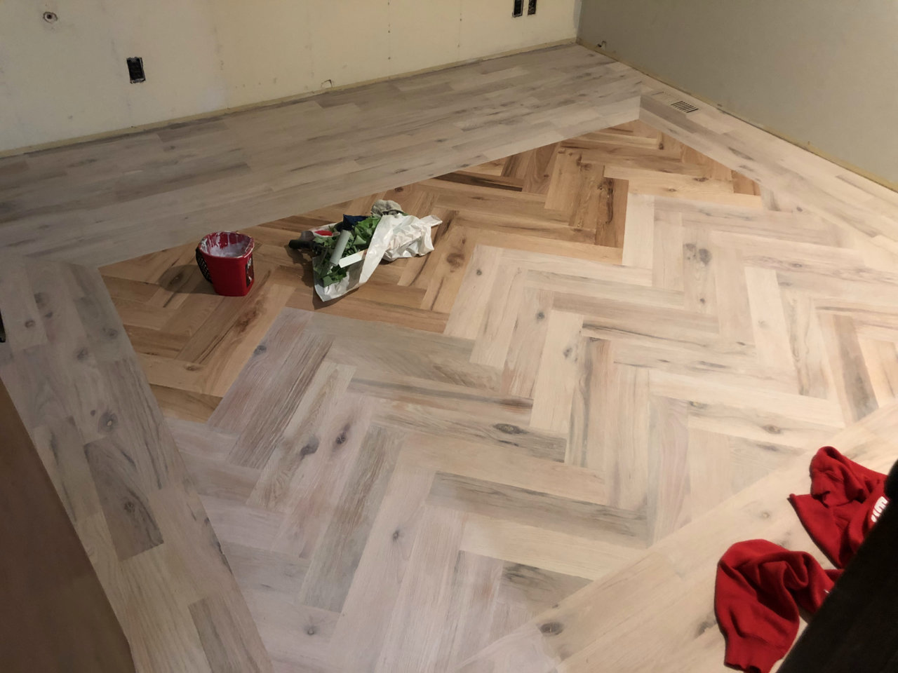

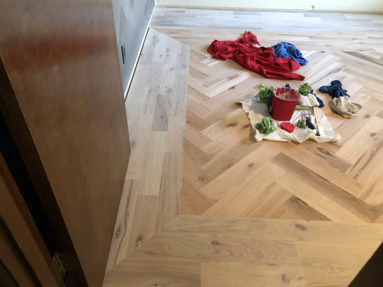

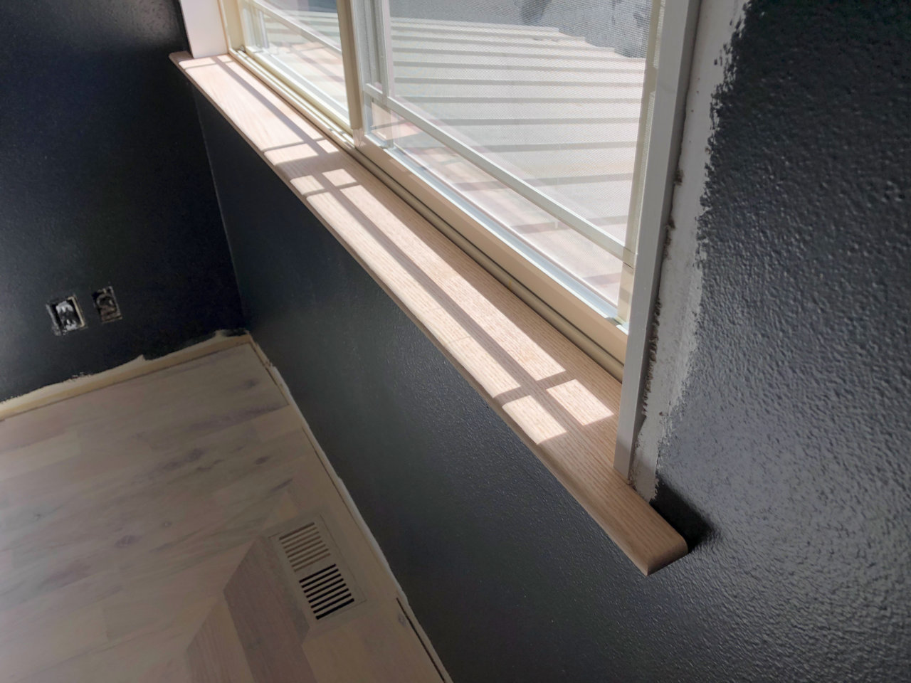

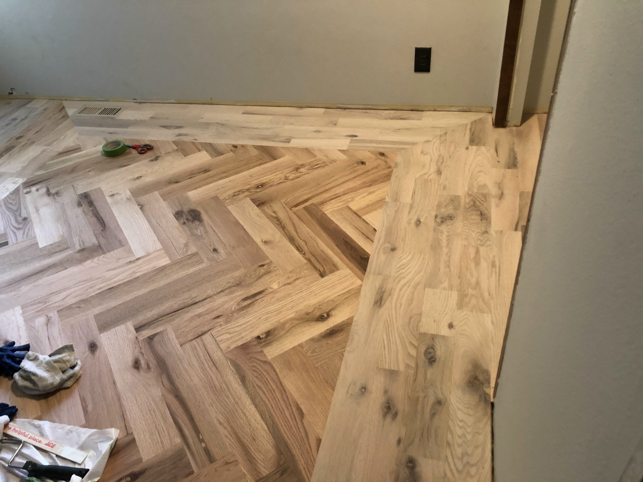

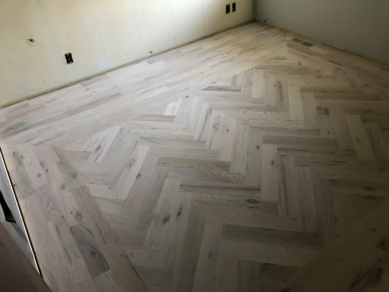

    Made some minor headway on the office.
    Finally got my carcasses moved upstairs and laid down the first coat of paint. Took me forever to get to the paint stage seeing as I had about 200 holes to patch and retexture after I yanked the slat wall off. I went with Sherwin Williams Green Black. Mind the lap map marks -- it's just the first coat. Cabinets will be the same color, just needed to mock-up the fitment before I paint those.
    I really wanted to recycle the whitewash floor element in the room somewhere, so I decided to make an extended window stool out of oak as a small detail. I started by yanking the old window jamb out... the rough jamb was pretty rough :rofl: It hadn't seen the light of day since the 70's.
    The old finished jamb was just held in by silicone and friction... I hadn't seen that before. Everyone I've watched do this type of work puts a nail or 100 for good luck.
    To get the length of my stool I made these little jigs that help me visualize what some of my pieces will look like when they're finished. I ripped two pieces of pine -- one to the width of my window stop (the vertical jamb) and one to the width of my window side casing + 3/4". The 3/4" is how far my horn will extend past the side casing. I marked a 3/16" reveal line on the side of the window stop piece and tacked my casing + 3/4 piece onto the mark at 90 degrees. I made one for the left side and one for the right because, of course, my window sills just aren't the same depth on both sides lol.
    The length of the stool is the distance between the ends of those two jigs. I just tacked them in with a single 1" brad nail each and ran my tape across them.
    The stool was made out of a single piece of 3/4" S4S oak from HD... I was in a hurry so I didn't do anything fancy with milling. I took a 3/8" round-over bit in my router and made a bullnose on the front and side of my piece once I cut it to length. You just flip the board over after you round-over one side and do the other, then you get a perfect bullnose on 3/4" material. This would give me a nice horn when I'm done without having to make some other mitered end and whatnot. Then I notched-out where the stool/horn will wrap around the sill and cut it with my miter saw and table saw. She fits pretty damn nice!
    All of the window trimmings other than my oak stool will be the same green black color as the walls when I'm done, but this is how it'll fit when I get my casing on.
    I'll paint the window trim and finish my stool tonight. I'll attach all 4 sides of the sill using pocket holes and mount it in one piece. There's some screws in the sill that I'm using as shims, so it should be self-centering when I go to install it. Just mount and tack. Then I have to re-trim my closet since it was trimmed for a closet door and I need to extend the jamb to look good when I do the built-ins back there. It's getting there slowly but surely. I have to finish all of the trim, paint cabinets and install, build an 11' wall desk, and do some electrical. Then I'll probably call it good for a bit.

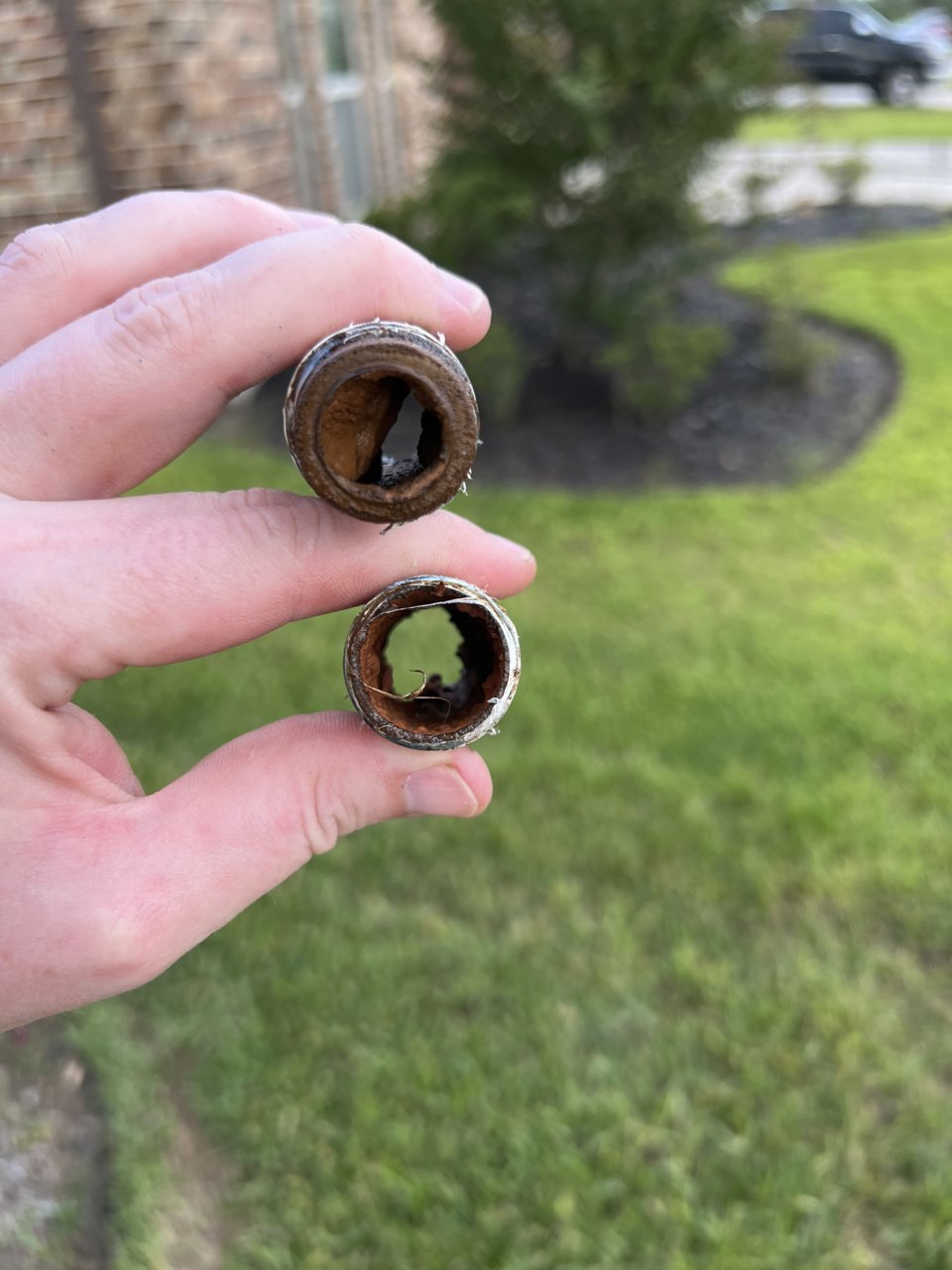

    That did the trick thanks. Manual said 5 wraps. After reading your message I got the hot on the first try but had to go to 8 wraps on the cold side. Good thing I got a new roll of Teflon tape!
    Yup that did the trick thanks!
    Here are the old nipples, cold on bottom and hot on top:
    Flushing is gonna be fun…
