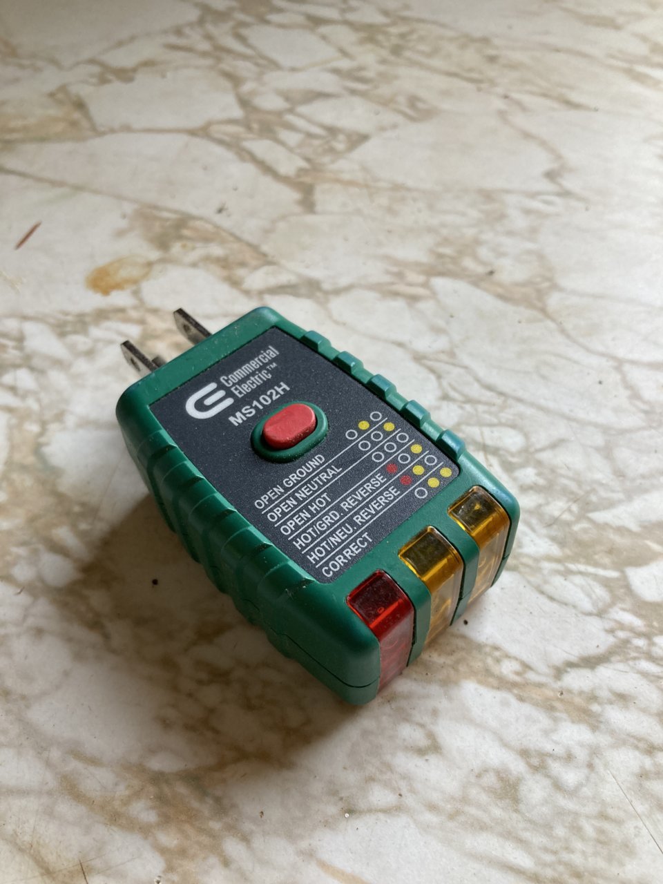

    There is a chance that the neutral and hot are switched on the outlet. Do you have one of these? They could also be wired in series instead of parallel if the refrigerator is further out on the circuit then the fridge might cut out on low voltage when the microwave is running. Why hasn’t the electrician run a separate circuit 20amp for the microwave?
