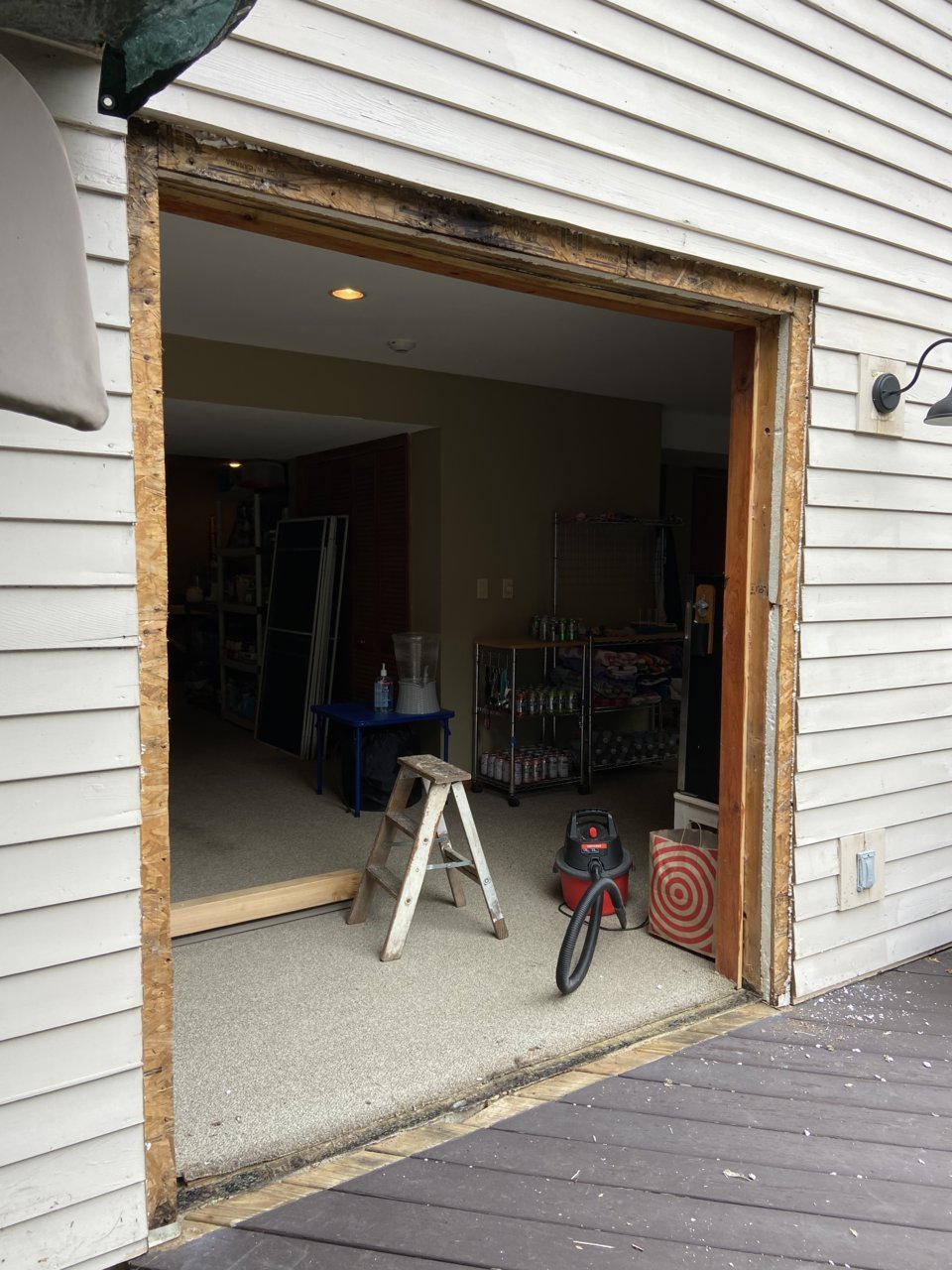

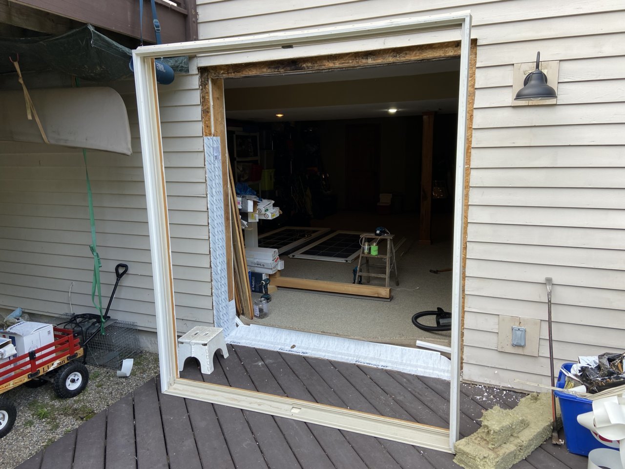

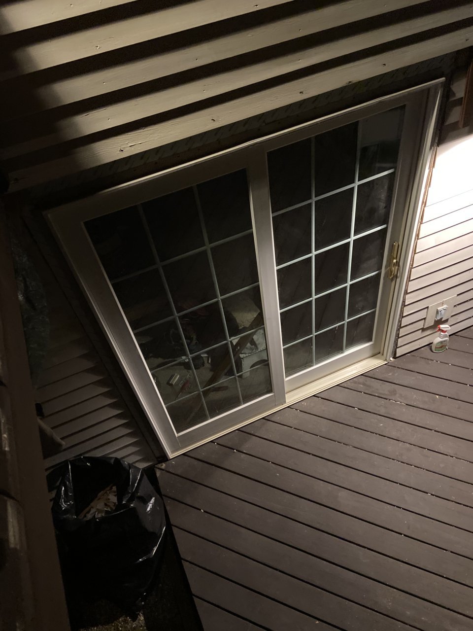

    My wife bought a Marvin Integrity slider on Facebook Marketplace a few years ago…
    Her-“Are we interested in this slider?”
    Me- “No thanks”
    Her- “OK, they’re delivering it at 10”
    In protest as much as just not being excited about replacing a basement slider, I’ve admittedly dragged my feet.
    So now I’m sick of tripping over the panels in the basement. Time to get this done.
    Remove old door, check square, flash opening, go to install new frame…nooooooo! Too big! How can a 6-8 6-0 patio slider be that different? Brands…old was a Hurd (now Sierra Pacific) and new is a Marvin Integrity. My bad for not checking.
    Remove a whole bunch $$$ of flashing, change RO, reflash and reinstall. Need to flash exterior tomorrow and replace trim and siding but the lions share is done!D230F22A-5619-47A7-B3D0-7EE43032D02D.jpg8D0384AD-7B14-473A-A141-CB56C2C490F5.jpgA44E71FC-33B3-4B4E-863B-96BD58052B79.jpg
