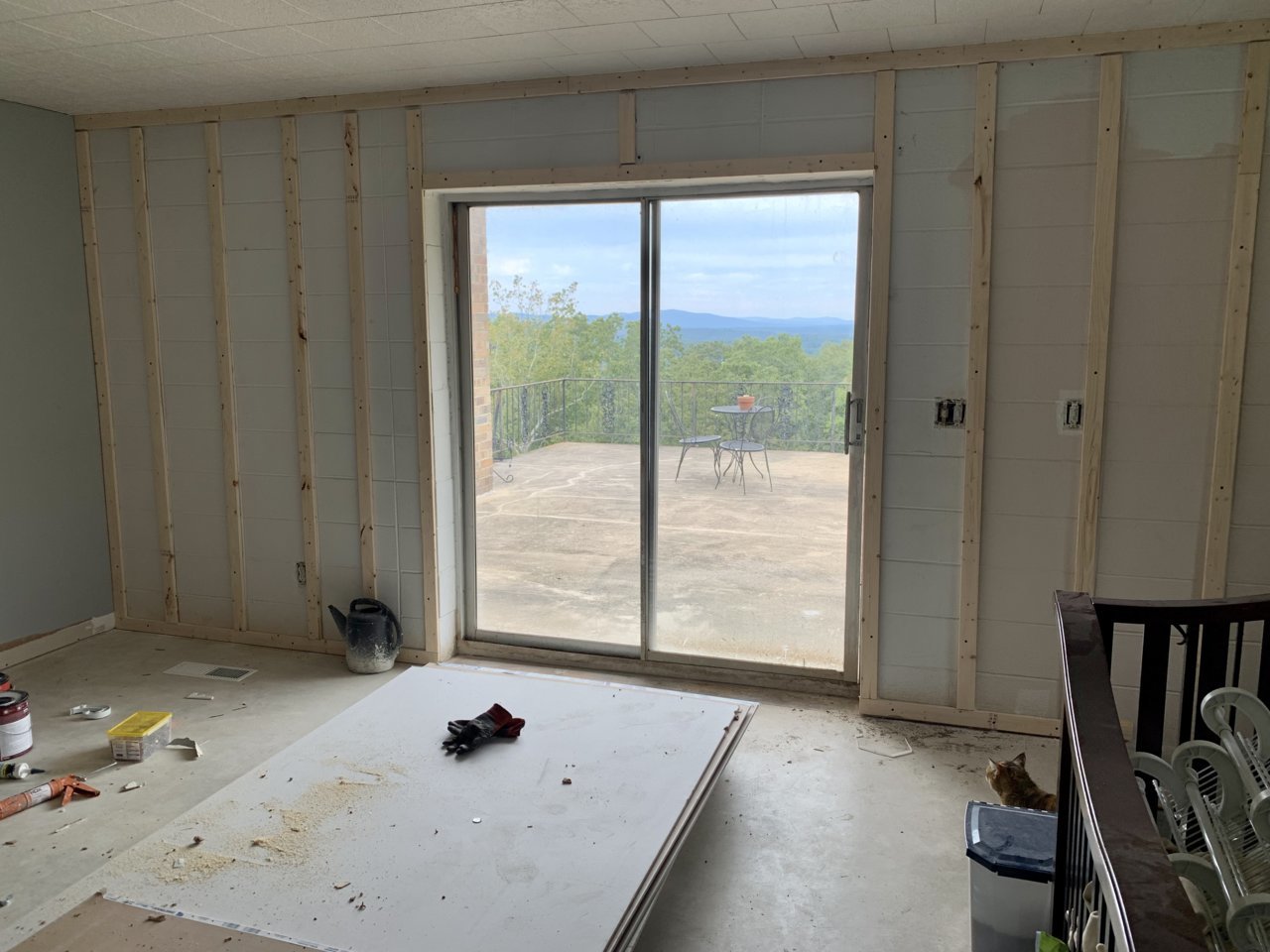

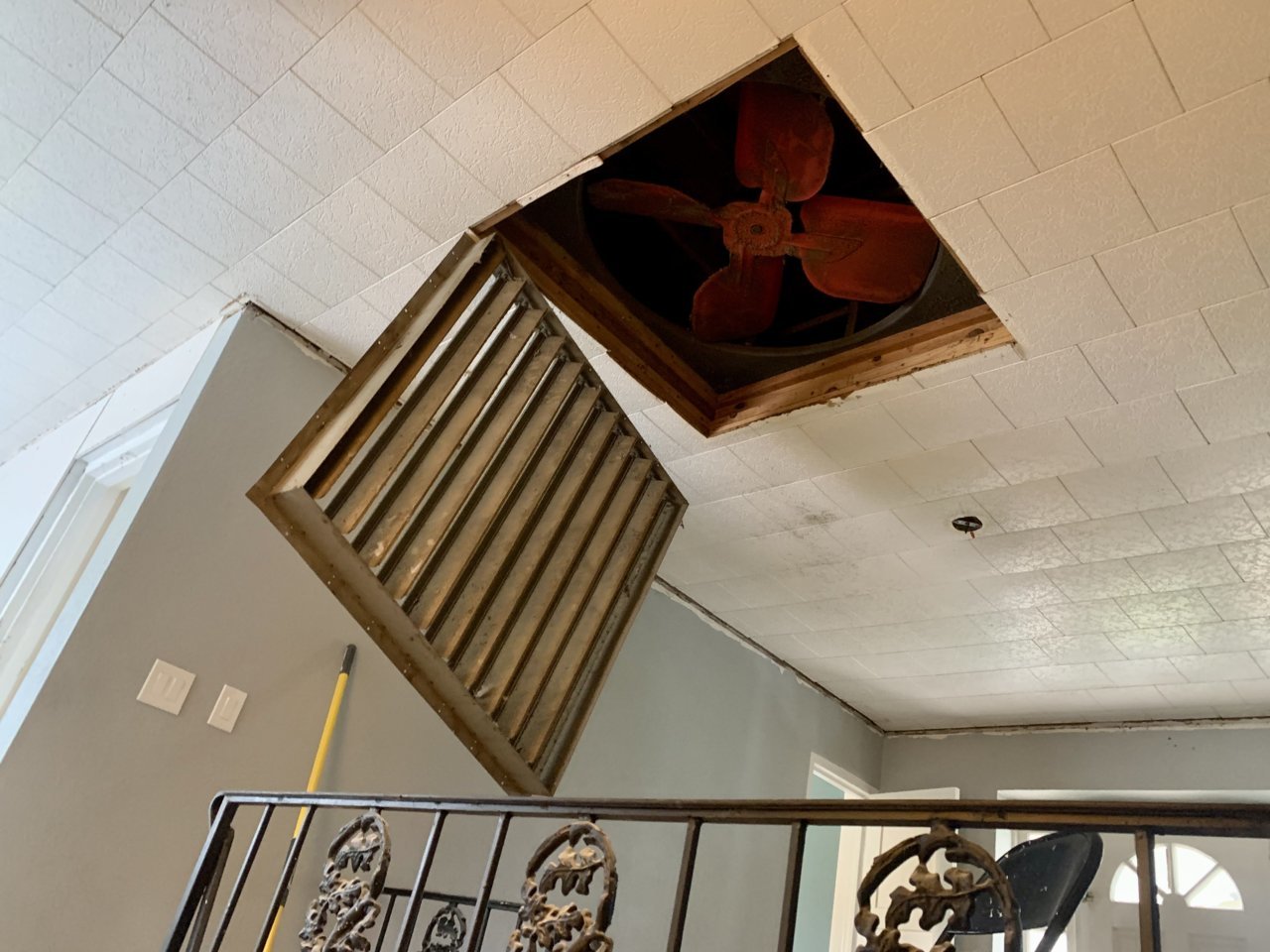

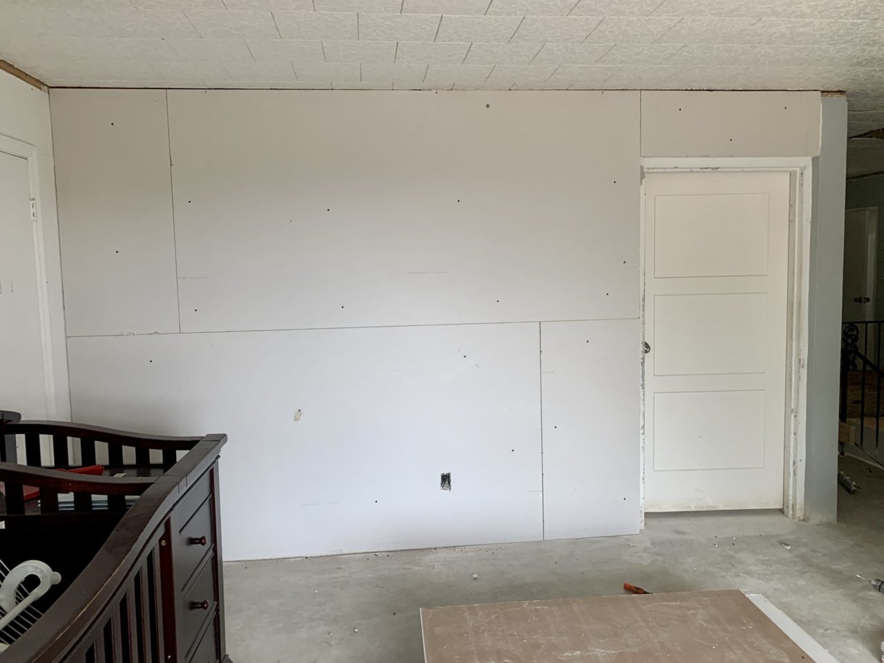

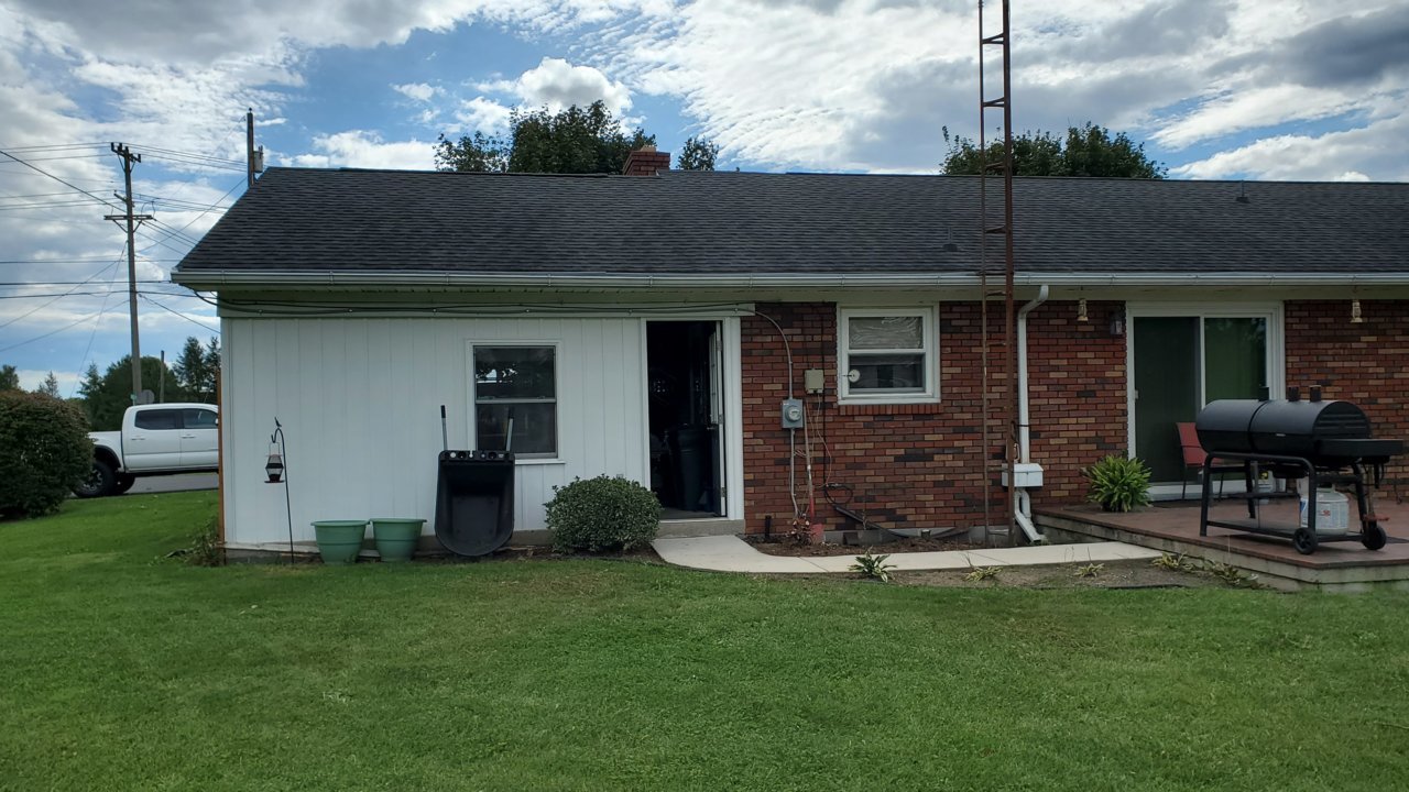

    Had to drywall one block wall that would have been too thick with furring strips. Ditched the whole house vacuum- sorry “fan”. Furring strips on the remaining walls and a decent view and mild weather!
    We have a couple people coming out next week to quote windows and a few doors. Will feel like a totally new house soon.

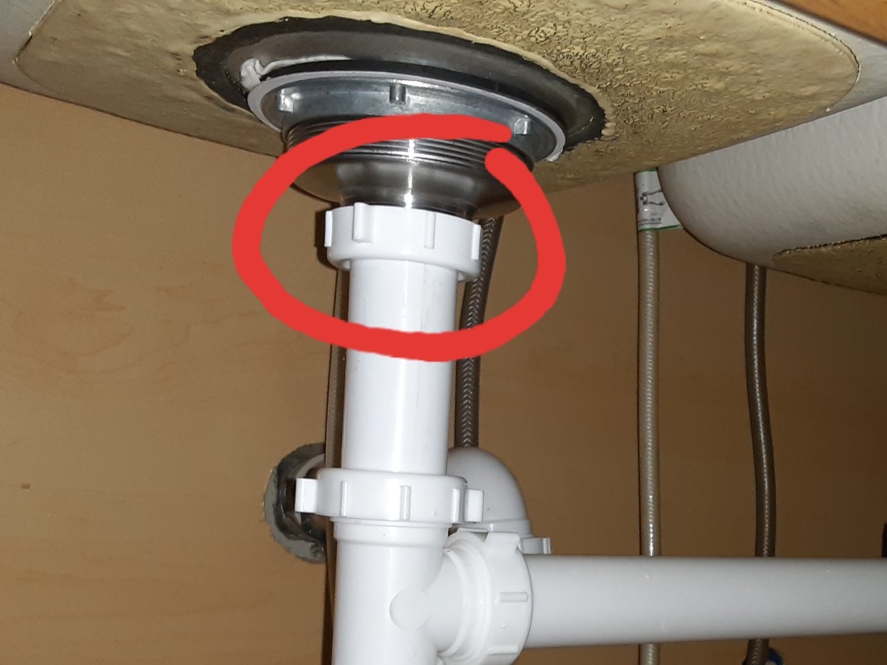

    Question for the plumbers in the group; had to redo the kitchen sink and install a new garbage disposal. Everything went fine except I now have a slow leak from the non-disposal side of the sink. The leak is coming from where the drain/basket meets the plastic slip joint.
    I have replaced the gasket and nut at that location, I have it pretty tight. Would this be a good spot for plumber putty?

    Is it a flat seal in there?

    That little gasket is the top hat type gasket, ferrel, that has a lip that sticks down into the flanged tail piece, if nothing is available, pipe dope will work, putty may just squish out.

    It looks like you might have the wrong tailpiece to mate with the trap.

    Yes, the seal is flat not beveled, the "top hat" style as mentioned

    I usually take down hand tight then give it a little more with the channel locks.

    There are two sizes to those things, right? 1 1/4 and 1 1/8? Something like that. Should be snug to start.

    You need one of these from lowes and a metal tailpiece nut…..
    Keeney Tailpiece Washer 1-1/2
    Item #2483960
    Model #50879KHB

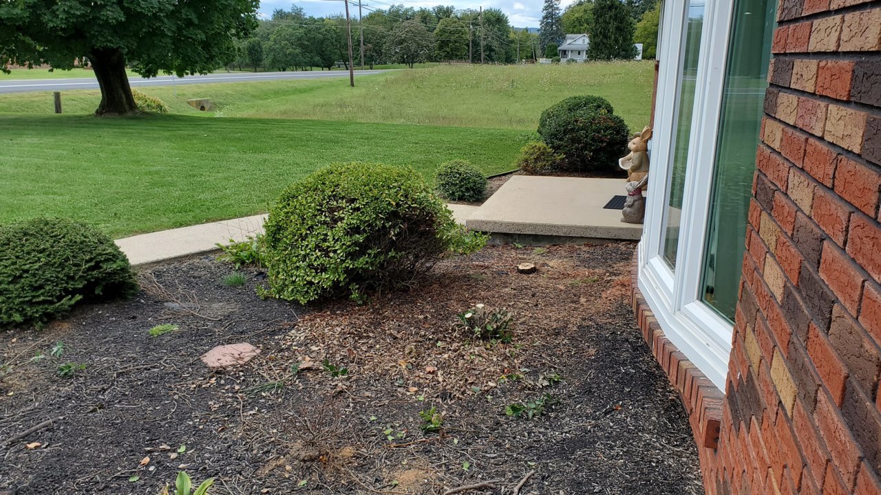

    So a little more shrub "trimming" today...
    Also cut down two overgrown evergreens that were dead inside. Needs to Start over.
    So it's going to look pretty bad for a while, heck probably into next summer before it all starts looking ok. You might be wondering why am I butchering all this. Everything had just gotten overgrown and was crowding each other. Take this picture for instance, a Holly bush was growing right into the back of this one.
    Still got lots more to go, but I have to go bit by bit so my burn pile don't get too big...
