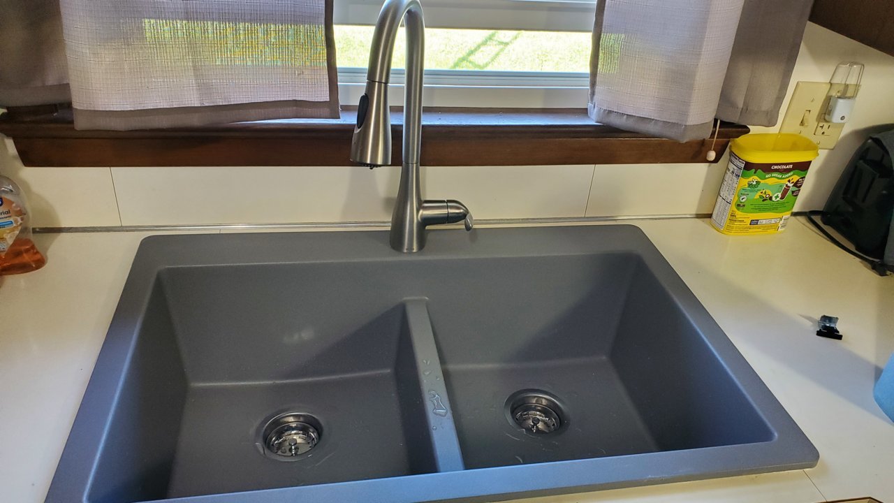

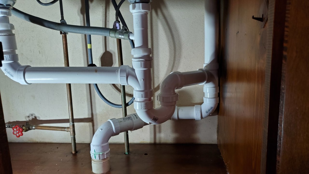

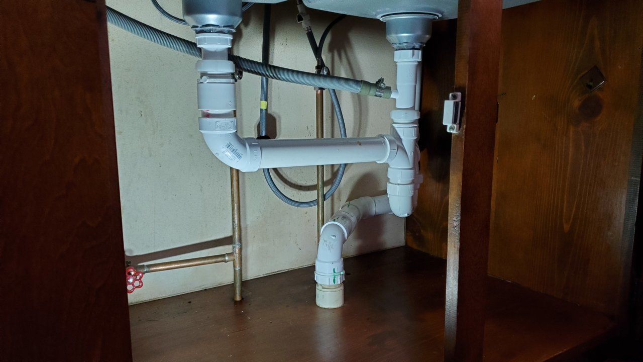

    So I finally got the right sink in and it's installed!
    The sink install itself was easy, but the plumbing was a pain in the ass! It never would drain right so I knew there was a venting issue. Corrected that with a Studor-vent.
    It might look like a science experiment, but can drain a sink full of water in a hurry now!

    It's far better than what was there and actually drains now...
    Stunk to high heaven for a while though. Between the gasses from the septic and glue, my house smells interesting now... :rofl:

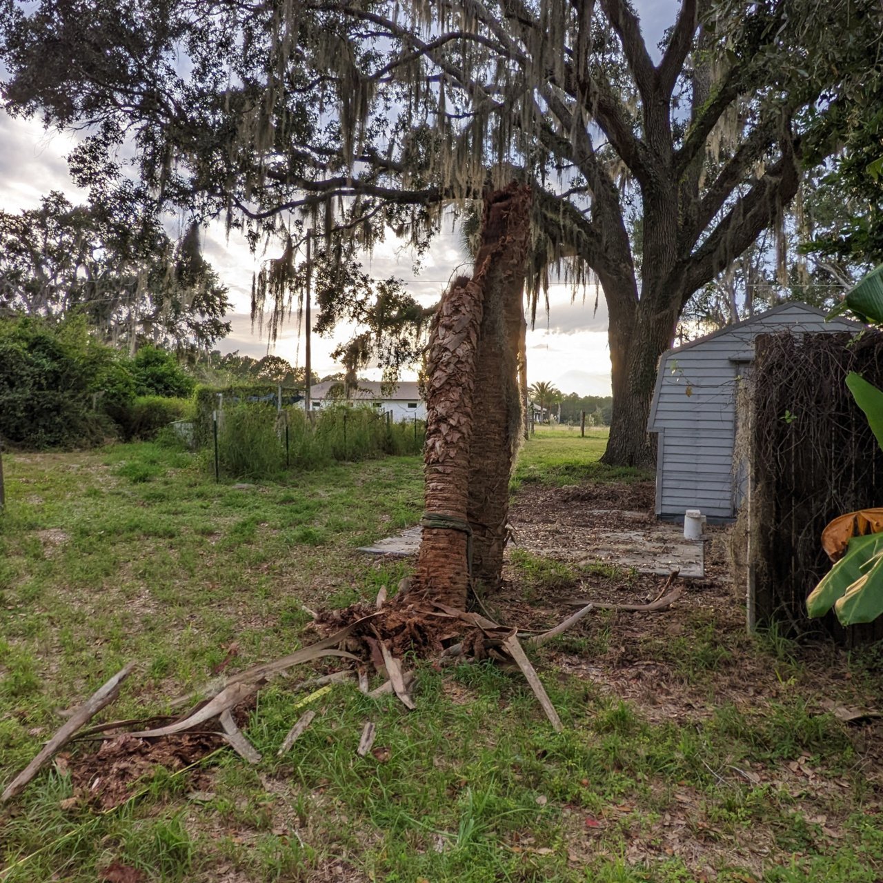

    When I got my place there was a fairly sizeable palm that I looked at and said, that looks dead, sure enough it was and the few wilting fronds left on it completely fell off shortly after.
    It was probably planted too close to the well and over watered thus.
    That raised it's own concern, palms being technically grasses aren't the most structurally sound 'trees' to begin with and I didn't know how long it was going to stay up dead.
    On top of that it was leaning towards my shed and well pump, I wanted to do something about it before it took those out which was going to be challenging due to again it *wanting* to fall that way if I just took the chainsaw to it.

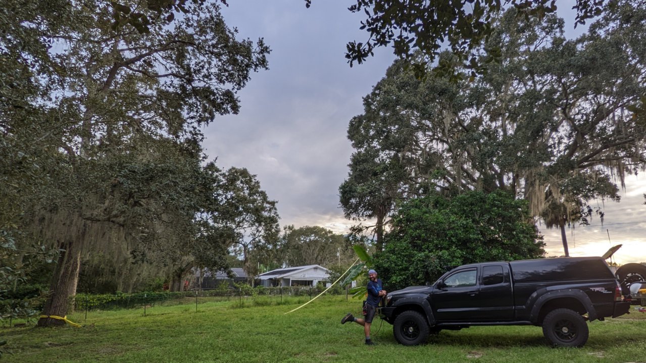

    Fortunately I have a winch and a good buddy who loves rigging to come help me (the first gen) and (the white sheep of the family) my Uncle's Tundra will be doing the haul away, currently on loan due to my truck missing it's rear drive shaft...
    :bananadead:
    We rigged it up with a snatch block around a conveniently placed oak to redirect the winch line so I could pull it down away from my truck, had no idea what was going to happen, the trunk could have exploded for all I knew.
    And promptly pulled just the top right off...
    :annoyed:
    Many laughs had, we rerigged the lower half took up tension the truck started to dig in and slide even standing on the brakes and the winch line was taught enough it may as well have been solid rod so we slacked it slightly and gave it a little help from the chainsaw and were able to pull the rest down fairly easily and anticlimactically.

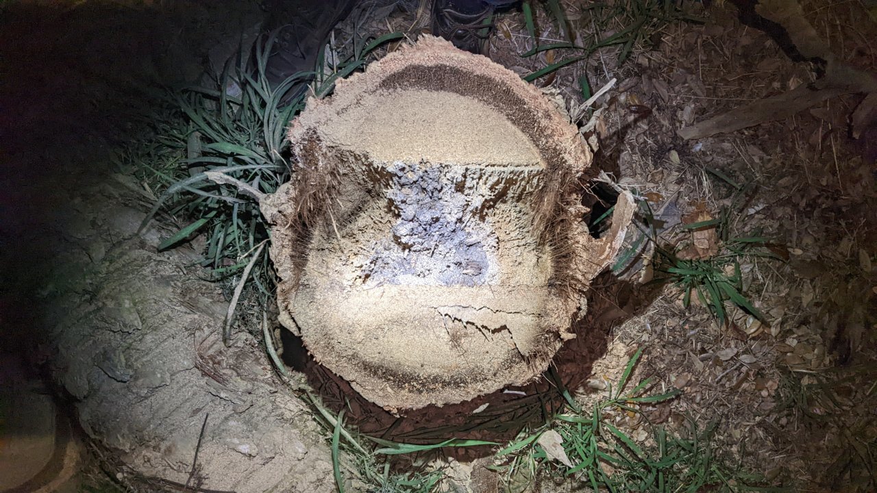

    Definitely ain't no solid oak but I was surprised as rotten as it was I still couldn't just winch it down.
    Ran out of day light to do much else but the core was definitely rotting.
