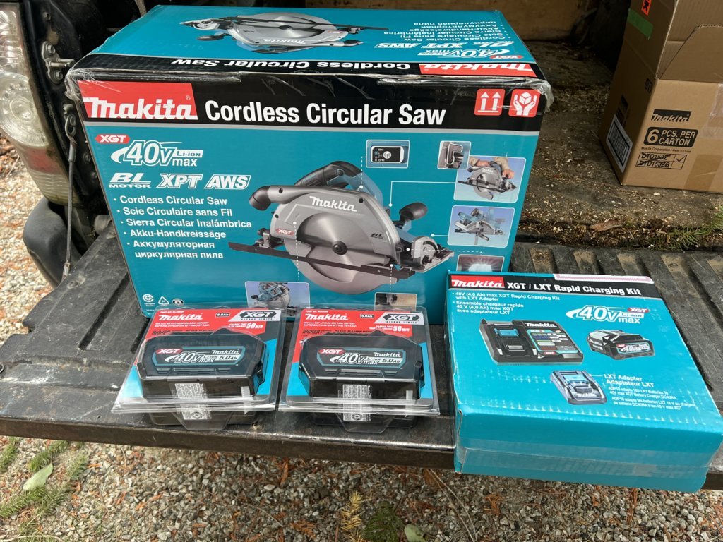

    All my cordless tools with the exception of a Hitachi framing nailer are Makita but they are all 18V / 36V (18x2) , this is my first Makita 40V , its a 10" , guide rail compatible circular saw , bevels to 60 degrees
    https://www.makita.ca/index2new.php?event=tool&id=3798&catid=2

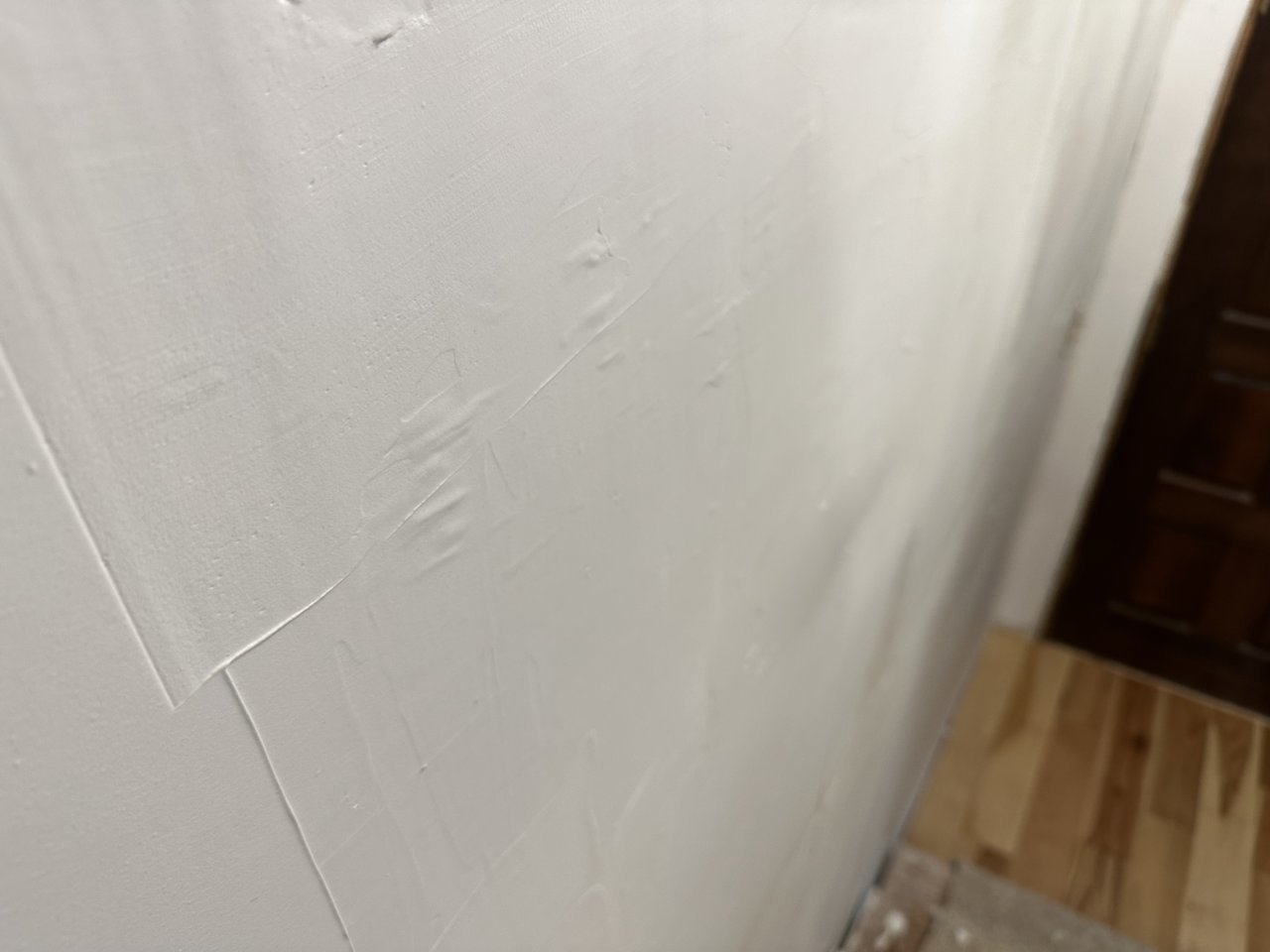

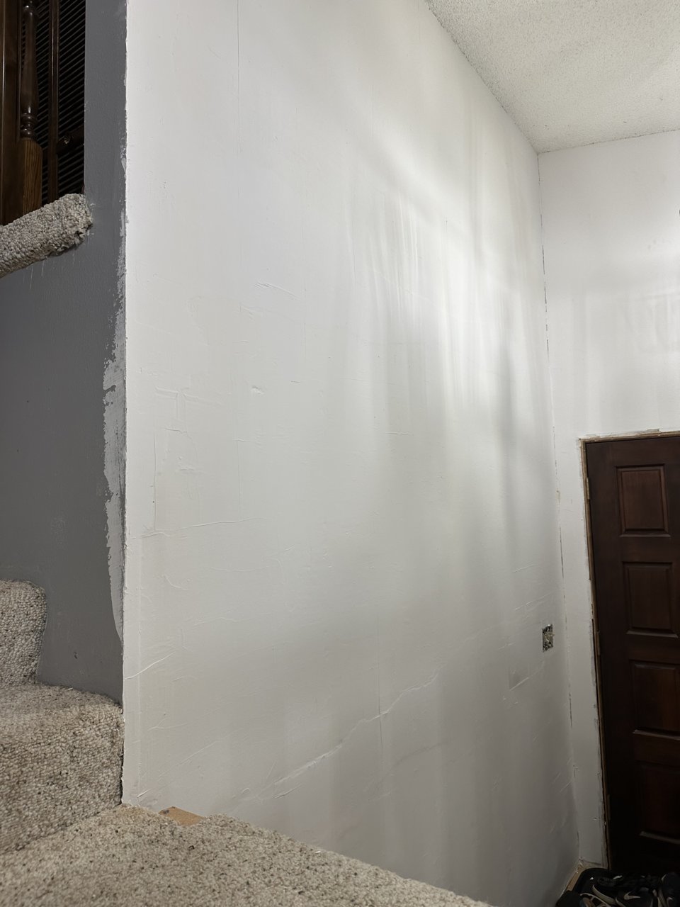

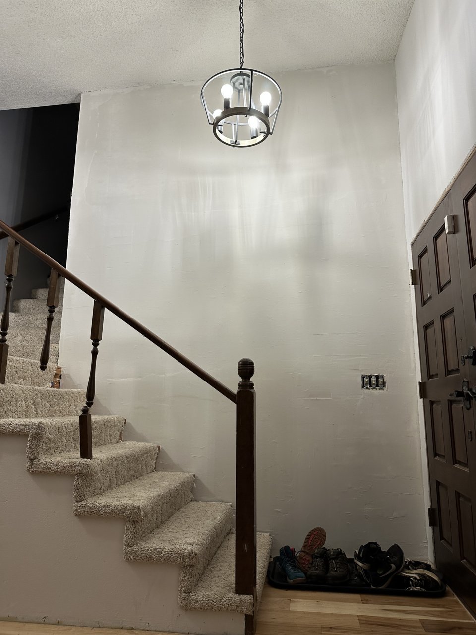

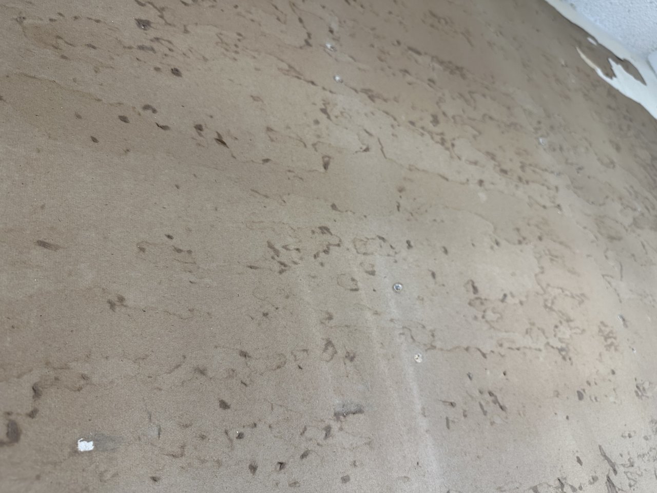

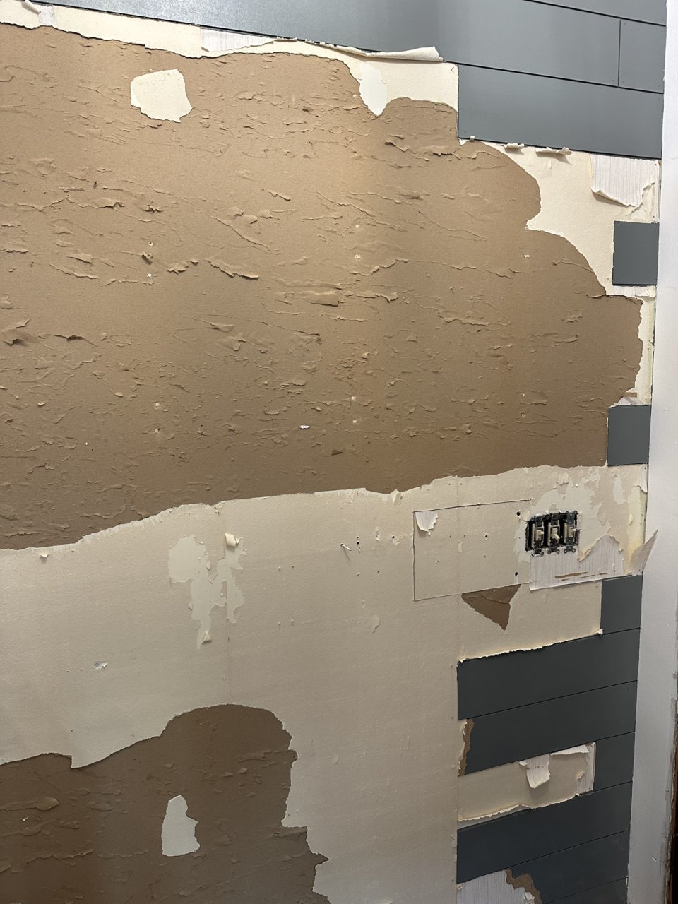

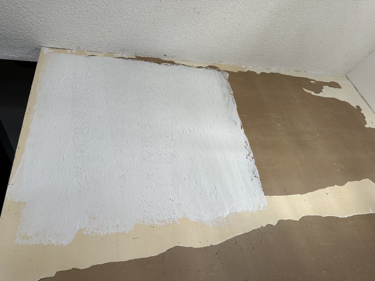

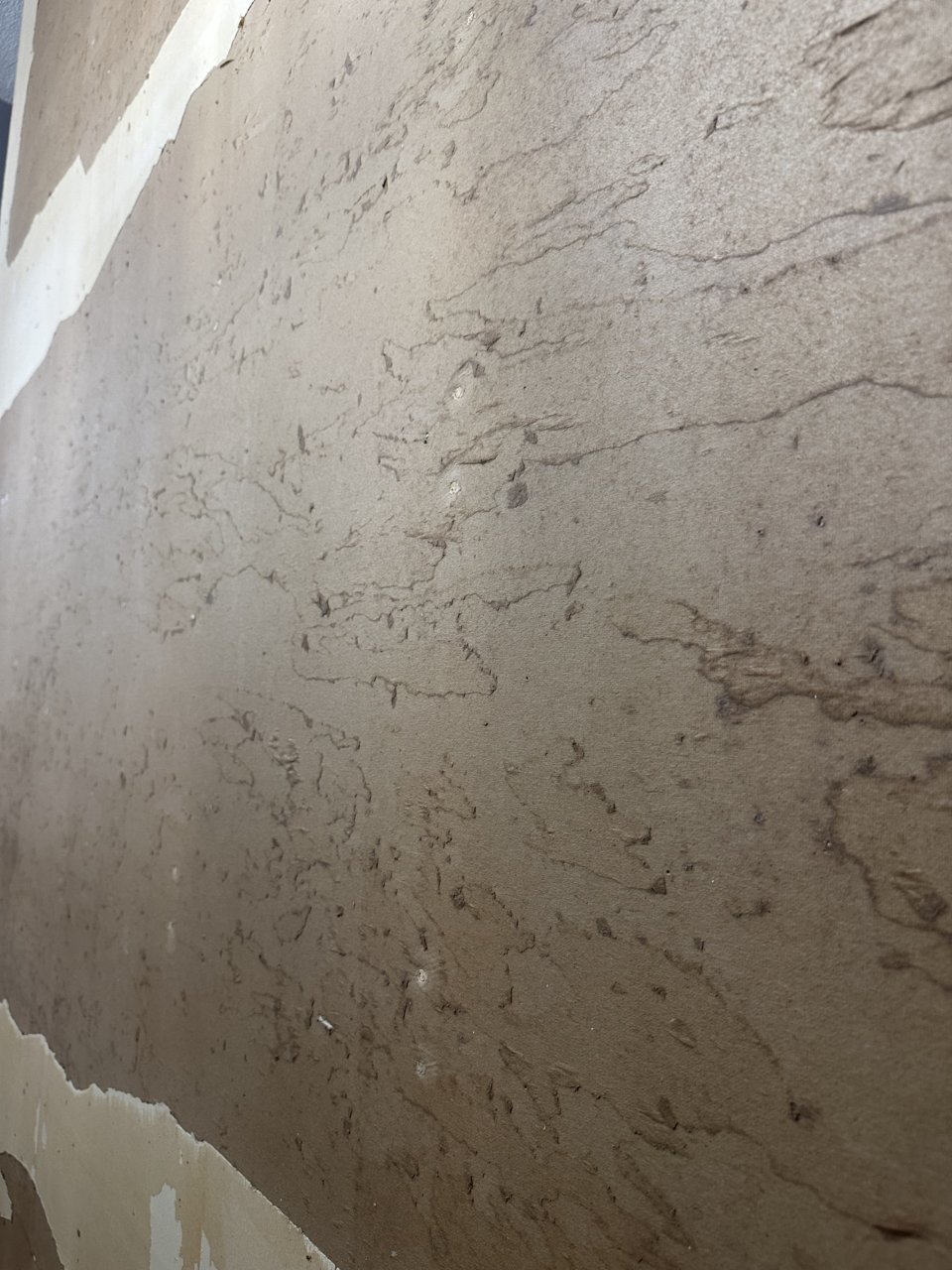

    Remember when everyone was telling me just to board over this wall? I should have listened. That was a bear to skim. Wallpaper should be outlawed unless you put it over removable boards!
    Starting point (gore/trigger warning):
    Day 1 sealed the paper as best I could and laid down a horrible coat. Used the old roller method.
    Day 2 cut all of the damn blisters out, pre fill, and then do skim coat 2
    Day 3 cut more blisters out. More prefill. Sand lightly and do the top coat.
    Final
    Time to ice my back :rofl:. Just needs a very light sanding, texture, and primer. No wonder that wall had slats on it for 20 years… removal and repair was a MONSTER! Wouldn’t have been so bad if the wall wasn’t 13’ in the air over a flight of stairs. Onto overboarding the popcorn on the stair landing tomorrow.

    Damn! You did good.
    Might have been easier to take it back to the studs and re-drywall, at that point.

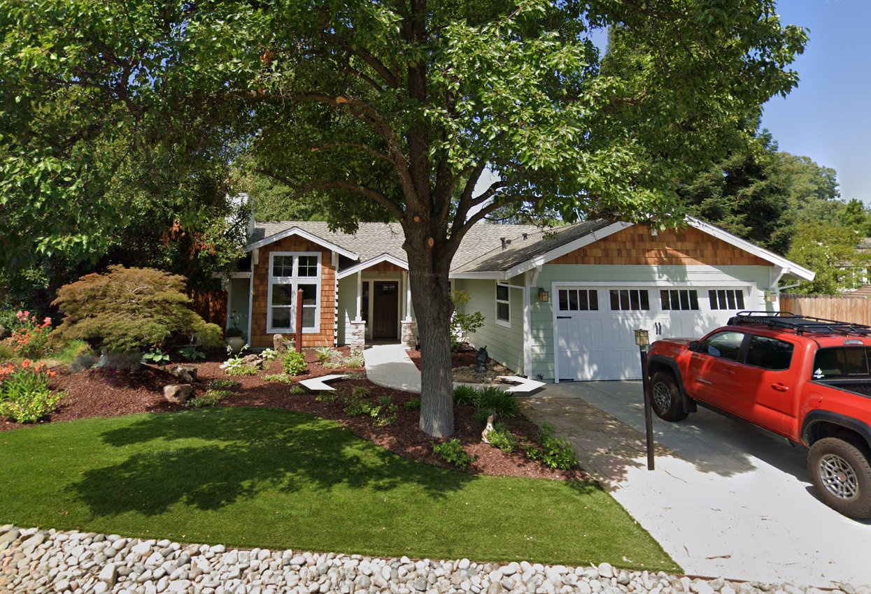

    My wife and I did a full remodel on our house (inside and out). New siding, eves, garage door, entry-way, and driveway outside and new finished in place hardwood floor throughout, dry wall “adjustments”, windows, doors, slider, fireplace, stucco, etc. on the inside. :bananadance:C31A5DCF-F4BC-4007-82A1-6B2909C755D6.jpgEB1DBC93-745D-41A6-AA16-D81C59501DCC.jpg

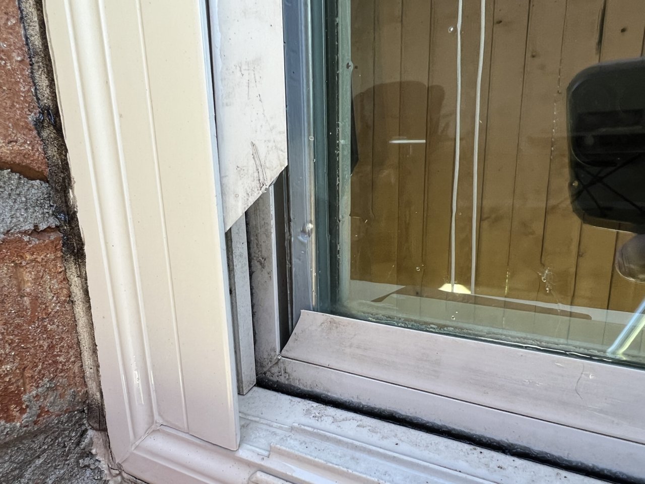

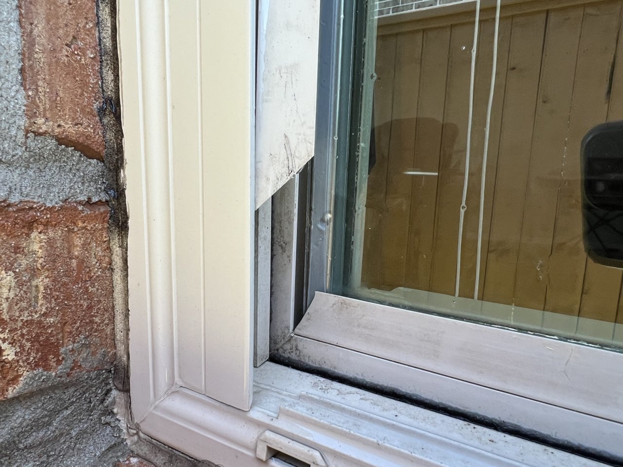

    Decided it was a good day to clean all of the windows today. To get the screens out we had to open the windows far more than we usually do. Not sure what this part is called but when we tried to close the window it caught on something and came out and bent all to hell.
    0DCA6C84-69F4-4D98-83A6-F1D009B88337.jpg 9720BD99-074B-4C82-B1B3-2FE9831EF7B0.jpg
    The whole vertical piece came off and I had to jimmy the window with a scraper and grab it with pliers and pull it down just to be able to close the window. This is how it sits now - except we still cleaned it, of course.
    Any idea if this can be repaired or will we have to replace the whole window?

    It's trim bead. It snaps back in place. If one end is square cut, insert it first under the mitred end of the horizontal piece
