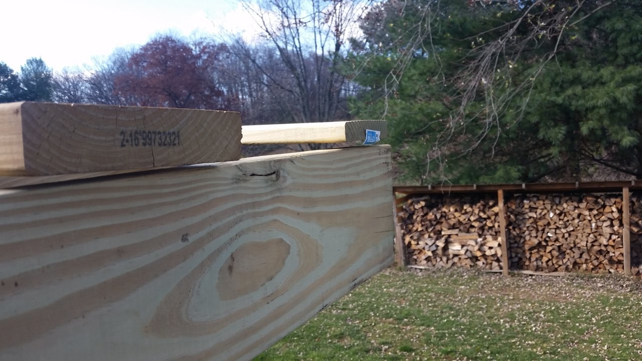

    Getting back to this mess, here's a pic. This is the outside joist, any way that I shim it will be visible. I planned on having the deck boards extend past the edges about 1/2", I like that look much better then the "picture frame" style which would require a trim board. Although, a trim board would hide the mistake and a shim between the joist and deck beam.
    The last option that I can think of is to get a 2x10 and rip it down to 7 1/2" at the joist hanger and 7 3/4" at the deck beam.

    Is that running parallel to house?

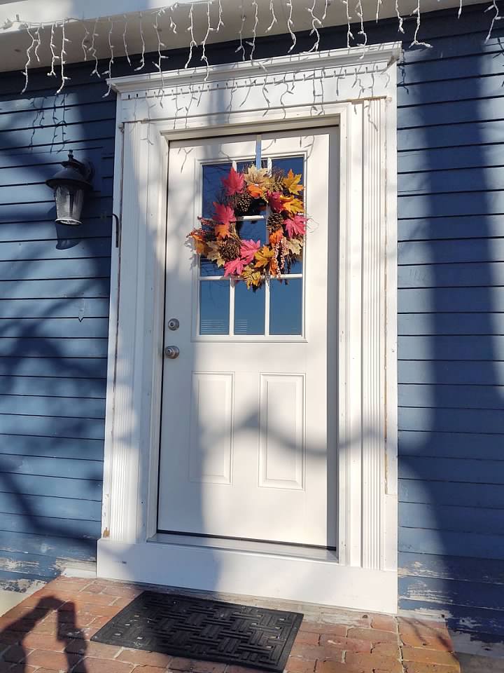

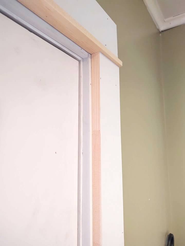

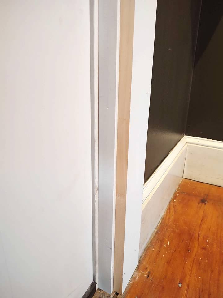

    Saturday I installed a new entry door. To achieve proper plumb, the lower left exterior corner was about 3/4" proud of the sheathing...lovely. Trimmed out the interior and exterior today. Padded out the exterior trim and kick plate/board some to give the appearance of everything being aligned/even. Used a jig to cut a pie shaped extension jamb/filler for interior. 1/2" at top and 1 1/8" at bottom. Nice clean cut. Replaced most of the exterior trim, but kept and patched a few pieces. Wasn't able to match the original fluted trim, but this is close enough. Homeowner intends to get a coat of paint on soon.

    I remember having to make up trim like that on my old house in Mississippi. Was not fun at all...
    Yes, that color got changed :laugh:

    It's not too bad. Some wood glue and a pin nailer hold that top assembly in place.

    Piece of trim sounds reasonable.
