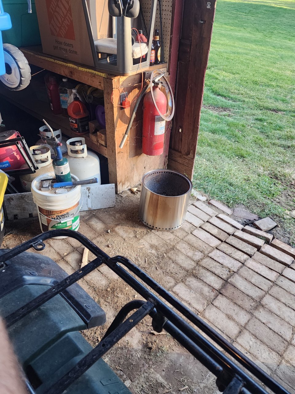

    FINALLY got my Solostove delivered. Was supposed to get it on the 19th but received yesterday. Of course its when im out of town. Ill send pics when i get home next week

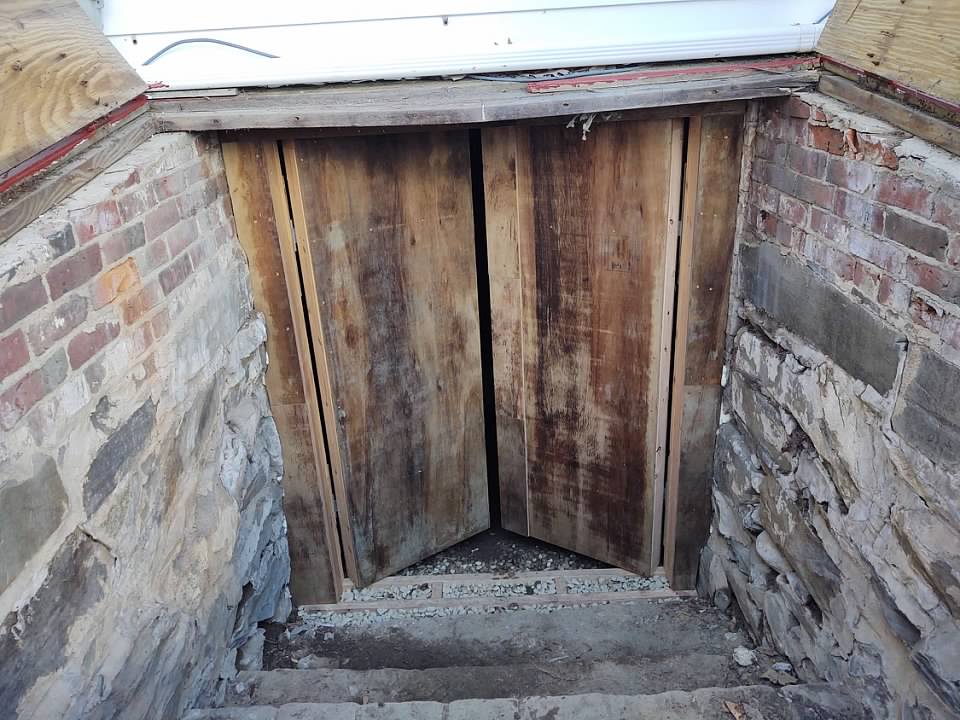

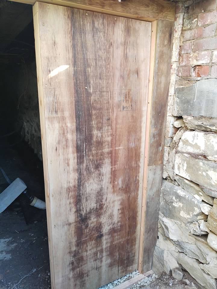

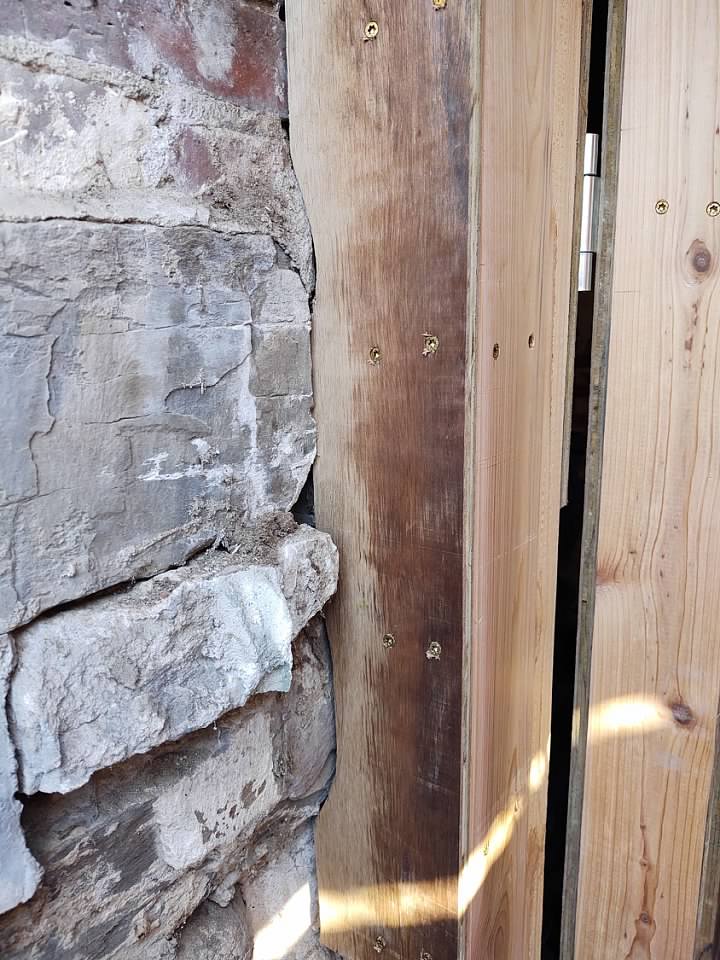

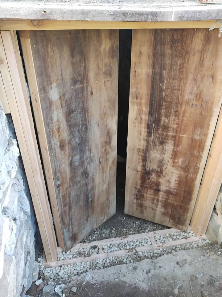

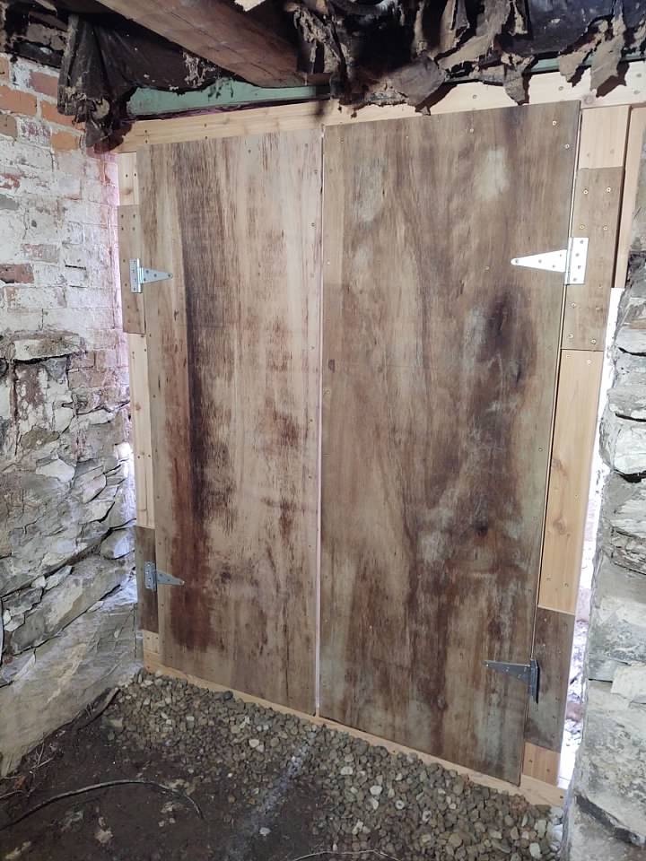

    Very fun and challenging 2 day job. I really enjoy these custom, non-traditional type jobs. Wrapped up today. House was built in 1801. Original wood door at the bottom of the bulkhead was rotten beyond rotten. Nothing square, level or plumb in the stone opening. Dirt/Mud had accumulated along the bottom. Got that all cleaned up and added some crushed stone to the base (cedar 2x4's). Got lucky with the base as there was a level piece of old concrete under the mud/dirt. Used tapcons to secure it. Added crushed stone to facilitate drainage into the channel in the dirt floor basement. Framed/Shimmed up a new square opening using cedar 2x4's. New doors were framed with same cedar 2X4's, insulated and sheathed with 1/2" PT plywood on both sides. Then added some scribed boards to the outside so I could use spray foam insulation around the perimeter on the inside. Everything turned out plumb, level and square. Customer was very pleased.
