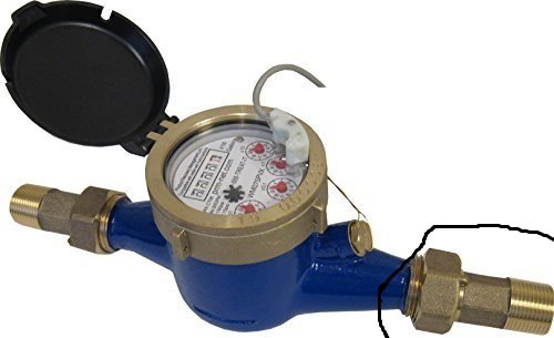

    Can you circle on the picture what item you’re asking about?

    No laughing at my dumb circle. It is my first time trying to make a circle on a picture.

    Yup that’s a meter union, usually you have a valve on both sides so it can be removed without draining you’re entire system.

    I have a shut off valve on both side of the meter. It makes meter replacement of the meter or repairs so much easier.
    I have to figure out what the part is call before I start calling for a replacement. I don't want to remove the old part unless I have the new one in hand.
    Is there a rubber washer/gasket for the union?

    Is it leaking or are you trying to get rid of lead parts? Normally they are brass or copper and those are compatible with drinking water and don’t contain lead. Depends on the time frame it might have gasket or just a face that will yield when tightened.

    It look like all lead pipes were replace but one. It was probably due to not in stock at the time of replacement.
    I'm trying to remove all lead pipes. Is lead solder something I should remove?

    If it is a dielectric union this is the basic breakdown

    This is the closest I can find online to what my coupling look like.
    My part is over 30 years old so I don't think they're made the same design.

    As far as plumbing goes, unions seat metal to metal. No gasket.

    I wouldn't worry about the solder.

    Not true. It depends on the face and application of the union. Beveled faces do not need a gasket and are almost always used in gas supply. Flat faces do need a gasket and are almost always used in water supply. There are exceptions but they are rare.

    You're correct. My bad.

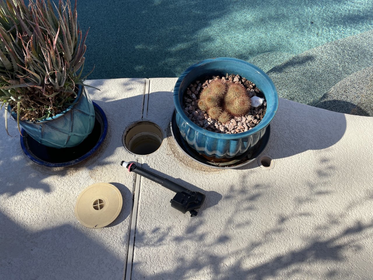

    So, I finally got around to draining off the excess water in the pool yesterday. This morning I woke up and the pools over full again. :annoyed: The Korky fill valve didn't even make it a year. Off to HD for a replacement.

    Looks like a meter coupling.
