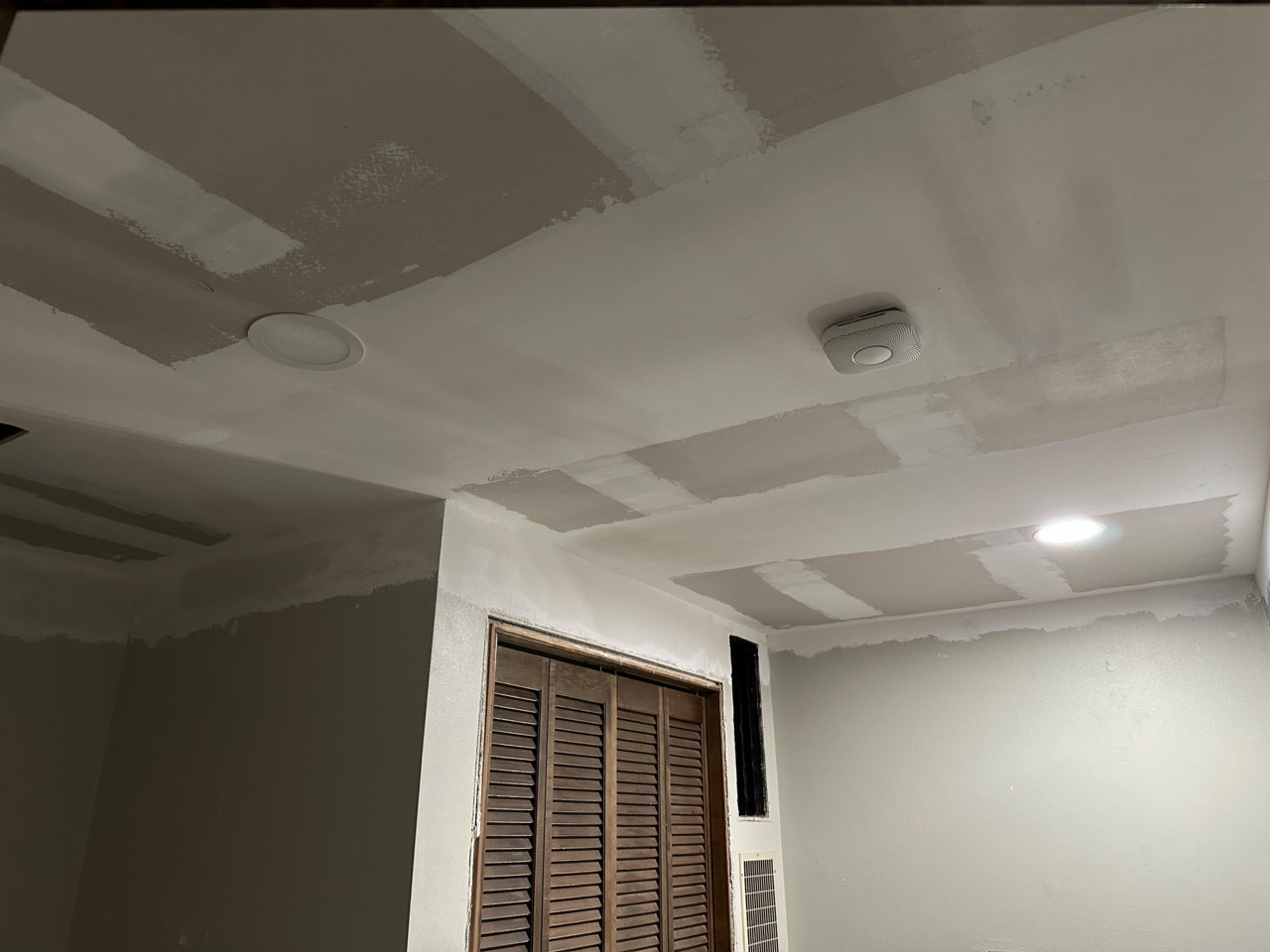

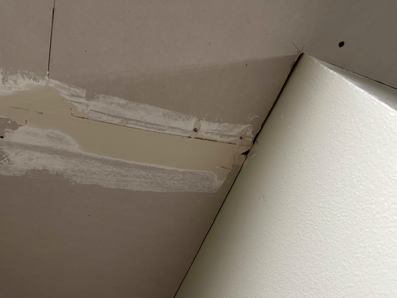

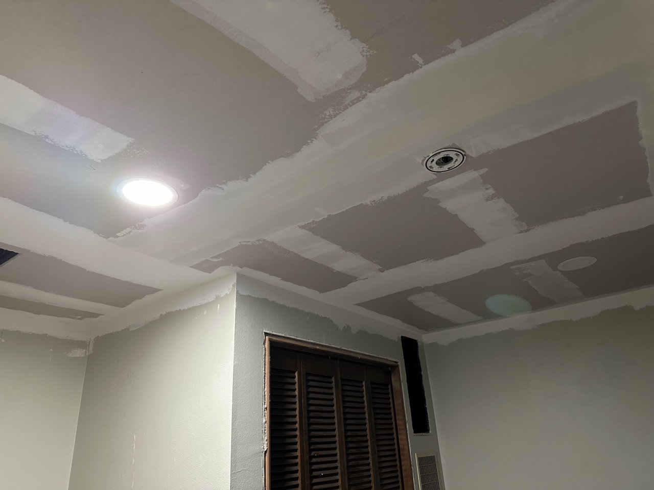

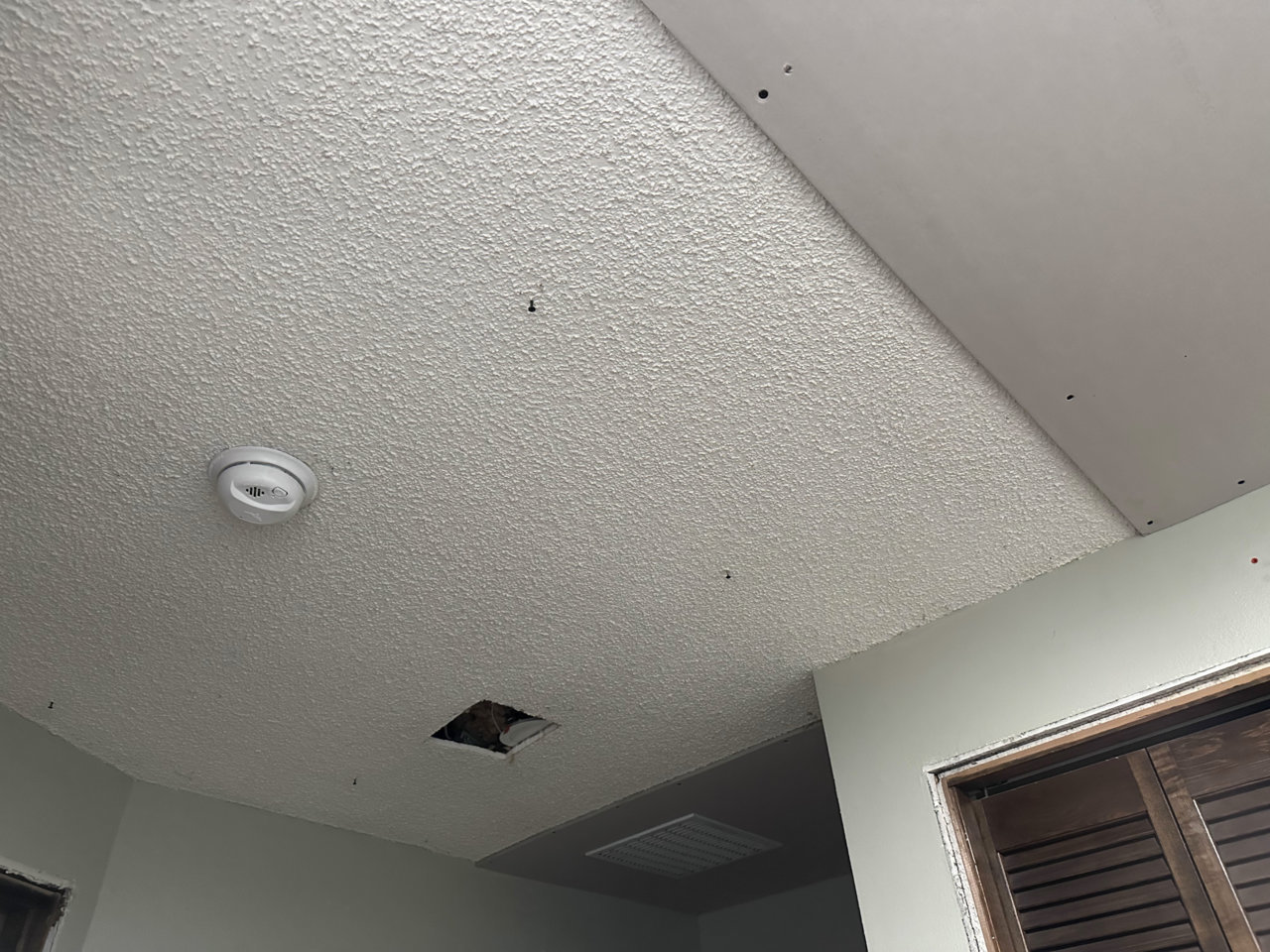

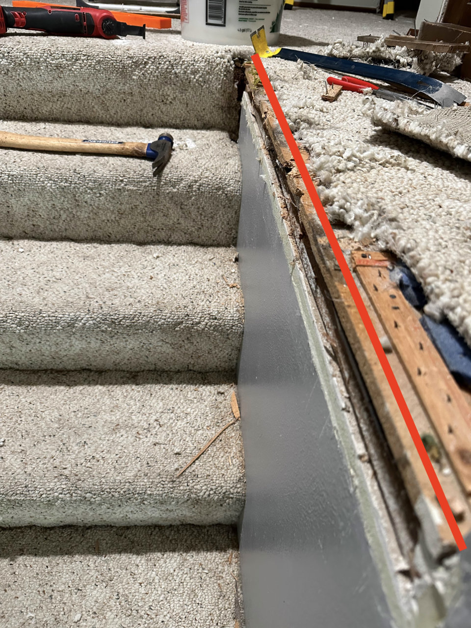

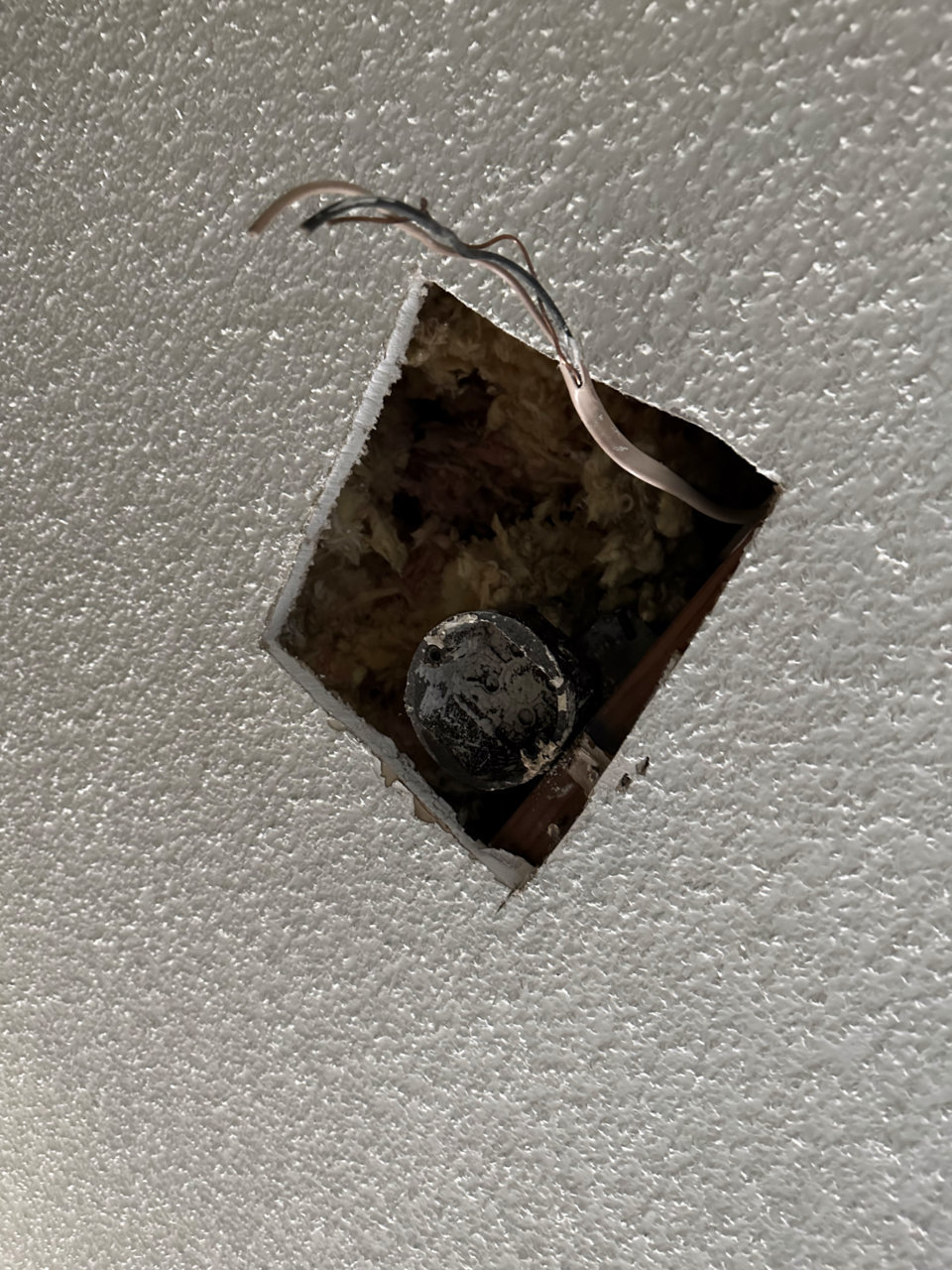

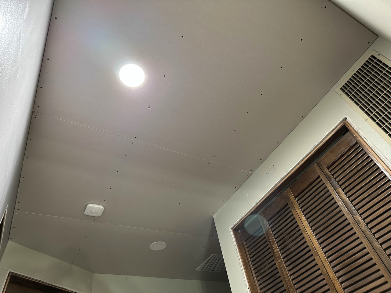

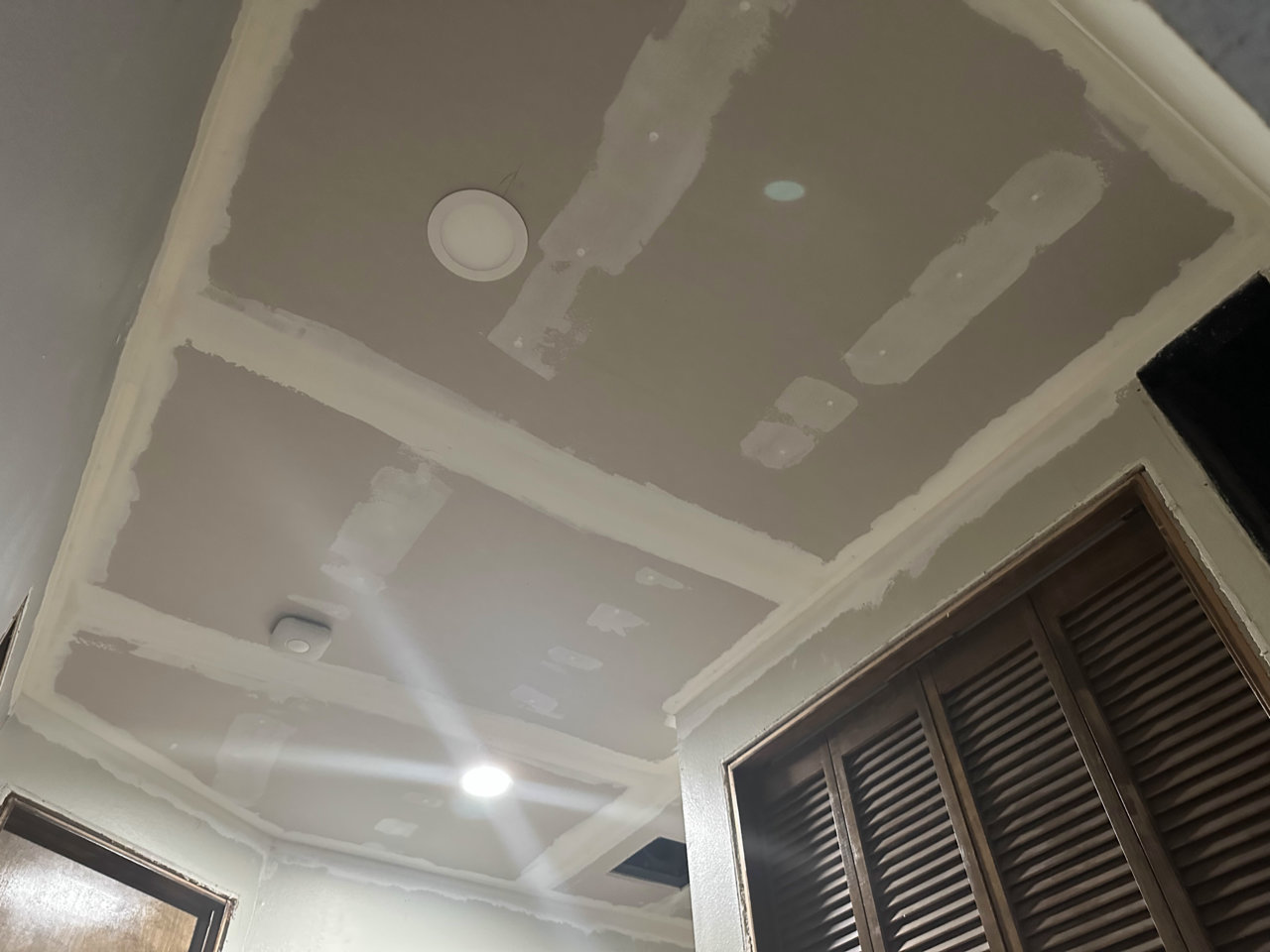

    Made some progress on this. I went ahead with the plywood backing for that piece of damaged wall where I need it to be nice-looking wall. The nosing for my landing will go over the old floor, so anything below the sub floor needs to be tight.
    Started by ripping the old carpet nosing off. I had to finish the cut with a multi tool and the blade was super dull... don't mind the burn mark. I know the smoke alarms work, though!
    Then I made a 3/4" recess on the lip I'm going to float over
    Added a piece of drywall in the corner and then ripped down a piece of birch plywood to use as a fill strip
    Then I pre-filled all of the harsh gaps with fast set before adding mesh tape to the seams and skimming
    It took a couple of skim coats and some tedious sanding to get it all blended, but I think it turned out great!
    I also skimmed 2 other walls that were pretty jacked up from 40 years of picture hanging and whatnot, so I think that's why I was so slow with this project. Anyway, today I did my "near-finish" sanding of all the walls and my ceiling I boarded over. It just needs some minor touch-ups in some valleys and around the stairs where my new treads will be (it needs to be super tidy in those corners otherwise I'll have gaps).
    Overall I would rate this project a solid 1/10. I absolutely hate drywall and I'm ready to get back to nailing something :rofl:. Just some minor touch-ups and some detail sanding to go before I blast this whole room with my texture gun.

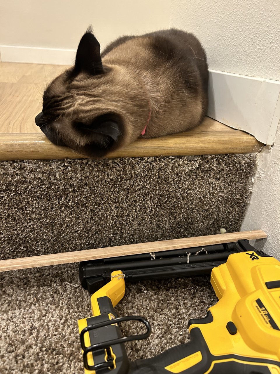

    96162952-458B-4EC6-A8D3-065893F04677.jpg image.jpg I had to repair carpet damage due to KAT this AM.

    I gotta ask. Is it sleeping or is there a 18 gauge brad in it's skull? No judgement. Accidents happen. lol

    The bugger just falls asleep at the scene of the crime. Some nerve. She's a sweetie but loose carpet fibers makes her nutso
