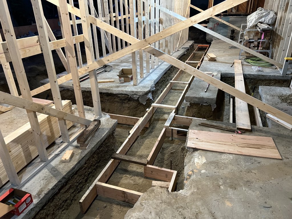

    What is going on top of the footings? And I figured your frost line would be lower than that?

    there will be a foundation wall to top of slab height
    right here on the coast , that is as deep as we are required to go , frost line in my area is approx 18" and in this particular site we are not in clay or other expansive soils so ground heave is not really a big concern

    Will the foundation wall be cinder block?

    8" cast in place concrete wall , cinder block is pretty uncommon here where seismic considerations are concerned
    we have shearwall hold down bolts that embed 20" into the foundation here at about 16 places

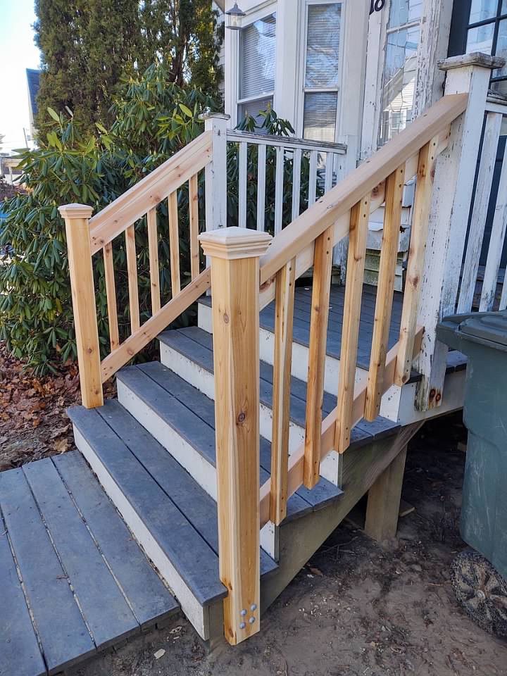

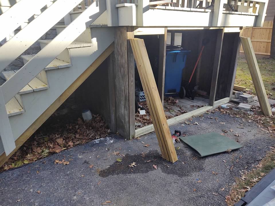

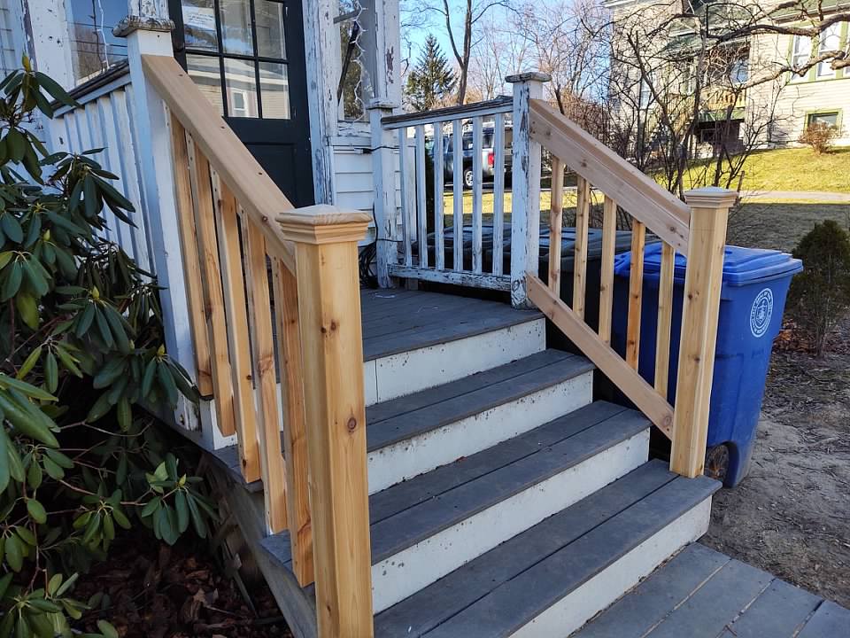

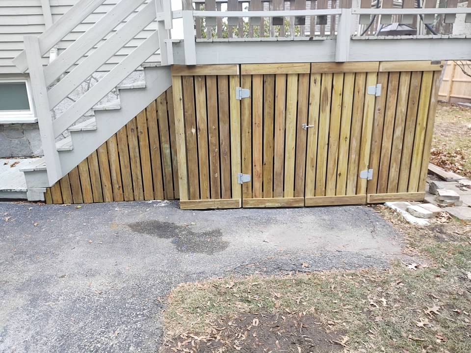

    Couple small jobs this week. Wrapped up today. I'm now on vacation (self-employed) until after the holidays. :woot:

    I didn't even think about the seismic concerns.

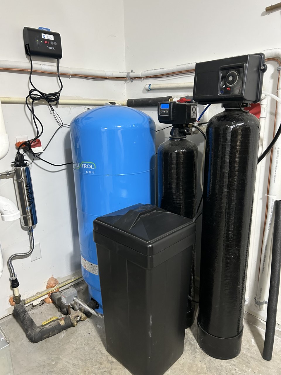

    FFBFC7A5-6810-466E-A92A-1959959C9F30.jpg 66A030F3-FF3E-4D7C-B5A3-B733B3B0FEE4.jpg 8B057626-E9C2-4D76-AC9A-24335A8E3948.jpg 5A71E2C9-E29D-4807-BF8C-8BA47BB435AD.jpg 0C9F082F-F6F0-4D43-B053-912A041832ED.jpg Installed further "stuff" on my shallow well water system. Wow have I added to system where the previous idiots just drank the water and ignored hard deposits and put up with the H2S stank, etc
    So initially: Oxidation of sulfur compounds via air/resin bed. Flushed (now every 4 days, seems right.
    Then: Water softener using KCl v NaCl
    Ran like this but water just wasn't right and wife would get a stommy ache. (We even ran a little experiment with bottled water, yep, she not lying). Bacteria tests were hit and miss. Sometimes yes and no. Means yes to me.
    So yesterday in went the whole house VIQUA UV treatment post both above tanks.
    And undersink Solo Axeon RO to replace the store bought Aquasana system (have my doubts).
    Install was relatively easy.
    WOW the water is absolutely tasty pure. I was actually the most surprised!
    EDIT: Just did a four person blind taste test vs. Kirkland bottled water. Well water won all four.
    I'm done adding dollars! Next idiot gets sweet water too.
