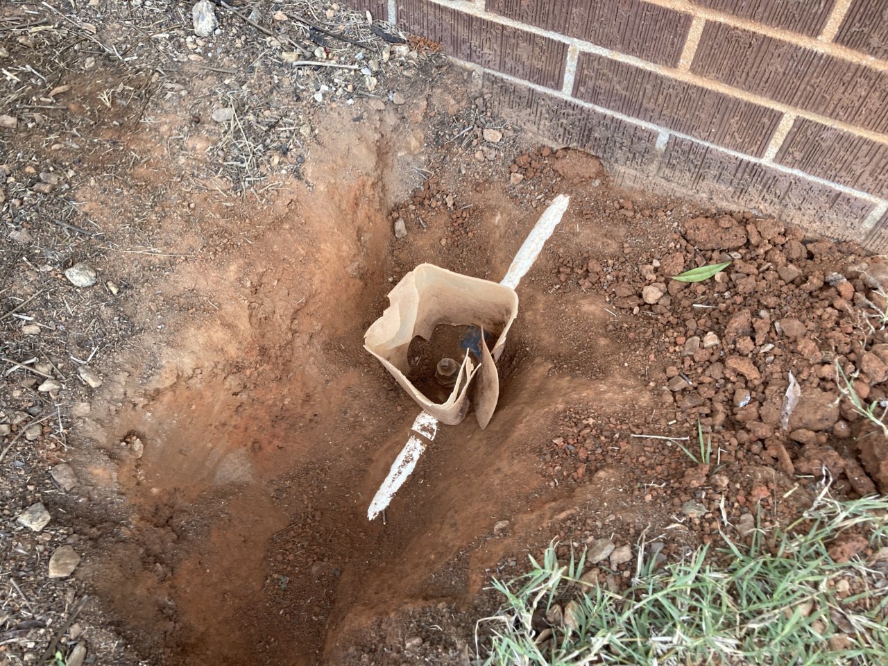

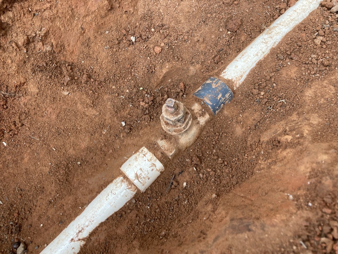

    Update to the mystery water line: I asked the lady next door and she couldn’t recall there ever being a sprinkler system or anything like that out back, but was very certain the house had always been on city water and not a well.
    I did some digging and sure enough the pipe comes out the other side into what appears to be some sort of valve, and proceeds further away from the house. There was remnants of a plastic box surrounding the valve. It’s definitely 3/4” pipe and I could only make out that it was schedule 40 pipe. Anything other markings were beyond my eyesight. I’d love to know where this goes but really don’t want to dig up my yard just for curiosity. It’s about 5” below ground level where it exits and slopes down to about 9” where I stopped digging.
    At this point I’m considering just having it cut off and re-solder the copper so it’s all one piece, which I think a couple of you had suggested.

    5" isnt much for frost, i dont know what your minimum is there. Is the valve on?

    Or close it see if someone starts yelling:anonymous:
    Its either coming from a cistern/well or might going to someone elses property maybe?:confused:

    is it the remnants of a PRV ?

    That’s what I thought too.
    Looks kind of like a regulator to me?

    Is this by chance the lowest point in the plumbing system? If so this could be a master drain for the house. Was it ever used as a seasonal dwelling?
    You could cap it off or locate an outdoor faucet higher on the wall if wanted, you have the tap in the water line already there.

    Aside from the septic drain and hvac drain lines, yes it’s the lowest point in the plumbing system. It was not a seasonal dwelling. She lived there from 1969-2020. Tomorrow I’ll try to see if the valve will even turn (and if anything happens afterwards). I’ll probably end up taking it off that supply line and cap it. I’ve got a spigot on each side of the house so no real need for another one.
    One other wild guess from left field…is it possible that line was put in when the house was being built for the brick masons to have water before the spigot lines were run? Obviously it’s below ground now but that would’ve been dug out back then. Just a thought.

    That PVC is too new to be something the masons used when the house was built. Make sure you get a cap or plug the size you need to stick in that copper before you attempt to turn that valve. Turning that old valve might result in a serious "oh shit" moment :laugh:
