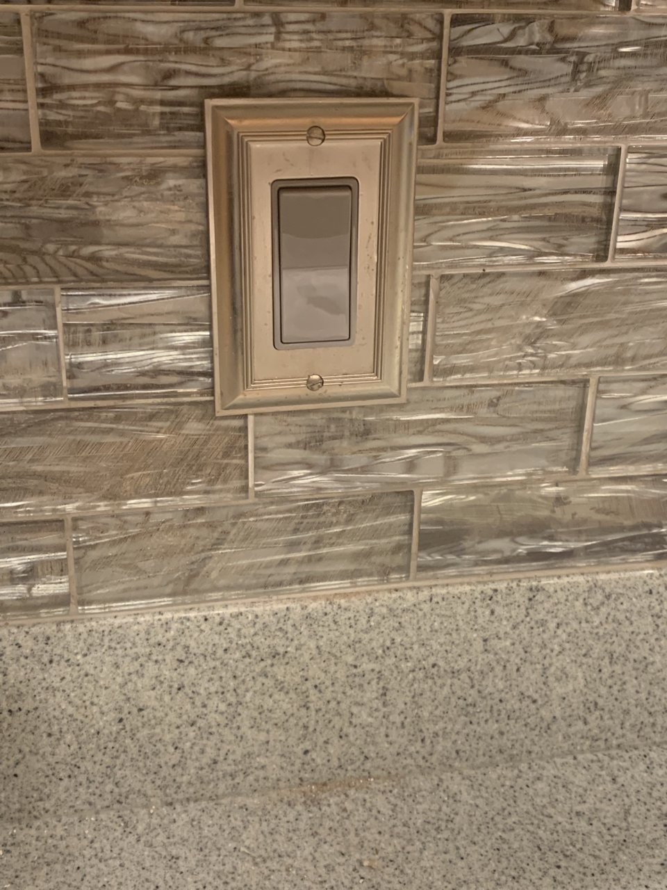

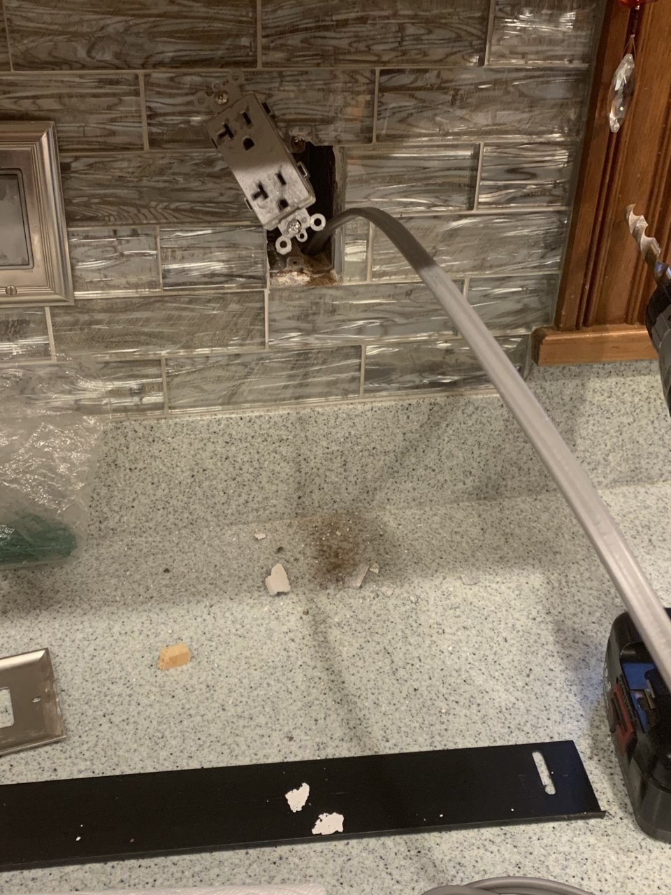

    New house didn’t have a garbage disposal so after 3 months of dealing with a strainer and the gf with a total disregard for what goes down the drain, it was time.
    Major challenge was running power under the sink. The wall had a single plug linked to the dining room according to the panel. Had a single lead to the outlet so that was simple enough to tap into…. Now to get a wire run. Was fortunate enough I punched a hole behind the washer and was able to feel the bottom of the outlet box. Success.
    That was enough for one evening. Switch all wired up.

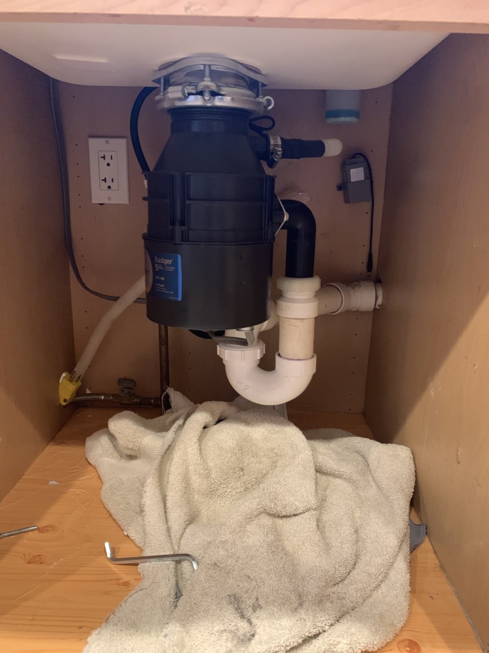

    Now for the disposal.
    Took the old p-trap out and fit the disposals with a new trap that has disconnects. This was the easy part of the whole job, aside from being 6’2 and working off the floor. Ugh.
    It was unfortunate the outlet under the sink wasn’t on a switch and powers the washer. everyone is now happy feeding anything into the sink……..

    You could have used the outlet under the sink with an air switch on/in the counter. :rolleyes:
    Of course, not sure what code in your area would say about that.
    Looks great! Good that everyone is happy!

    im unfamiliar with this Air switch as you say. code??? its Rhode Island which allows you to do your own plumbing, unlike Mass which by code does not. I kid mostly.
    quick search and it appear to be more work than running a wire but I did learn something today so I guess its beer time.

    It's just a push-button, usually in a hole in the counter. A tube, which carries air compressed by the switch, connects to a relay/switch, which controls the power going to your disposer.
    I assume they are still on the market - haven't seen one or looked for one for several years.

    air switches are still very much on the market. one of my main contractors uses it in all his jobs, it tidy's up the counter not needing another switch, and also allows bigger window openings above the sink without having to reach so far off to the side for disposal activation.
    biggest concern is that the circuit under the sink needs to be a dedicated 20A circuit to support it. dishwashers draw about 9-12A, disposals are usually around 4-6A.

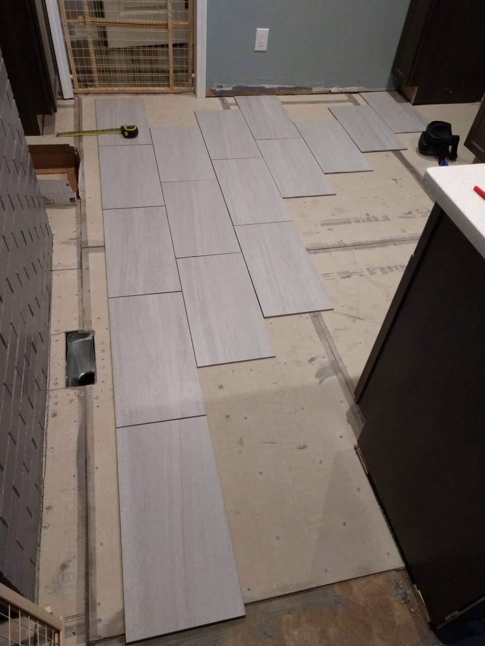

    Being that the fridge wont fit in the doorway to the living room even with the doors off (honestly not sure how they got it into the house), looks like Ive gotta tile the kitchen, put the appliances back, then tile the dining room. Cement board went down today, right over top of some ancient linoleum but not before a good thick layer of mortar. Then 350ish screws to hold everything down. Still have one creak, not enough movement to crack a tile but Ill still go under the house to fix it...one day.
    Now Im figuring out the layout so Ill be ready to go full send tomorrow.
    The creak is right around the air duct, hence the excessive amount of screws near it.
    The floor is nowhere near level, so installing these should be fun to say the least.

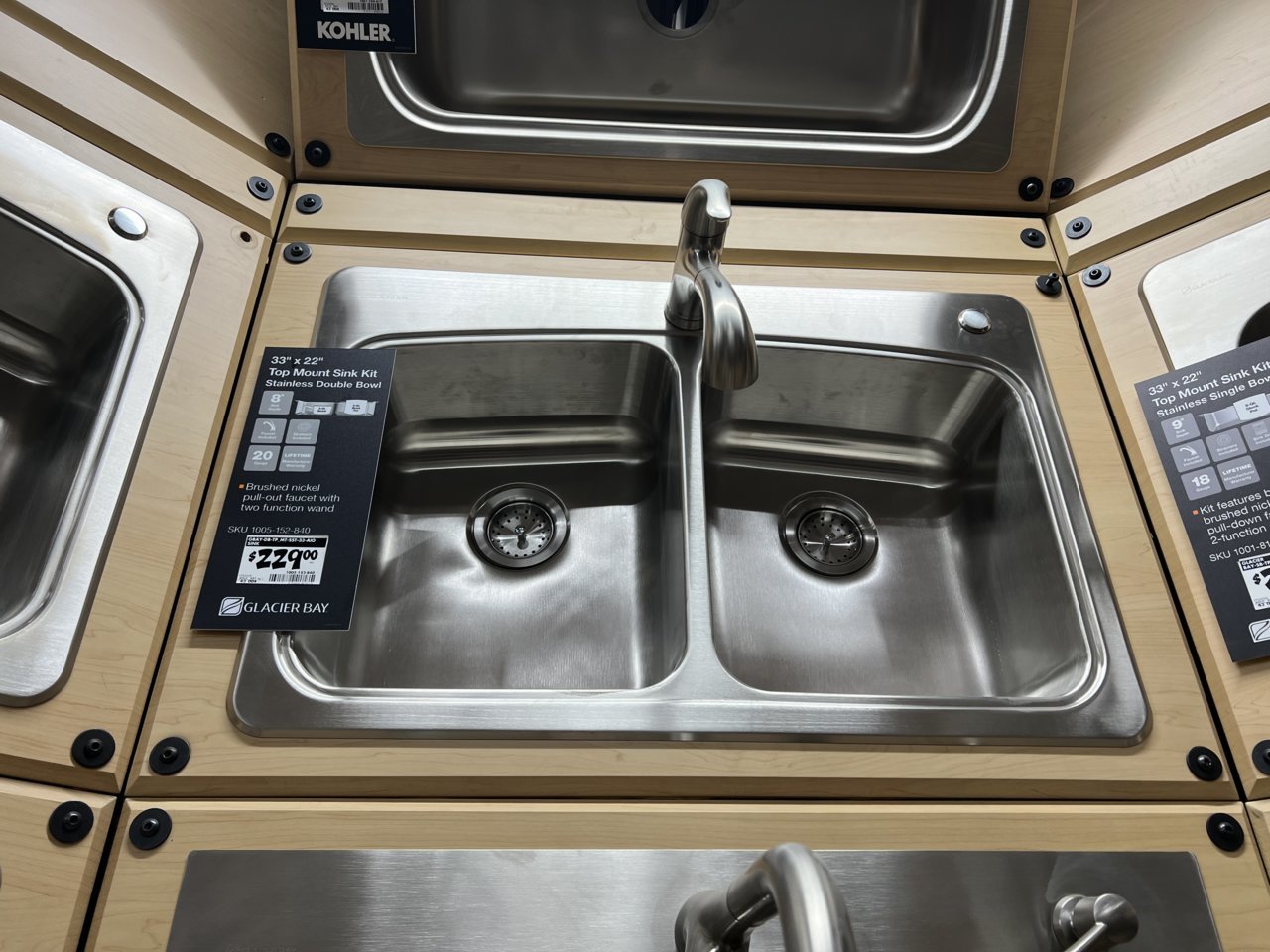

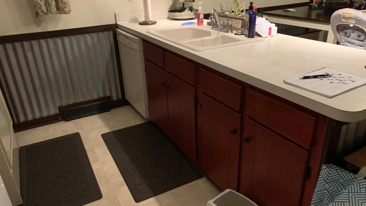

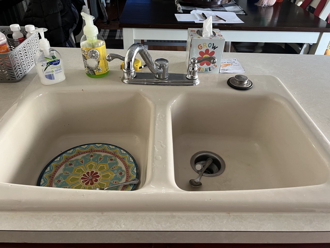

    Going from this…
    To this…
    Would this be considered upgrading or downgrading?

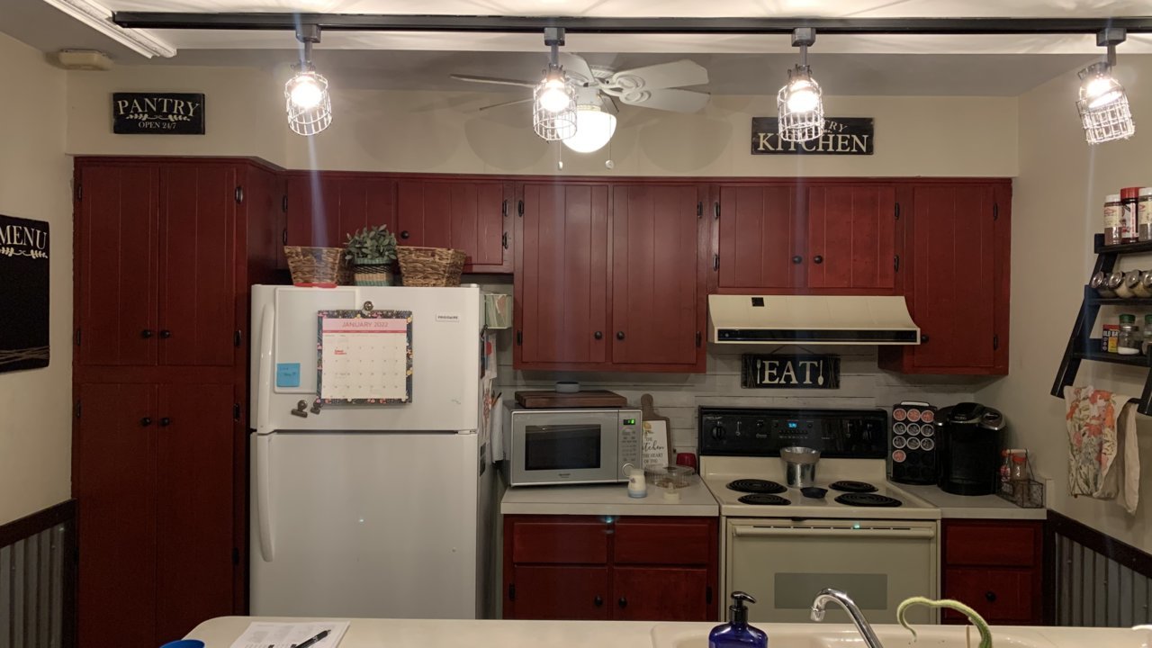

    Here’s the kitchen. Notice I have half metal lagged wall all in the dining room.
    3DA544C2-7DB1-49CB-AE62-A1409FBC9A12.jpg A015FA0A-3923-474C-9E2B-0D3E96F02E00.jpg 485008D0-1B5B-4441-984C-677D137015B8.jpg
    To add some more info, my garbage disposal took a dump and am looking to replace it with straight pipe. The faucet has a small leak on the outside and needs replaced eventually. I thought to go all new assembly on everything is the way to go.

    I love my glacier bay single basin drop in sink. Was $279 iirc. Id highly recommend the single basin.

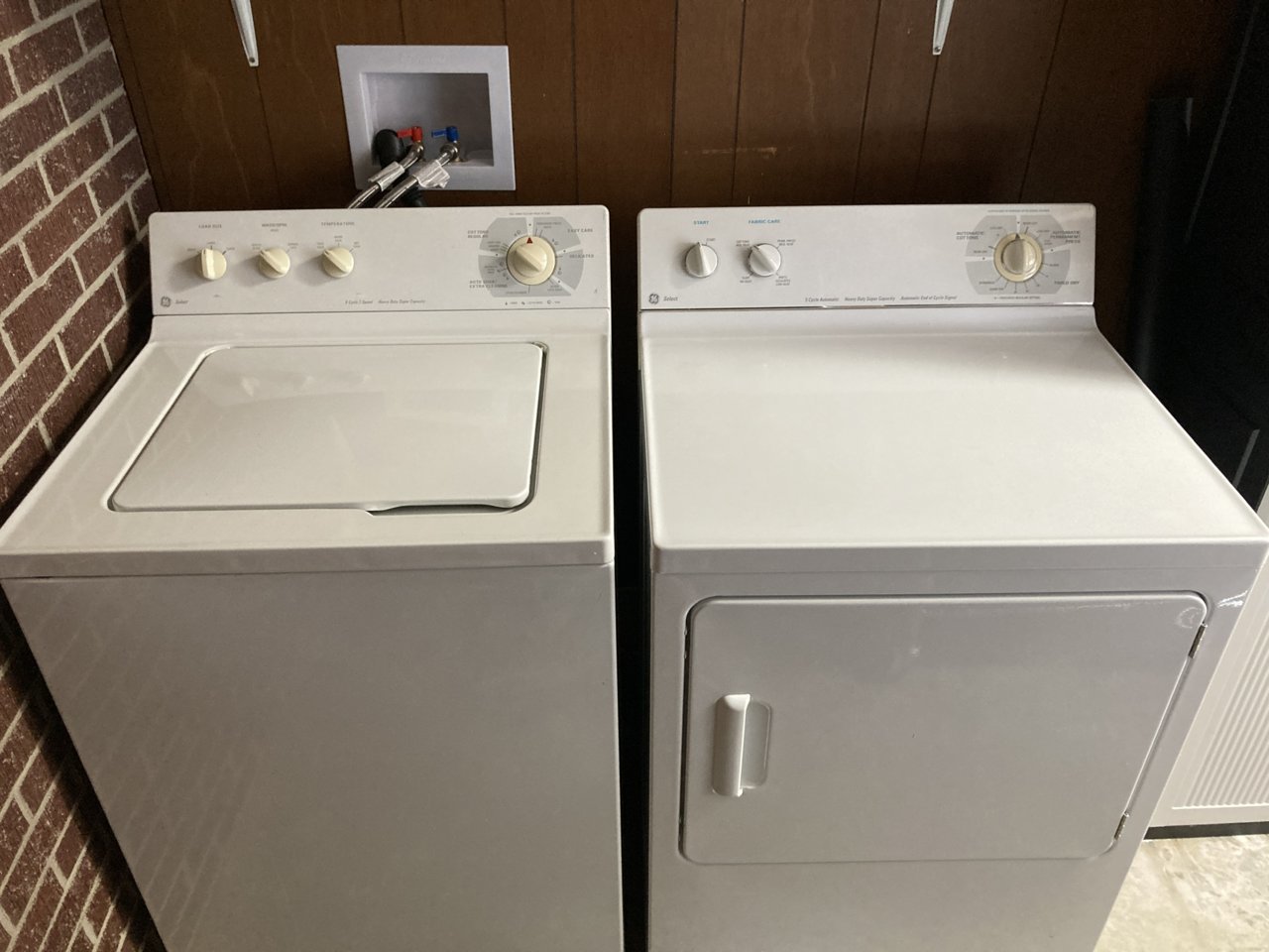

    Finally got my washer and dryer put back in place after putting in a new outlet box. Patched up the hole from the old location, new braided lines, and put in a new dryer vent tube. Now I’m just hoping these units will last a good while longer. Although not used heavily, they’re from 2001.

    Id say its an upgrade. Gonna look good!

    Seems to be the consensus. Will do.

    keep 'em running if you can! easier to work on with mechanical timers and simple electrical contacts, no circuit boards! mine are from the 90's for a similar reason
