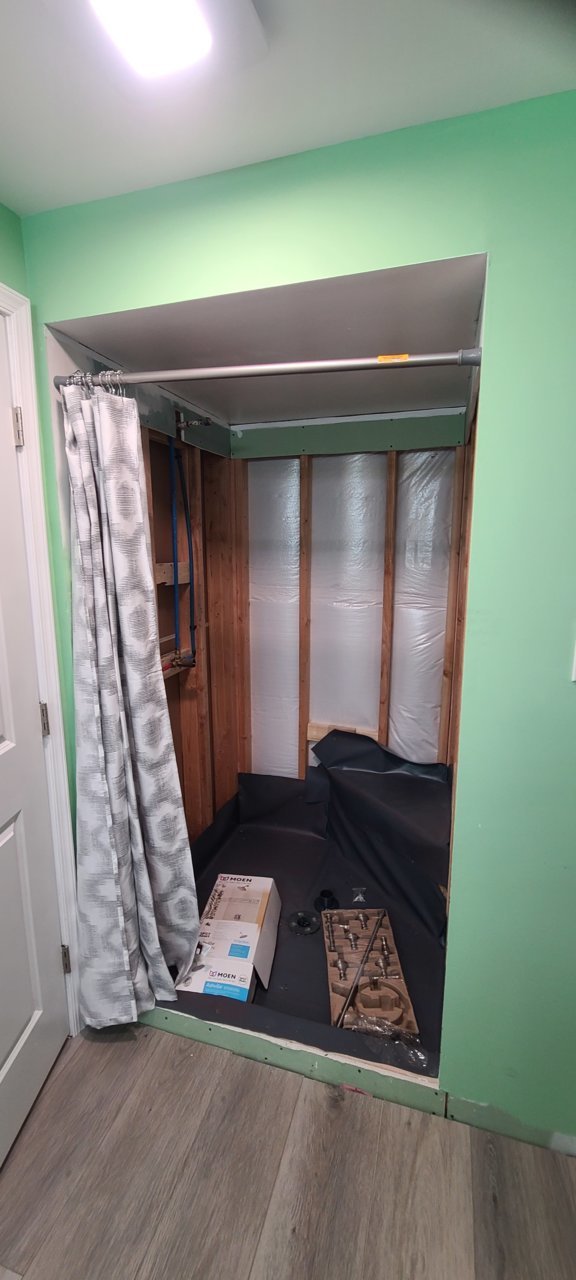

    I was going to say be careful with the plumbness (is that a word?) of the framing if you are getting any kind of a nicer door. Couple of years back I had a basement shower, bath that we needed a to replace the old plastic accordian style door. The new glass door required very tight tolerances on the plumbness of the opening. I always do my own tile work so whatI needed an expert on framing and we got it done correctly, and my son did my plumbing rough in (not too difficult , but he is way better than me). Advice if there is any possibility of getting a better door down the road , pay close attention, (or have your carpenter do so) to the plumbnesss of the walls and openings. As any good tiler will tell you, when installing the tile is not the time you want to find out your walls/openings are not square/plumb. Good luck with your project!

    if your neighbour can do a leak-free epdm pan why is he not tiling your shower ?

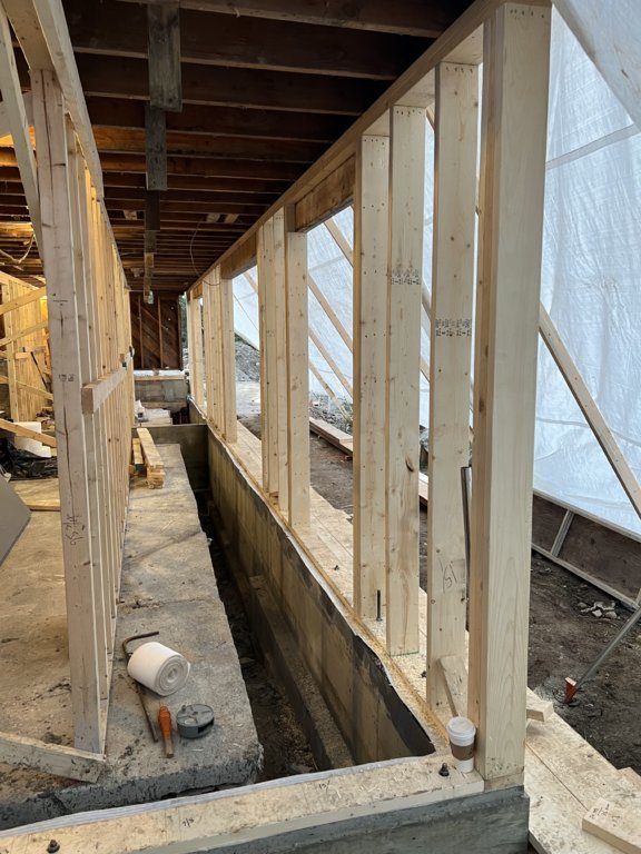

    We have our new foundation work all stripped and material cleaned up , shot all our studs with the builders level to give us a perfectly level underside of existing floor framing and today cut and started installing the new exterior wall framing
    We still needed to jack up the old house in the odd spot to get the new studs in but finally the house is actually bearing on its new foundations
    Outside planks are a temporary walkway as we don't backfill / infill till Tuesday

    I know you’re not in termite zone but why not put PT on the bottom plate of the wall framing?
    This question is for personal reference out of curiosity. I would assume cedar is too soft…

    we have subterranean termites here
    using PT for bottom plates is pretty uncommon here as there is really no advantage to using it . The SPF is isolated from the concrete with a sill gasket and all the SPF material is kiln dried whereas the PT lumber is usually soaked

    No option for drying PT?
    what / how is it isolated? Moisture barrier?

    sill gasket is installed between the sill plate and the foundation concrete
