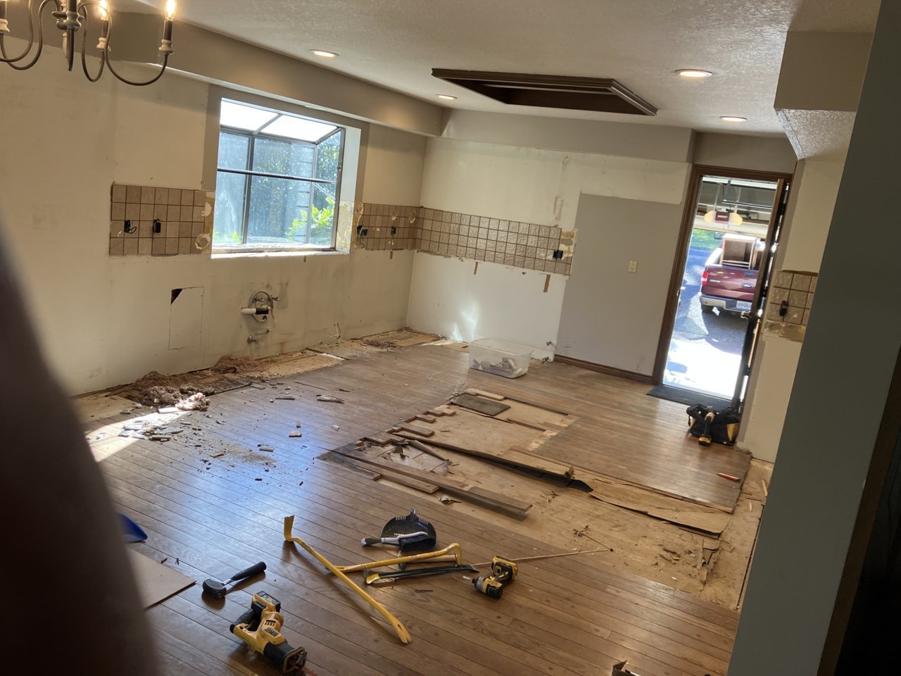

    So my cooktop has copper 3 conductor on a 30 amp circuit and the oven has aluminum 2 conductor on a 40 amp circuit. I’ll have to check wire gauge. I tossed the cooktop pigtail into the crawlspace and screwed plywood over the vent hole so now it’s time to check out the crawlspace.
    Mouse death toll: 4.

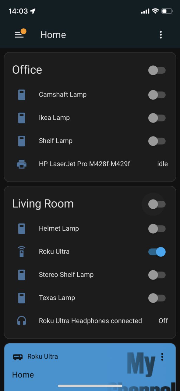

    Dipping my toes into some home automation again. Have a bunch of sonoff s31 lites running esphome and controlled from home assistant. Have a couple extras… maybe I can disembowel one and build a garage door monitor/controller.

    Ok, my dreams of recycling the cooktop Romex are dead, it’s 10/3 while the oven currently has 6/2. So I guess I’ll have to pony up some good money on 25’ of 6/3?

    might only need 8/3
    AL should be upped 1 size over CU for a given load
