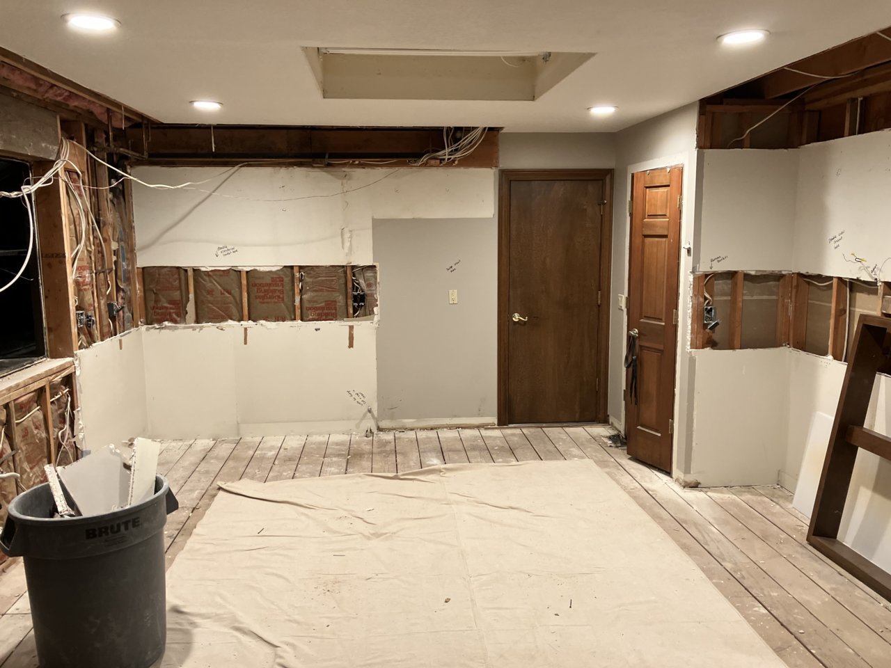

    Contractors made a little progress with extra demo today. Now to buy copper wire.

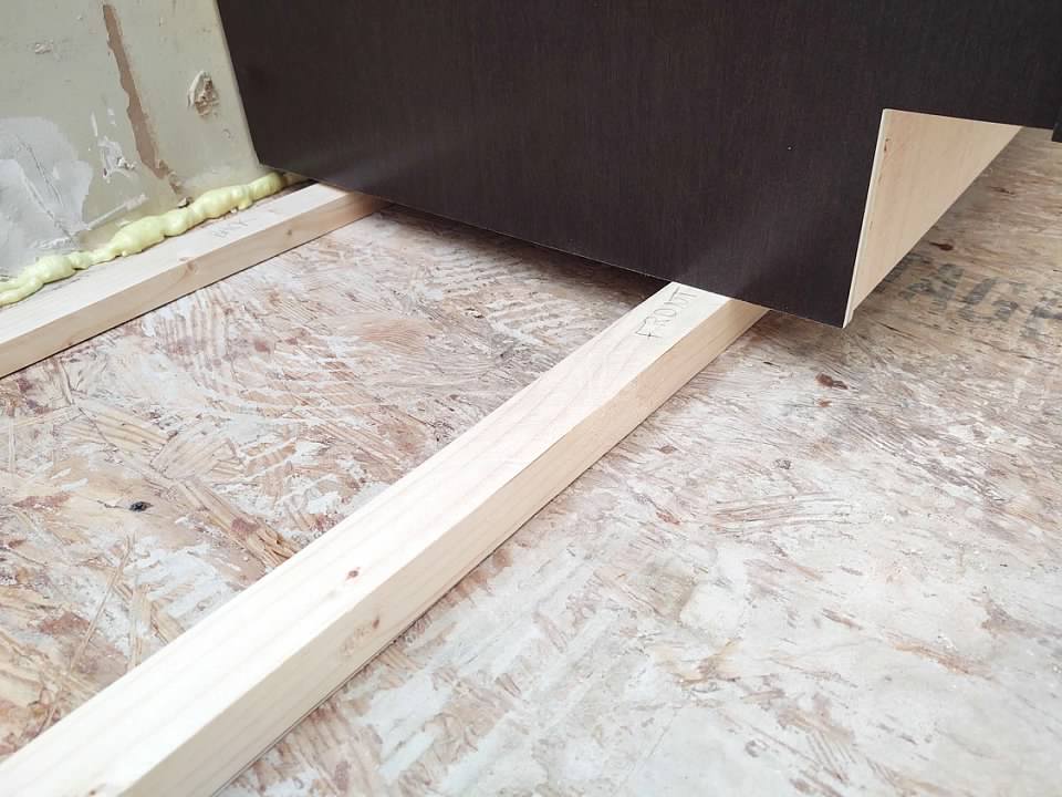

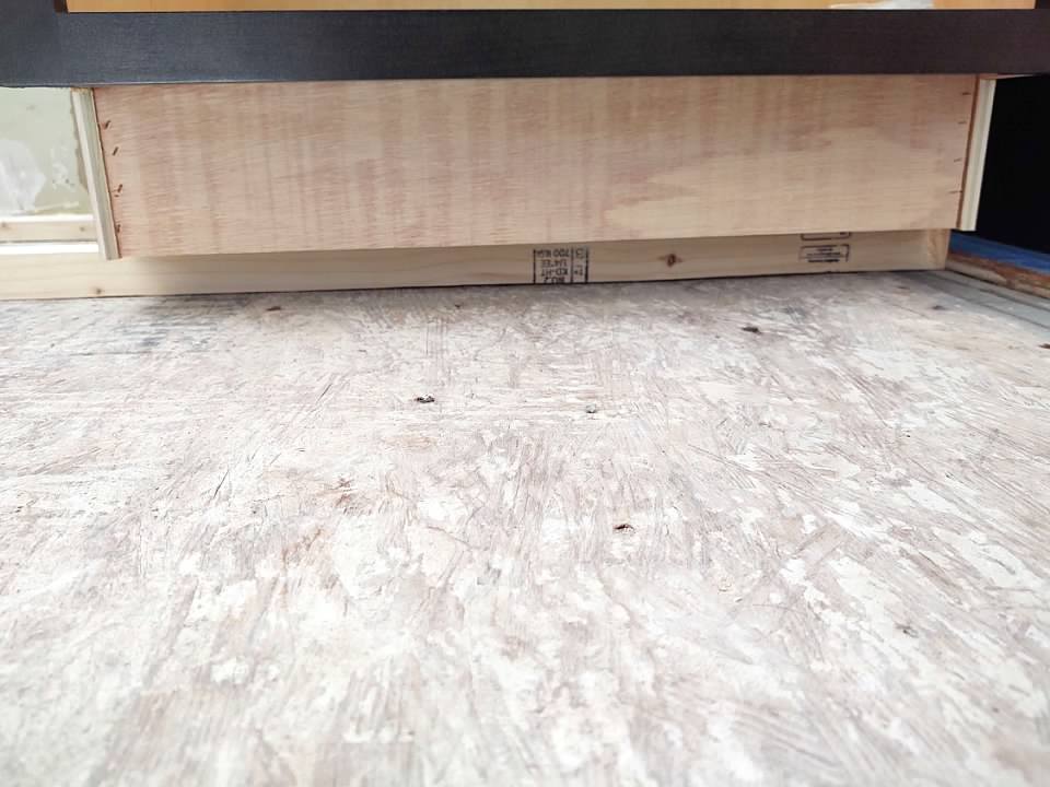

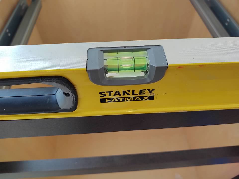

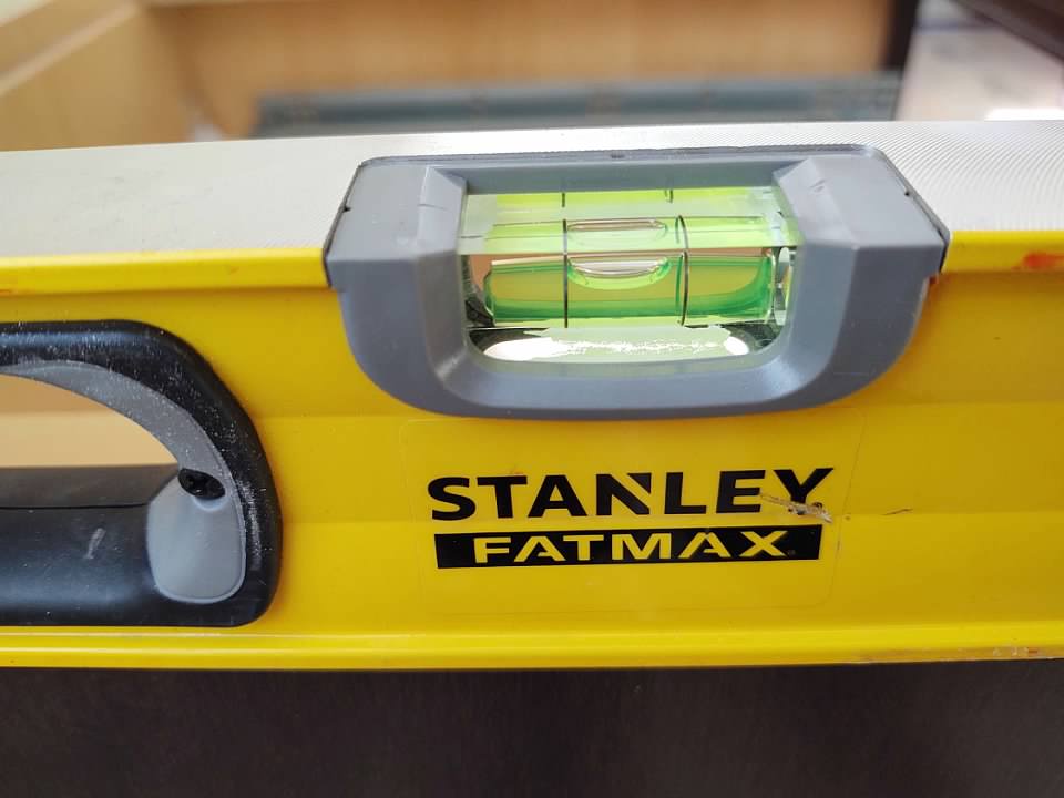

    Did some drywall repair (electricians left some big holes), some canned spray foam insulation along the floor and measured & cut those long (112") wedges/shims. Did a quick test dry fit and everything is pretty close and can be leveled with minimal shimming. Room also slopes to the center, so the front shim is 1/2" taller than the one against the wall. Back is 3/8" to 1 1/4" and front is 3/4" to 1 3/4". Good times! I'll lay everything out tomorrow and glue/screw those long shims down and hopefully get that run installed. Pics are of the far right cabinet set in its rough position and it's pretty darn close to the 34.5" level line on the wall.
    Front to back:
    Side to Side:
