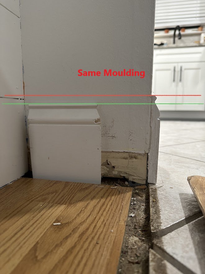

    Whats the best route to go here? Before I moved in I had my kitchen redone and we used some more modern floor moulding with the thought to eventually convert the rest of the houses moulding to the same as time went on. I just built a new electric fireplace and looking to continue this moulding into the living room, but running into some minor issues.
    Issue 1: As you can see i have about a 3/8" difference in height as the moulding that was there before sat on the houses slab instead of on the floor like the kitchen's moulding is and then the quarter round was attached which was on the floor. Im thinking I should cut/fit in a 3/8" Thick x 1" W shim to bring it up higher to match floor level of the living room which would make the moulding all sit the same height. But then i still have a gap between the moulding and the floor and leads me to issue 2.
    Issue 2: Is it normal to still use quarter round with this newer taller moulding? Only reason i ask is cause the gap from my pergo floor to wall is about a 1" gap (with no moulding) and the moulding itself will not cover the gap entirely. Would quarter round with modern moulding look dumb? or is that normal? What else can I use to bridge the gap that would be left after installing the moulding instead of quarter round? If i do go the shim wood piece fill in route i could paint/stain it to match the floor and maybe that would make it look okay. Maybe i am missing or not thinking of a simpler solution?
    If i do use quarter round with this in the living room, is it weird if i dont also add quarter round with it to the kitchen?

    Shoe (or any small moulding wide enough) moulding is pretty much your only option to cover the gap between the floor and the baseboard trim regardless of what trim you use. It would cover any shim you use to raise the moulding to match the kitchen height. I can't think of anything (other than custom milled) that's more than 1" thick.

    Thanks! I guess that is what I'll have to do then. I don't want to do custom at 1" thick cause I feel it wouldn't look right coming around the corner unless the rest was the same but that's a good point to avoid any need for shoe.

    You could get creative with the transition if you went with something thicker. Maybe run the new thicker trim with a return to the outside of the kitchen trim. Looks like a threshold is needed to. That'll help with any perceived visual distractions. I've found that most people don't notice things that I spend too much time worrying about....just like something like this.

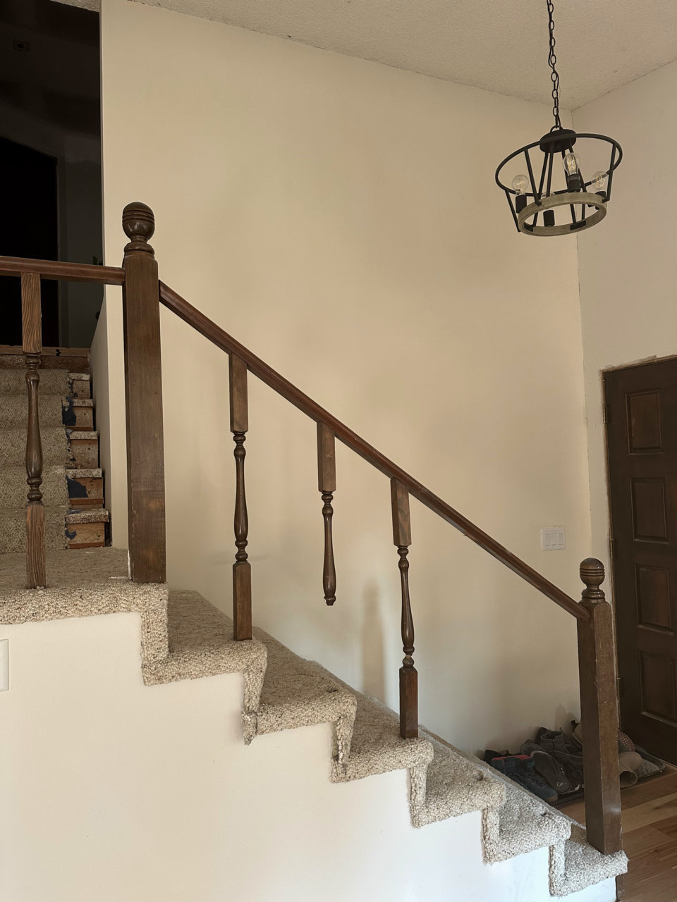

    Slowly working through this... I got the ceiling and the walls all textured:
    Remember how jacked up this wall was? Man... It's way better now.
    We'll be getting new doors (haven't decided on a design for them), but for now I finished all of the painting on the walls and on the trim. The walls are painted with BM Signature (Ben) and the trim is all BM Advance in a medium gray tone to match the downstairs trim. I haven't finished trimming-out this space yet. I'll do this whole area and my downstairs baseboards all at once.
    Then I moved on to the super tedious task of laying the wood floor in the hallway. I would rather lay floor in a 2,000 sq ft open house than do a tiny hallway like this. I started by making a custom nosing that I had to shim to account for a dip in the subfloor. I wish this task was as easy as the pictures make it seem. This area took me several days with the warped subfloor. Lots of custom cuts to make the gaps close with the floor dips.
    From there I started on the stairs. Each tread was made using my old floor boards.
    I had to cut the nosings off of the old structural tread (designed for carpet), and then I made finish risers out of simple 1/4" birch plywood. I have a tread gauge that works nicely for getting all of these measurements tight. Risers are painted with Scuff-X.
    There is about a half can of PL Premium under every tread + a series of 16 ga finish nails.
    I'll need to circle back and do a second coat of paint on the risers and fix up the drywall I didn't pull tight enough during my skim coat.
    Then I moved on to the open portion of the stair case. Also known as the bane of my existence.

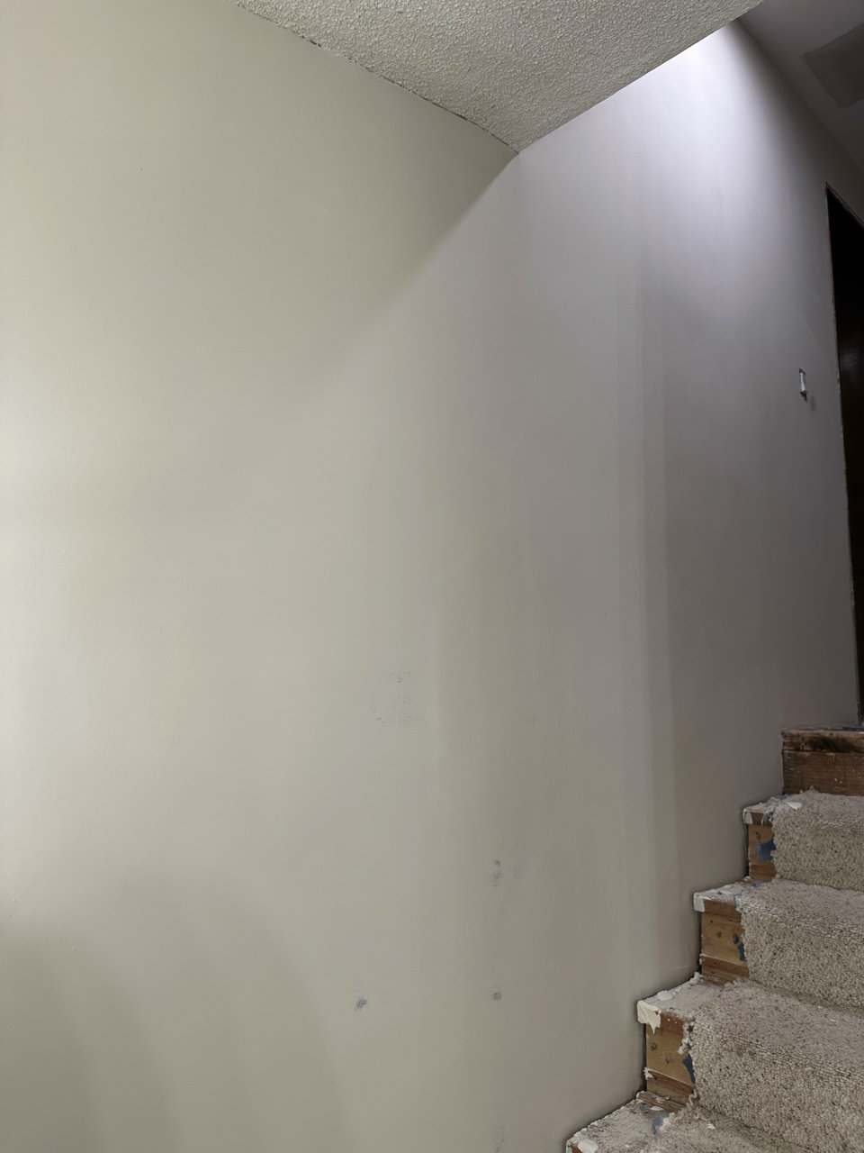

    To start I ripped off the carpet to reveal just how jacked up my drywall is from the carpet nosing. Check out the gore:

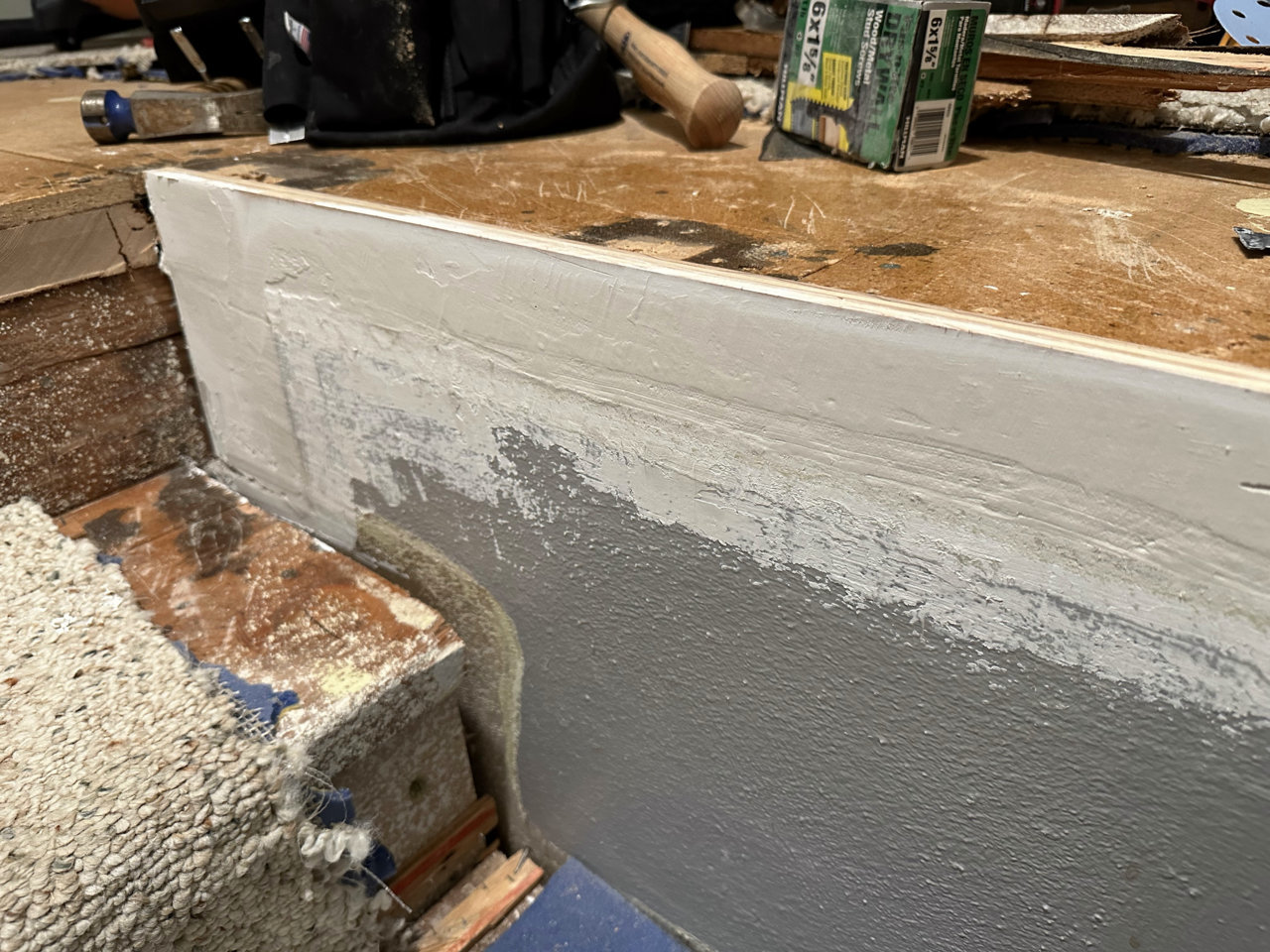

    The idea was to install some finish risers that looked like they wrapped around the staircase wall. To do this I had to get a little creative. I started by cutting some finish risers to the shape of each structural riser using a jig, then I used some stop blocks to pull the risers flush with the drywall on the end and the tread on top. Prybars helped get it in place snugly while I tacked it.
    Then I did 3-4 coats of mud on the sides to make them look like they grew out of the wall. This was tedious to say the least. When all was done I textured the wall side and painted the risers white.

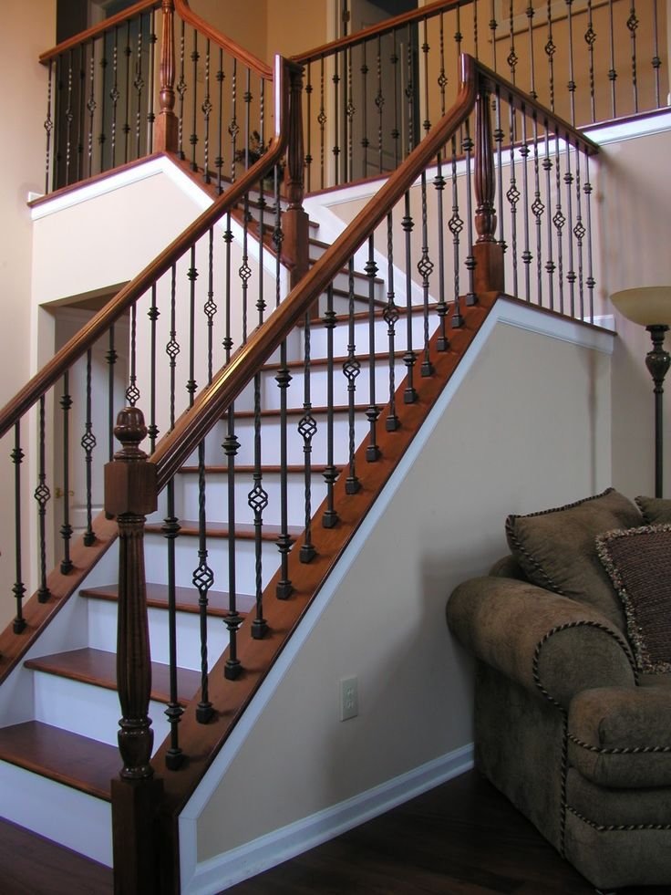

    Wow! What are you using for the stair railing? Wrought iron with wood banisters maybe?

    Close! I’m going a little more contemporary. We got some solid hickory newel posts and hand rails. For our balusters we went with powder coated steel round bars. They’re going to be laid horizontally — so like a ladder balustrade. I know some people don’t like horizontal, but we don’t have kids and what not and we think it will match the vibe.
