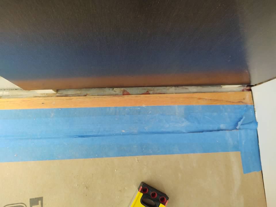

    Today I fixed a gap in my luxury vinyl flooring my office at the door threshold. I got tired of MIND THE GAP!!
    The numbskull installer (hahahaha) didn't think about the planks actually sliding when forced........easy fix dough. Just remove base trim on one wall opposite lever the run back in place (moved pretty easy) then cut and fit some wood filler blocks under the drywall (and trim naturally) to hard stop movement. Pin trim back in place with 18g e nailer. Vacuum. Done. Hug wife.

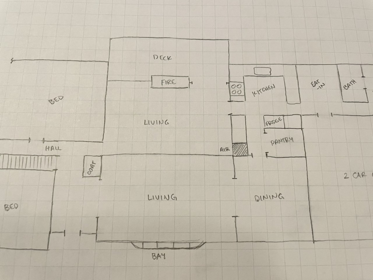

    I LOVE the layout shown in your sketch! What's wrong? Many buyers would snap that up.
    What's on the other side of the shitter behind the dining area?

    Laundry area.
    we don’t hate the layout we just don’t know how to use it. We prefer the living room with the fireplace for hanging out in, and we will open it up that little bit to the kitchen when we remodel the kitchen.
    we just don’t know what to do with the front living room. We don’t use it, because there’s not a good furniture layout that doesn’t block the large window. Do we just make it a sitting room? A useless sitting room haha

    Just keep it open with light furniture, IMHO. I would not spend a dime remodeling it unless it looks old/tired. IMHO.

    I appreciate that, makes my wallet happier. It definitely needs cosmetic (the fireplace living room is all paneling lol) and the kitchen is “updated” but just like 2000s style. We can afford to do those updates over the next couple of years and maximize our profits.

    It's a good layout already but if you're set on making a change how about boxing in the 'eat-in' area turning that into your pantry, knocking out the existing pantry, and move the fridge over to the pennisula (which would now just be a bank of uppers and lowers on the wall backing onto the new pantry. One plus from this is you won't be eating breakfast in the 'eat-in' area while hearing someone is making room for breakfast in the bathroom right beside you.
    This also would tighten up the 'working triangle' for the kitchen (Fridge/Stove/Sink). You could throw a small island approximately where the fridge is now, all depending on your feng shui feelings of impeding the 'hall that comes from the livingroom, thru the kitchen, down to the bathroom.
    This would open up into your current dining area and then that could be your main dining area (instead of having the two tables).
    If you have you want to go whole hog, you could have a window above the sink, and one in the dining room to really increase the natural light in those rooms. Sky's the limit really.

    I like that idea and have considered it too, for the same reason you said…the toilet. But the eat in area is really just some barstools for us right now. We don’t eat in there because it’s too small for a table. There’s also a large window in that space that gives a ton of great light but of course you wouldn’t have known that since I didn’t say haha. Here’s a picture

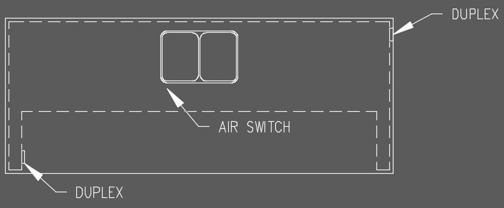

    First off, I wouldn't use a single receptacle unless you need a dedicated outlet for a high draw device. Put duplex in everywhere.
    For the disposal switch, my sink is in an island so they used an air switch which is nice and clean on the countertop.
    All of my receptacles are mounted to the bottom of the upper cabinets like @MGMDesertTaco 's. Our most used appliances just stay out on the counter so there isn't too much changing out for us.
    I will second the end of the peninsula receptacle, too. I use that one constantly. If you'd like one there but want it concealed, the other end of my island has one like this:
    Thrown an extension on your right side under the overhang and put one on the inside face.

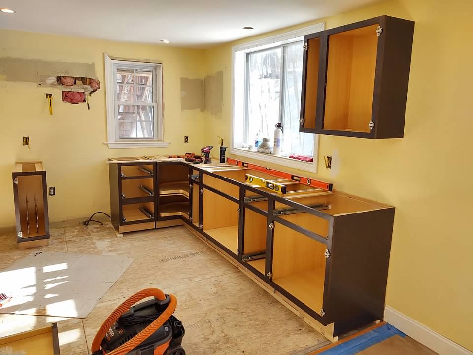

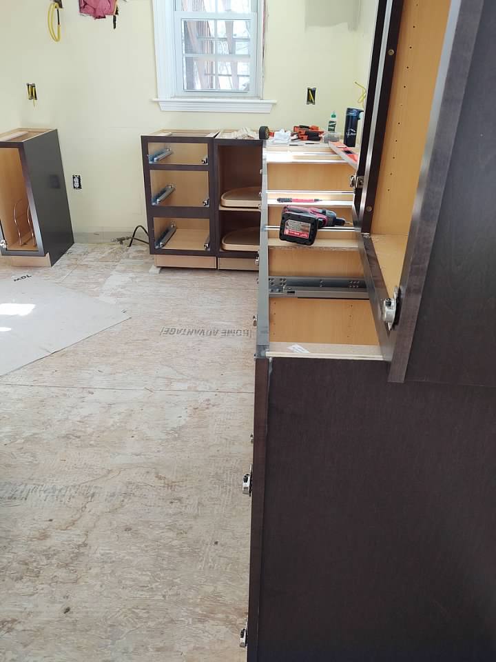

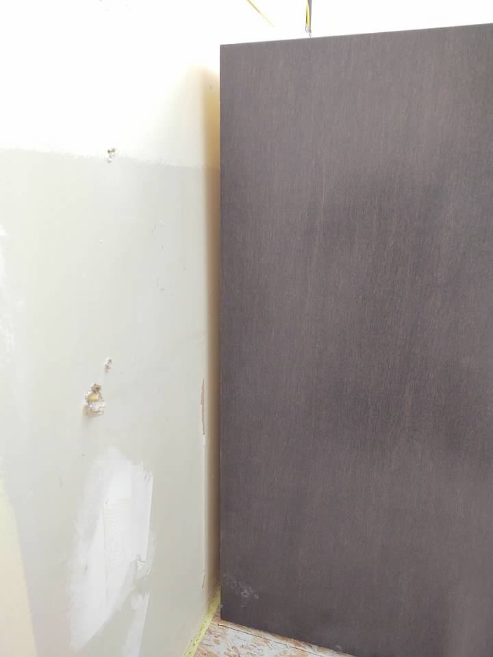

    Great progress today for working solo. Got the long run of cabinets and a couple uppers installed. That wall was so out of square I ended up 1/2" off the wall at the end of the long run and 1" off the wall at the left of the corner cabinet. There's only 1 cabinet to the left of that and I can probably bring that back to 5/8". I attached all the cabinets to each other before determining the final position. Was able to shift the entire assembly. Not a big deal as the range will be there. Everything is plumb, level and straight. Those long floor shims worked great. I like to put blocking (1/2" in this case) along the back edge of the cabinets to keep them running straight. Also I ended up even where the far right cabinet meets the dining room floor. So all in all, given the situation, I'm quite pleased. Oh, customer is going with granite (or some stone) countertops. They should be able to custom fit that to the irregular walls.

    ah well you've got a nice bright kitchen space! I wouldn't change much then. The house we're in now is great, but there are features we're not in love with. We've weighed making bigger changes but I've worried that it'll snowball into updating the entire house as it progresses (yay open concept design... arg) But we're taking it as live in experience for when we design and build our next house once the kids move out.... sometime around 2040-2050 I recono_O
