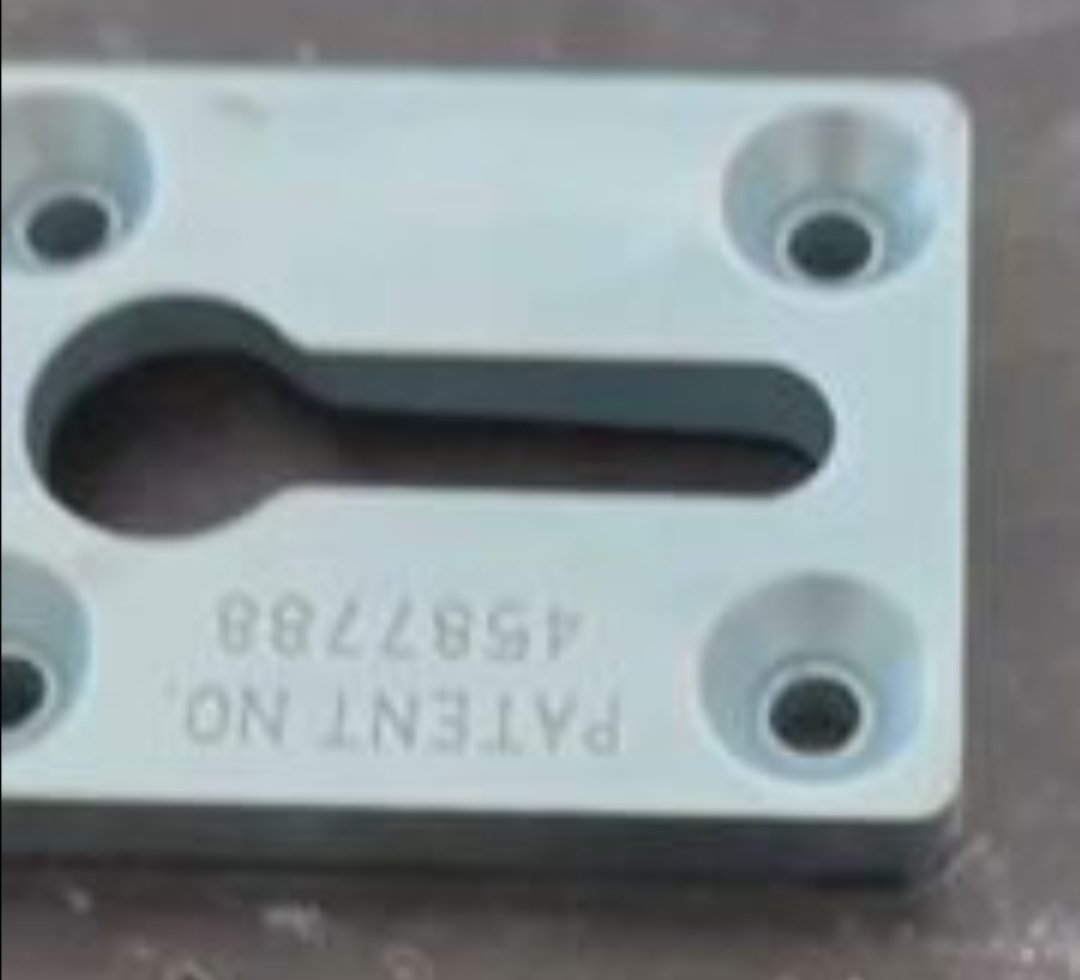

    There’s a 5/8” lag that is 5” long in the bottom of the newel. The head is left about 1/2” proud and goes into the key hole. Then you strike the newel and it falls into a tapered slot pulling it tight. You install it so that it tapers toward the open part of the straircase — so if anyone braces against it it’ll pull tighter. Takes a lot of force to pop it out the other way. Idk if I trust it though. I think I’ll fill the keyhole with PL Premium when I do the final install.

    I see , so it essentially retains the base of the newel and the top is braced by the railing ?

    I was interested too, found these. The angle on the bottom side makes sense, I was imagining a flat keyhole rather that a keyhole with a wedge to lock onto the bolt head.

    Yeah that’s them. I’m using their handrail fastening system as well called MiniLock. Same concept just in a smaller package. Still I don’t really trust it all so I plan to fill the whole mortise with construction adhesive. Call me paranoid.
