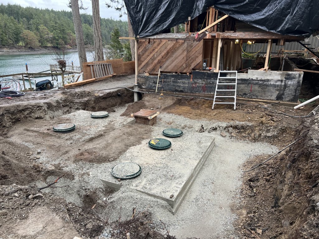

    Now that our tanks are in and compacted backfill around them we can complete the foundation work around the tanks to rebuild this end of the house we tore off
    in the meantime the basement rear side bearing wall has been removed so we can enact repairs to the top of the old foundation wall and re-frame

    Knowing nothing about code, or industry norms, is there a general rule of thumb for how far away from the home your septic system should be?

    there is , this is not a standard installation
    we have 3 variances on this job , plus a structural engineer , geotechnical engineer , septic system designer and a biologist
