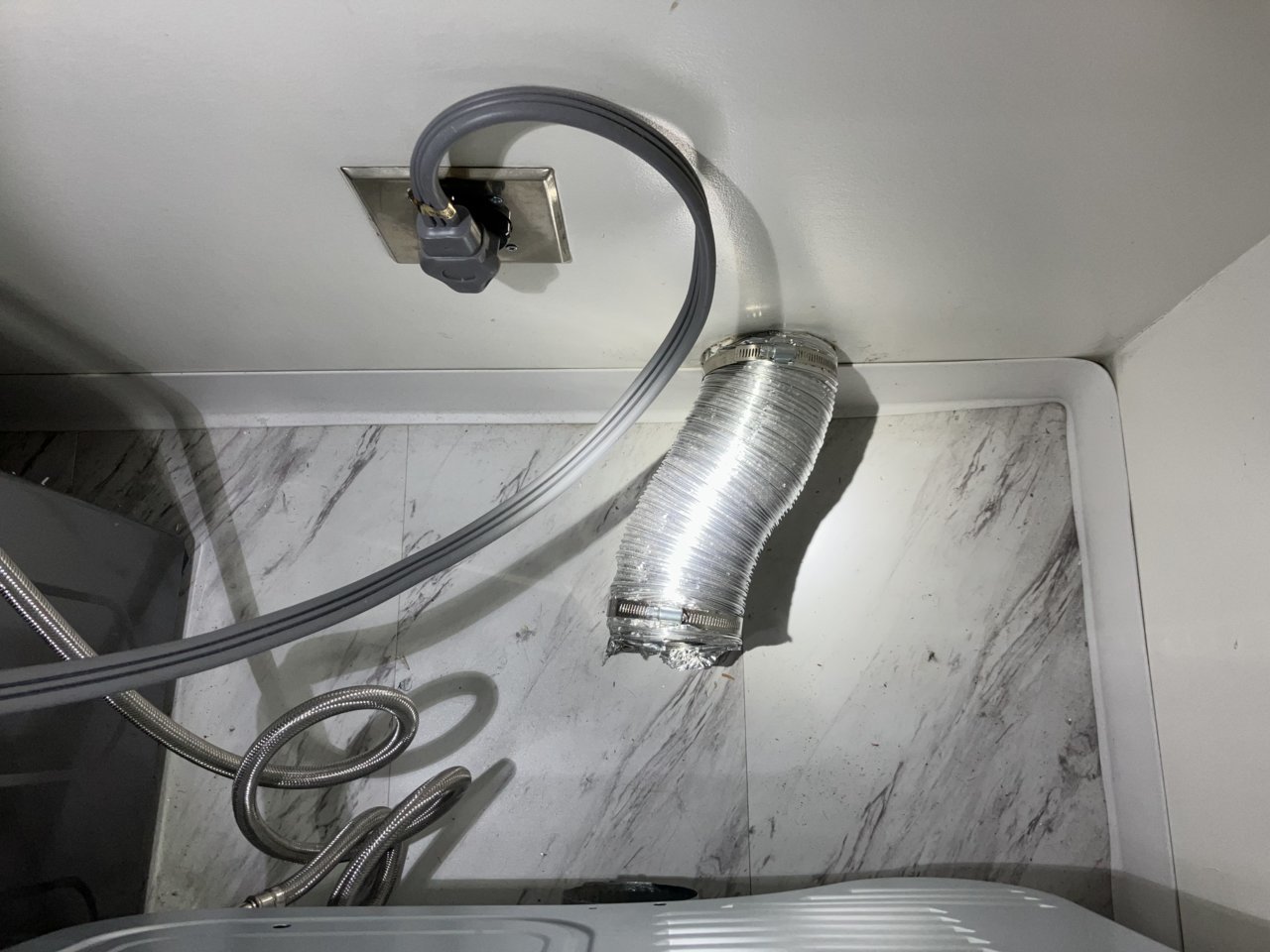

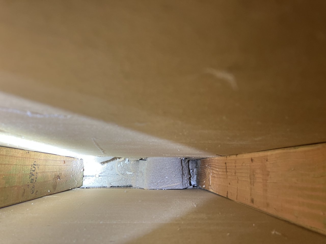

    What are your thoughts on the mag on the face of the dryer box inside the stud bay and elbow inside the cabinet on the other side of the wall? Or a frame rectangular drywall box? That buys back 3.5” of hookup space and costs only 3.5” of cabinet space. Likely that part isn’t used much since the depth is 24” there and below an oven is mostly oven pans.

    step 5.
    i would entertain the idea of thickening the wall by the washer/dryer to allow a 4" pipe to smoothly transition into the crawl space.
  4. Feb 12, 2023 at 8:35 AM
    soundman98
    soundman98 Well-Known Member
    May 31, 2021
    #367288
    6,196
    NW Indiana
    '18 Taco Sport, '14 Ranger
    i think the main concern is going to be fire code. as long as there's at least 1" of airspace around the vent pipe for any solution, i think you'd be good to go.
    the drawer below the oven ought to have 1.5-2" to the cabinet back, depending on the cabinet construction, there's either 3/4 or 1/4" laminate back there, usually plus another 1/4" to the drywalled wall behind it that ought to be 1/2-5/8" thick.
    so all those assumptions, pushing the dryer flat to the wall, and cutting into the cabinet all the way to the drawer, you should have about 6.5" minimum to play with, not including adding a wall back into the back of the oven cabinet.
    daveeasa[QUOTED] likes this.
  5. Feb 12, 2023 at 8:50 AM
    daveeasa
    daveeasa FBC Harness Solutions
    May 14, 2020
    #328079
    7,481
    David
    PNW
    2016 Tacoma OR DCSB 6MT, 2005 RC 5MT PreRunner, 2002 Tundra SR5 RCLB 4x4
    So, the mere fact of a vent being within a stud bay gives it some sort of fire rating which is superior to being within a cabinet? That sort of makes sense to me, stud lumber being fire rated while cabinet grade plywood is not?
    And, from that thinking, it almost sounds like building a stud bay box on the kitchen side to steal space might be the way to go?
    I think shortening the drawer by 5" might not really be too hard, those things don't typically open all the way anyway and 24" deep cabinet with 24" deep drawer is 4' away from the wall and into a primary walkway, so it's not going to see a ton of heavy use.
    Is there code against a trench in the board at the bottom of a stud bay wall? Given a 4" duct, ovalized and through said stud bay, pretty much makes an entire trench out of it?
    Let me get some photos, probably hard to describe this properly since I'm not versed in terminology.
    I love the mag connector b/c the upper cabinets make getting into the space behind the driver to tighten up the flex pipe clamps quite tricky and my 7 year old isn't trustworthy for this yet. Last time we had to install the dryer first then the washer and moving that washer is kind of a bear.

    Just throwing this out there. Some lg dryers have an option to bottom vent directly through the floor.
    https://youtu.be/Dce9Ec6fDxA

    This is awesome. With the mag seal it may be perfect.

    why would you need to meet a parting wall fire rating in a detached dwelling?
  10. Feb 12, 2023 at 9:38 AM
    OZ-T
    OZ-T I hate my neighbour
    Dec 15, 2009
    #27584
    50,587
    Peter North
    British Columbia
    again , curious why fire code would come in to play in a detached dwelling unit in this application
  11. Feb 12, 2023 at 9:41 AM
    daveeasa
    May 14, 2020
    #328079
    7,481
    David
    PNW

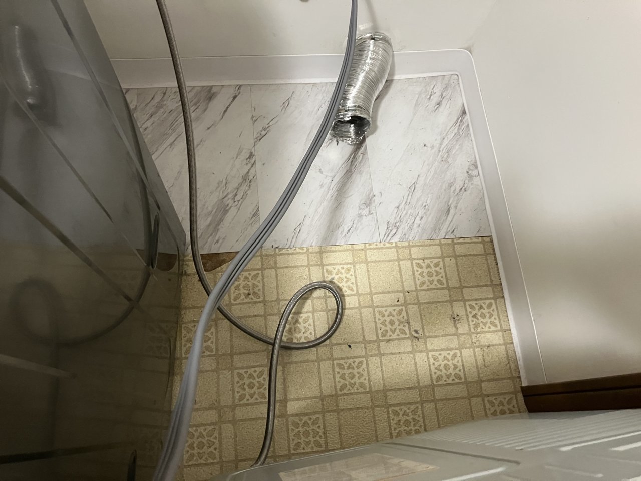

    Some photos. I see knockouts so re-routing vent through the floor may be the easy path. We already replaced a bit of the floor here due to water damage, PO’s never addressed a leaky valve, changed the core, now it’s good to go.
    93C960B7-2782-41F6-870B-EC407A6E83BF.jpg 0CABC2C3-D6DB-4068-A5CD-AEC247669ECB.jpg CAFACC91-8592-4B3D-8C6E-A04095E5EE8B.jpg
    Looking over this closer, that mag vent might get me everything I can really get with the least amount of effort. And if not, then I think I’ll get that kit to vent out the bottom and cut a hole in the floor.

    the Mag Vent would make a little more sense to me if the mag connection was on the dryer side of the flex and was slightly conical with o-rings instead of just flat

    where do the instructions say that detached dwellings need a different requirement from multi-family dwellings?
  15. Feb 12, 2023 at 2:48 PM
    OZ-T
    Dec 15, 2009
    #27584
    50,587
    Peter North
    British Columbia
    the Dryerbox instructions don't , fire code is applied differently to multi family parting walls versus detached dwellings , ie the steps for meeting the fire rating only apply if you need a 1 hr fire rating in that assembly
    Why would they sell 2x4 and 2x6 versions of the Dryerbox receptacle if there was no way you could install it in a 2x4 wall ?
