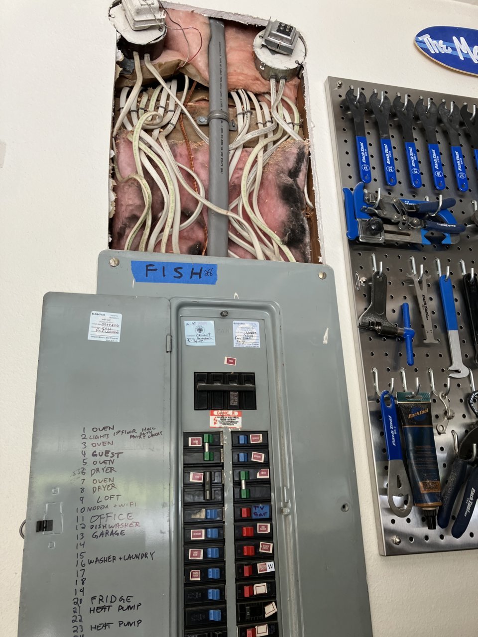

    I've found as many differing opinions on how 2 bars should be installed as there are pages on the internet. Good grief.

    4/0 AL. Any circuit past the first main, neutral and ground must be separated.

    [​IMG] One reason I like Square D Homeline, neutral bus runs entire length down both sides of interior. This model is a 40/80 200 amp. The way to go....

    Long rod is better than Siemens. Ya got me there. Wish my bar had more spots.

    What was the 4/0 about? Am I misreading my supply or is it not rated for 200AMP?

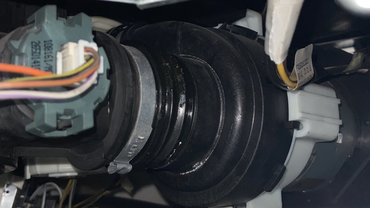

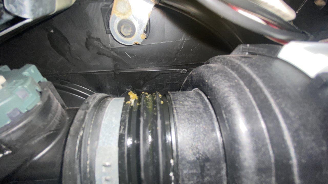

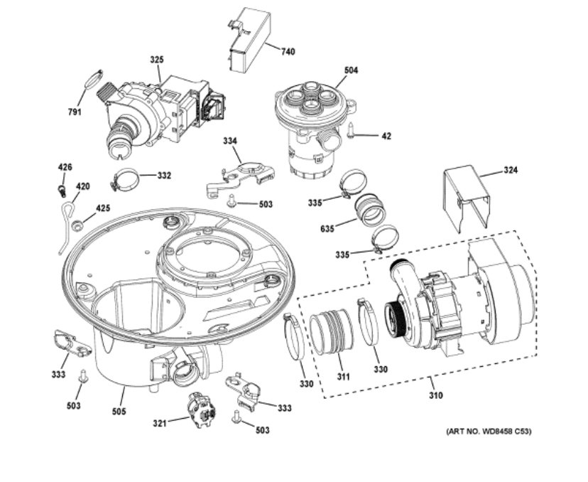

    Working on a GE Cafe dishwasher the past two days. It is going into CSM mode and tripping.
    I found a leak in a hose dripping in wire harness. Waiting for part but don't see how ti remove and attach new part. Schematics show 2 clamps and I only see 1 one mine. Looks like the hose on one side goes into then pump inlet rather than over. Anyone repair one of these before? Part 311 in schematics.

  9. Feb 18, 2023 at 3:13 PM
    IPNPULZ
    IPNPULZ Well-Known Member
    Jun 16, 2014
    #132087
    13,855
    Deeper in the South…….
    2023 TRD Off Road Premium 4R
    going to be fun!
    I think you have to drop the whole pump assembly….
    asuchemist[QUOTED] and wilcam47 like this.

    Hold on I’m digging through some service manuals

    Meaning buy the whole assembly?
    wilcam47 likes this.
  12. Feb 18, 2023 at 3:23 PM
    wilcam47
    wilcam47 Keep on keeping on!
    Jan 27, 2016
    #176243
    54,920
    Will
    Bourbon state
    Looks like theres a second clamp there

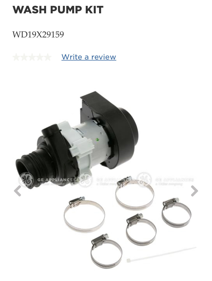

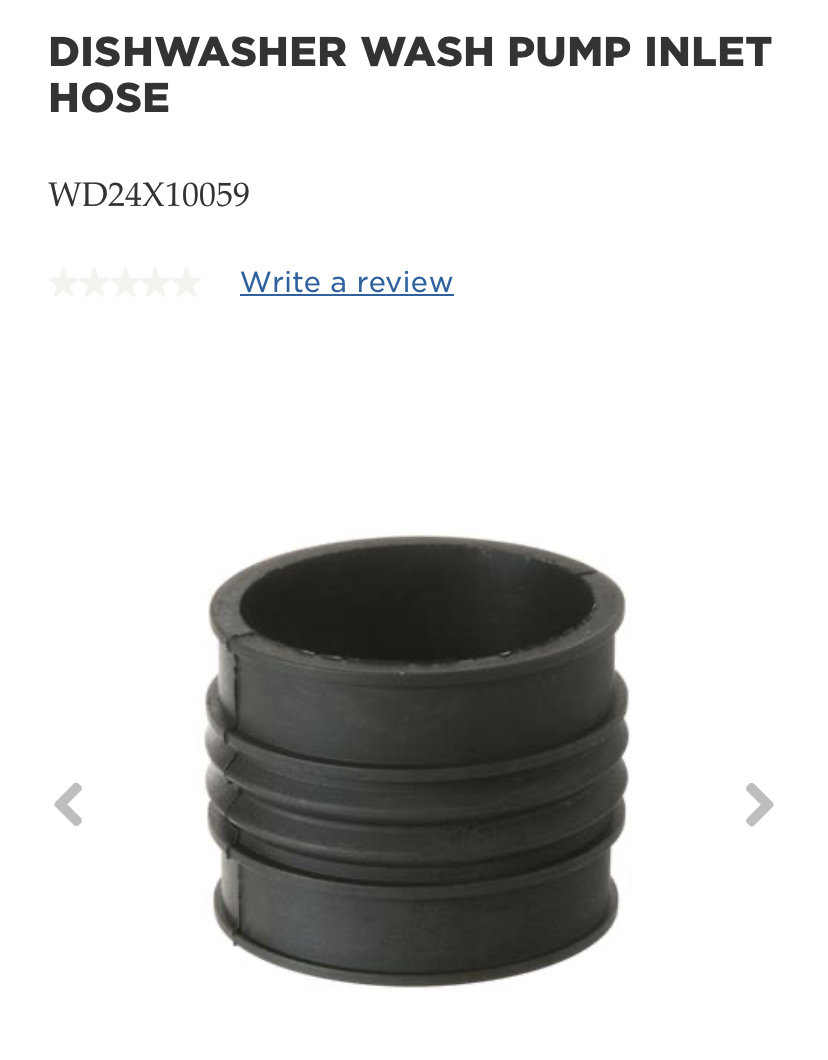

    You have model number? That WD24X is a part#
  14. Feb 18, 2023 at 3:25 PM
    asuchemist
    asuchemist My Hamstrings Hurt!
    Mar 29, 2013
    #100895
    2,084
    South South Dirty Gilbert
    11' TRD Sport V6, 23' TRD Pro 4Runner, 23' Tacoma TRD Pro
    NONE
    CDT725SSF7SS dishwasher
    old pump WD26X22285
    trying to replace just the hose.

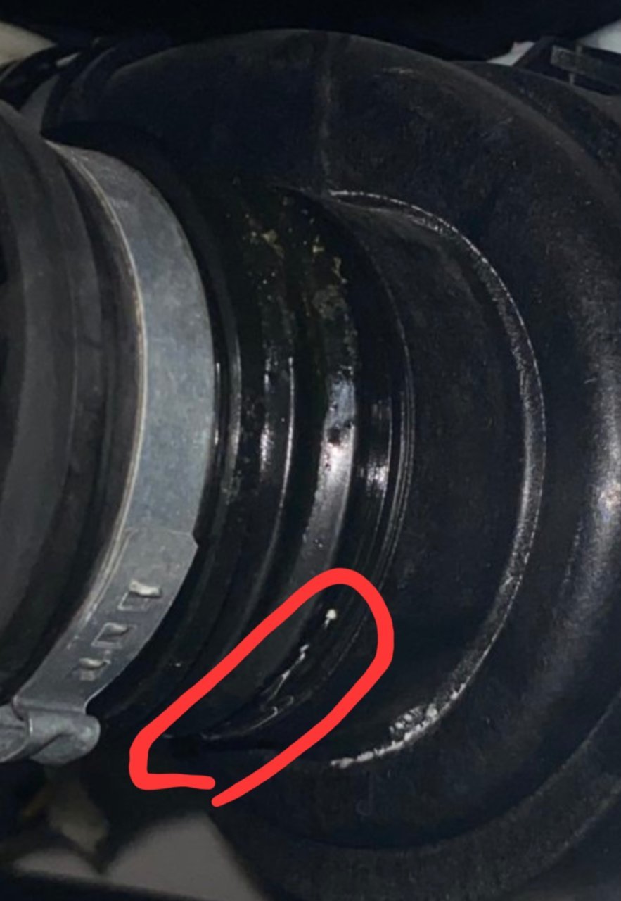

    i think that was just water droplets.

    nice, looked like it was a clamp. Maybe reflection off the other one:notsure:
    Quality control missed it or someone replaced it before.

    i looked at my old pump and the new pump on ge website (old pump reference pic attached). i guess when i remove and install the dishwasher i will hope to find the hose on pump side goes into a grove/slot or something. i thought i can just change hose in place.

    Id guess the black piece locks into place. Which holdsthe hose in

    it's an electrical service using Service Entrance(SE) cable. from any meter to the first disconnect, the neutral and ground can be combined. this is the same as if the electrical service was ran in pvc pipe.
    @MoneyMan55 is correct. once a service uses aluminum feeder wires, code specifies using 4/0 on a 200A service. aluminum doesn't have the same conductivity characteristics as copper, so it takes a larger diameter wire to make up the difference.
    the electrician that originally installed your service wire misread electrical code. it's not currently rated for 200A in it's current form.
    typically, the gfi receptacles are a cheaper option. generally they're more preferable because they can be directly where you're most likely to interact with them instead of the panel. the plug-on-neutral is a really nice option though.
    hard to make out in your pictures, are they both ground bars? or is one a neutral bar that is on stand-off's and the other is mounted solidly in the panel?
    if either/both of those are ground bars, the metal enclosure of the panel serves as the path between. i'm not aware of any code requiring the 2 bars be connected beyond via their attachment methods to the metal enclosure.
    mixed feelings, as the homeline panel neutrals have only few more holes as the seimens, but are spaced out across the entire length. sometimes make panel swaps harder. homeline also never includes the chassis ground bars either.
