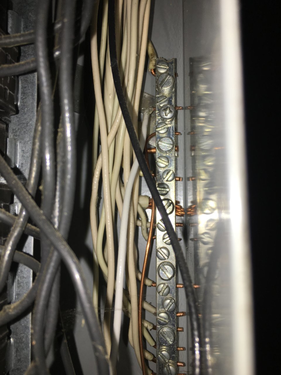

  6. Feb 18, 2023 at 5:35 PM
    916carl
    916carl Well-Known Member
    Jul 26, 2015
    #160332
    4,153
    Carl
    2008 DCSB TRD Sport SR5
    Both bars appeared to be screwed directly (flat) to the can. The bottom one has the main ground wire attached. All the neutrals were/are attached to the bottom bar, all the grounds to the top bar. I took a bunch of pics, this is the clearest one showing the bottom bar.

  11. Feb 18, 2023 at 7:03 PM
    soundman98
    soundman98 Well-Known Member
    May 31, 2021
    #367288
    6,191
    NW Indiana
    '18 Taco Sport, '14 Ranger
    it's a fun site to waste some time with though. if only not everyone took it as seriously as intended.
    it's interesting because this is the second customer in a while that's done anything to ask or get into EMP protection. the first i told them straight up there's nothing anyone could do outside of covering their house with tinfoil and hoping for the best.
    still hard to make out for me. that last pic is clear, but i really need one of the whole panel. the diagonal bar might be part of the bond, but hard to tell. one bar should be isolated for proper neutral connections with a separate connection to it connecting it to the metal housing--in daveasa's picture of the new panel, it's simply the green screw at the top right corner by the neutral bar that makes the connection.. for a main panel, it's really fine the way it is, but every panel since about the 1950's has the capability to be a sub panel, where the neutral would be isolated from the grounds.
    just watch the coverage warranty, and stick to a name brand-- if the brand makes breakers, it's worth looking into. unlike that 'EMP Surge' brand.
    i install mostly the eaton models because City Electric Supply is local all over my area, and they're always in stock. their model, iirc, has a low $25,000 connected equipment warranty, but i don't believe most other models have much better warranty coverage.
    none of my past customers have called us back for a failed unit, so i can't say they work better/worse than plug-in surge protectors.
    also, nothing says you can't 'stack' surge protectors and keep plug-in one's on critical equipment as well as having the whole-house unit...
    yeah, my boss's house is similar, he's measured something near 60A at full load with all the lights, and 2 a/c's running.
    but National Electric Code(NEC) is what specifies that a 200A service gets 4/0 aluminum and 2/0 copper for service wire. but keep in mind that NEC is always a bare minimum--technically, the 2/0 and 4/0 sizing is already downsized, as there's a specific section on residential electrical services that already plans for the load of the house to be lower. it doesn't matter what the measured draw is, NEC specifies that a house of your size needs a 200A panel minimum, and that needs the appropriate wire size. there's no allowance for smaller wire under any circumstance.
    so the appropriate action here is to start planning to change the wire to the correct size.
    somewhat overkill, but really not far off.
    code really only requires 2-20A circuits for all kitchen countertop outlets.
    microwave is around 1500w, so really needs it's own 20A circuit. as long as it's dedicated to the microwave and not easily accessible(like a cabinet-mounted unit), that doesn't need to be gfi protected.
    the disposal/dishwasher, we generally run only 1 20A circuit for both, a circuit for each only needs to be 15A. disposals/dishwashers are both momentary loads, both around 8A each. newest code (2020+) requires that those are gfi protected, but many towns are on older code revisions, which allow for any dedicated outlet to be non-gfi'd.
    15's for the fridges are a little weird-- the mfr's always state in the spec's that fridges need to be dedicated 15A circuits, but generally run about 4-6A each. so you're not entirely wrong to run each fridge on their own circuit, but it's slightly overkill-- 2 fridges fit on 1-20A circuit just fine. but don't put the fridges on gfi's, especially if the outlets are behind the fridges as they normally are. they fall under the dedicated outlet rule, but also, many newer fridges have all sorts of computer stuff that will constantly trip a gfi and not run properly, if at all.
    the sump pump is another odd area-- newest code technically requires them to be gfi'd due to the location and accessibility within most houses, but i would recommend against installing a gfi on a sump pump if possible. otherwise make sure you've got a good sump pump backup and alarm!
