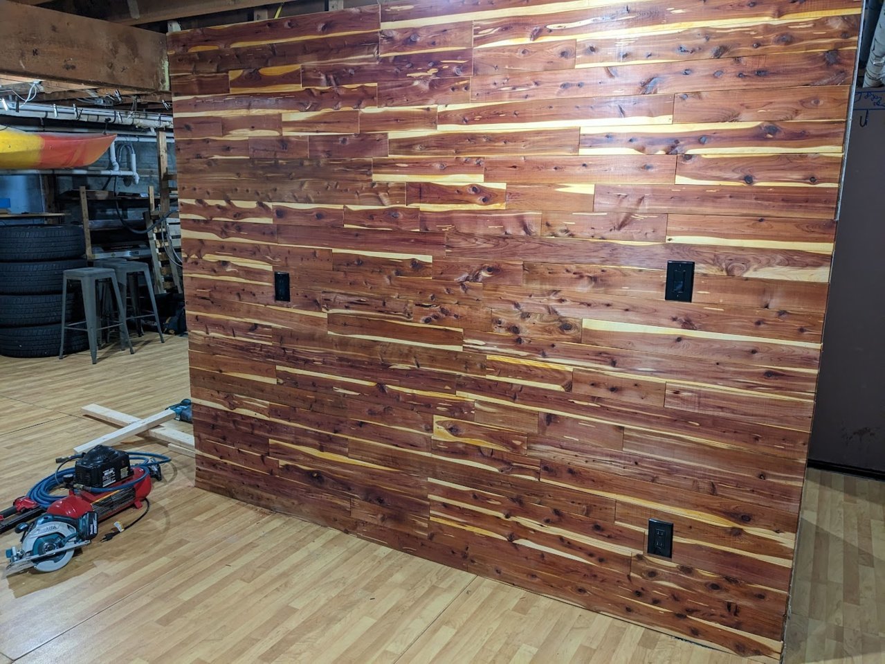

    I'm not totally sure what my intentions are with my basement yet. Basically, my goal is to slowly make it less horrible while spending minimal money on it. I don't think I'll fully finish it, but maybe it'll turn into that with enough time. This was the latest project:
    Previous owners had left five boxes of cedar planks behind, so I figured I'd use them fix one of the walls around the staircase. It was a half wall open under the stairs. I extended the studs and removed the sheetrock that was in rough shape, then put the cedar up.
    Long story short, half of the basement was finished at one time. The original owners had five kids and had a couple bedrooms in the basement. When I bought the house, it was partially gutted so it looked worse than a completely unfinished space would have. I think either they got water down there and removed anything damaged then decided not to refinish it. Or, it wouldn't pass Title V because it had too many bedrooms so they quickly eliminated them when they sold it.
    EDIT: I should note that the oddly placed outlet is there because it would line up behind the left side of a 55" TV if I centered it between the switches and left edge of the wall. I'm not sure if I'll actually do that or not, but two friends mentioned it would work perfectly there so I figured I'd place an outlet there in case.

    I really like that. And if you don't, I'd recommend using it for axe throwing.

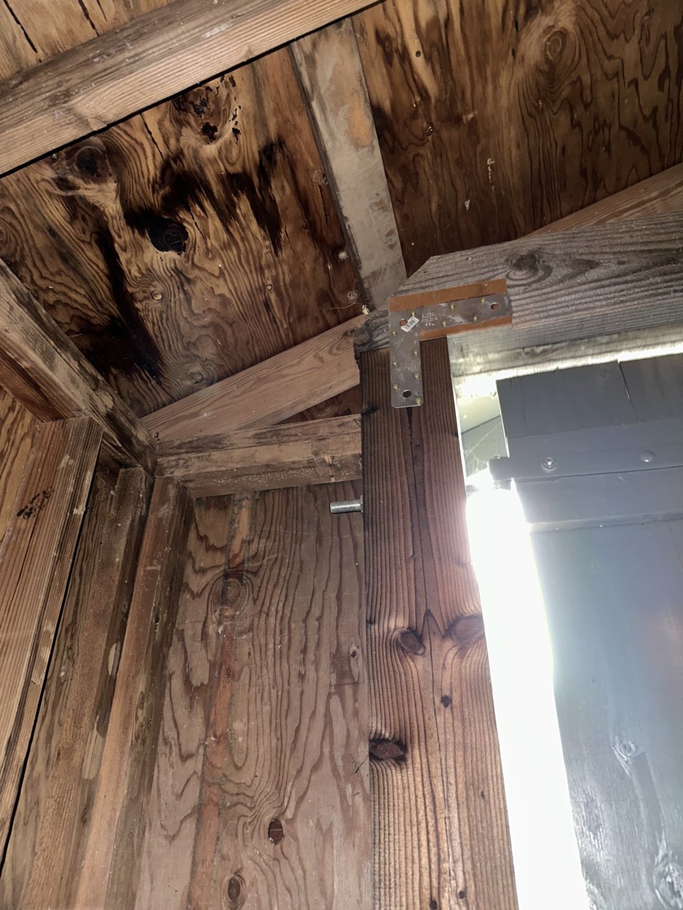

    Slowly starting to re-set my eyes on my barn renovation. Anyone want to make an assessment of this water damage? Looks like some of the rafters have mold on them:

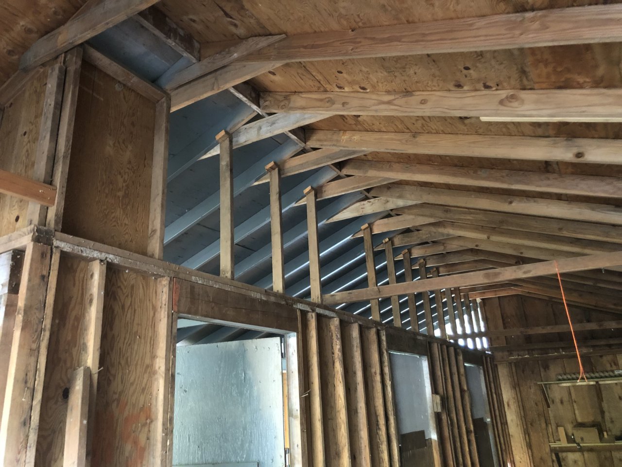

    Toward the gable it looks pretty good still. That center wall is coming down shortly.

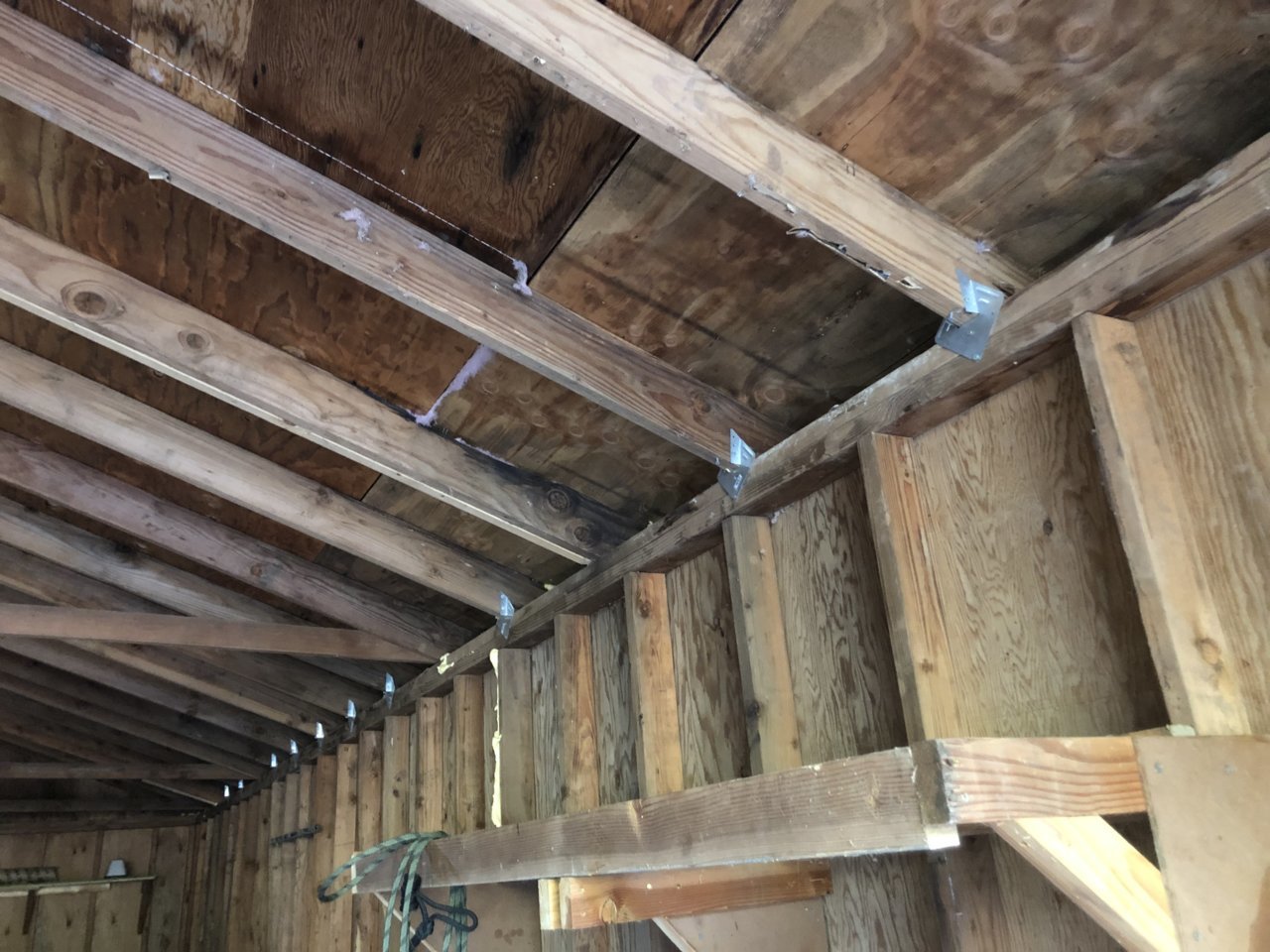

    Some of the plywood on the roof looks tore up.
    Generally, the wall framing looks good. I think it just needs a good scrubbing. My plan is to replace the siding and the roof sheathing this summer, but I’m curious if I shouldn’t try to mess with the rafters? They might also just need a scrubbing and some paint. Trying to keep costs relatively low as it’s just a shop, but at the same time I’m not a framer.

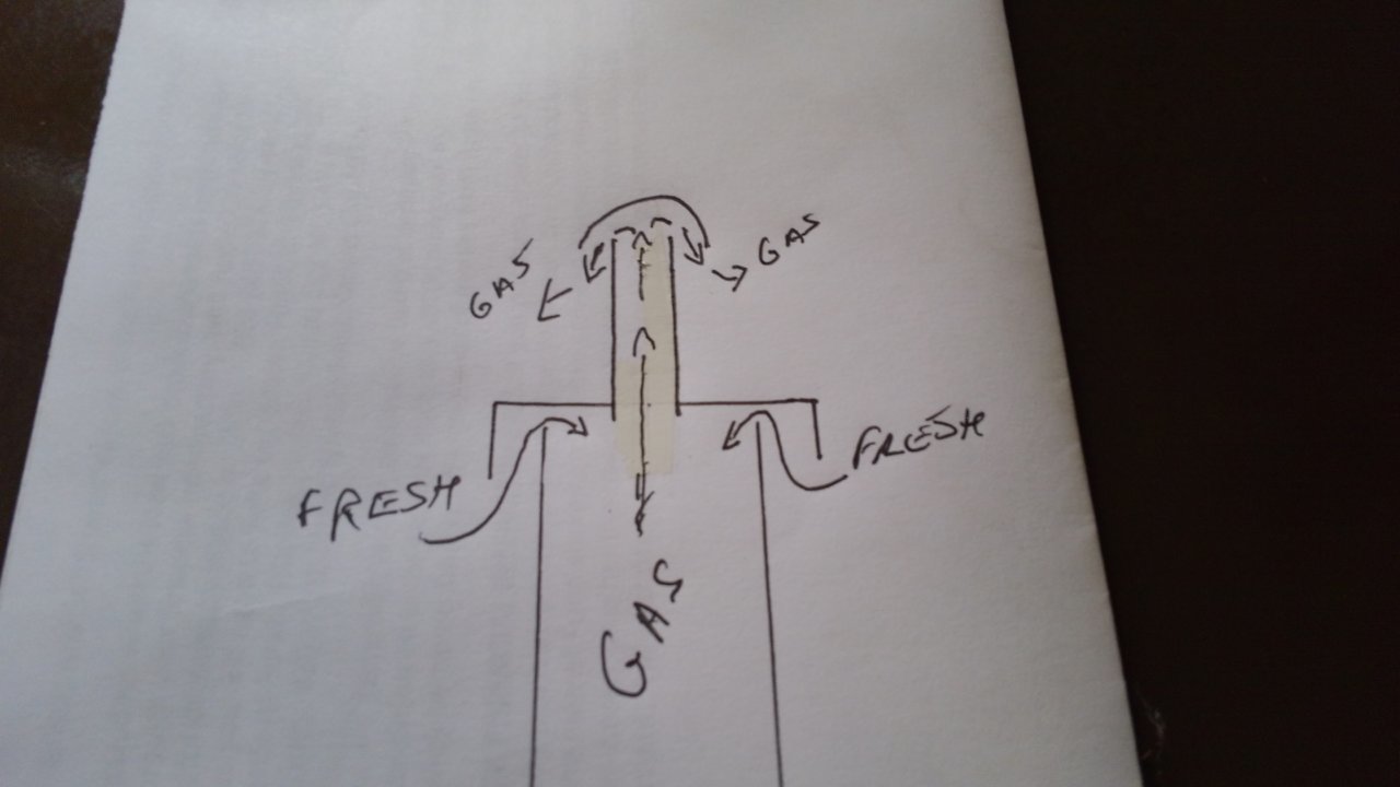

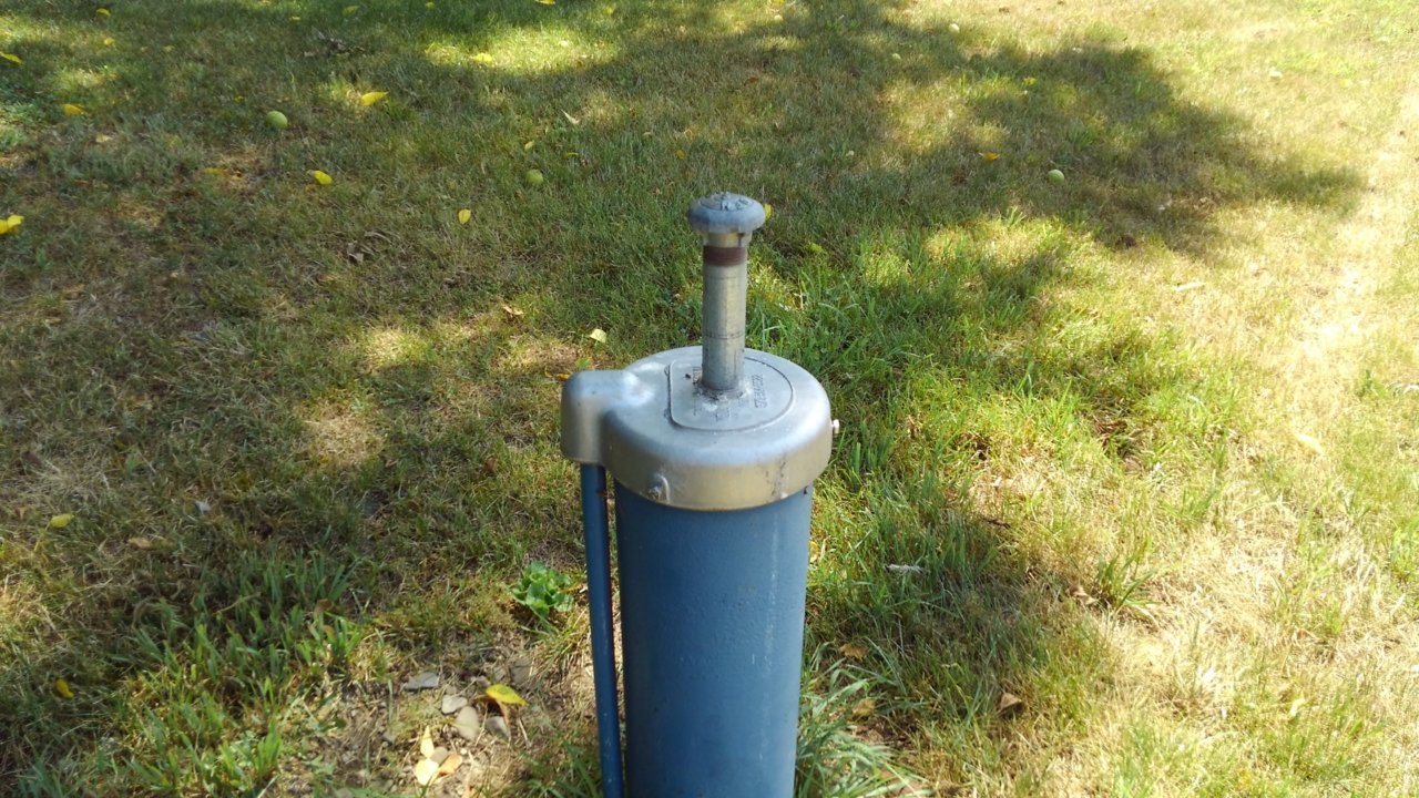

    The well that serves the garage had sulfur smell and so much gas that the water wouldn't flow smoothly from the faucet, it would spit and pop, the water would change colors even. I don't use the water much and always felt that contributed to the problem.
    Lots of gas drilling was going on (Marcellus Shale) and this Engineer kid came around doing a survey and taking samples. He observed the water and said "I can help you with that". He changed the well cap out for one with a vent -- a standard cap with with a hole for a 1" x 6" tall pipe nipple held to it with two conduit lock nuts and an oil tank mushroom vent on the end.
    To be honest I was thinking "yeah, right" -- the original cap isn't air tight... At this point I would have bet $10 there would be no change.
    Ran the water for two pump cycles and the spitting and color changing were gone! Several years have gone by and the problems have never returned. You can build you own for about $10, just need a big drill bit.
    I believe it makes a chimney effect encouraging the gas to flow away.
    Like this:

    Nice yes it just needs to be oxidized away not even a strong oxidizer- air will do

    that could all be a result of condensation , was there a ground seal inside , or do you know what was previously stored inside ?
    if the material was rough sawn or green lumber when it was built that can have a really high moisture content that will harbour mould

    It’s a gravel floor, so I imagine there’s been quite a bit of wet stuff stored in here. It’s a barn, so I have to think there was hay at some point, horses, etc.

    plywood is a great condensing surface , cold outside , humidity inside and it can basically be dripping with beads of moisture
