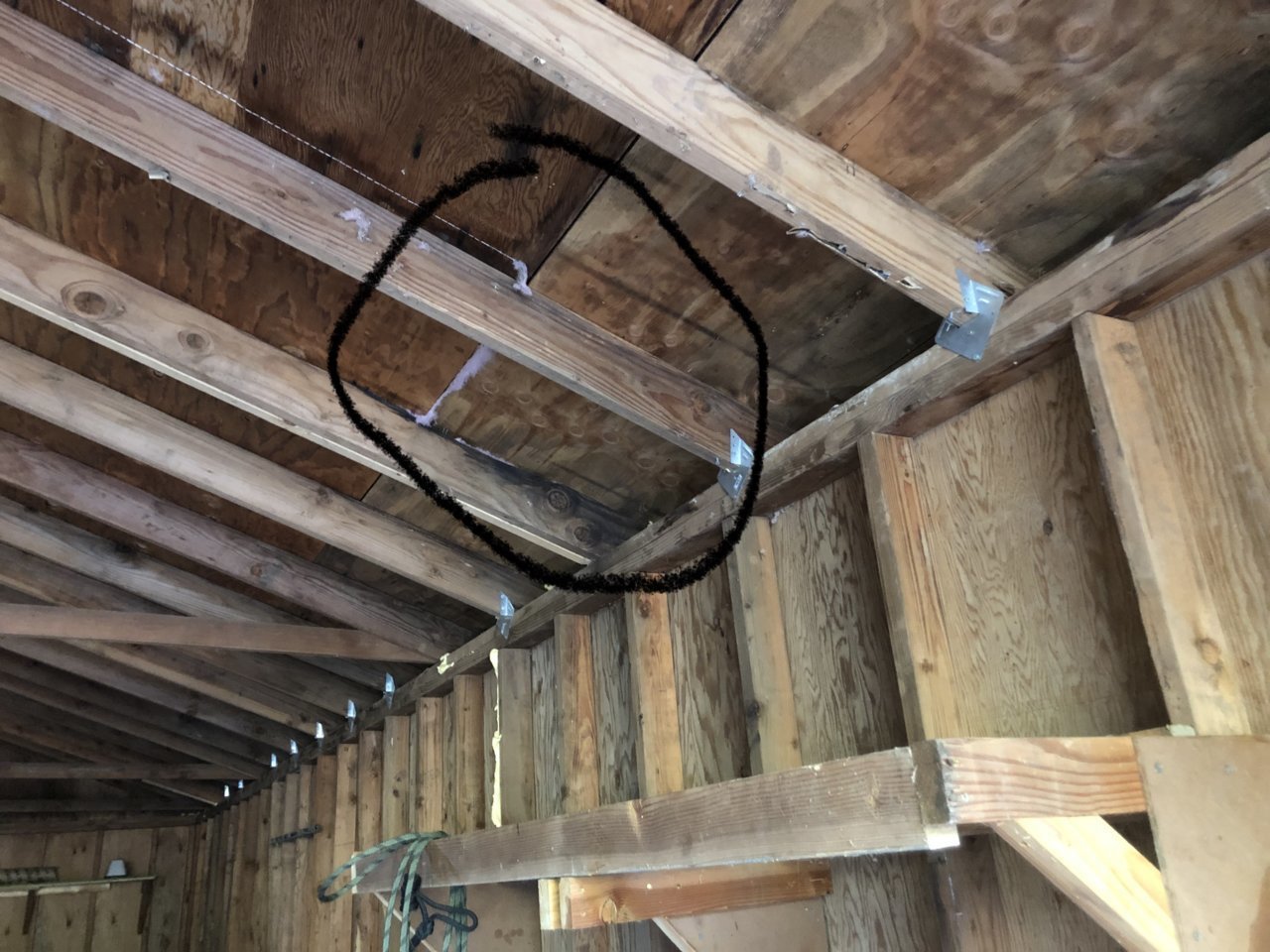

    Gotcha. So if I were to do this smartly, I’d treat the framing lumber for mold, then replace all of the roof and wall sheathing to fresh OSB. Then seal and insulate walls? Concrete floor goes in in the spring.

    get a moisture meter , check the moisture content of the lumber and plywood , over 24% (IIRC) will harbour mould

    If it were me first I would verify 100% the water is not coming in from outside, then I would run a dehumidifier in there for a couple weeks to dry everything out. Then, after verifying the wood is structurally sound and at appropriate moisture levels like oz said I would give it a quick scrub (respirator on lol) then cover every envelope/condensing surface aka sheathing with some of this. https://tigerfoam.com/sprayfoaminsu...er-foam-slow-rise-formula-600-board-foot-kit/. Thickness of foam based on climate :)
    In the meanwhile I’d consider putting a temporary vapor barrier down on the floor to be replaced by the one that will go under your slab
    What kind of cladding is on outside of shed?

    Doesn't appear to be sealed to the point that a dehumidifier would work to suck moisture out of the boards.
    Moisture meter it, if its not overly damp, spray everything with a mold killer/inhibitor and call it a day. Get to work sealing the thing off, ridge vent, pour the slab, get your doors in so its all sealed off and then insulate and sheeth the inside.
    Its a shop in an old barn, it's not going to look like Oz's with brand new lumber. :notsure:

    Lol good point about it being too open for a dehuey to do much good
    As a matter of fact kinda difficult to imagine such a drafty building with (I’m assuming) no heat source being able to create a temp/humidity gradient that would allow condensation in the first place.
    I bet it’s liquid intrusion either thru sheet flow (crack in roof sheathing) or capillary action (area above door)

    Or its just old weathered lumber thats been covered but still "outside" if you will. Lumber looks fine to me. Then again I can't smack it with a hammer to know for sure. :notsure:

    This is concerning, looks like fuzzy moldy active rotD8C6AE17-CBDC-4E19-88D0-664D276AA99E.jpg
    But then wtf is that string looking thing coming down into it lol
    I agree. A hammer test is in order :)

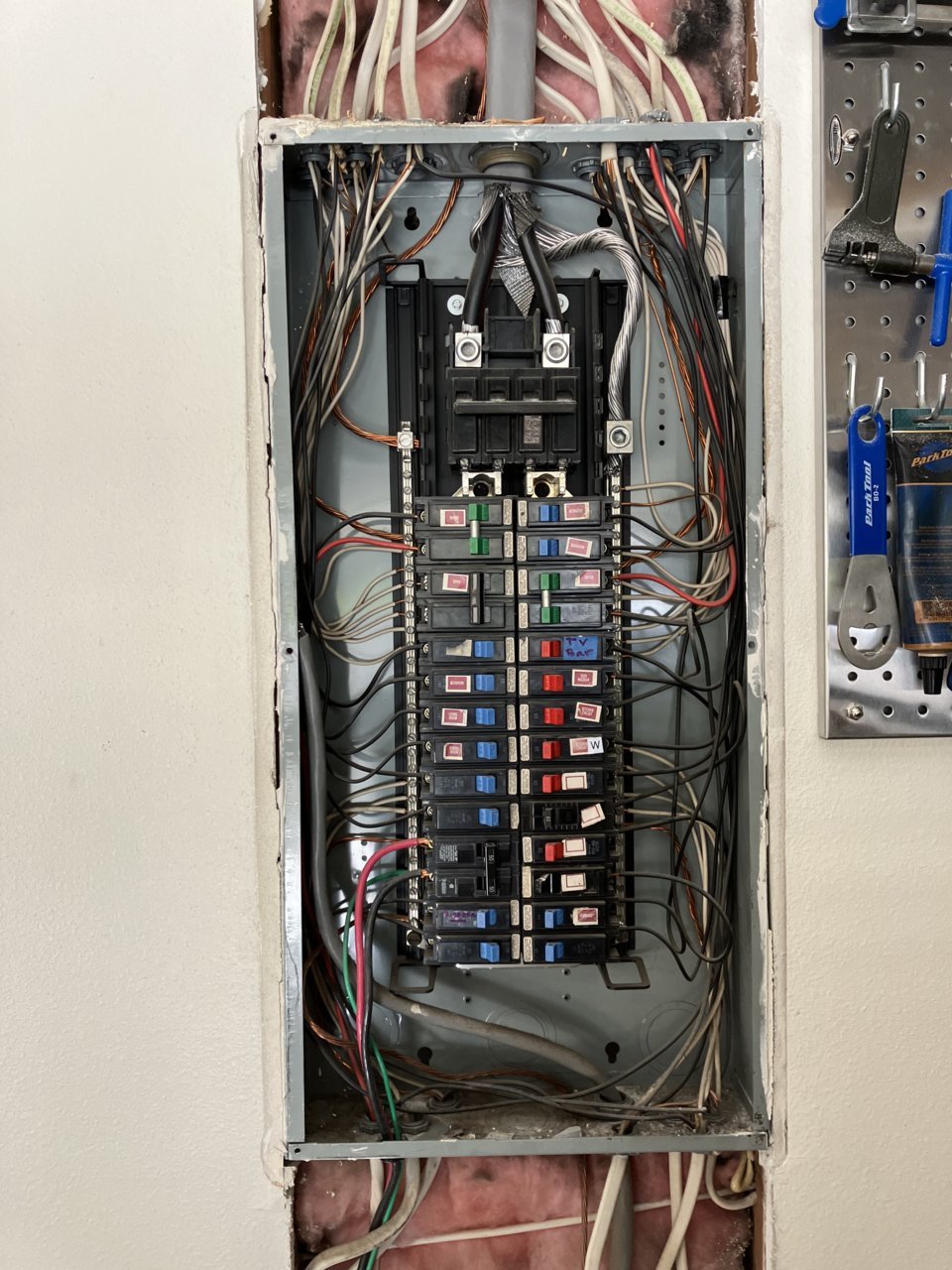

    Those are sure some nice expensive bike tools you have hanging there!

    Oh those are remnants of old insulation someone ripped out. Definitely isn’t any fuzzy mold going on in there :rofl: Thanks for the vote on confidence on everything though! I’m in the northwest so who knows what got in there. The framing stands up to a nice smack with the hammer, but it’s not sealed whatsoever. Literally there’s a 1 ft gap between the stable doors and the roof. So it’s virtually been outside under an awning for 45 years. I’ll moisture meter it and try to get my floor poured asap. Not a bad idea to do a dehumidifier when the floor gets poured and I seal with doors.

    if it was insulated with batt insulation with no air channel above to move moisture that would trap any condensation against the roof sheathing and rafters , that could have be the problem right there

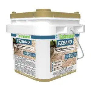

    If you are talking about a sand tamped patio or pavers there is a polymeric/silica sand/additive that you can use as a binder. You use it as a finish course and then wet it down to activate the polymer/silica. It’s spendy though.

    yes, like that but even less cement. When it's fully cured, it very brittle compared to mortar.
