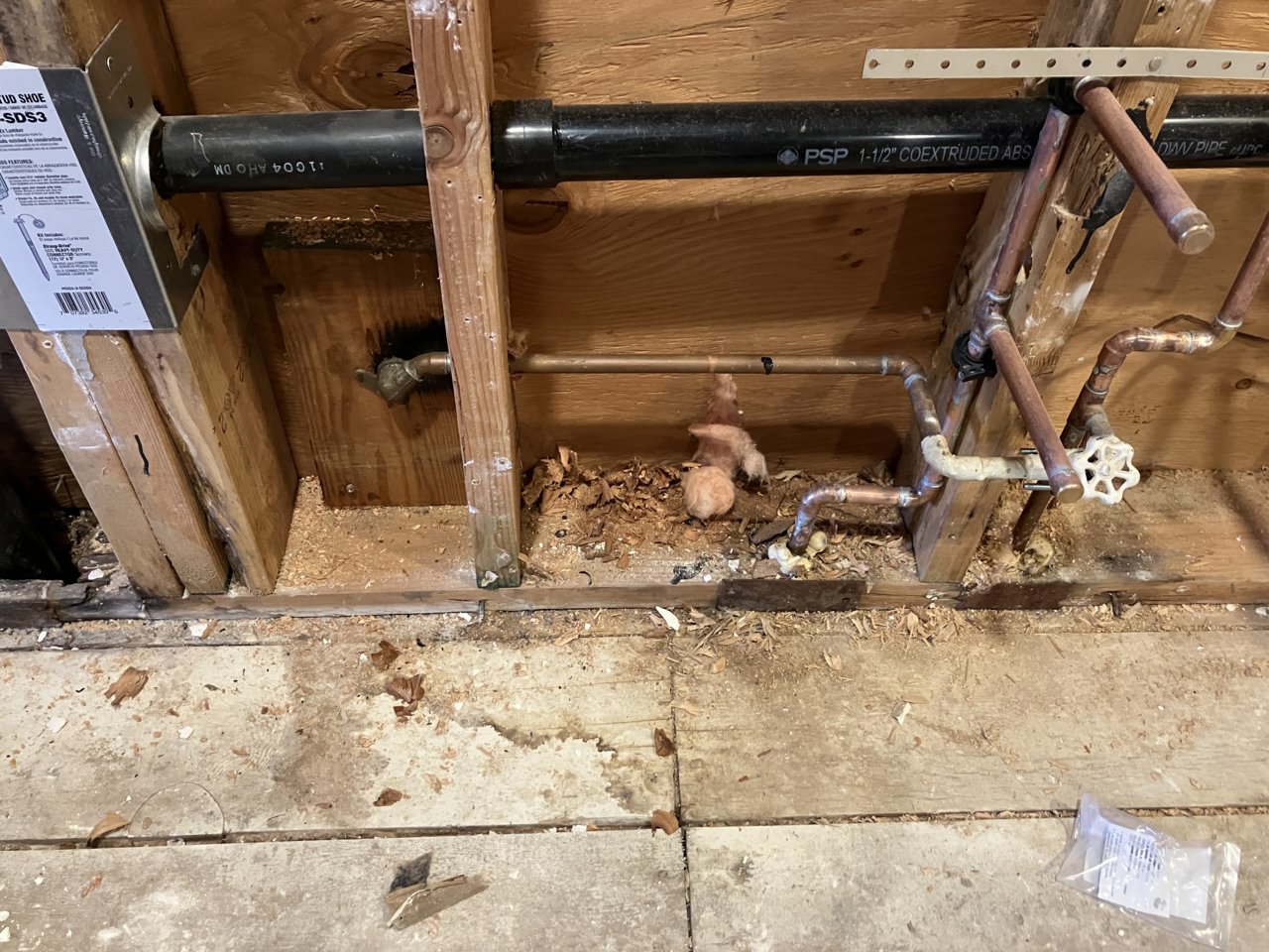

    I have purchased the replacement and repair parts it should be resolved in short order. I decided that it needs an interior shutoff valve for future cold spells (which is like 6 days a year). I will be adding an access panel behind the toilet.

    When you shut it off for those cold snaps be sure to disconnect the hose and open the hose bib. You have to get the water away from it or it will all be for nothing. Every year in my area people forget to remove their hoses and it prevents the frost free hose bib from draining. What you're doing is essentially a manual frost free valve.

    Correct, all in my plan.
    If they sold close access frost free spigot then I would have proceeded in that manner.

    @OZ-T is good at spending my money. I'm thinking 6" for a 2x6 exterior wall? But not sure if the elbow will stick out. Then again, maybe we can relocate it to directly under the sink so it sticks out where it shuts off?

    They should install in a t wall for depth and the ability to add a service loop

    The only "T" wall is the swiss cheese wall, you really want me to push for that? It's chock full of electrical right now anyway.
    So just skip this and pretend I'm smart enough to remember to turn off in the cabinet old school style?
    Does anyone make an app and wifi enabled solenoids? I guess I'd still have to open the hose bib itself once the inside valve is off.
    I think that's my answer, just leave hoses off most of the time.

    I'm unperturbed if you do not install a frost free , just stating how they are intended to be installed to actually work as intended

    We have a bunch of exposed pipe in the crawlspace so I wonder if maybe the answer is to run hose bibs from the crawlspace?
    I grew up in Hawaii, spent the prior 20 years in San Diego, this pipe freezing thought process is new to me.
