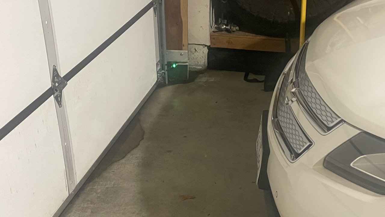

    Replaced my garage door seal today. It’s been a few weeks straight of rain here in SoCal and I’m tired of sweeping out the water from my garage twice a day. Fingers crossed it seals, should know overnight.

    That sounds more like a slope problem, unless it’s blowing rain. Or I may be misunderstanding.

    does your driveway slope toward your garage ?

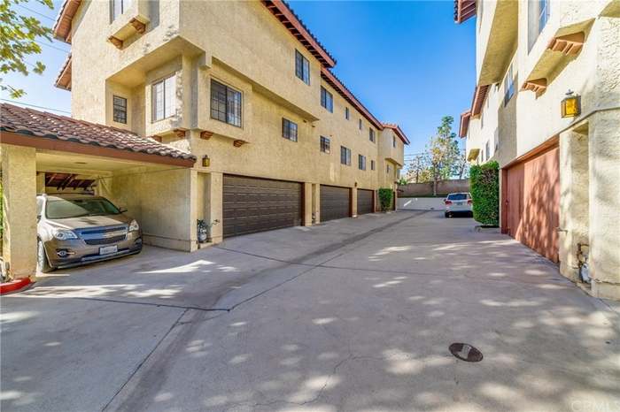

    Little bit of column A little bit of column B.
    The driveway is sloped towards the center and down towards the camera. The problem is the ~6” (that’s what she said) of slab that is still mine that extends past the garage door to where it meets the common slab. While the eaves do extend past that point, the problem we’ve had the last few weeks is sideways rain that’s hitting my door and running down to where it’s sloped back towards the interior.

    How are the seals/flashing on the sides and top? That could be contributing to your lakefront property too.

    Top and sides are good & dry…it’s only about 24” on the edge that are letting water past. It’s been about 4 hours of rain now and I just checked…. Still have water intrusion. I guess the next step is to get one of those “berms” that you epoxy in place as a sort of sill

    It's worth a try. Maybe the concrete isn't level or is sunken in a bit. On the plus side I'll bet the lakes will be full in CA this summer with all the rain and snow.

    can you use a grinder and cup wheel to create a slope outward on the portion of your slab that protrudes beyond the door ?

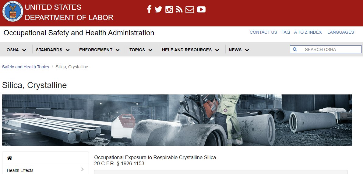

    Better follow OSHA's guidelines.

    Since it buts up level to the shared slab that would mean either:
    • It slopes down but creates a step up to the shared slab
    • I also grind the shared slab
    Either of this are a no-go and frankly too much work for what is not my forever home. With any luck my $60 dam & liquid nails will stop the water intrusion from what is sure to be a once a decade storm. :rain:
