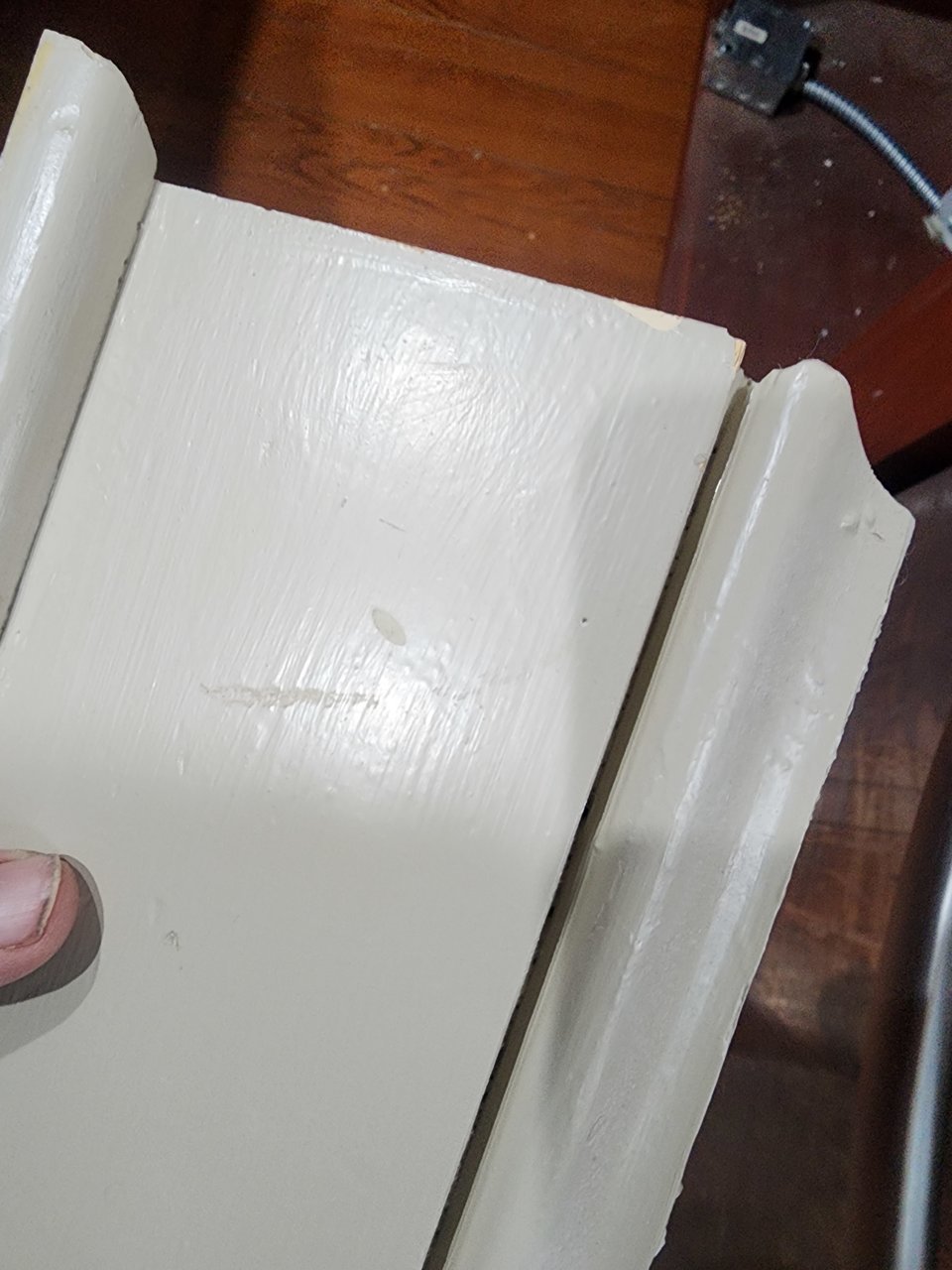

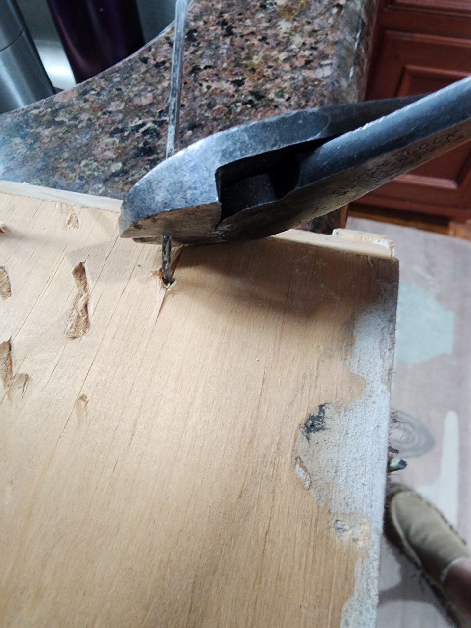

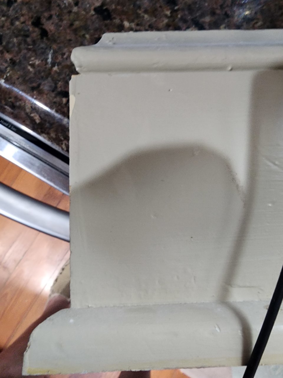

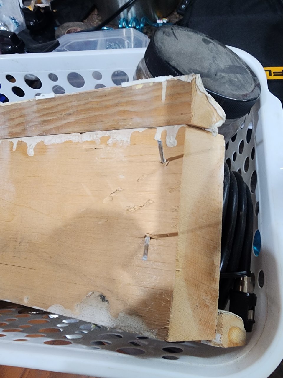

    Got a piece of trim you need to reuse but it has trim nails in it? Pull them through the wood rather than pounding them out.
    20230304_093606.jpg 20230304_093625.jpg20230304_093639.jpg 20230304_093703.jpg
    It's like it was never nail.

    Too bad in my house they used 10D & 12D finish nails in everything, so pulling them out just trashes the wood, even from, behind. Tried to salvage the wood from the section of top cabinets I took outta my kitchen. Nope, right to the burn pile! :laugh:

    I have used a dremel cutting wheel to reclaim trim with those finish nails before. It went pretty quick. Profit margins were tight back then.

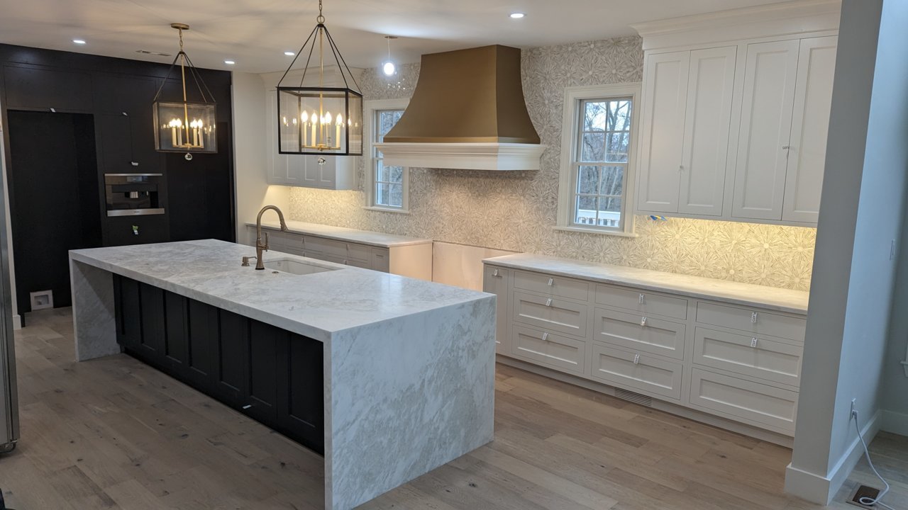

    Beauty cabinets. A question, and I don't want to seem like I'm crappin on the project, just genuine curiosity. The upper doors, why have them in different sizes? I just thought having all 4 doors the same height would have kept a cleaner line horizontally.

    Fridge and freezer cabinets installed:
    Now we wait until October until microwav, fridge, freezer and range come in........ 16 month lead time on Wolf/Subzero products.:eek:

    The right is the RO for a microwave and the left is the RO for the refridgerator

    I've heard mixed reviews about those higher end appliances. Looks very nice though.
