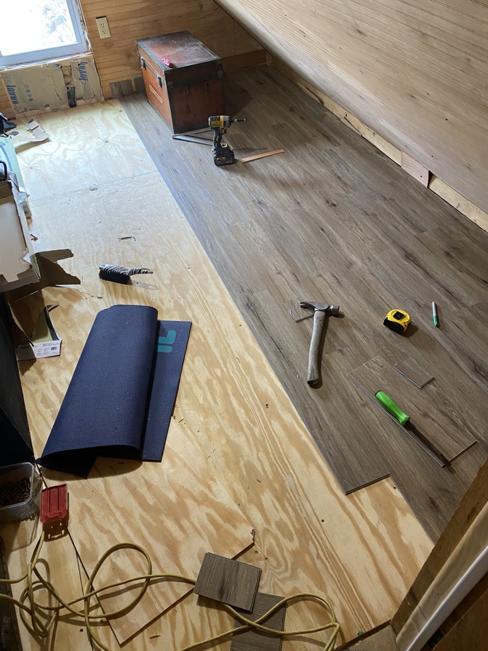

    Doing the floor in a small closet room, subfloor was so uneven had to overlay with 1/4 ply and lots of adhesive

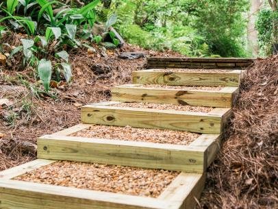

    I'm in the process of pouring some footings for a path and stairs that are in the style of the image below. The main path is about 20 feet long and is being mostly held up by some boulders that are 4 to 5 feet diameter plus smaller rocks and dirt. In other words, the path is on top of the boulders.
    I have one more footing to pour, but one of these huge boulders is slightly in the way. There is a gap of about 1" below the 4x4 and I'd really like a nice flat surface for the wood to sit on. I have little concrete experience, I'm doing the job for my home without a permit so no one accept for you guys is going to tell me I'm doing it wrong. And before anyone says I don't really need concrete for this, the path has previously failed 2 time due to erosion so I'm trying to make it a little more permanent.
    I'm not moving the entire boulder but I could cut a chunk of it out with a diamond wheel or drill into it with a rotary hammer. How should I fill this 1" uneven gap between the rock and the end of 4x4?
    These are not my stairs, just a similar style to what I'm building.

    do you mean the gap is between bottom of your 4x4 stair "stringer" and top of boulder ? ie you want to fill the gap so the 4x4 is bearing on an extension to the existing boulder ?

    Yes exactly. However, I also want to stress that I'm open to any other recommendations.

    is there a flat-ish surface on the top of the boulder already ?

    Not at all. Multiple angles.

    you could drill and grout in or epoxy in a 4x4 post saddle at the correct height and location to bear your stringer

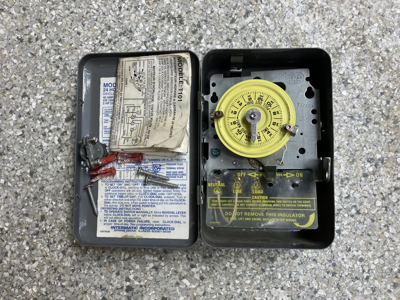

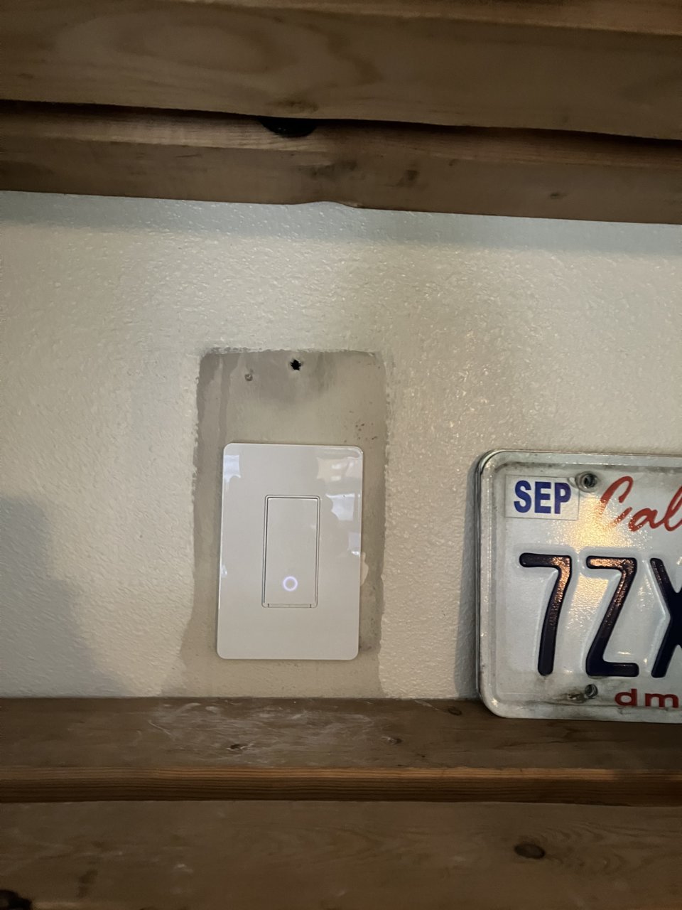

    Slogging through finish electrical today.
    Old mailbox timer. Kind of a cool unit. Super loud though.
    Threw in a half ass box and modernized so I don’t have to adjust for sunset/sunrise changes.

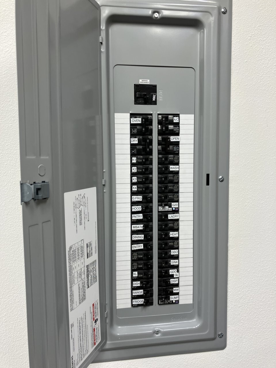

    Inching my way forward with the label maker:

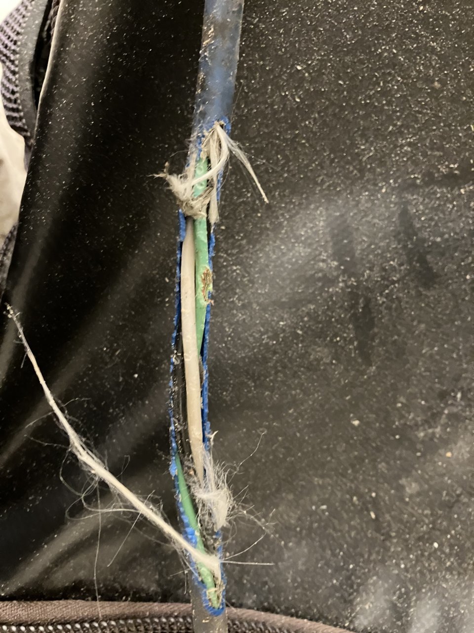

    Got the sump pump hardwired before the mice could ruin my day:

    there is the method of charring the wood then chipping it out to conform to the rock base

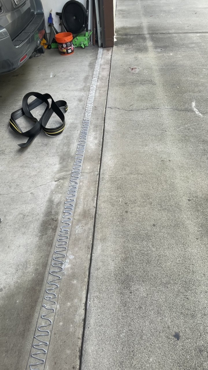

    Scrubbed the slab with Simple Green & a bristle brush this morning, let it dry a couple hours. Put the strip in place & marked the edges with a pencil. Threw down 2 tubes of Liquid Nails. Yes they’re different tubes, I had a different tube on hand already open but they both claim to bond to cement & rubber.

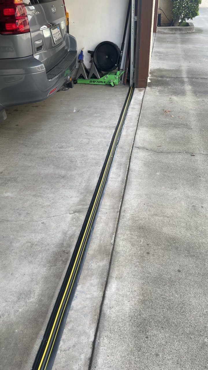

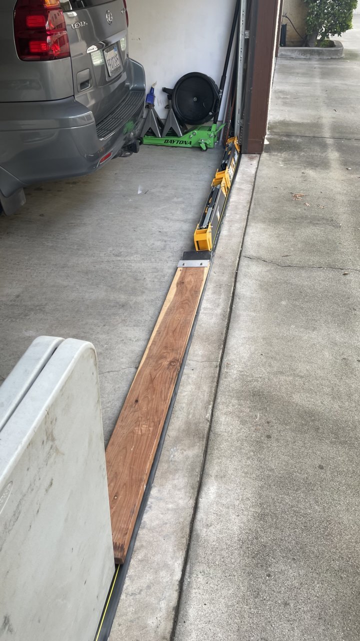

    Got the rubber dam set down & put whatever I could find on it to add some weight. Walked the toddler down to the grocery store while the LN set up. Thankfully my condo is in a great complex so 0 concerns about leaving my garage open for an hour while we were gone.
    Came back and loaded up his bubble machine, spent another hour chasing bubbles while the LN setup.
    And hopefully this will keep the garage dry :fingerscrossed:
