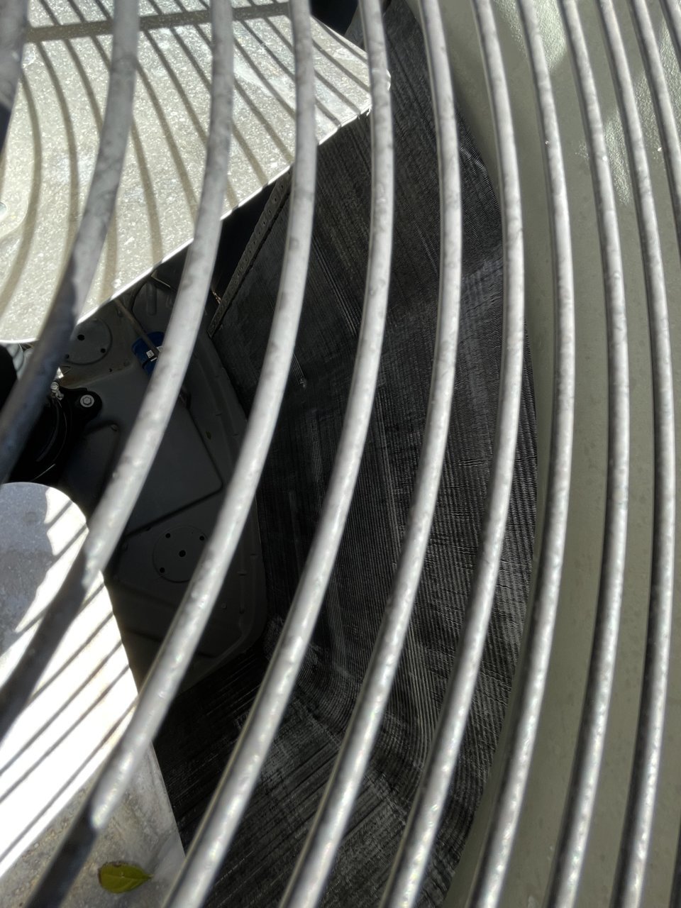

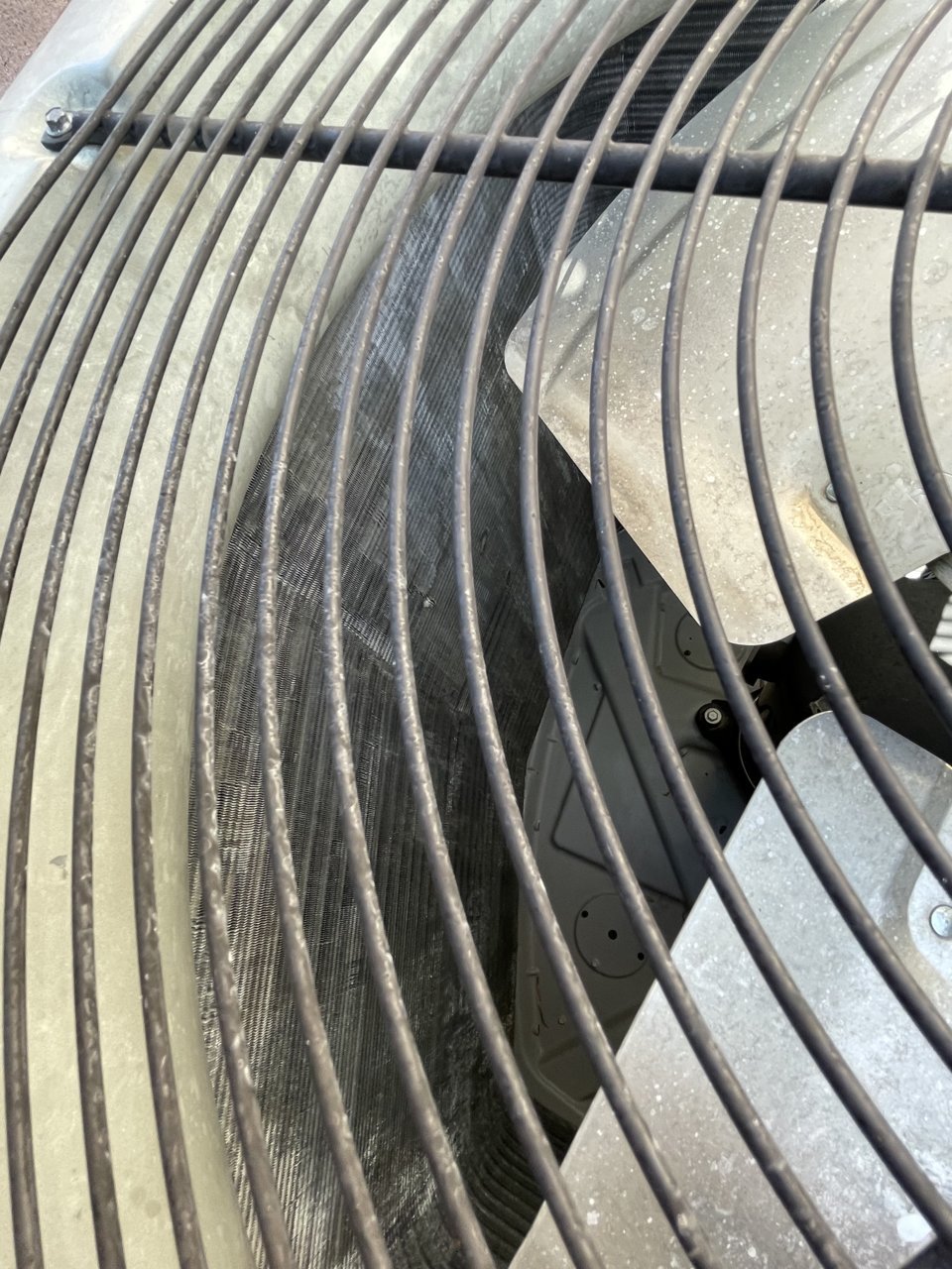

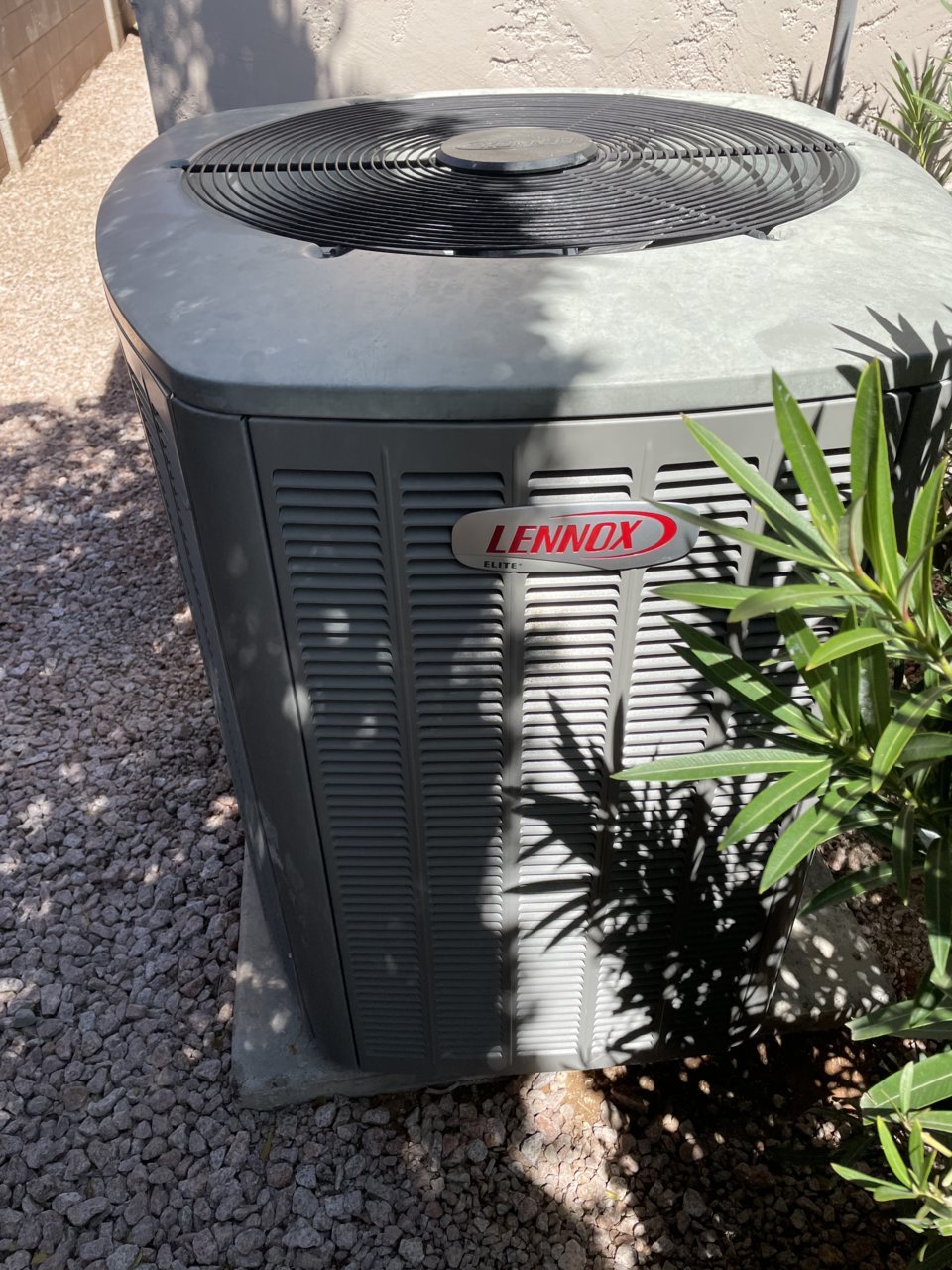

    Sorry I didn't take any pics before putting everything back together. You mix it with water, spray it on the fins and let it sit for a few minutes. It turns into foam, expands in between all the fins on the coils and pushes all the dirt out. Then you rinse it clean. I left it on a little too long and etched the metal, but hey it's clean now. :anonymous:
    I really need to trim the oleander back, but I'm allergic to those too. :rofl:

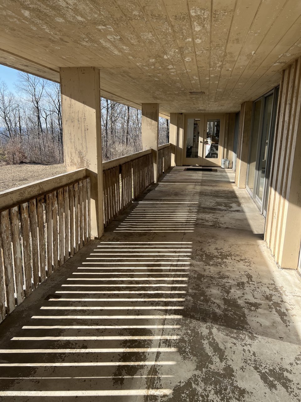

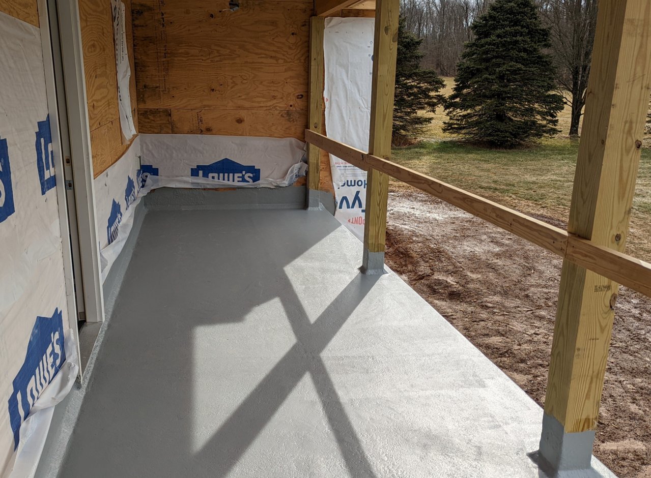

    Updated photo from this evening. Overhang extends about 3.5 feet out so the porch is covered. The entire plywood substrate is covered in this fiberglass but it’s not well adhered to it in most spots. Thoughts?
    EDIT - Please ignore the temporary fencing to appease the town inspector so we could get the CO after closing.

    My thought is WTF were they thinking? The fiberglass is almost certainly trapping moisture next to the wood and causing rot and mold. Can you see the underside of the deck?
    BTW I think it shows real potential to be a nice place to sit.

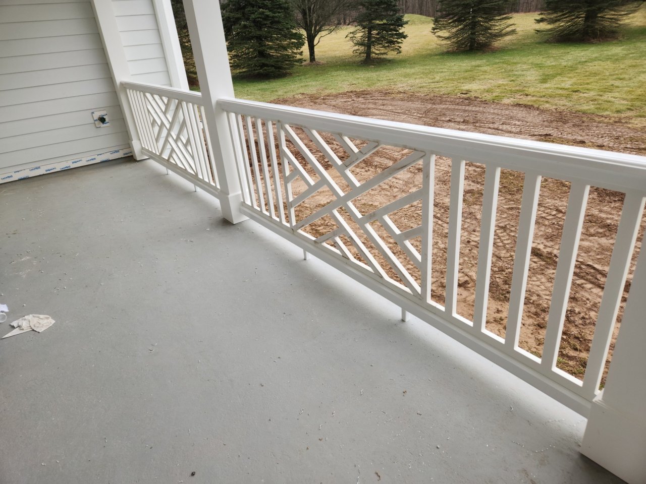

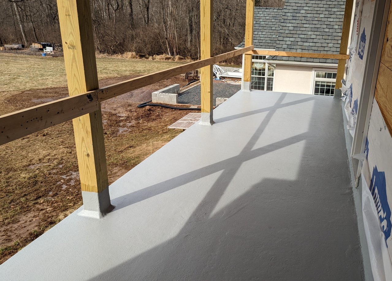

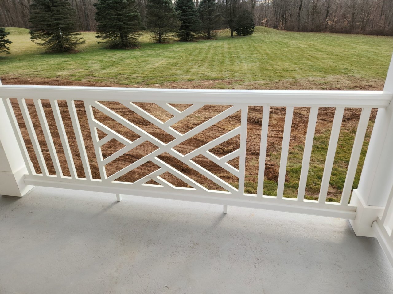

    We did a fiberglass deck over marine grade plywood on one of our customer builds. Turned out pretty nice.

    No idea what the thought was. Guessing if they had good adhesion it would encapsulate the wood like fiberglass on boats and block and moisture? I have no access to the underside, it’s also encased in ply. I’ll snag a photo of that too.
    It’s a funky house overall for the northeast area being a big flat mid century modern home but it’s awesome. This porch connects the master and two other bedrooms all from big glass sliders and then the garage is at one end and the dining room at the other. Also has the best viewing direction.
    I am thinking this was what it originally looked like.

    If the deck was built like a flat roof and sealed against moisture that could work just fine. The only experience I have with flat roofs is the house I grew up in. About 15 years after it was built it started leaking. My dad tried every concoction, goop, tar, sealant, and tarp he could think of and nothing worked. The only way to fix it was to remove and replace the roof surface.

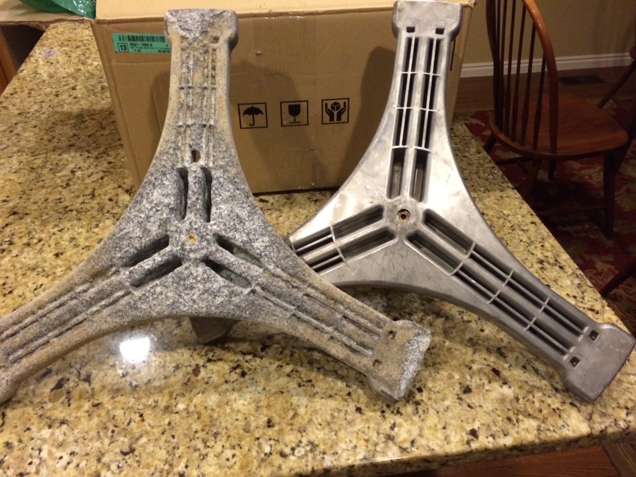

    Question for you guys... I have an LG front loading washer and sometimes when spinning, it sounds like the drum is going to come through the door. Very loud and banging. Works otherwise. Does that mean the shock absorbers are bad?? All the video's I've seen just show replacing them, not the reason for replacing them.. thanks for any assistance.

    Front loading washers have a part called the spider arm
    In an effort to make sure the washing machine dies 2 days after the warranty runs out they make the spider from aluminum. The spider corrodes with normal use and eventually cracks causing the loud banging you're hearing. This is from my Samsung washer after about 4 years of use. The picture doesn't show how thin the old spider is or the multiple cracks. If you have to pay someone to replace the spider it might be cheaper just to buy a new machine. I replaced mine and while it requires the washer to be stripped to the bone it wasn't that hard of a job. It took me 4 or 5 hours to do start to finish. If you think you're going to have it fixed stop using the washer now. If the inner tub gets damaged the repair cost goes up dramatically.

    Is there a way to verify that's the issue before ordering parts? I can't find any video's showing a machine making the noise. It only does it part of the time the drum is spinning..... doesn't do it when washing

    That sounds just like my machine. When it started the spin cycle it would make terrible banging noises until the load got balanced. Then it would quiet down. I replaced the shocks first because they were cheap and easy to do, but as you can see the problem was the spider.

    Yeah, that's what it's doing. Thanks for the help....

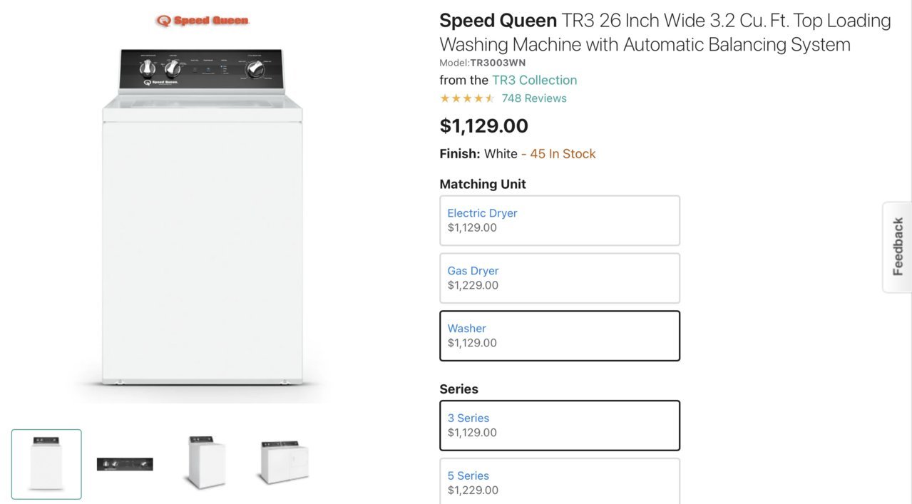

    If you decide to replace the washing machine I recommend Speed Queen.

    :eek: $2499
