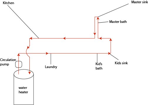

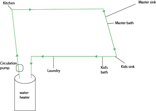

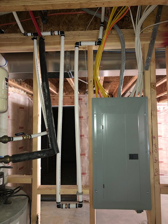

    My house was built with a circulation loop so each faucet feeds from the loop. The plumber that installed it was an idiot and put the kitchen sink at the end of 65' of pipe. So, yesterday removed the idiot's hot water loop and installed my own. The first thing I did was make the loop as short as possible while at the same time keeping it as close as possible to the different faucets. I also made the most used sink, kitchen, first in line for hot water instead of last. In the kitchen, without the circulation pump running it now takes 2 cups of water before it runs hot vs nearly a gallon before. With the circulation pump running all of the sinks have nearly instant hot water.
