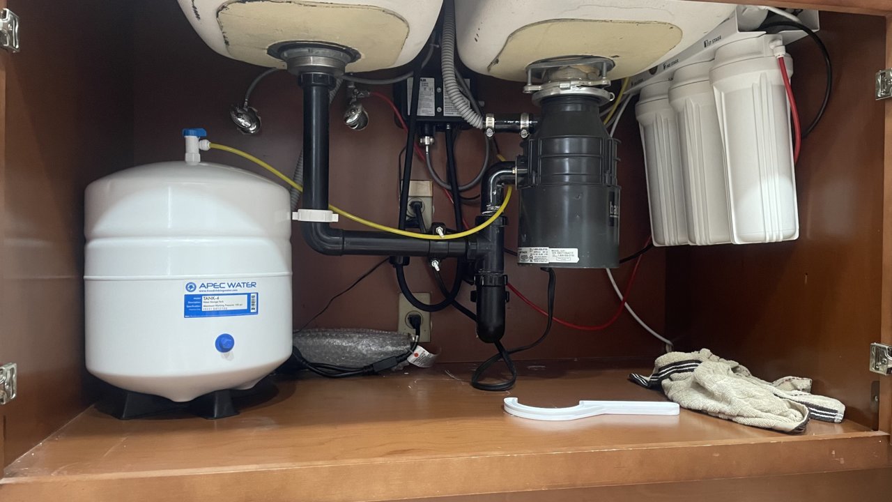

    Installed a reverse osmosis setup this weekend. Didn’t like the Chinesium saddle valve they included to get the water supply so Bezos sent me a couple solid brass 3 way fittings with a ball valve quarter turn shutoff on the 1/4” branch that feeds the RO system. Also used the same fitting to split the output to the spigot and fridge supply. Now I can isolate a few different ways to troubleshoot, replace filters or fittings with minimal impact to the rest of the system. I’m glad to get rid of both the Brita filter as well as the dishwasher air gap. I forgot to shut off the ice maker for the 1st batch of water so I ended up with gray cubes from the sediment filter. Ah well. Super happy with this Amazon Black Friday deal for $150. Once the disposal shits the bed I’ll replace it with a slim model and relocate the collection tank to the right side.
    And bonus that the faucet that came with it is a pretty close match to the Kohler faucet we have. Brushed nickel vs stainless but design wise pretty close without getting a lawsuit.

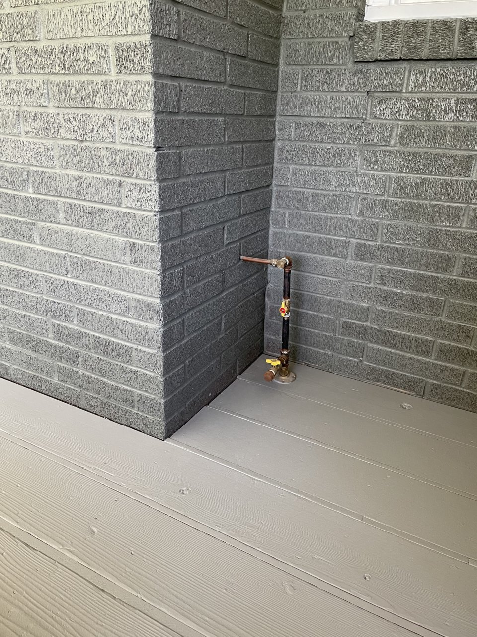

    i believe a standard 'vent free' unit would work there.

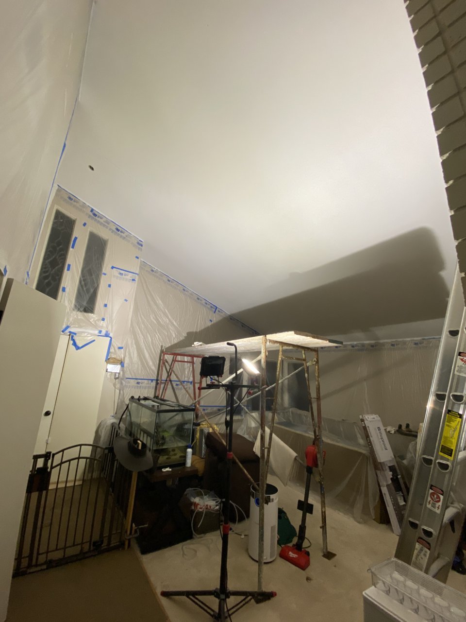

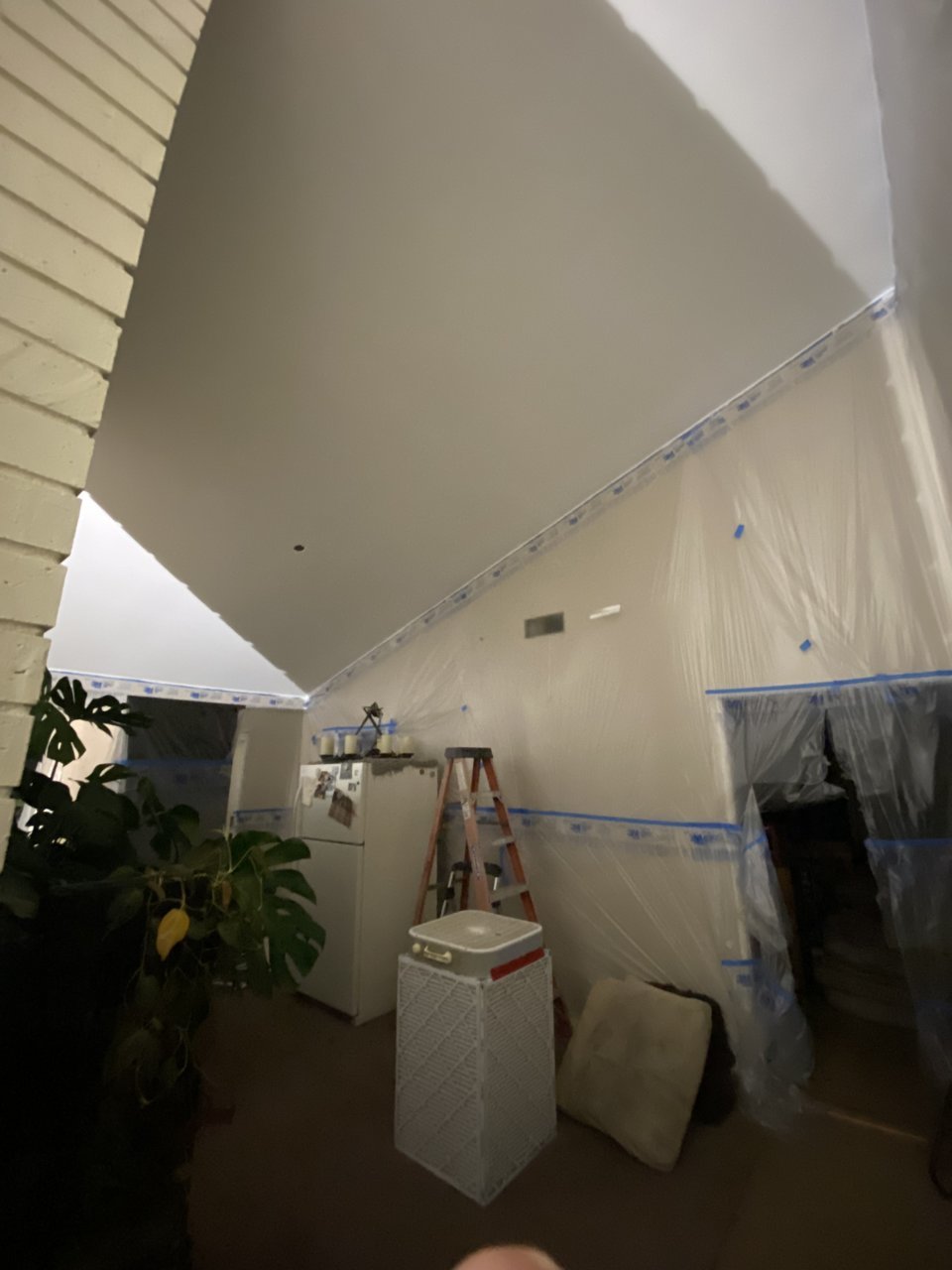

    Progress pics. We got the front room popcorn scraped and 2 thick coats Kilz Restoration Primer added. My goto primer is PPG Gripper but the ceiling plaster guy requested the Kilz. My painter buddy did the scraping so I can't take any credit for getting it done. To reduce popcorn dust he sprayed lots of water first then scraped with a 6" drywall knife and caught it with a cardboard pan that a case of Monsters ships in. It took him three 8 hour days to scrape the whole thing. We decided to take it slow to reduce dust.

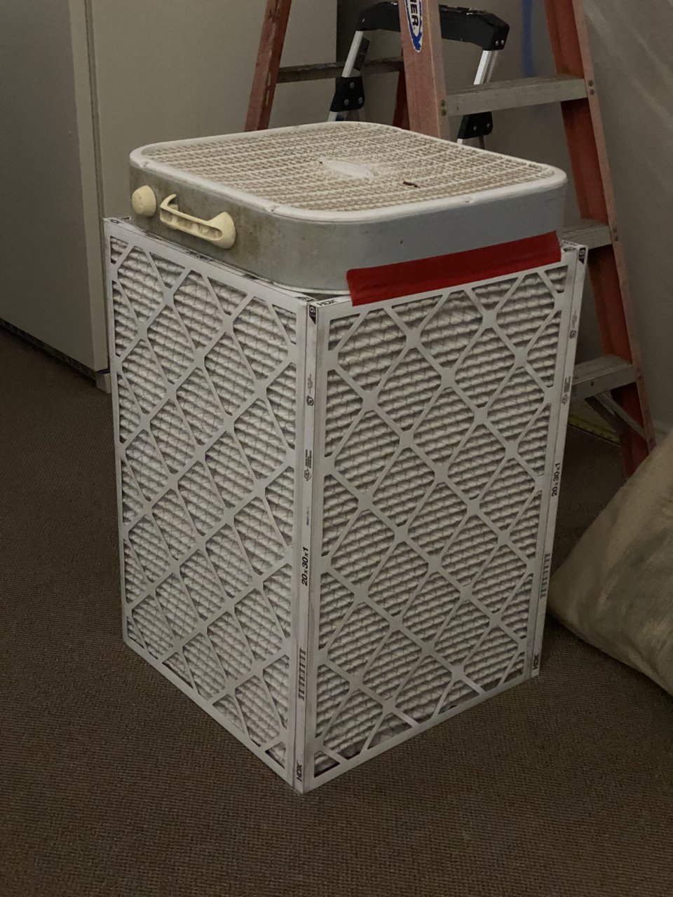

    For the first time I made a diy air scrubber with four 19x25 HEPA filters and a box fan-- it really helped keep the dust down.
    On the domestic side, I asked my better half what she thinks about it, and she said this the best it ever looked up here lol. This part of the house has been a wasteland while other parts got fixed first, so it is a relief to finally be getting this last large section under control.
    Ceiling gets plastered next wknd and hopefully I finish the front door by then too.
    I have been taking half time off work to do this stuff, which is a priceless head clearing exercise. The 1 : 1 return of input : output on house projects makes it a favorite hobby lately.
