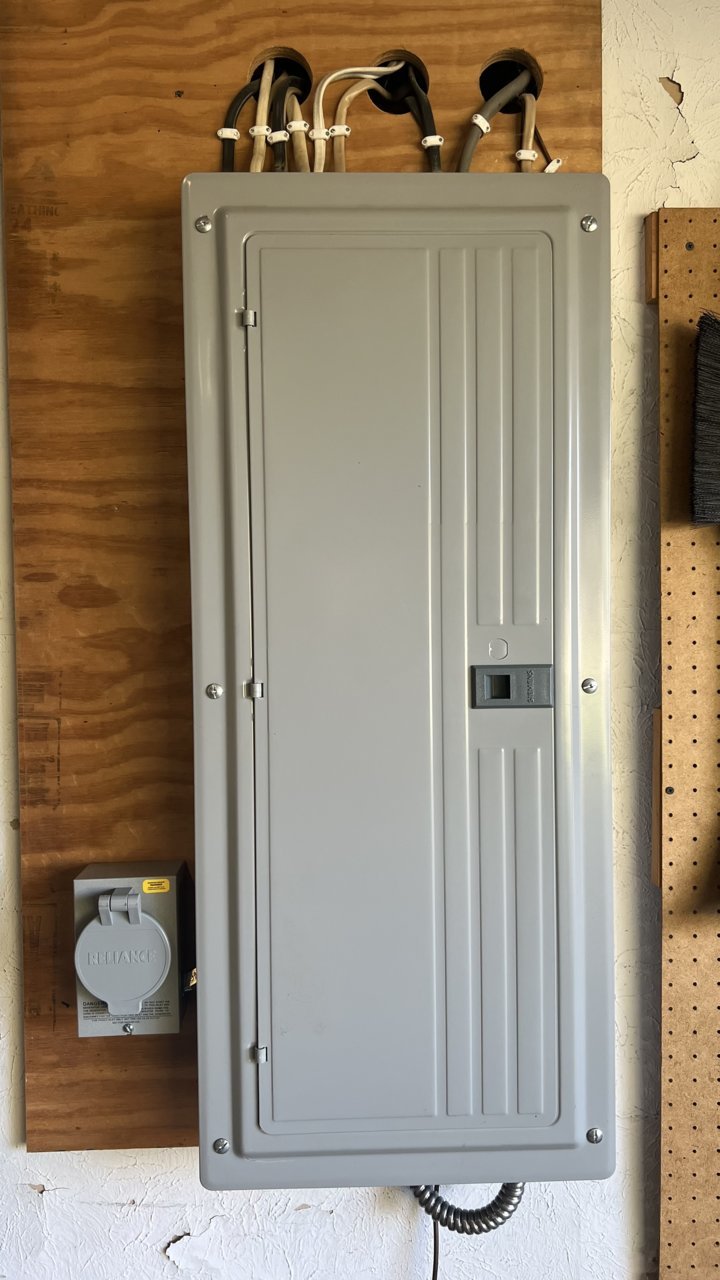

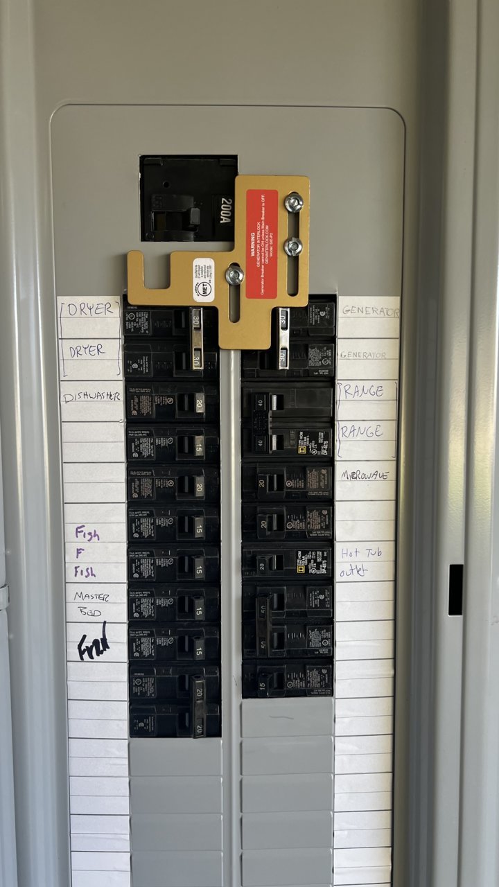

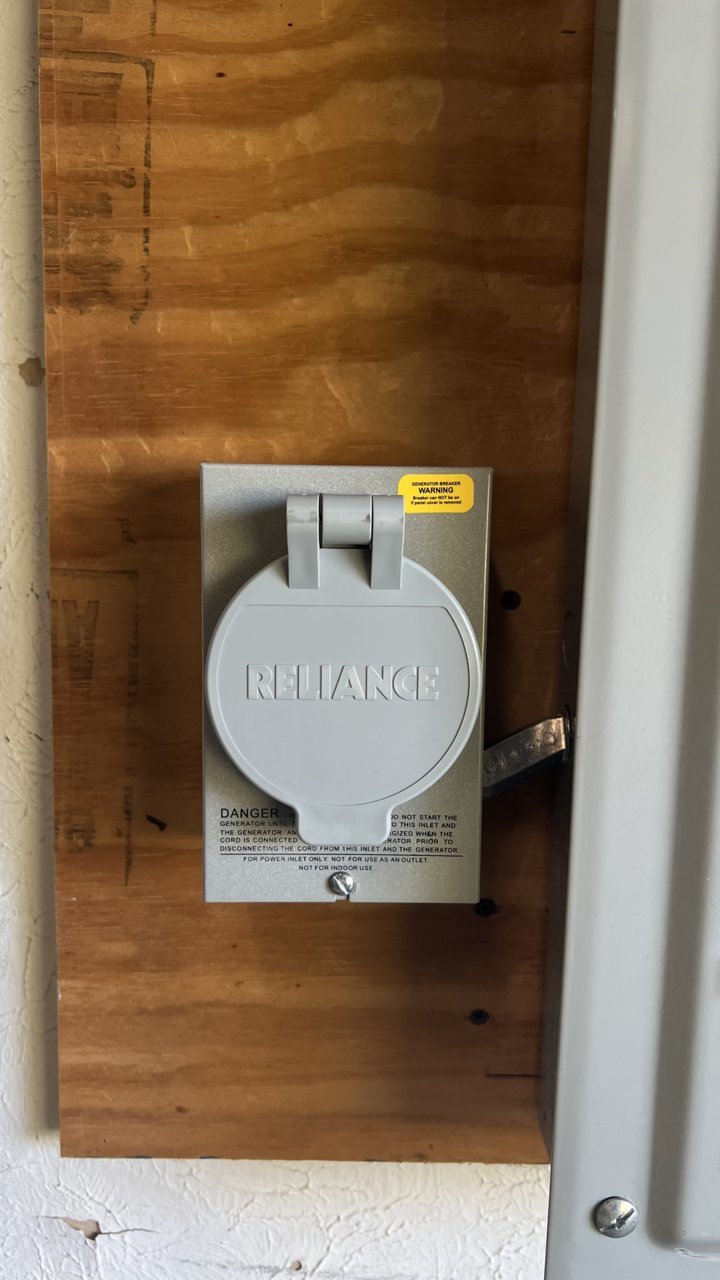

  18. Apr 27, 2023 at 6:45 AM
    themcnertney
    themcnertney Well-Known Member
    Jul 12, 2021
    #371097
    710
    Dan
    Akron, OH
    2016 Toyota Tacoma, Off Road, 6 speed manual
    Added an interlock switch for my house generator.
