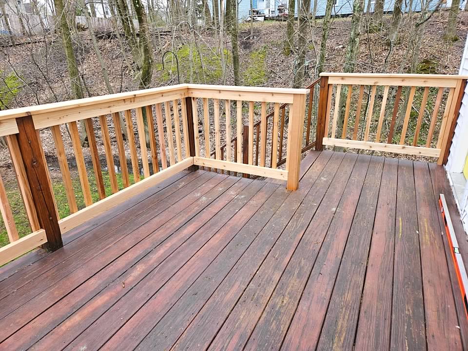

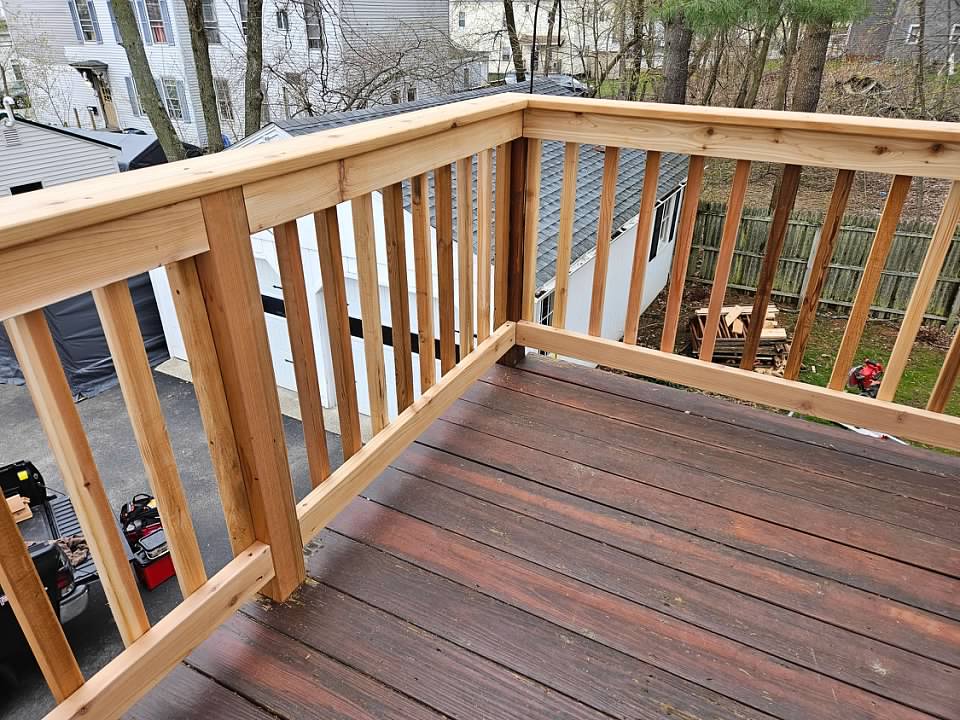

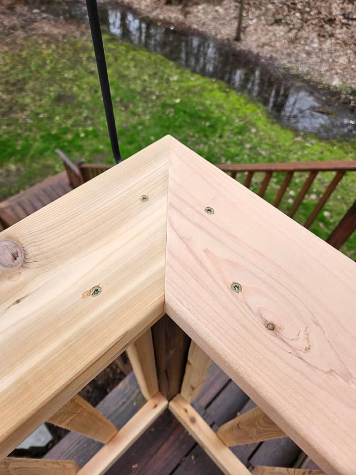

    Those corners look really tight!

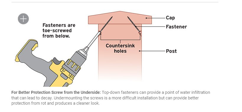

    One thing I am always wary of, screws in the railing caps. It's a great way to get them well secured but since you went that way would you maybe consider sealing that a bit? You could countersink and plug or just goop over the tops to reduce water intrusion and eliminate the collection point. Unless you're going to paint, but the wood looks nice as-is.

    Thanks. Miters are glued & screwed. Titebond 3 with GRK trim head screws.
    The top cap is 5/4 cedar decking boards. Not a lot of room for a screw to grab if toenailed from the rail underneath. I pre drilled, sprayed the hole with clear shellac and was careful not to bury the screws. That process has served me well over the years.
    Edit: I usually use a 2x6 for the top cap and that can be toenailed from the bottom. But I could only find them (cedar) 8' long locally. I didn't want a seam/joint so I went with the 5/4 which I could find in 10' and 12' lengths.
    And good GRK Deck screws. None of that Deckmate crap.

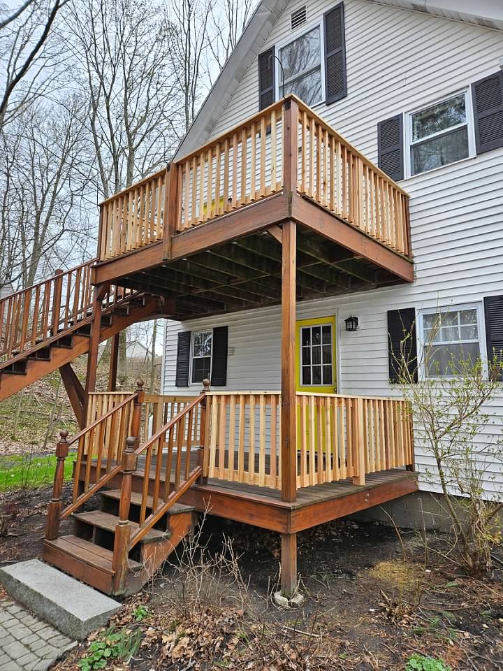

    Rim/Band is 2x10. Inner joists are 2x8.
    Whole thing really needs to be replaced, but customer just wanted railings replaced. Posts should be 6x6. It's just as crooked as that Kitchen is.

    Stair stringers are generally cut from 2x12 material.

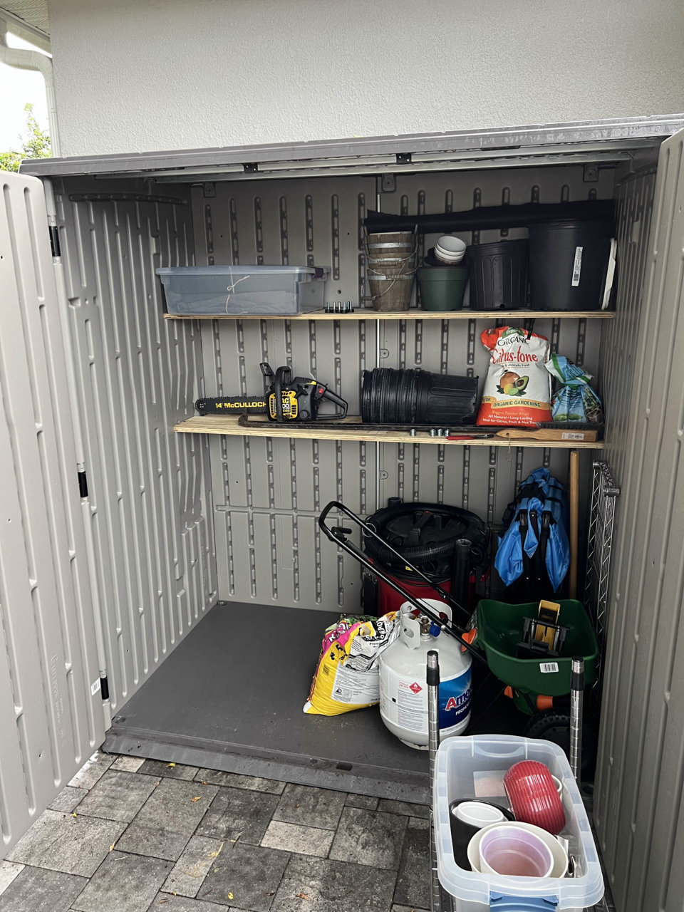

    added some shelving to my lil craftsman shed

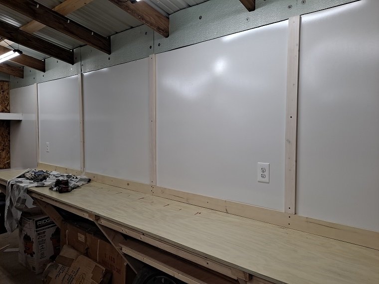

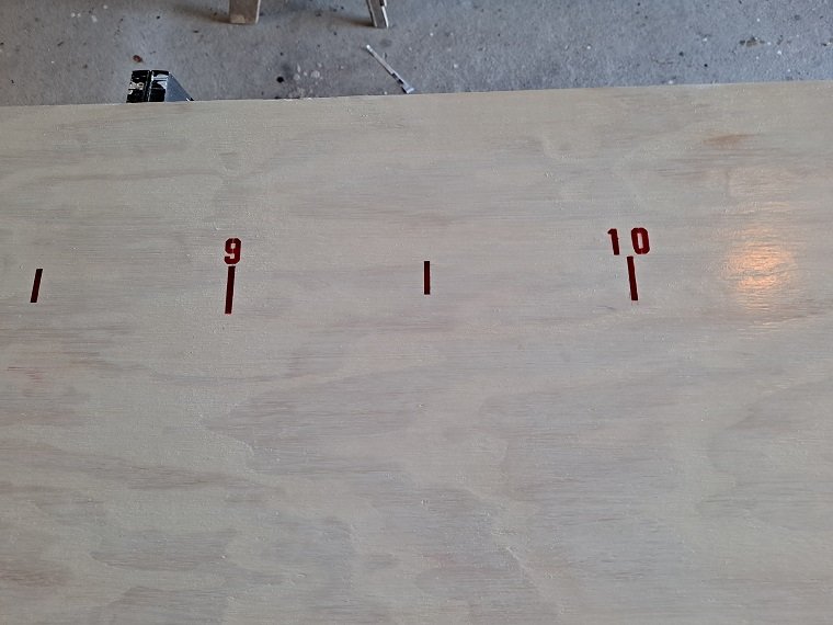

    About finished up my latest workbench, also laid out 10 feet of measurement on the top surface for rough measuring things like pipe or wire for future projects.
