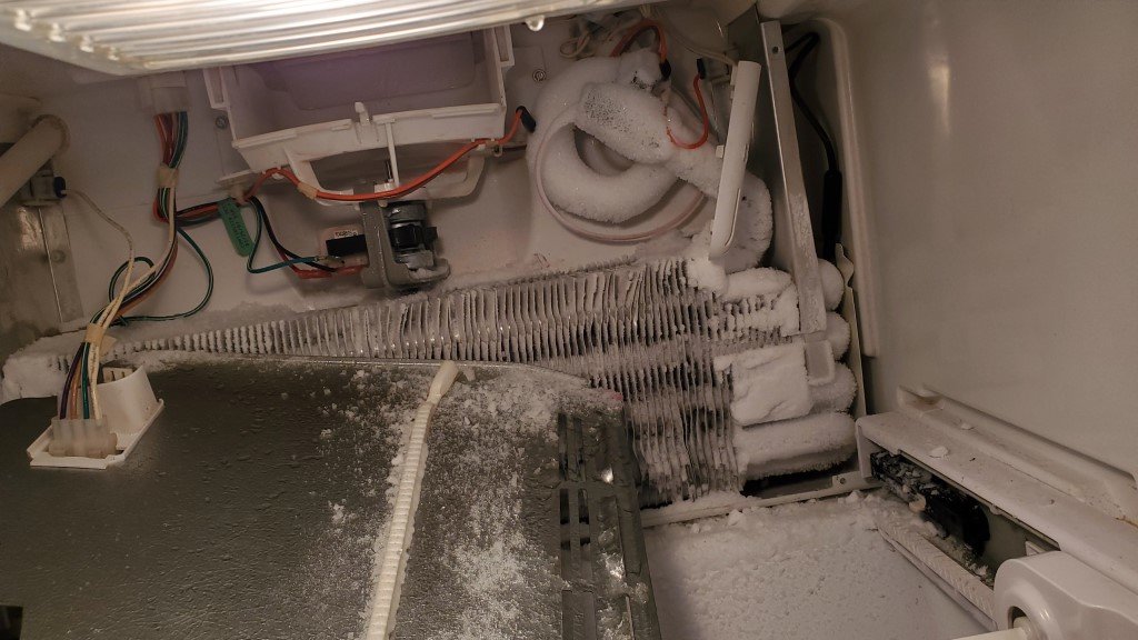

    The fan could be bad as well

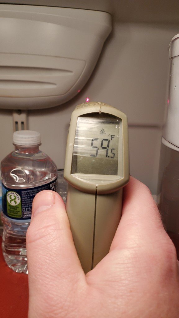

    Fan runs fine and actually the fridge is starting to cool since I cleared out all the frost from the coils.

    It has already cooled down a good bit already. But, I know it's temporary till it freezes up again. Like I said, it's time for an upgrade. This thing was originally white, but due to the previous owner being a chain smoker is no longer white. Even the inside is nicotine stained. I might fix it and give it to a friend. She's a chain smoker, so it would fit right in :rofl:

    It is a freezer on the bottom job right?

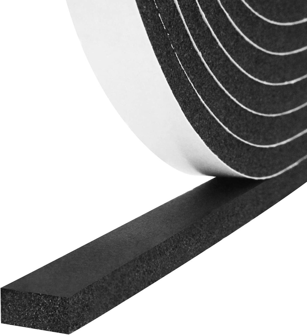

    I have the same one that did the same thing repeatedly, see that whimpy little strip of white foam on the cover? I replaced it with some 3/4" wide black foam and the problem went away for good.

    @Delta09
    I might have even put 2 strips on there, it has been several years now.
    Like this:

    It will cool just fine after you defrost the coils, I used a heat gun to melt it out.
    The air can bypass around that whimpy foam is what makes it freeze up.

    Once I unplug it when the new one arrives and it defrost completely, I'll check the resistance of the heating coil to see if it's still good. I actually have some of that foam insulation from when I did the heater core in my old '99 S10.
