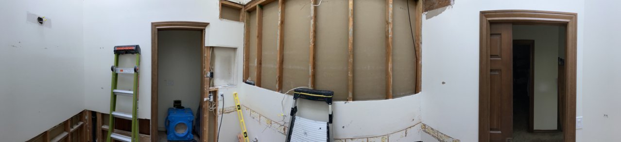

    What I’m up against. Good thing I have a full supply of beer.

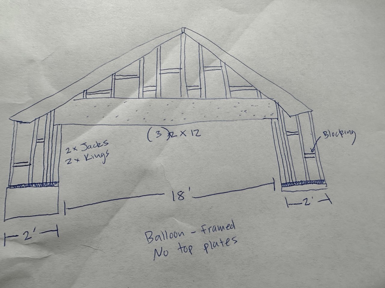

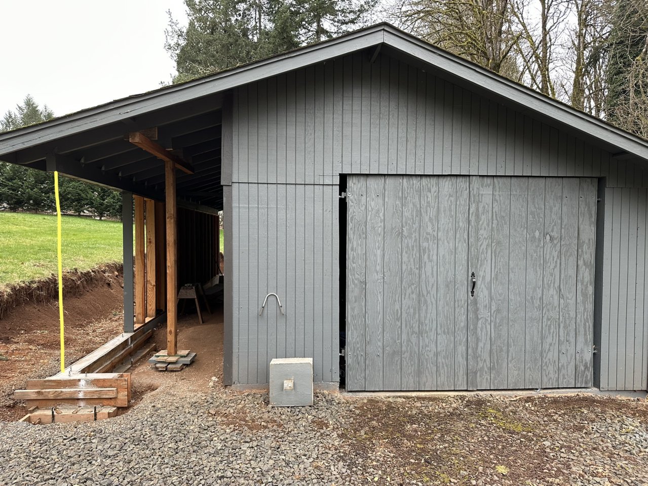

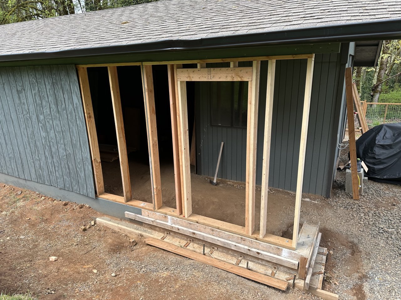

    Some shop updates:

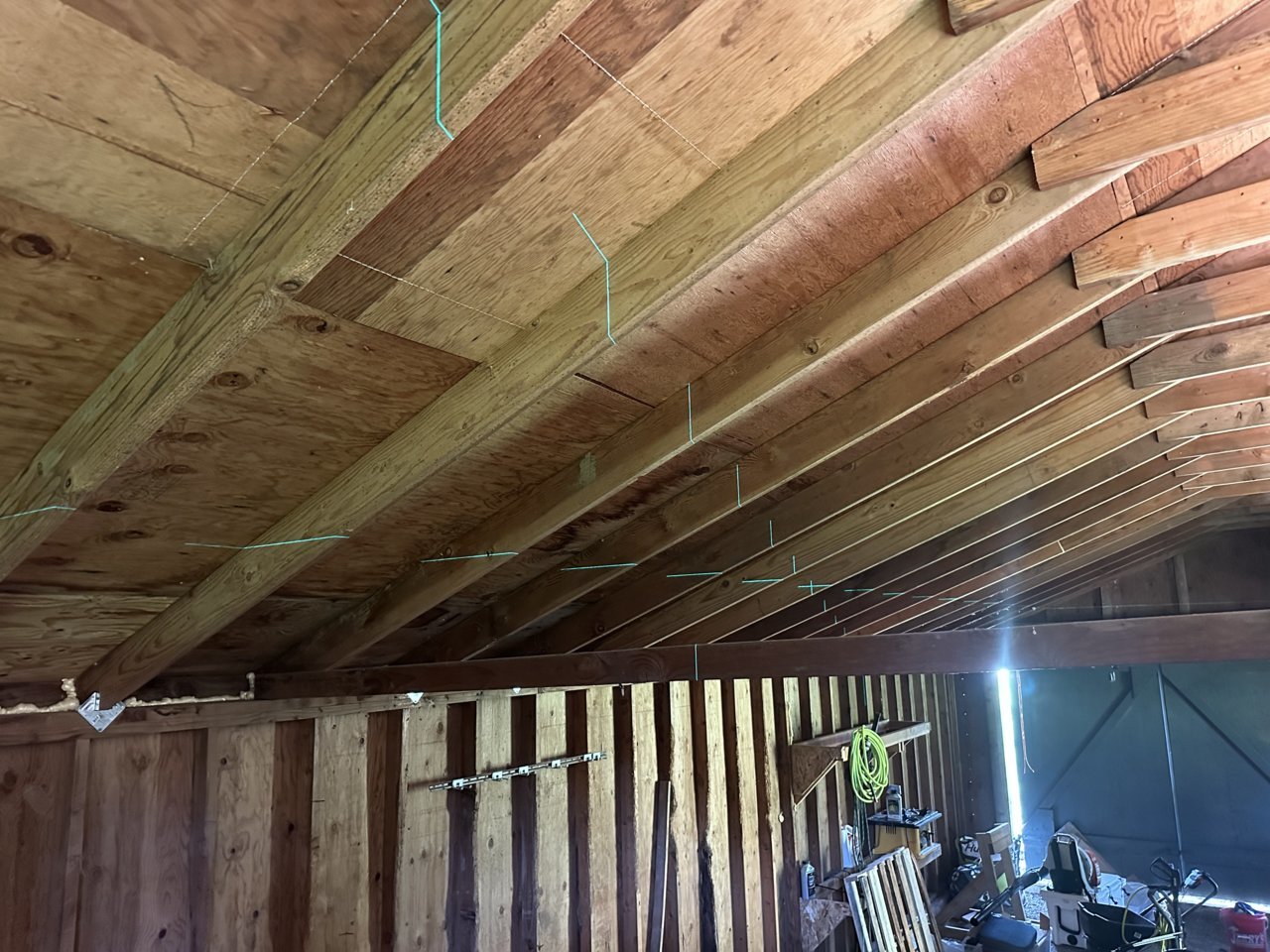

    Since this was a horse stable at some point, there were horses that bit through a bunch of studs. I went in and sistered all of the chewed up studs before a small crew of framers came in to help me out.
    The crew came in and installed a rafter tie on every single rafter. My engineer said this would provide the structure so I could remove the center wall that was pushing up on the roof.
    Then they hoisted a wall I framed last fall into place lol. It was just sitting there under the eave. Didn’t have enough people around to hoist it.
    They braced it against the existing framing to add some shear strength to the gable end. Then my engineer instructed them to put kickers on the front gable end before they remove that wall + the center load bearing wall. I held my breath as it came down, but it looks like the engineer got it right. Still standing tall. No roof ridge sag, and no walls bowing.
    That’s as far as they got in a day. I had originally only hired them to put in the rafter ties, put my wall in, and take the existing walls down. But they’re between jobs and had a couple extra days to spare so I paid them to tidy-up some framing and sheath the entire building. The siding is rotten so I wanted it all gone. I’ll redo it later in the summer after the roof.
    Check out all that room!!
    Doing some final clean up tomorrow and hauling scraps away. Concrete cutter will be by to cut the old stem walls off at some point. Then Friday I have an excavator coming in to grade and compact 4” of gravel. Hopefully get the floors poured next week! The front of the building is just going to stay open until the concrete is in I think. Just gives people more room to work around. The gable end isn’t load bearing and those kickers have the engineer’s blessing in the meantime.
    Now that there’s more light in here I’m seeing the mold wasn’t as bad as I thought. It looks like the roof sheathing is only bad on the very bottom row. The rows going up to the ridge seem reasonably fine.
    When I get the shingles off, I’m contemplating just replacing that bottom row and treating the others. My only other concern is I have some dry rot on a few of the rafters. Ideally I’d replace the 4 or so that have damage so it won’t spread, but I’m wondering if treating + sistering for permanent structural support wouldn’t be sufficient. You can see there’s already one that’s been sistered, but again the rotted board is still there. Replacing would require me to take the whole deck off, I think.

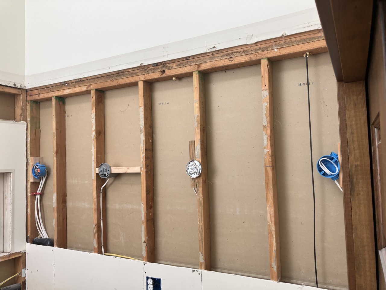

    Hah, just finished up a little while ago, I used 3 different types of roundies...

    yep, all within code for the lights.
    outlets, i'd usually recommend one on each side wall instead of a quad in the middle. don't know your usage, but generally his/hers sinks, having outlets on the far outsides of the sink basin's allows each person to keep things plugged in without bothering each other.
